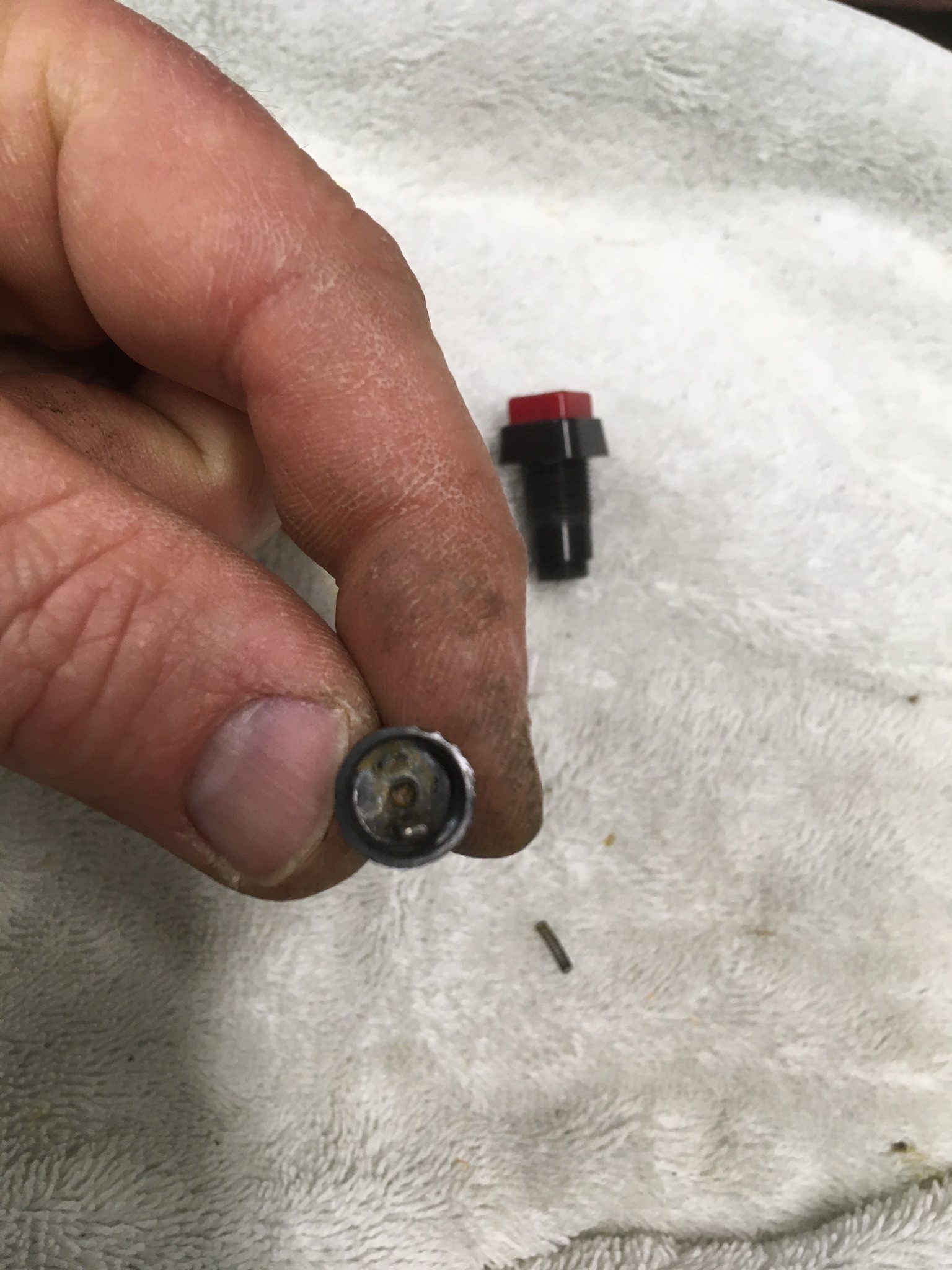

While I was at it decided to try and fix the intermittent water pump switch. In case you ever wondered how it went together. Mine was just dirty. Soldered the wires and cleaned everything up.
Cleaned it up and put it back together. I thought working on the kitchen sink in the house was hard, hardest part was getting at the nut to take it off. Oh, yes also be very careful with the larger of the two springs. I tried to clean it with the dremmel and shot it to who knows where. Luckily I was able to cut down one from a pen and it worked fine.
