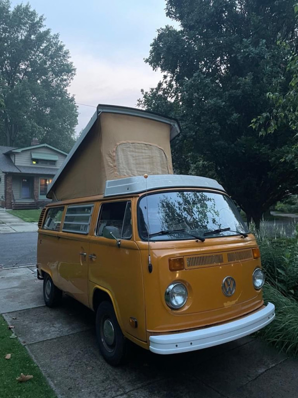

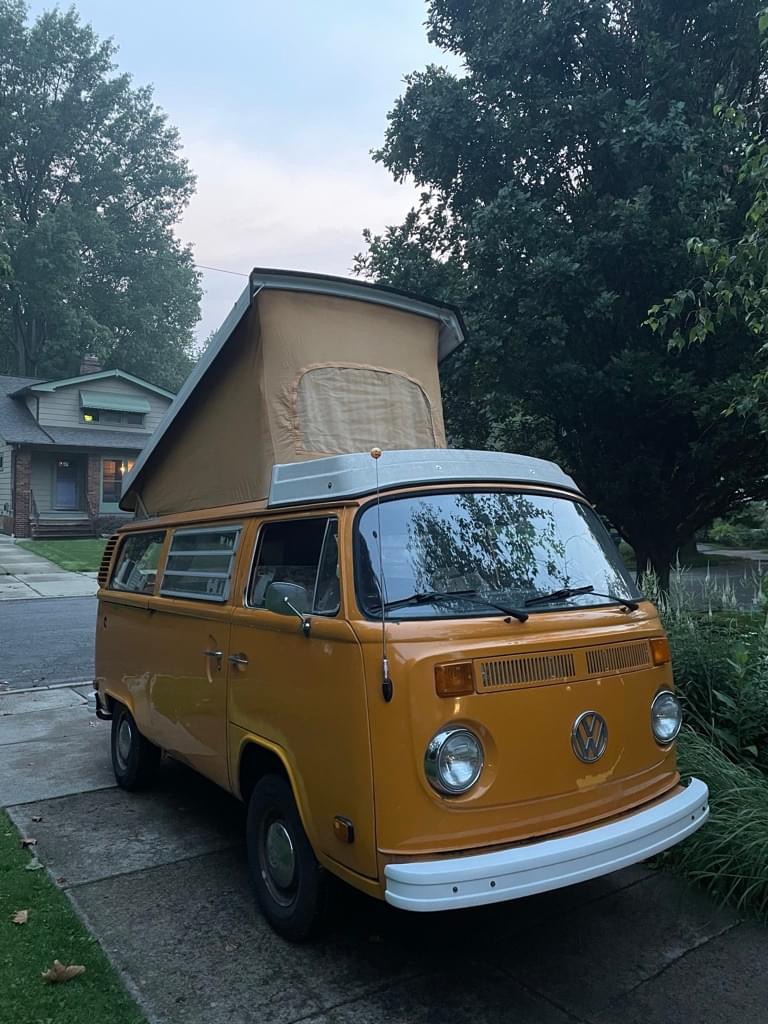

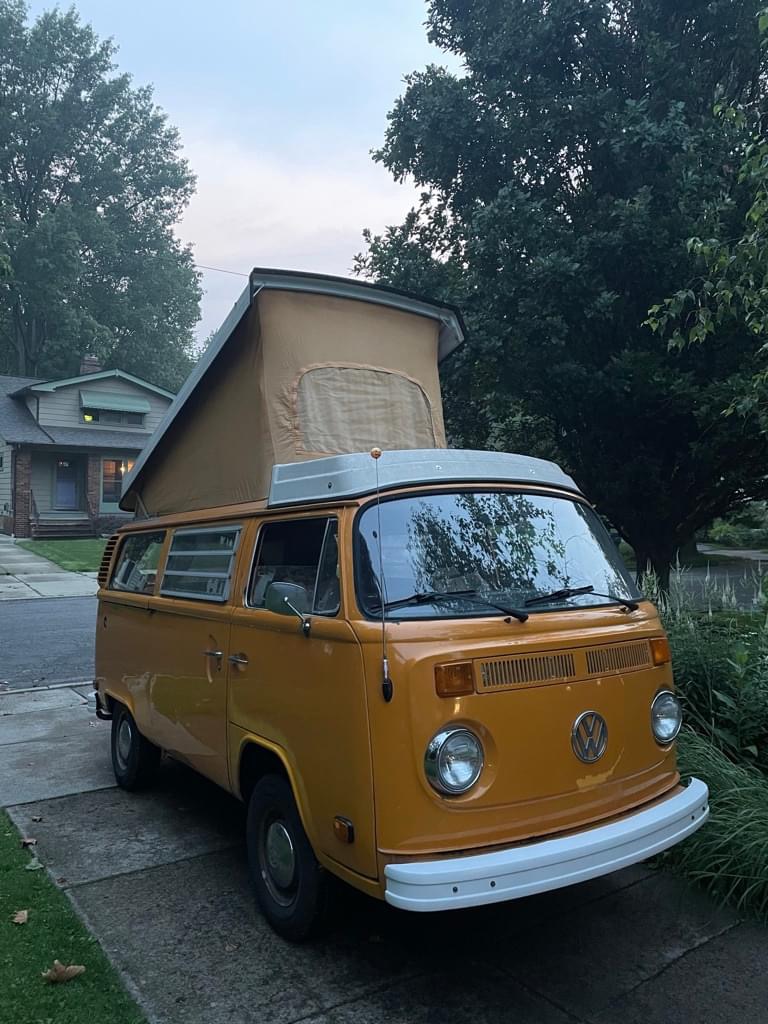

With my little family growing from 3 to 4 with the arrival of a kiddo #2 in September. I had been dreaming about a finding a late bay camper. I even started collecting parts in anticipation of owning one 😅.
This 77 yellow Westy came up for sale on Leakoil’s facebook group and I was able to buy it.
The bus is in a great stock driver condition but could use some TLC. Thanks to Brandon Antz for bringing his yellow 77’ out so we could twin our way home.
Stay tuned for updates as I work on turning this bus into a family friendly Pumpkin.

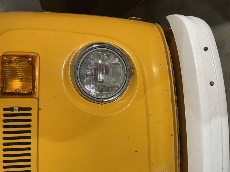

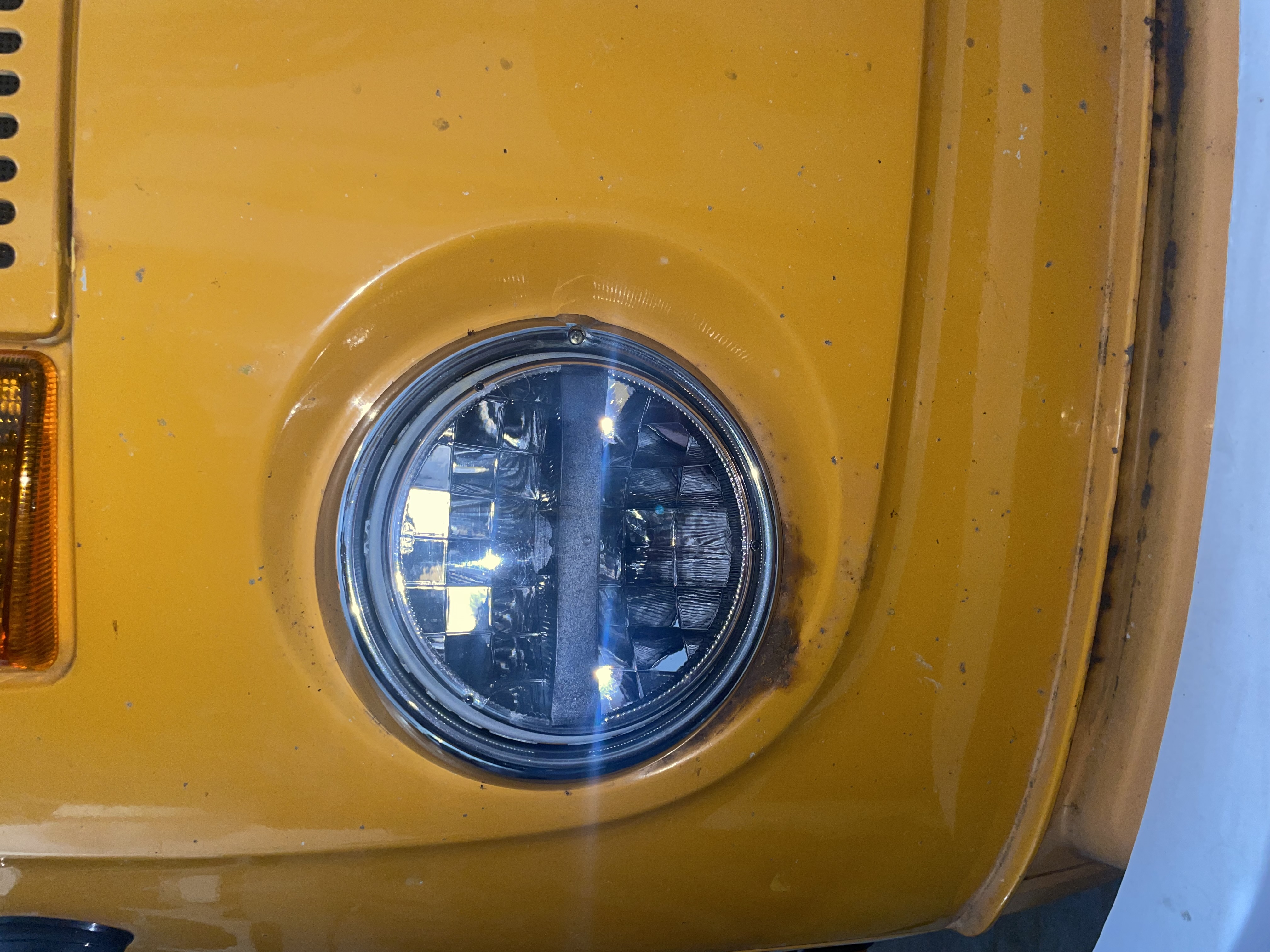

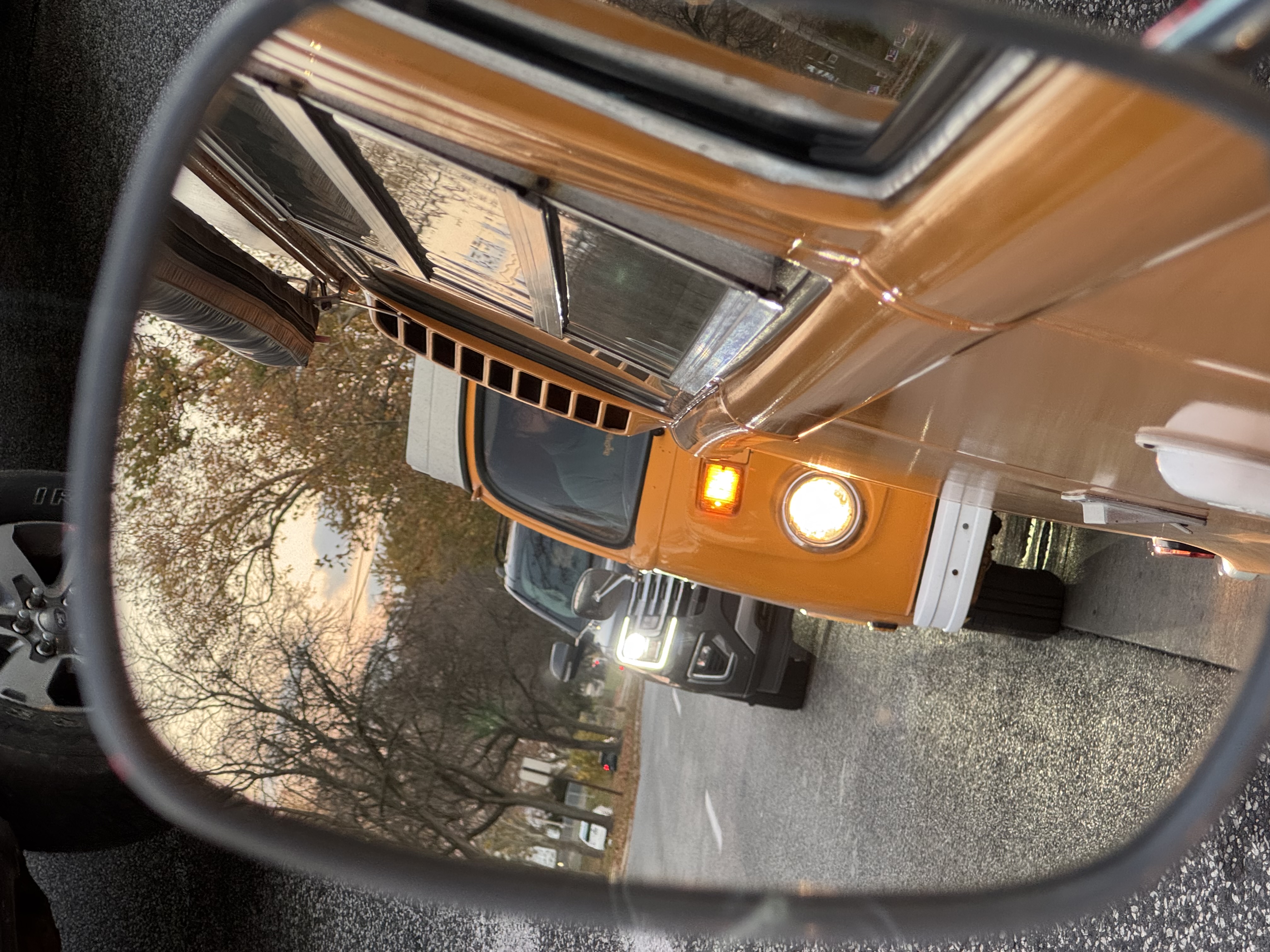

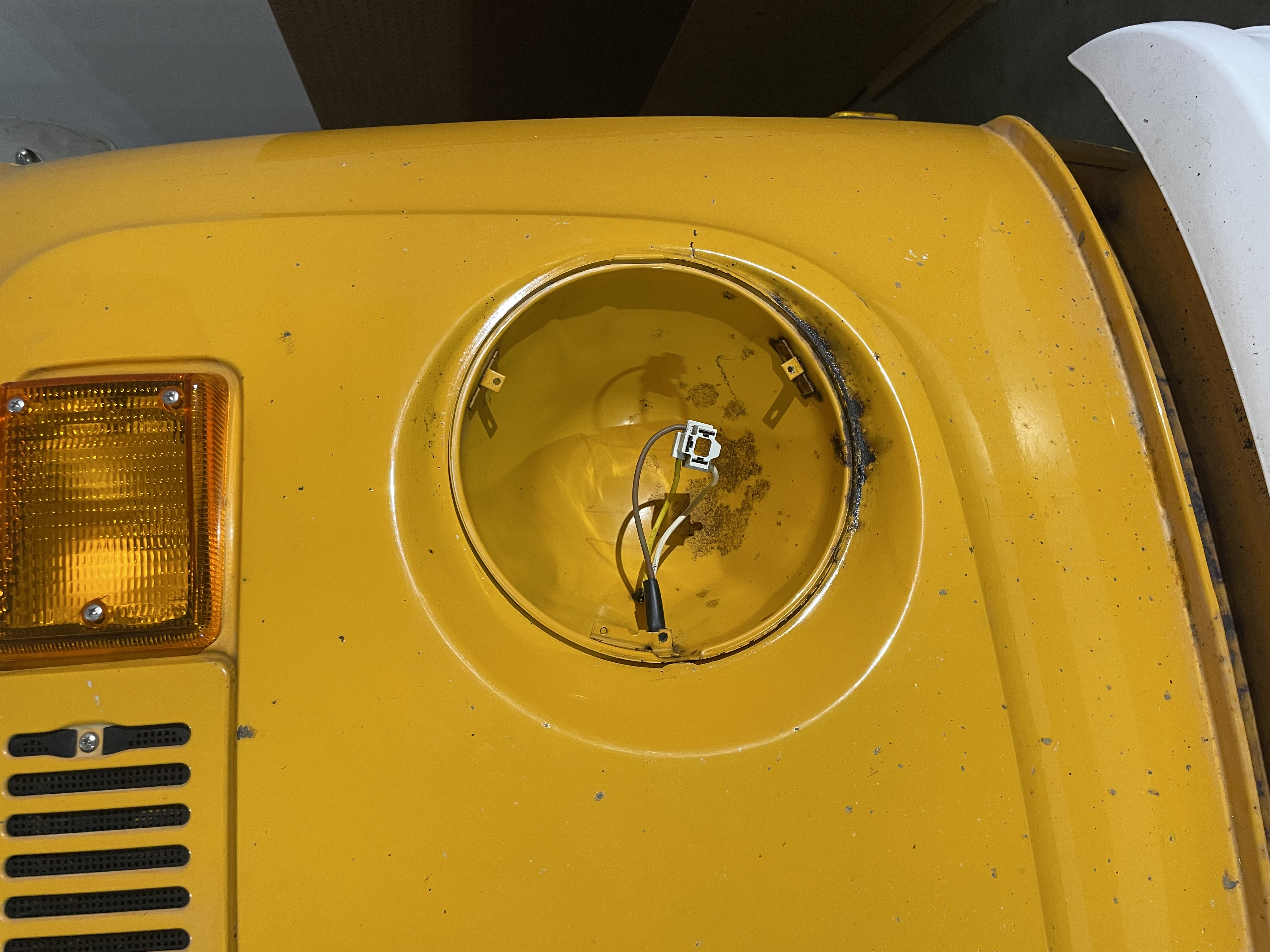

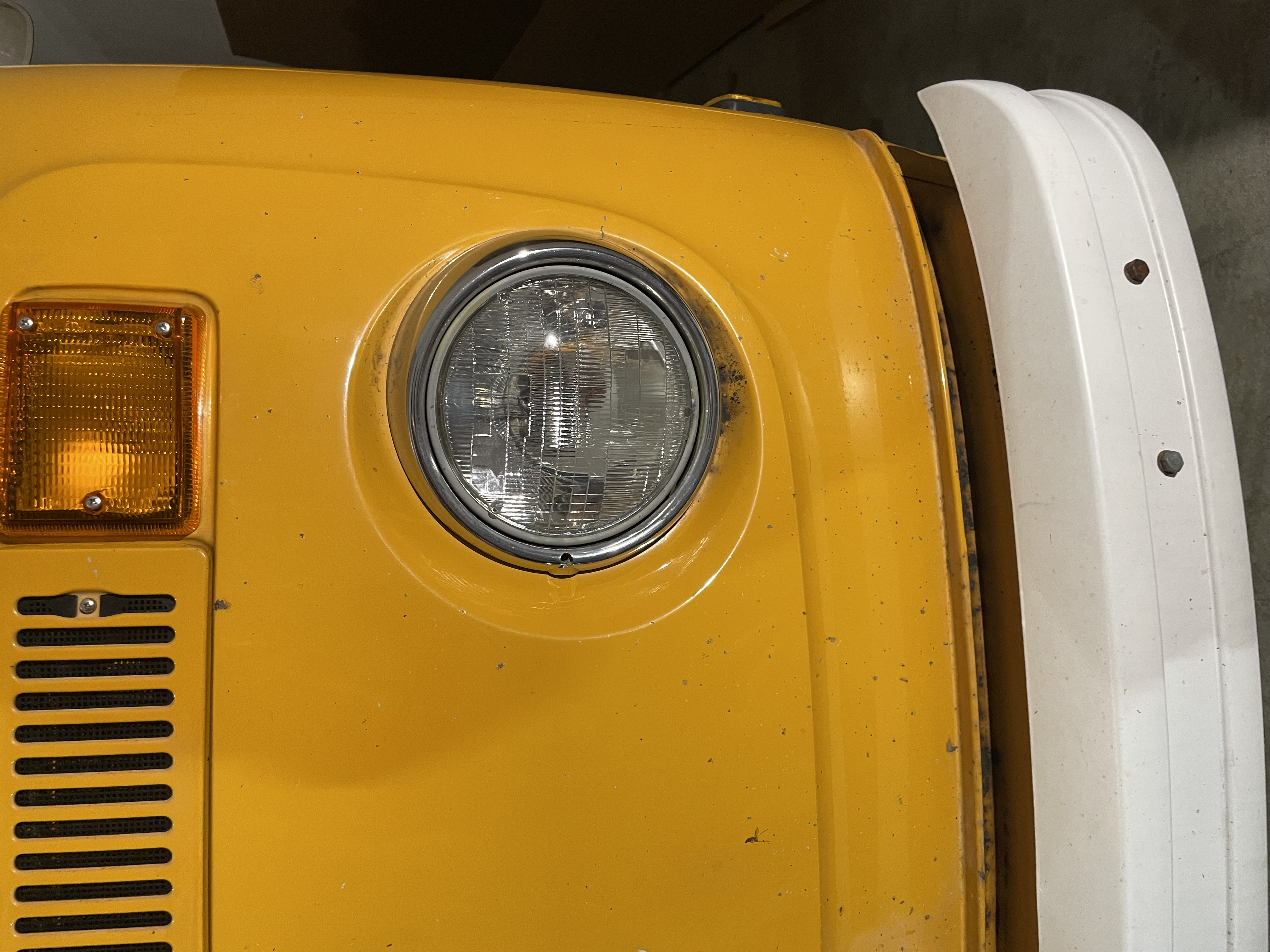

LED headlights from gowesty. Really impressed from my late night drive last week. Found some child labor to help with install.
