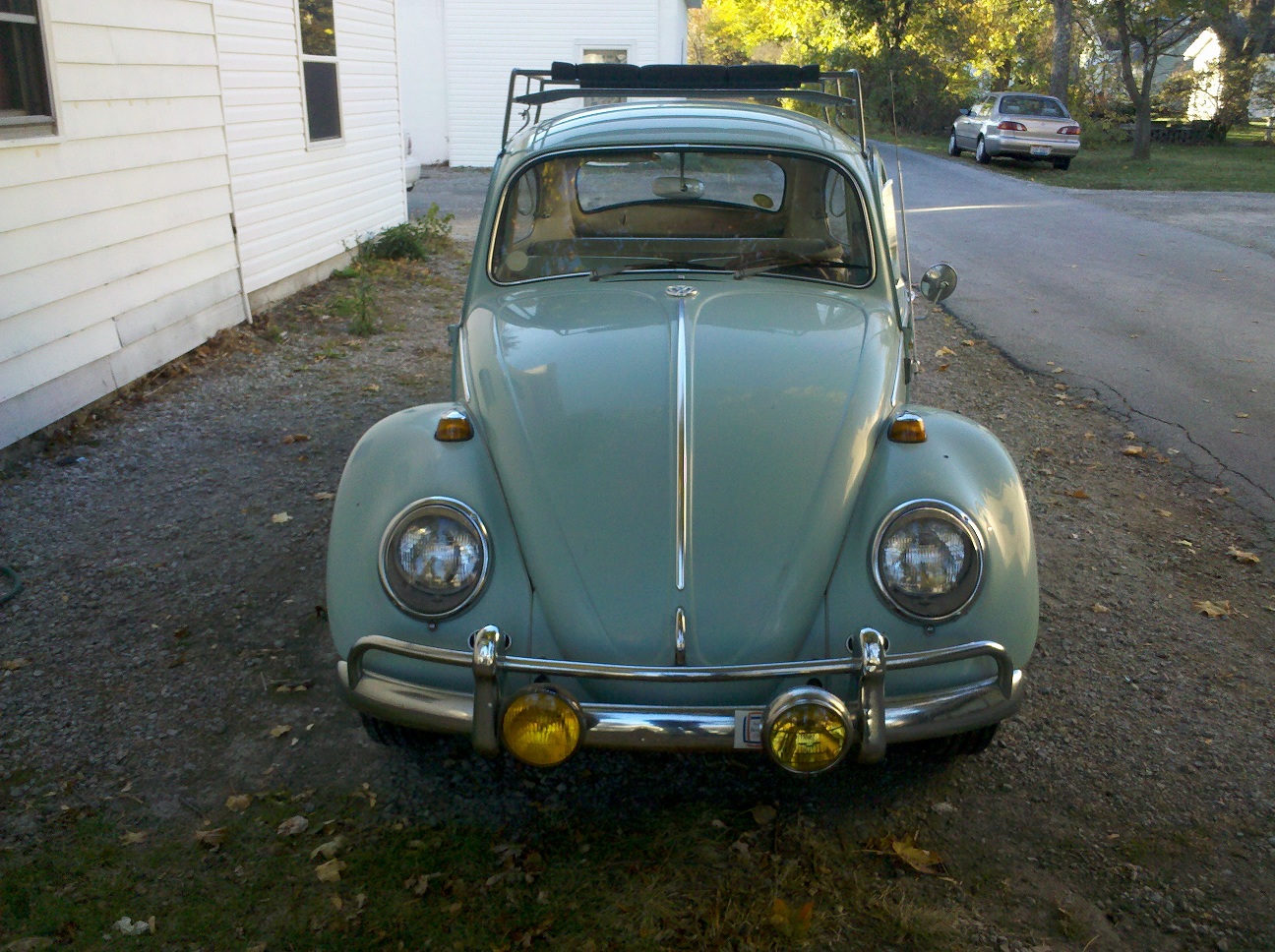

Need to make some better/stronger brackets, but these work for now. They look good even though they are a mis-matched set of fog lights. It really helps at night.
