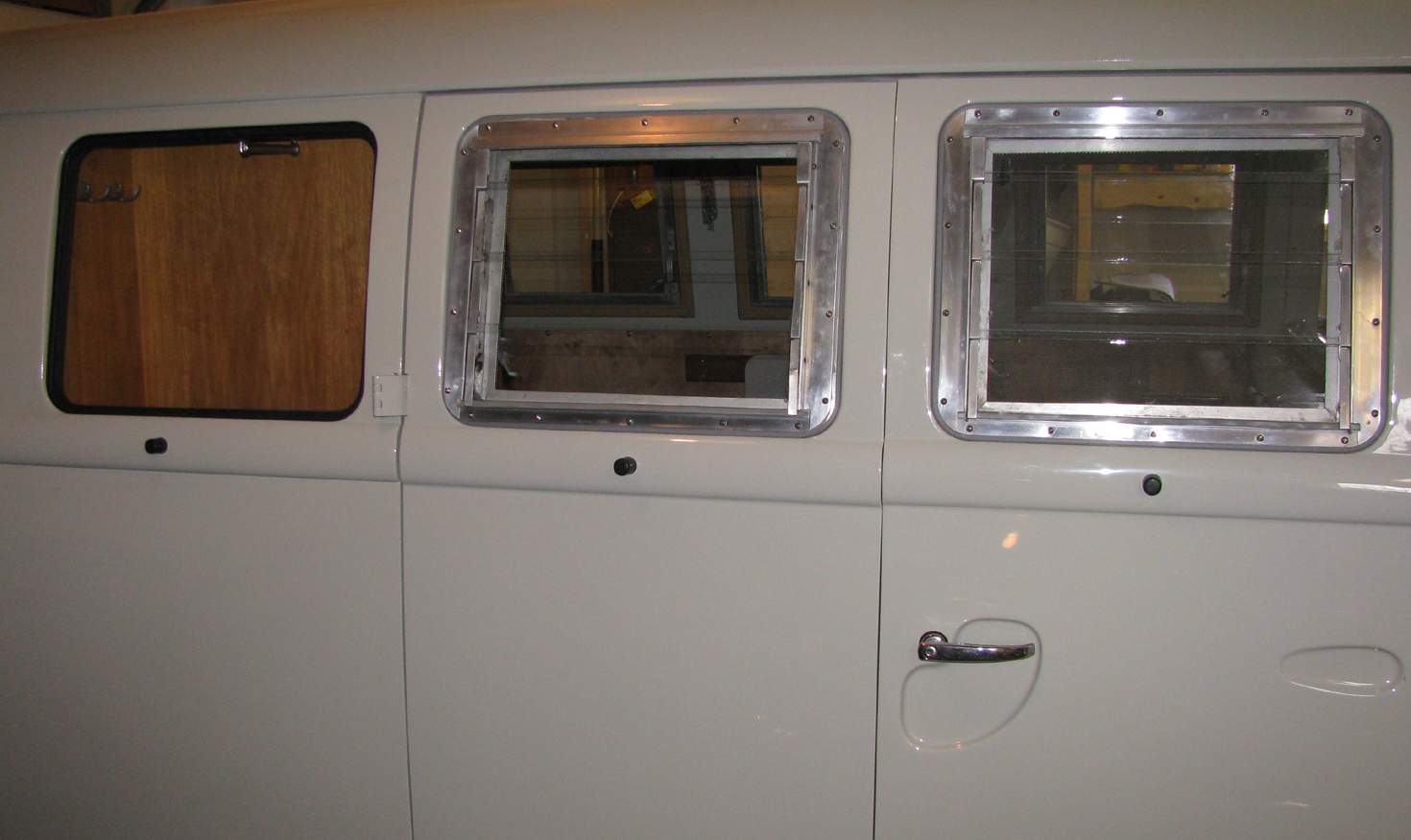

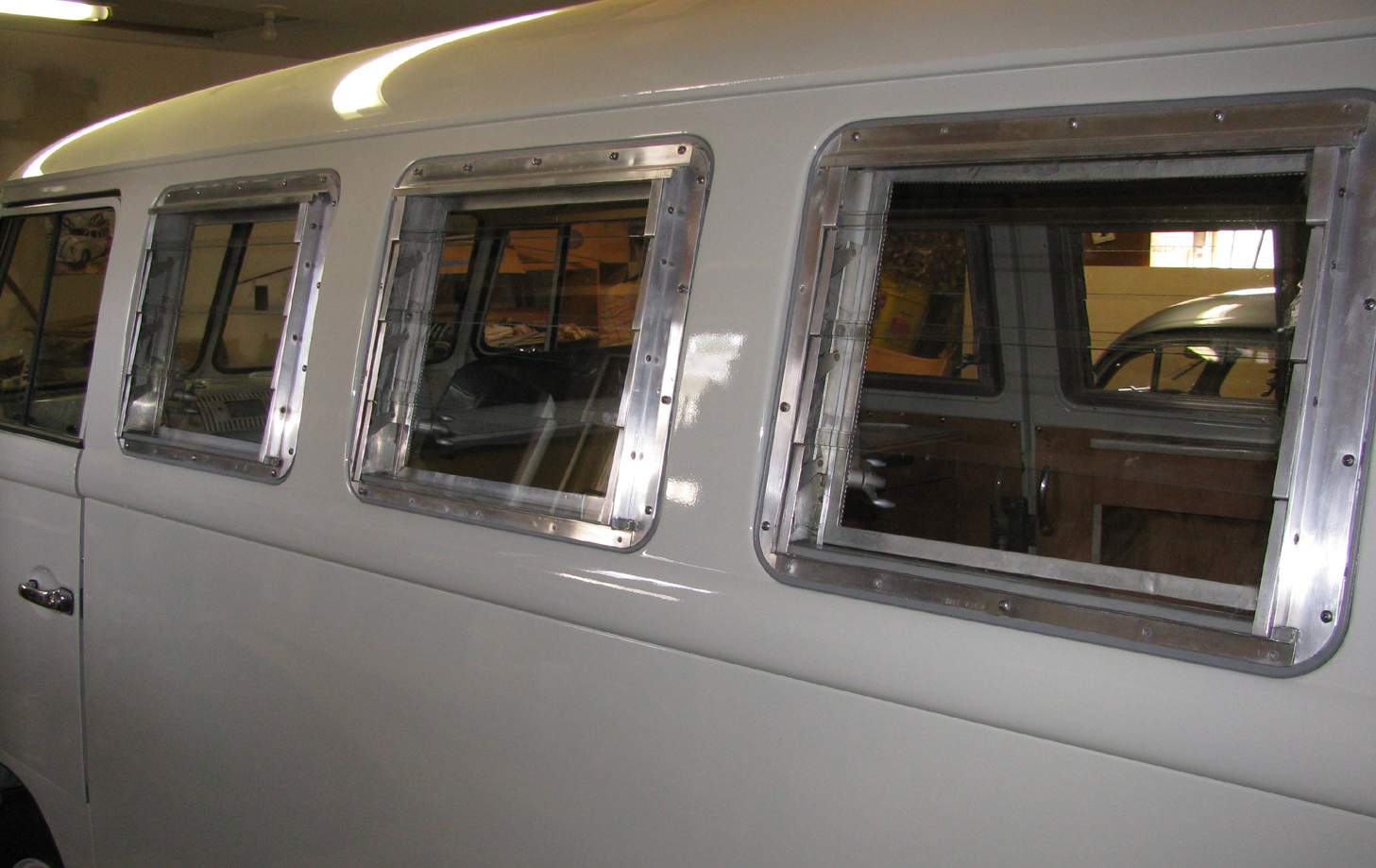

Got all the glass in today including all 5 jalousie windows. Glad that is done. Now on to the wiring.

How many cans of "NEVERDULL" did you use on those windows? I'll bet your fingures are still black :lol:
65Westy
Posts: 162
Re: 65 Westy
Post by 65Westy »
Wasn't too bad Bill..... I used fine steel wool and WD 40. I just hope they stay shiny.

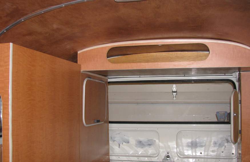

Got the rear hatch put on and the glass in. That was the worst glass to get in. Got the overhead cabinet put in. Now I know why they call it "headbanger". Ouch......

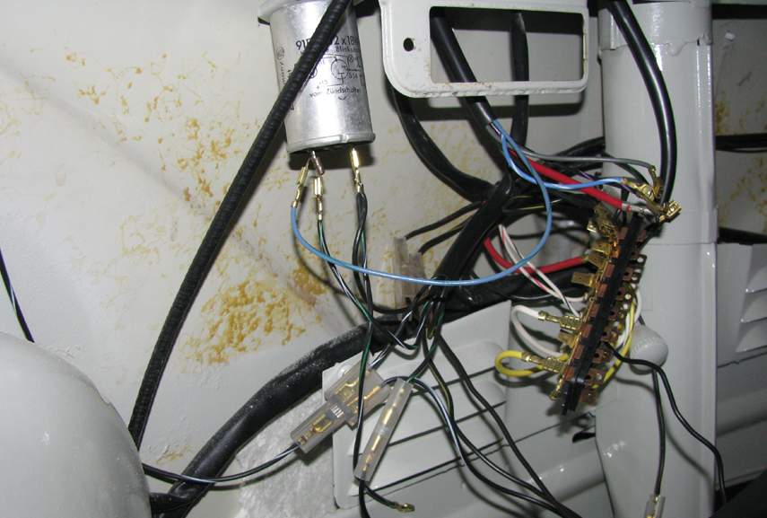

Finished up the wiring today and after double and triple checking everything, put fuses in the fuse box and connected the battery. Lights & horn work but can't get the starter to kick in and the green directional arrows on the speedometer are both on w/o the key in the ignition and so are the overhead lights. No turn signals or emergency flashers either. Time to start trouble shooting cuz I want to get this bus on the road...

Bob, I've got a 2 pin can shaped flasher relay and a 4 pin remote relay. The flashers and turn signals worked before I took the old harness out when I got ready for paint. The diagram that came with the new harness (Wiring Works) matches with the numbers on the remote relay and with the colors of old wires. (I cut the wires on all the switches and relays leaving an inch so I could see what color went where). The problem is with the flasher relay (I think). My relay shows one pin to be "S54" and the other "+15". The diagram shows three pins and they are supposed to be "49+" and "KBL" and "49A" or X P and L.
My dad who has been into ham radios for 60 plus years is going to come over and try and help me sort it out, hopefully this week. I'm itching to drive it now that I am so close!
