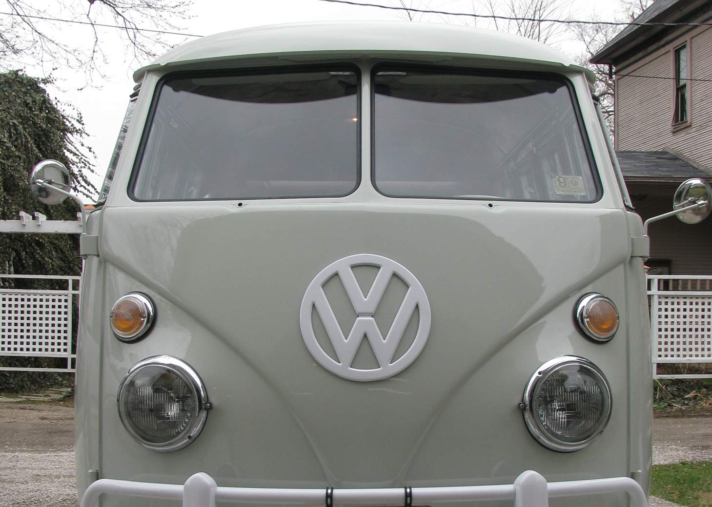

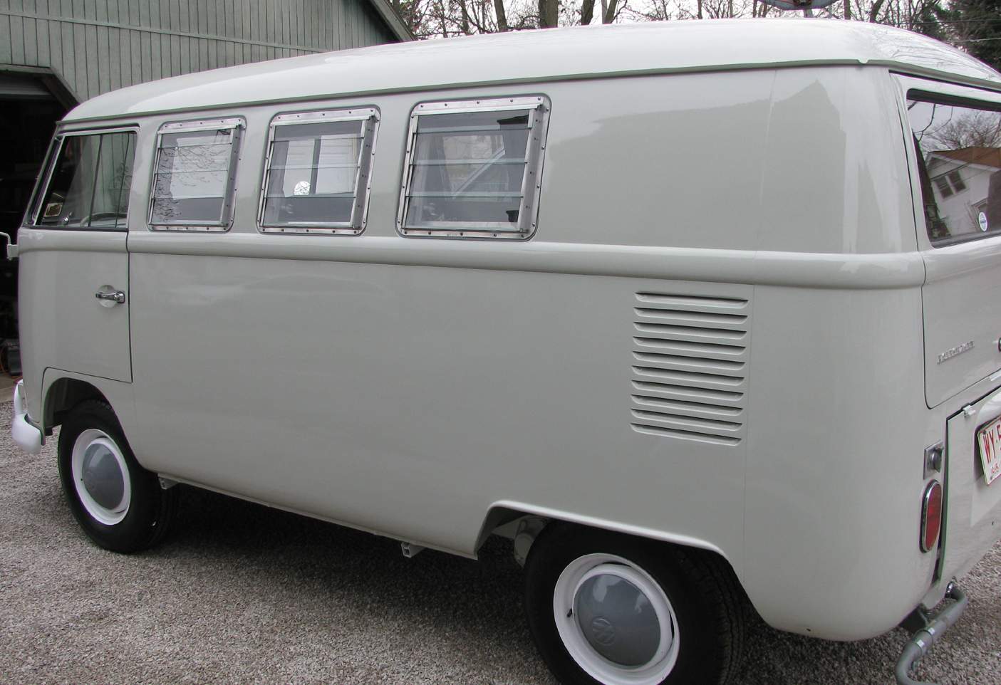

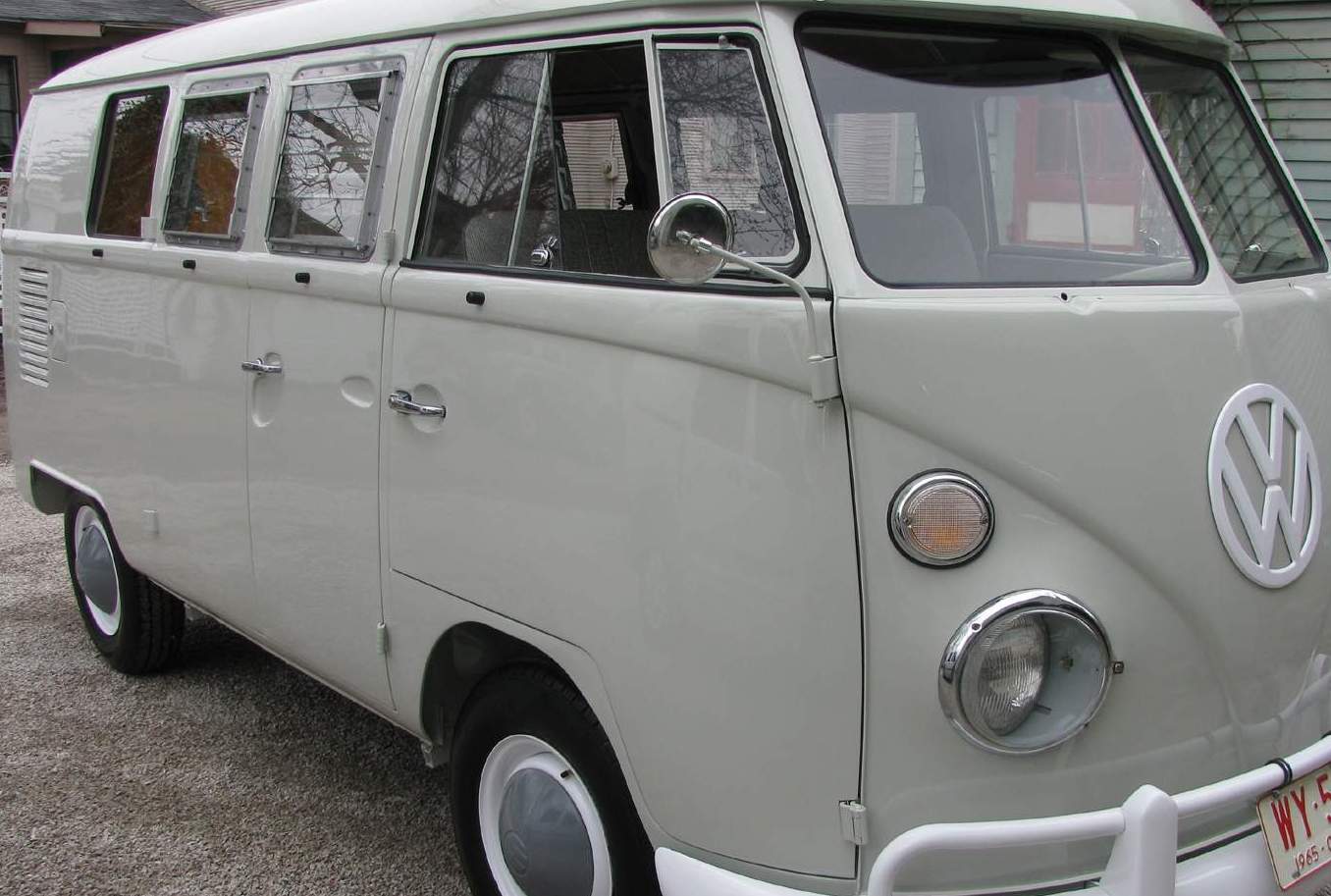

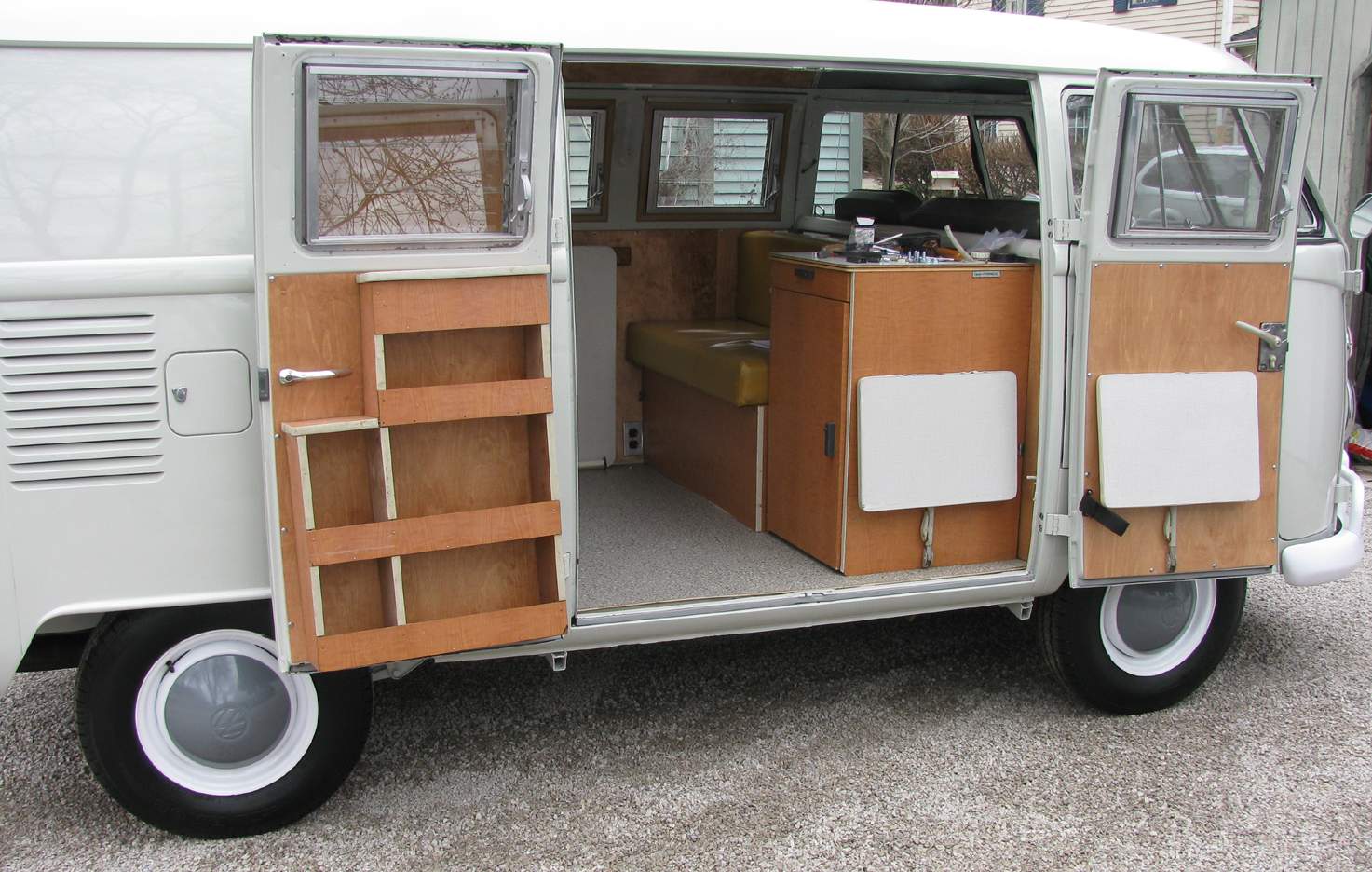

The Westy left the garage today under its own power. First time I've driven it in the 18 months I've owned it and then just out into the driveway. I need to put the rear bumper on and adjust the clutch and install new shocks and then its out for a spin around the block - maybe this weekend! Still don't have the turn signals and flashers figured out.

Looks great!!
You did a nice job.
