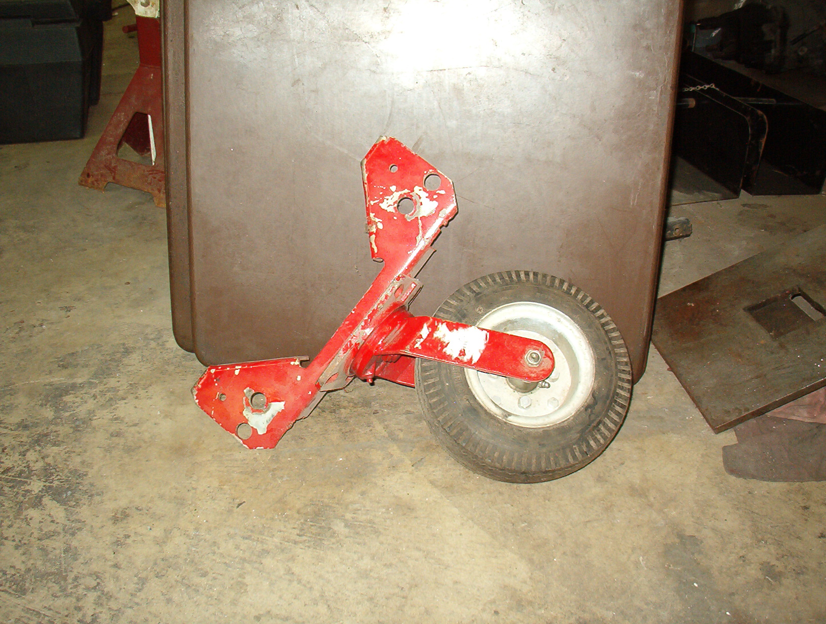

Sean,I think those hole could be where there were plugs. Not 100% on that. Also,I have something you can use while yours trans is out. This bolts to the frame horns and you can roll the car around with the trans and axles out.
Re: 1957 Oval
That roller is awesome!wwebner wrote:Sean,I think those hole could be where there were plugs. Not 100% on that. Also,I have something you can use while yours trans is out. This bolts to the frame horns and you can roll the car around with the trans and axles out.
