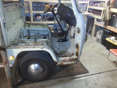

Stopped out Sunday to check on progress. David has completed what We considered the first phase. We went over some other areas of concern and It will be staying another week or so getting worked on the front lower half. Here is the rockers ready for paint..... Dog legs and cab floor is next.
Before they get cut out and new metal installed.

framingsilly wrote:Stopped out Sunday to check on progress. David has completed what We considered the first phase. We went over some other areas of concern and It will be staying another week or so getting worked on the front lower half. Here is the rockers ready for paint..... Dog legs and cab floor is next.
Sweet duel treasure chest doors!!

Since David was working on his Goon today I started preparation for him to weld the dog legs and side steps. Only had to drill one bolt . Anyway It's about ready and I'm taking all the wheels off tomorrow to get ready for the brakes ( probably all new parts ) We shall see.

Thats the goal ;) Im trying to get all the BS stuff out of the way to max out the time you have . Most of the replacement metal is good . There is two parts that I had that had small pieces cut of . Its flat parts that are missing . Im going to try to find time to start removing some of the metal without getting carried away or creating new work . Also I am going to wire wheel around the exhisting metal that is getting welded to . Never really did this type of work , but Im hands on .I'll show some pics after the weekend work .
