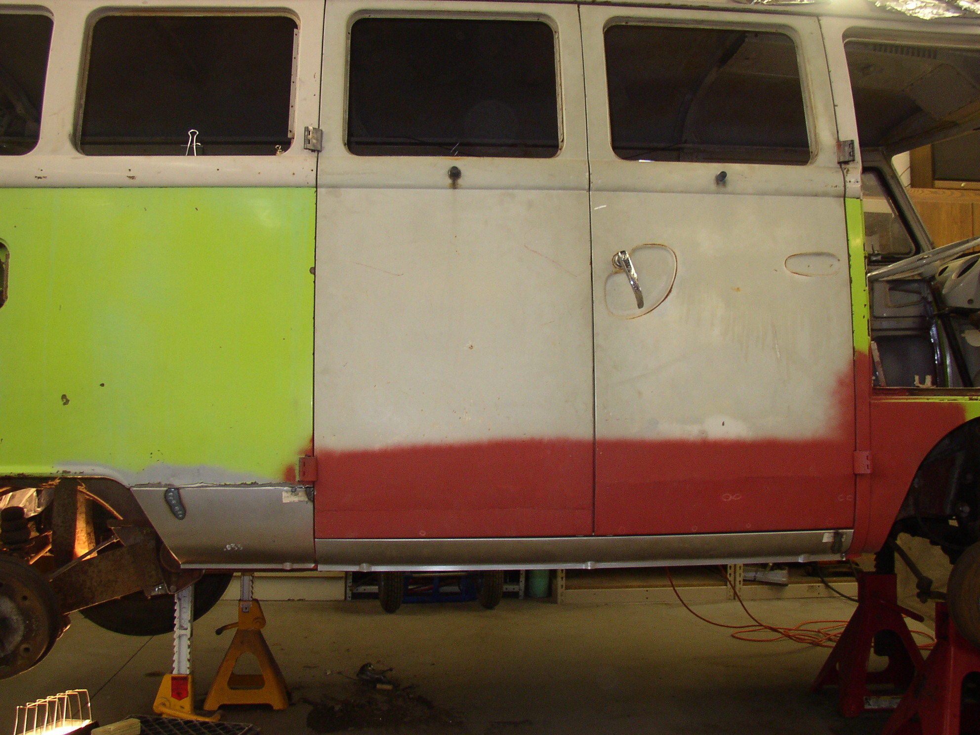

I got a lot done, pretty much finishing the cargo door/right floor/right rocker area. I did a lot of fitting and welding and I'm happy with how things look. The doors look and fit very well.

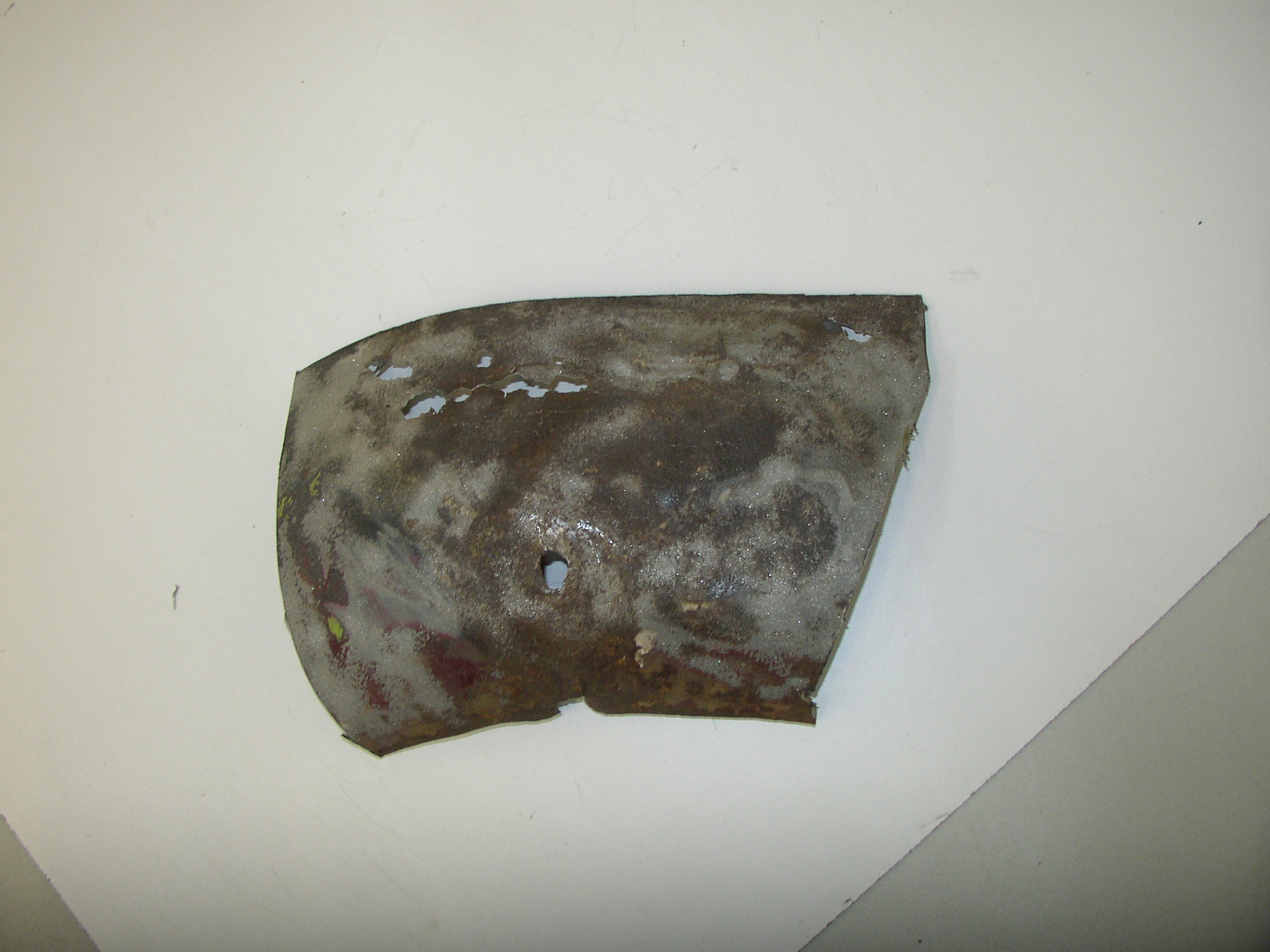

Everyone knows the tip of fitting a piece by making a cardboard template:

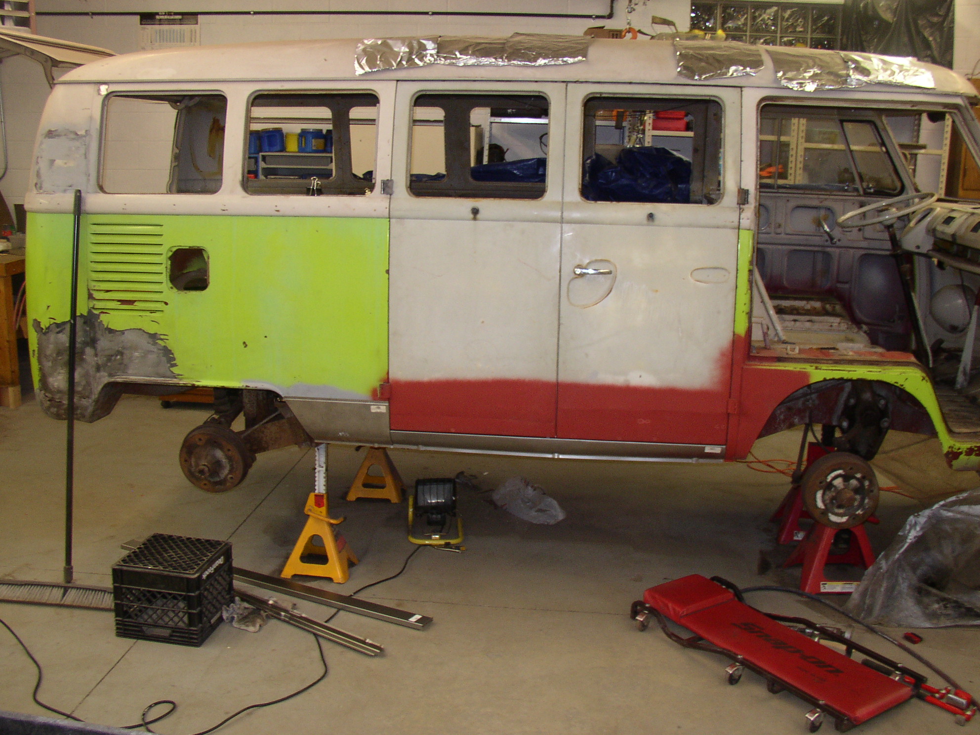

I love those Snappy roller carts, but they don't make a HD version for my fat ass. Here's my $9 version that works better than Snappy:

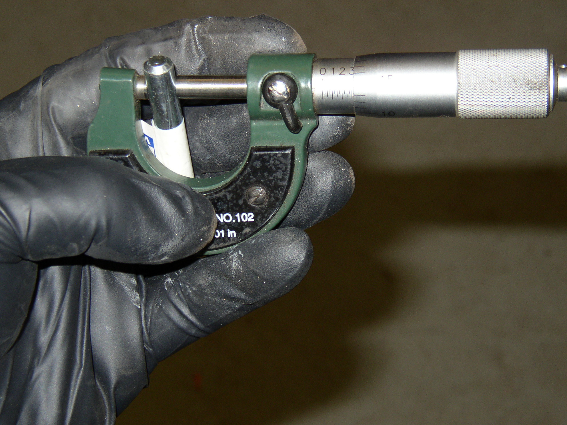

The standard pin is 8mm, which mikes out to .314":
My handy dandy chart shows 5/16" to be .0025" smaller than 8mm:
I now drill it out to 5/16". Running the bit at high speed gets me a couple of thou oversize so the pin fits nice:

I finally beat that POS brown floor into submission and got it installed. I'll now do a bit of grinding and get on to the RR area, which shouldn't take long. Then comes the long left rocker.....

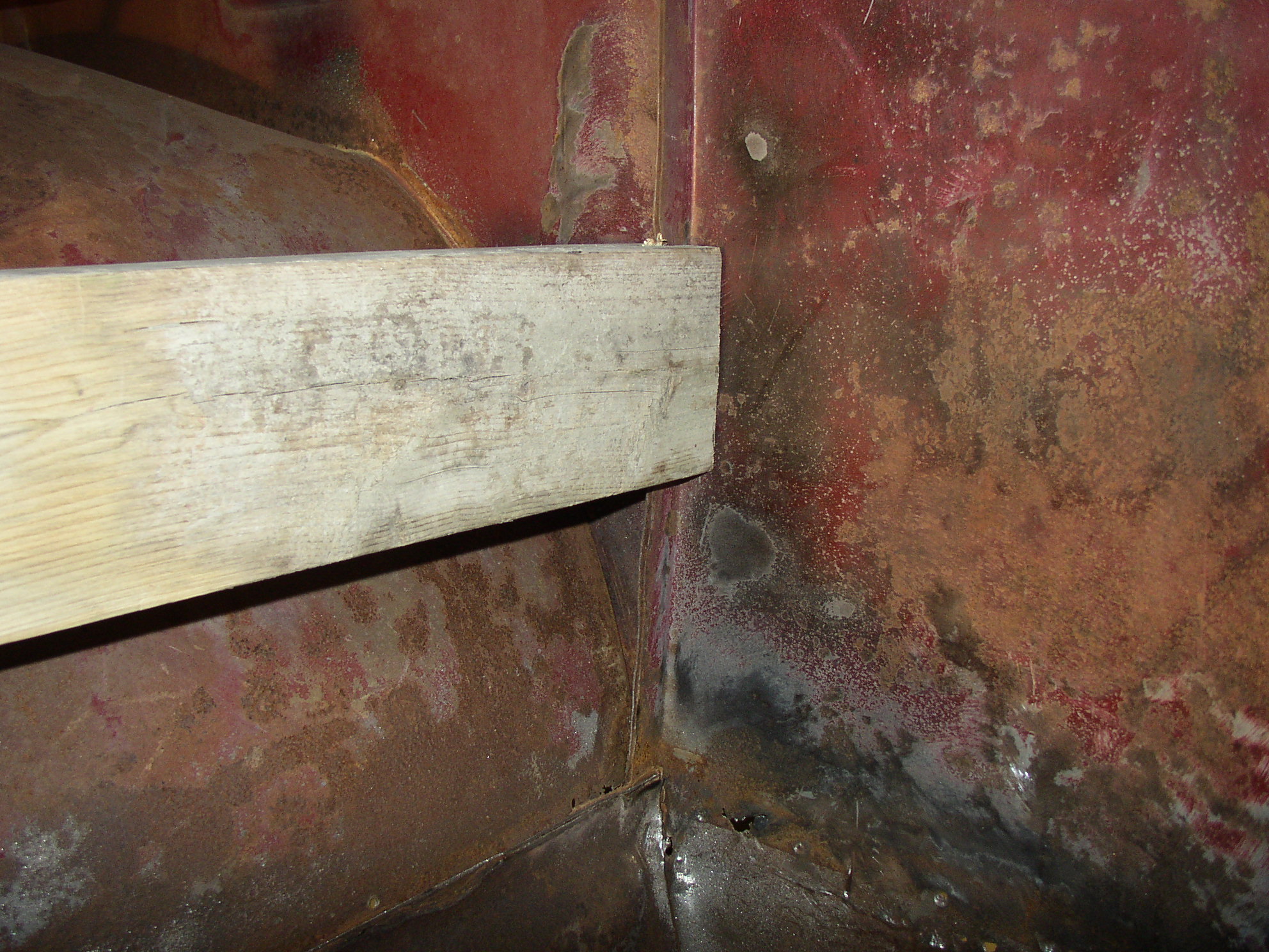

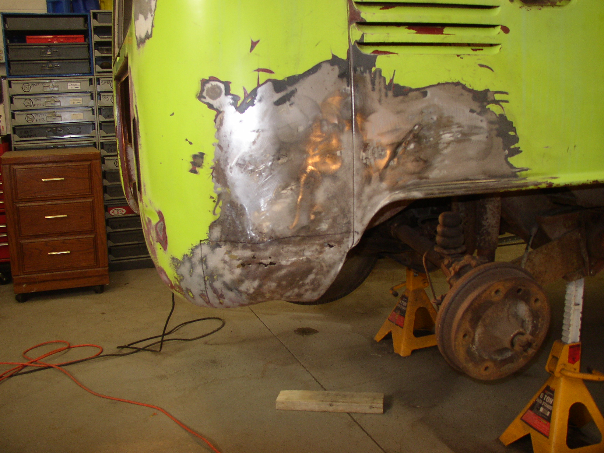

Onto the right rear corner. I still needed to push out some previous body damage, so a 2x4 with a slot cut in the end worked well for pushing right on the seam where the metal was pushed in.
I put the 2x4 against the spot and "work" it with a hammer until it's flush. It was probably pushed in 5/8"-3/4" and filled with mud when I got it.

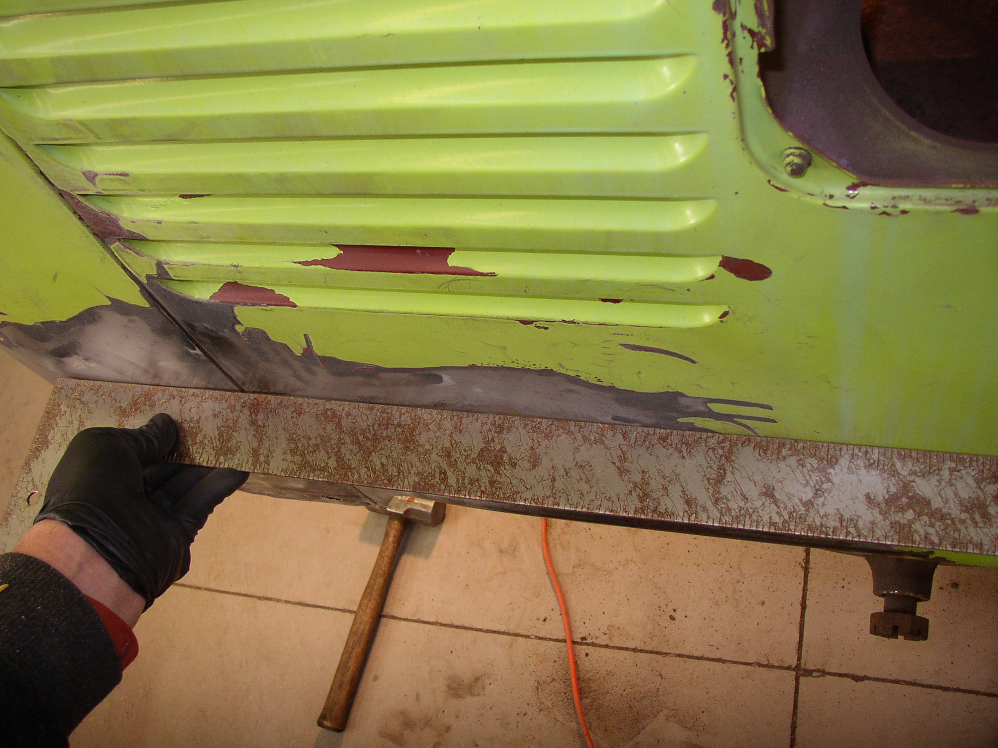

I commonly use a variety of straightedges to check my work 'cause my damn eyes are no good.
This one looks like a big gap, but it's really less than 1/8"
This bus is actually quite straight down the sides, even if you use a big long straightedge.
