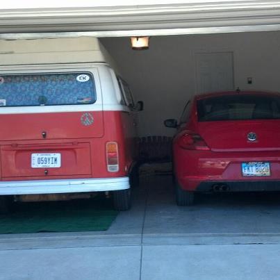

Post by Lizzie76 »
AMAZING!!!! You're the best :D THANK YOU THANK YOU THANK YOU :D
And she is right where she belongs :P
