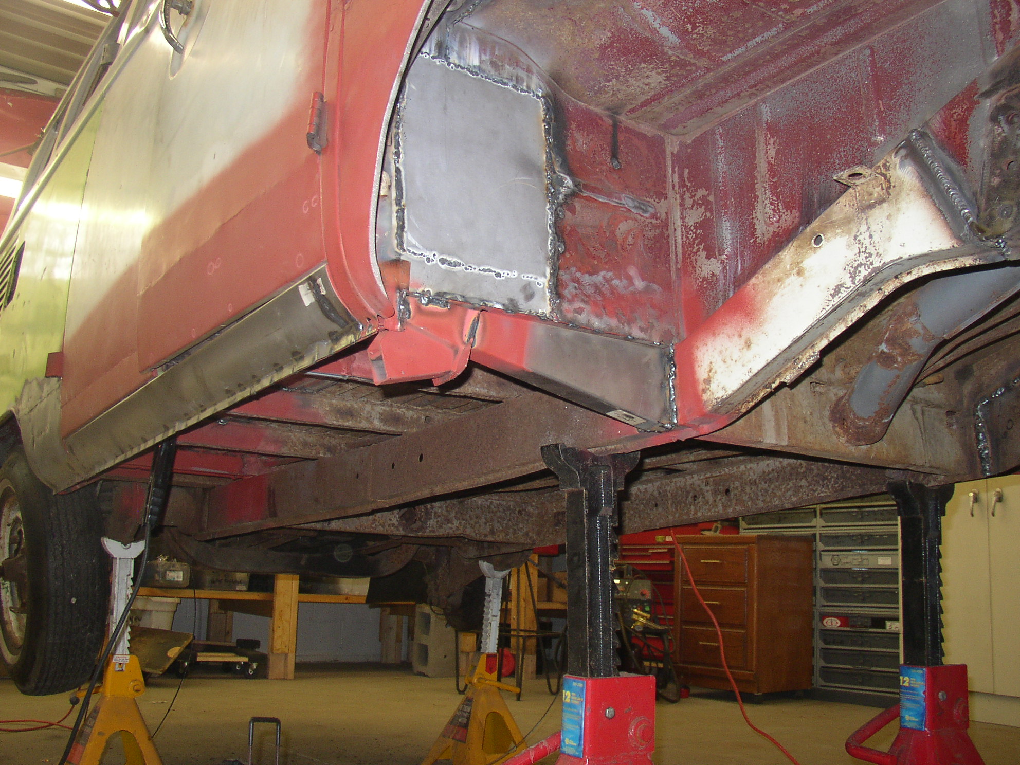

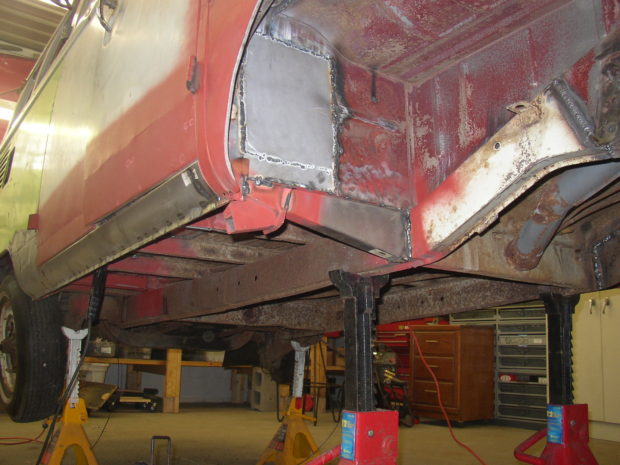

The concrete block under the nose has an adjustable jackstand on it (house style) and is only holding maybe 50-100lbs so when I cut the frame out nothing sags. The nose of that bus is so light gutted it's not even funny. I'm sure I could grunt it up in the air from below if needed. It wiggles dangerously on the stands, so much I have a safety chain going through the windows to the beam overhead just "in case".

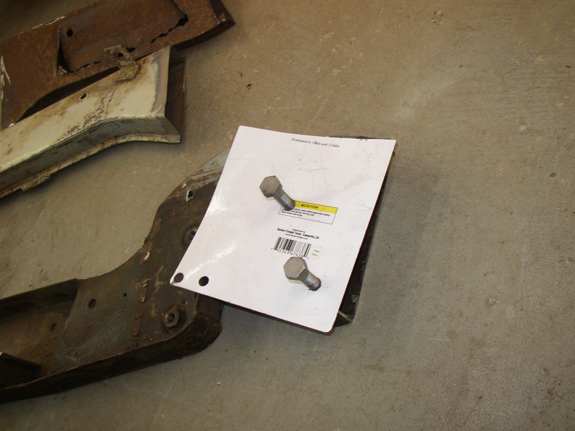

I made a cardboard template using a gasket hole punch that fit tight onto the axle bolts.
This enabled me to make an exact line on the outboard face of the bad piece to cut on, the same line on the good piece to cut on.
It works on both front side and back side of the piece 'cause I chased the threads all the way through.
This is the $hit. I used the cardboard template to scratch a line into the rail that is my working line. Then I cut it just a hair big and grind it back to the line (plus a bit for error).

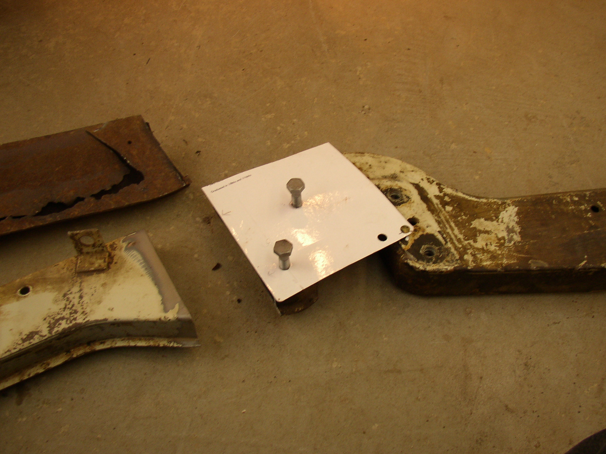

The good piece and the bad piece ready to go in. I cut it open to see how bad the rot was while it was still on the bus. There's a British co that sells a frame repair panel that might have worked here, but it was easier and more reassuring to buy the whole frigging rail from the States, and the same money.
Does anyone know what that big bracket is that was cut off the "new" rail? It was from a '63, and both sides have that big heavy bracket cut off them.

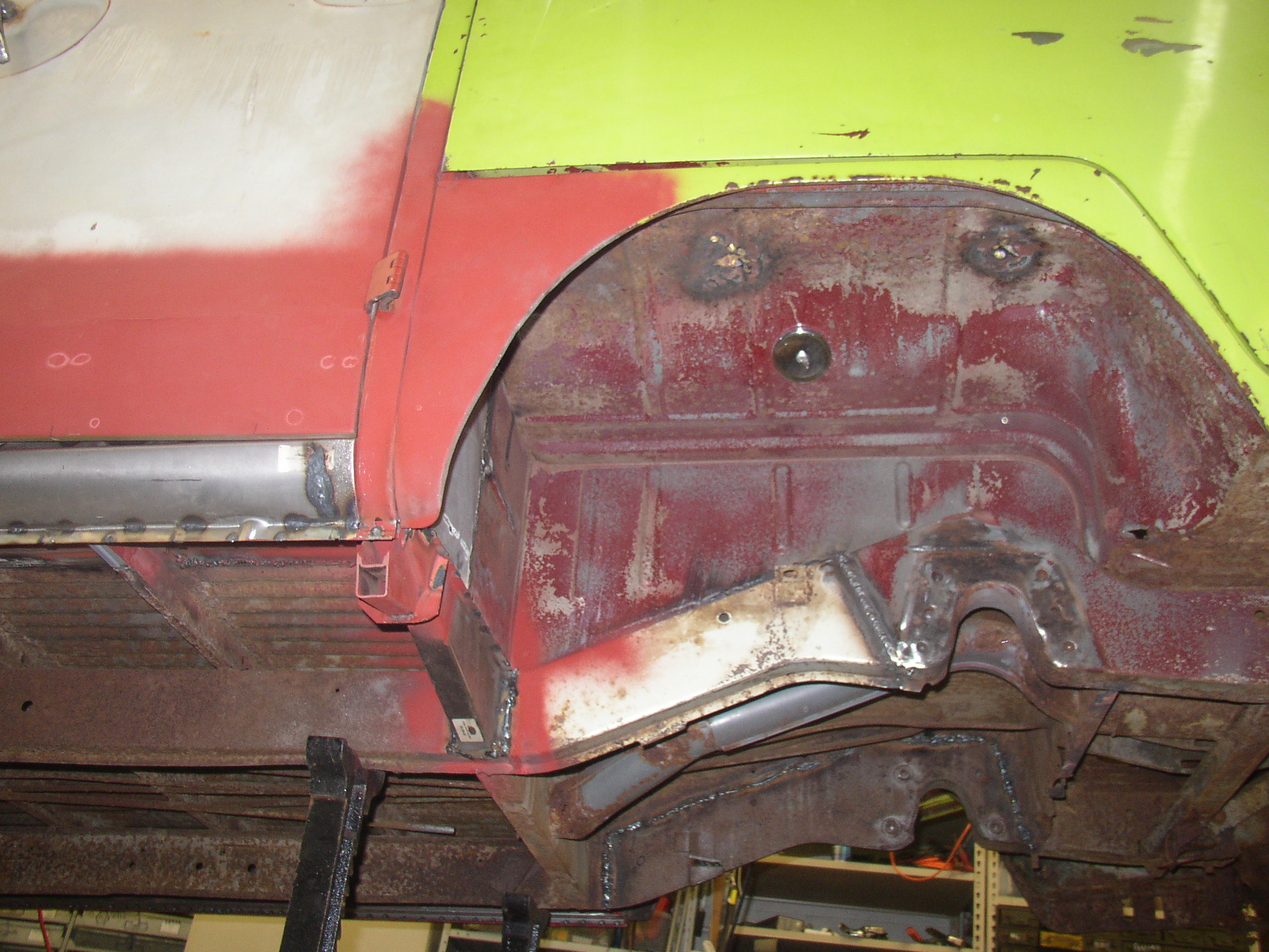

Now that's done I can put my outriggers and jackpoints on that I bought a while ago from Tom. They are nice and beefy, it's easy to weld heavy $hit. I shot them with some weld-thru primer first.
I'd rather do ten frames than one rocker!

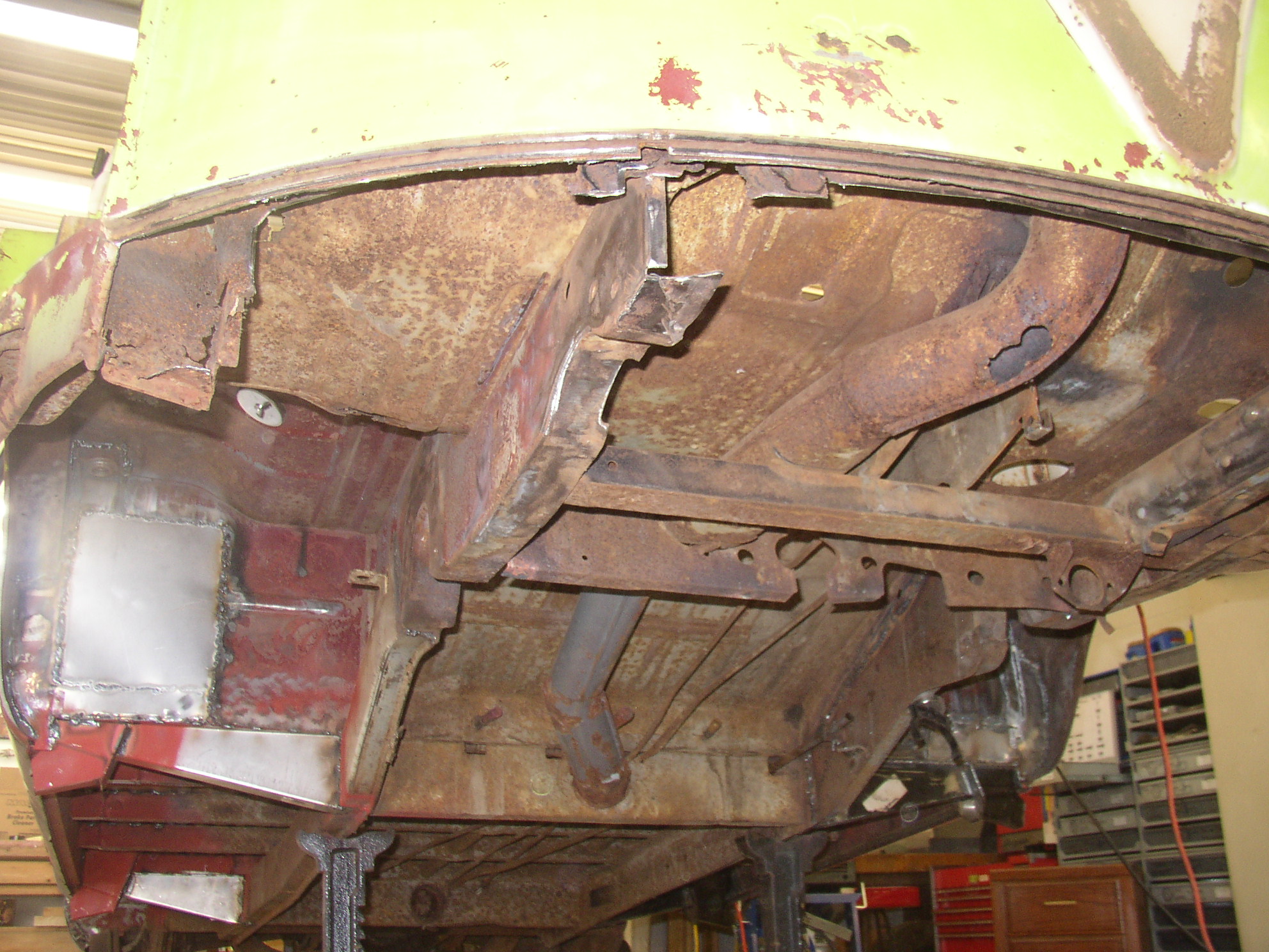

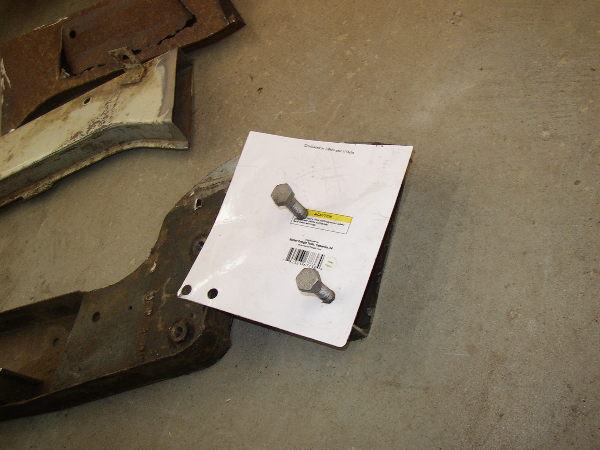

Next more outriggers and jackpoints, then on to the front right floor, which will be completely replaced along with A pillar repair panels. The left front floor is surprisingly strong with only a small patch needed. Then the front apron/valance, both inner and outer, which looks like a chore. I'm probably 3/4 of the way through the welding right now. Each left and right framerail took about 5-6 hours to do, I have about 170-180 hours total in the bus right now which is mostly welding but includes stripping the interior and glass, etc. At about the 250 hour mark I'll switch from being a hack welder to being a hack bodyman. I've barely touched Bondo in 10-12 years.......
