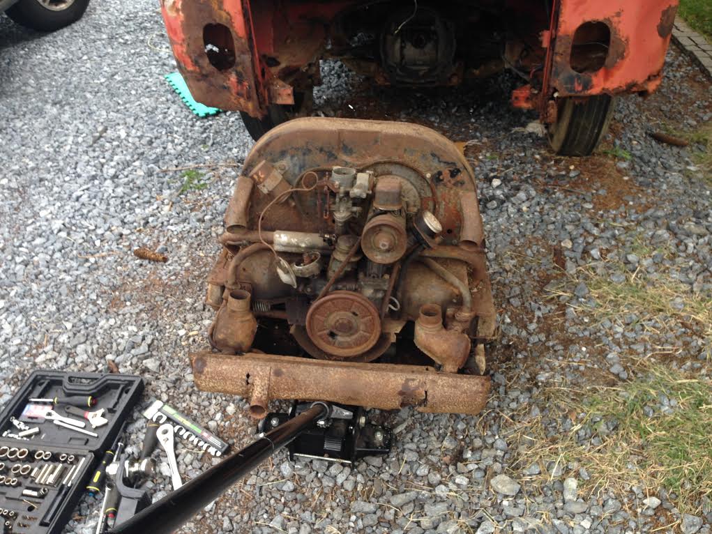

pulled out the engine,will be taking it into the shop this saturday for some very serious and much needed work :D

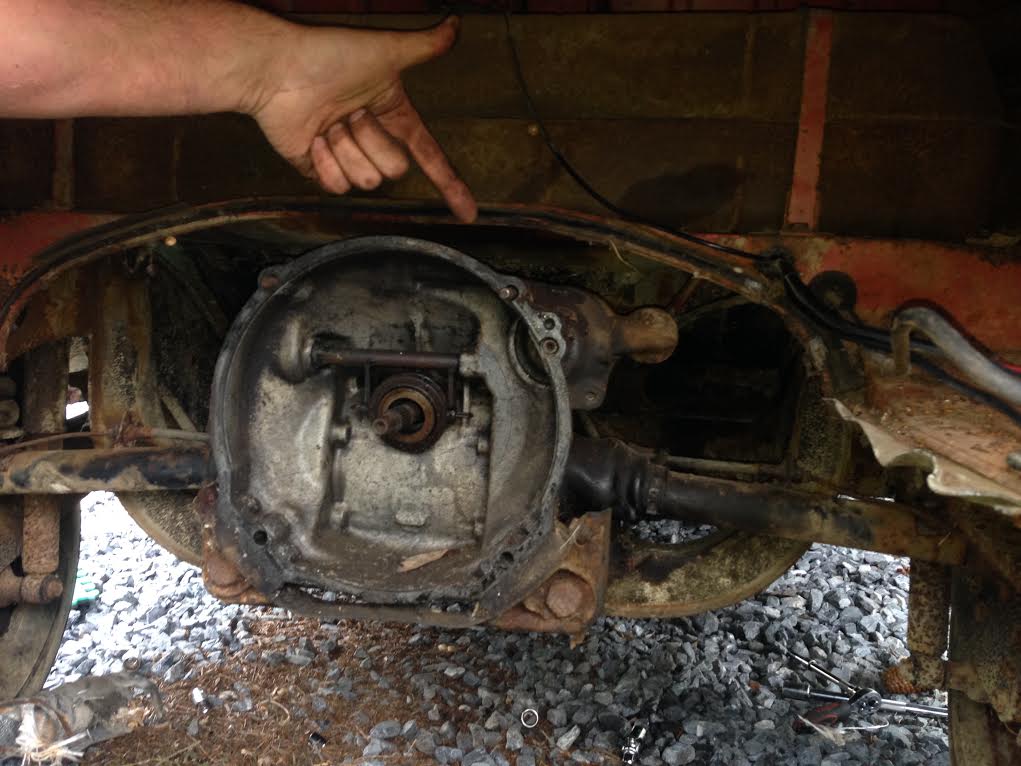

i accidentally stripped the nut that i have my buddy pointing to directly behind the case, so i had to get on my knees with a pair of vice-grips for an extra couple hours, while he sat underneath holding the bolt still... smh, at least that's over with.

Nice job. Is that a 40 HP? Is it locked up? Are you pulling the trans too?
Re: New member!
if its 40hp get rid of it...
Its too dangerous to drive your bus with one of those installed

The long bolt through the started should be a D head bolt, part number 111-199-101. It is 10x1.5mm.

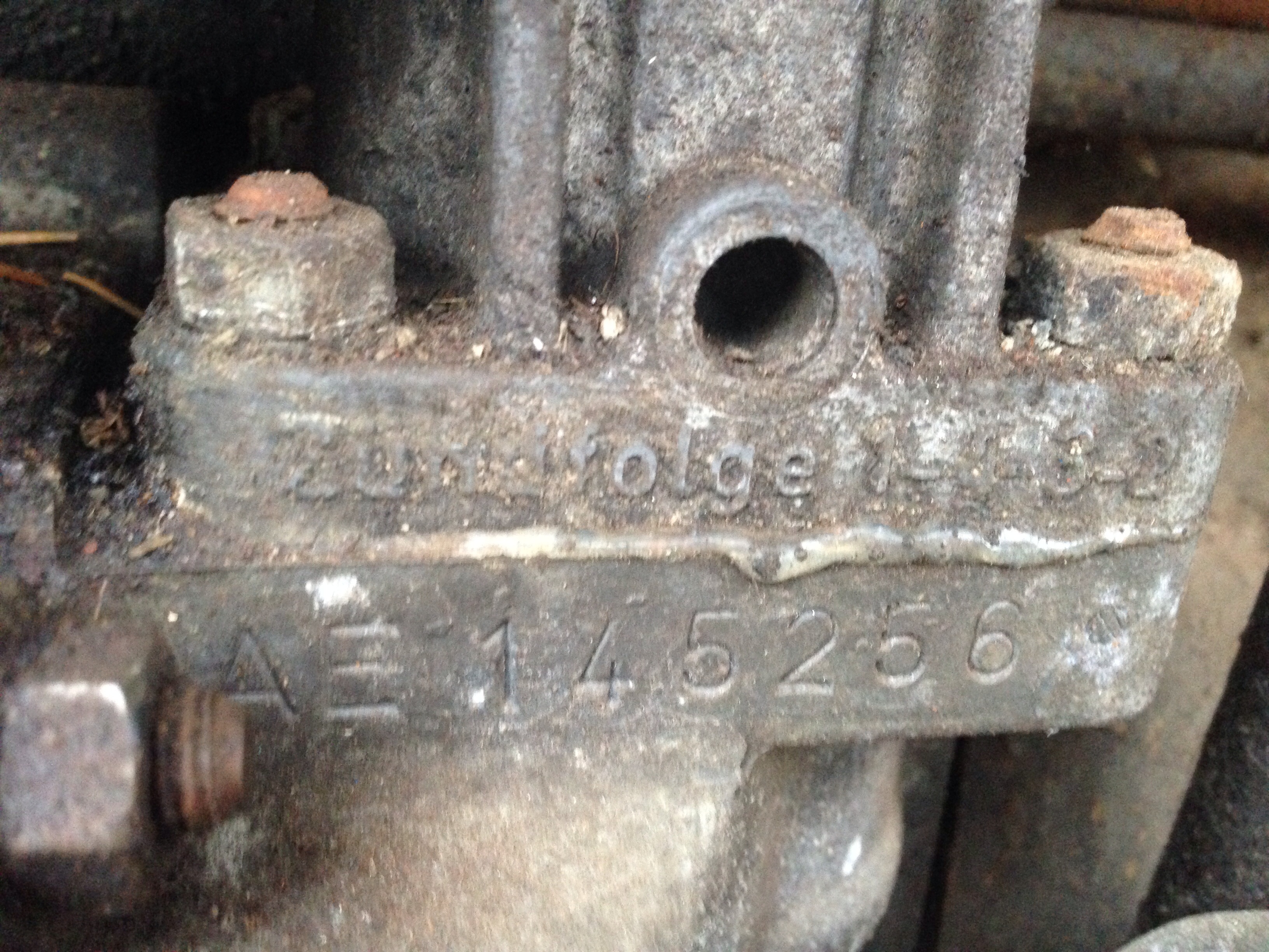

I was told it was original to the bus and was a 1500cc but I'm not sure the horsepower- I would guess 40hp. I just posted the code and according to the samba it's a 1971? Any help or ideas would be appreciated. My bus is an early 1965, so maybe they replaced the engine? I'm not sure.
Also Sean, the engine is not locked up surprisingly! It turns freely but when I drained the line there was nothing in it, same with oil. But I don't know the real condition until I start taking it apart.
http://www.thesamba.com/vw/archives/inf ... etters.php
Not sure what it is?
