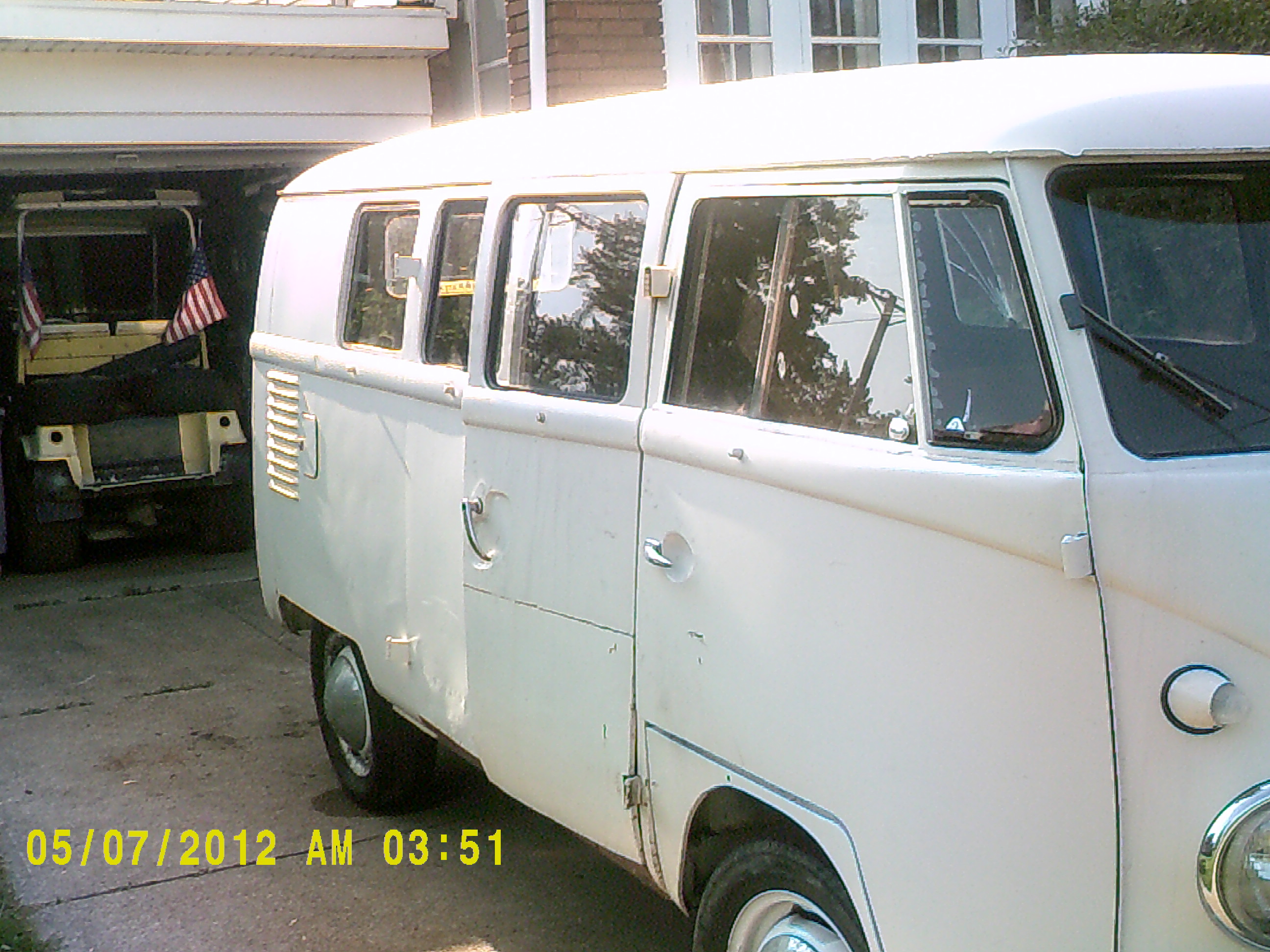

here is the van at time of purchase.
ignore the date stamps on the photos...they are wrong....technology scares me or I would change the settings on the camera.

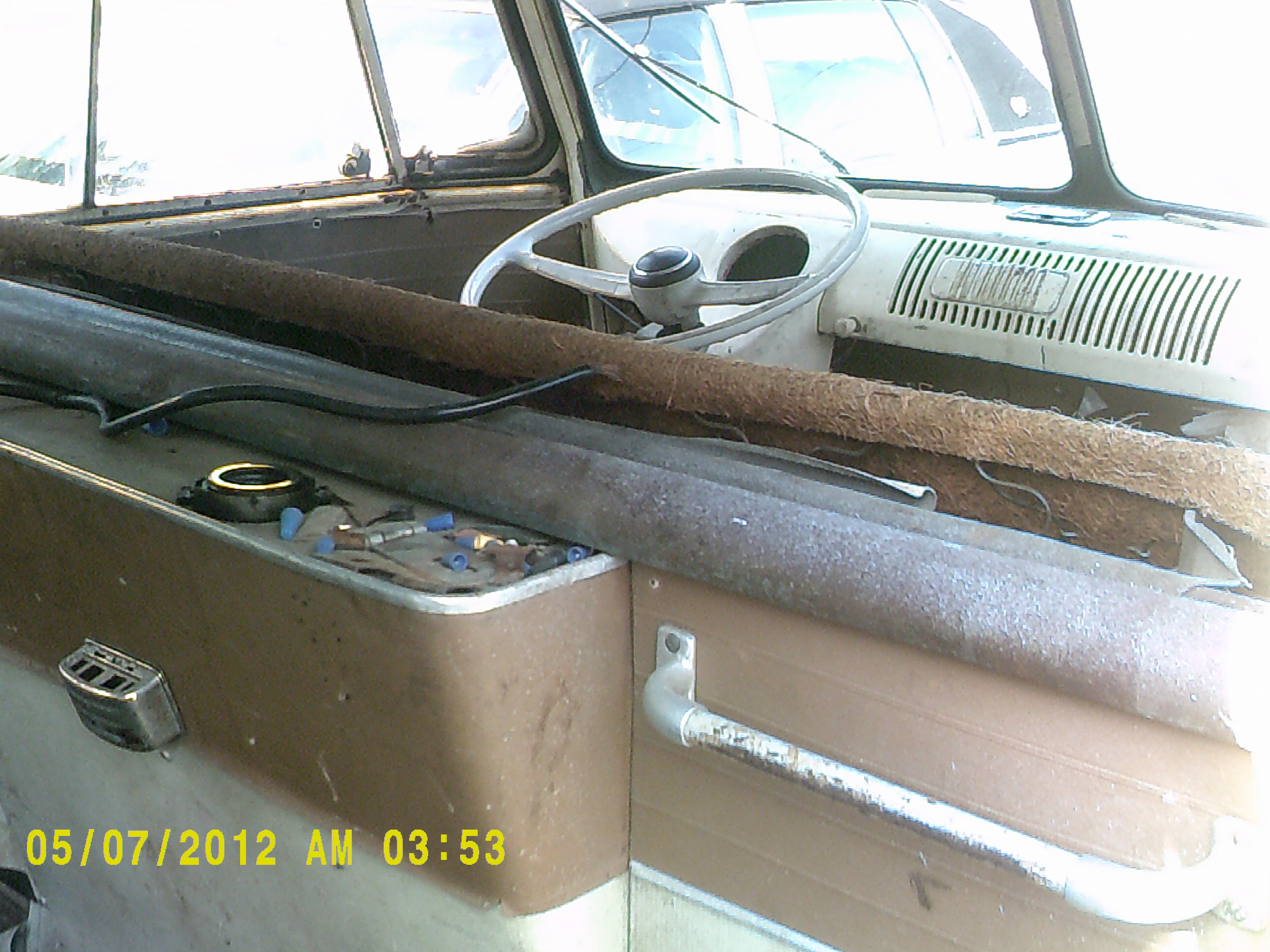

front interior
There is a lot of sheet metal to do, then on to mechanicals

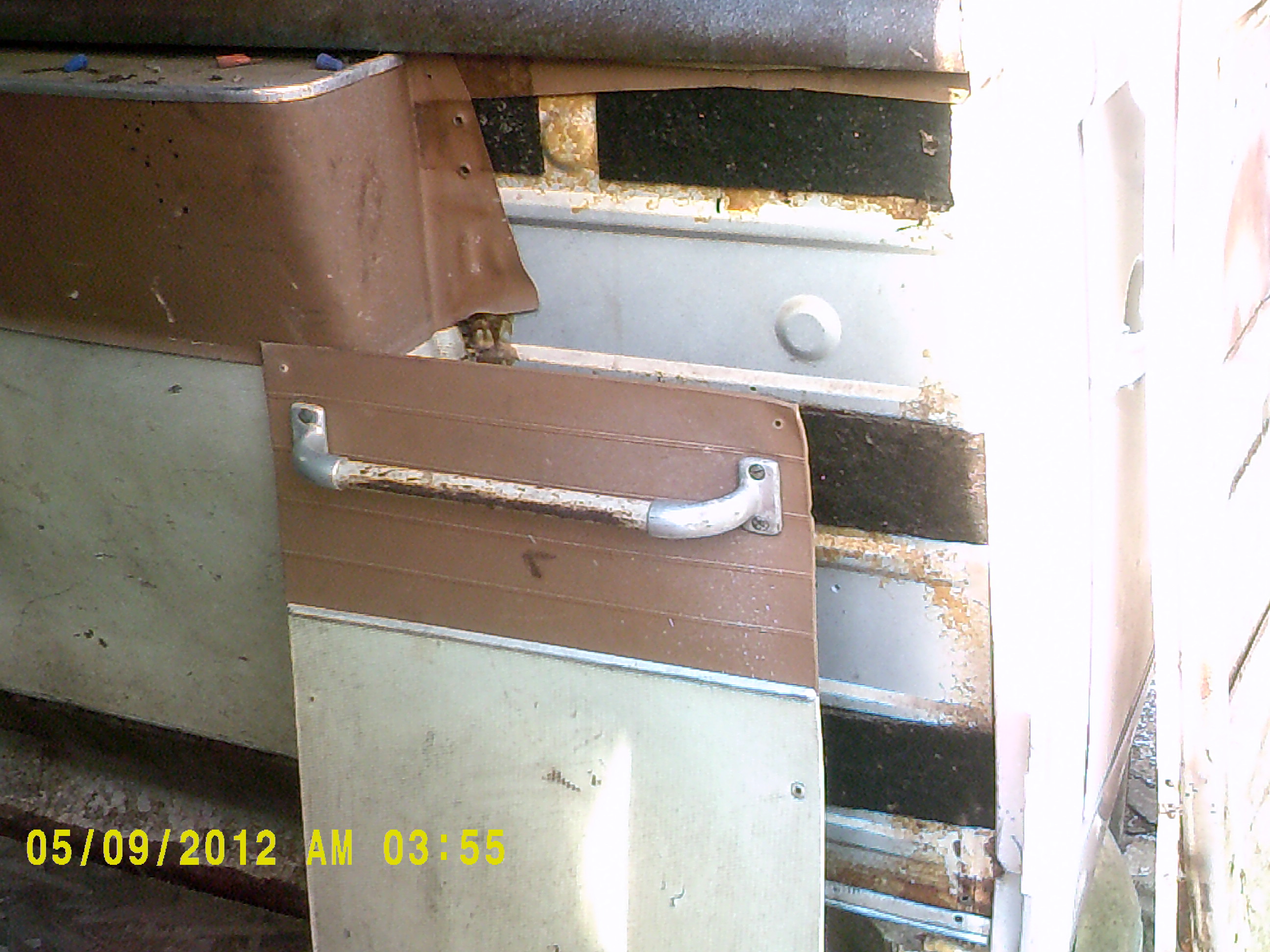

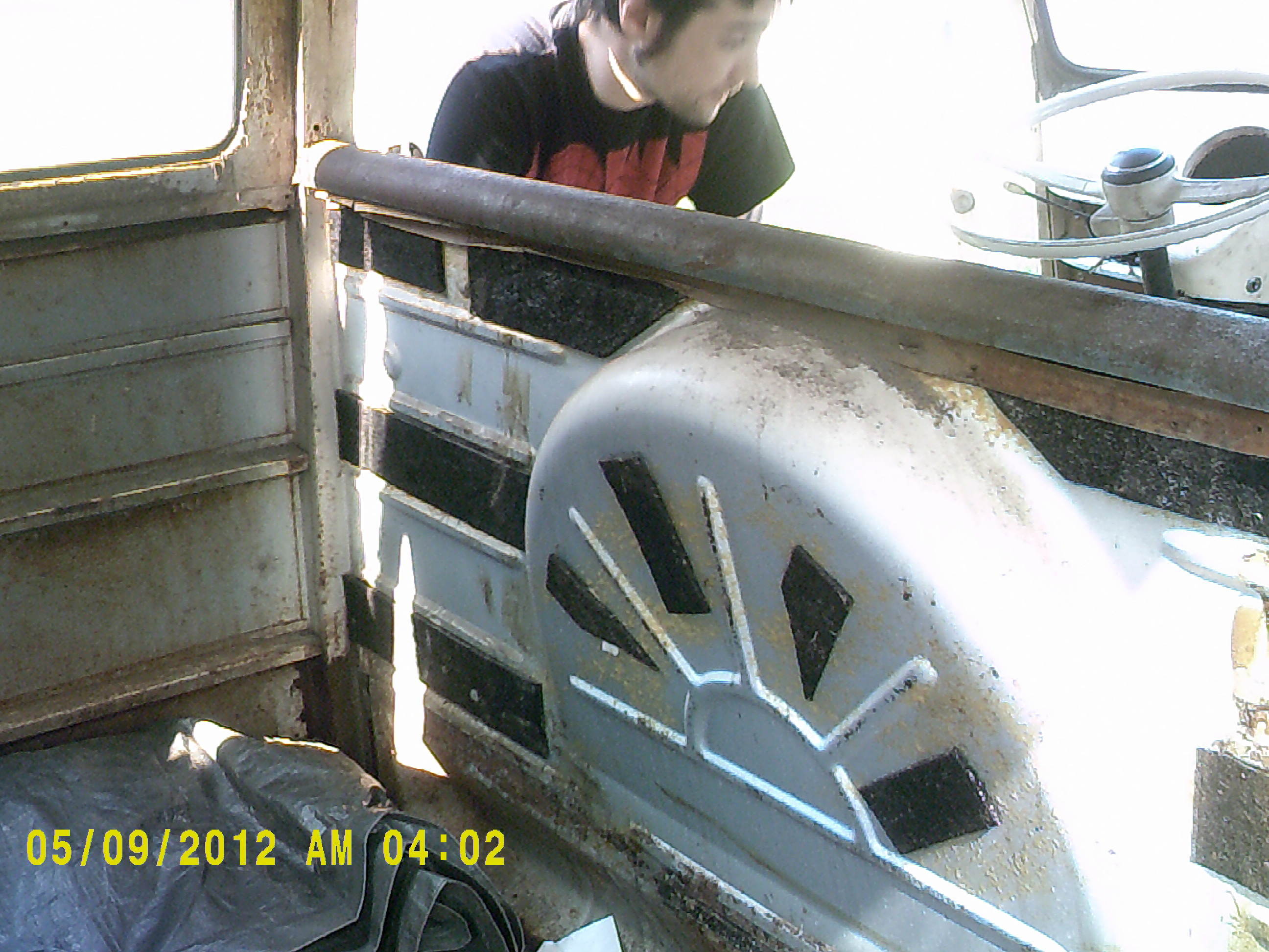

The Interior panels have been stripped out, bagged, tagged, and put into deep storage. I never throw away anything I find in the vehicles, no matter how crappy or garbage like it appears.
this weekend I plan on getting the rest of the top hat sections in, the out riggers on, the jack points on, the B pillar sorted out, and the bottom radius pillars on the long rocker side welded in. I would also like to get the long rocker and cargo does squared away if time permits. I will have to order a rear cargo door inner, but the other parts are already here. Then I can start on the cargo floor.

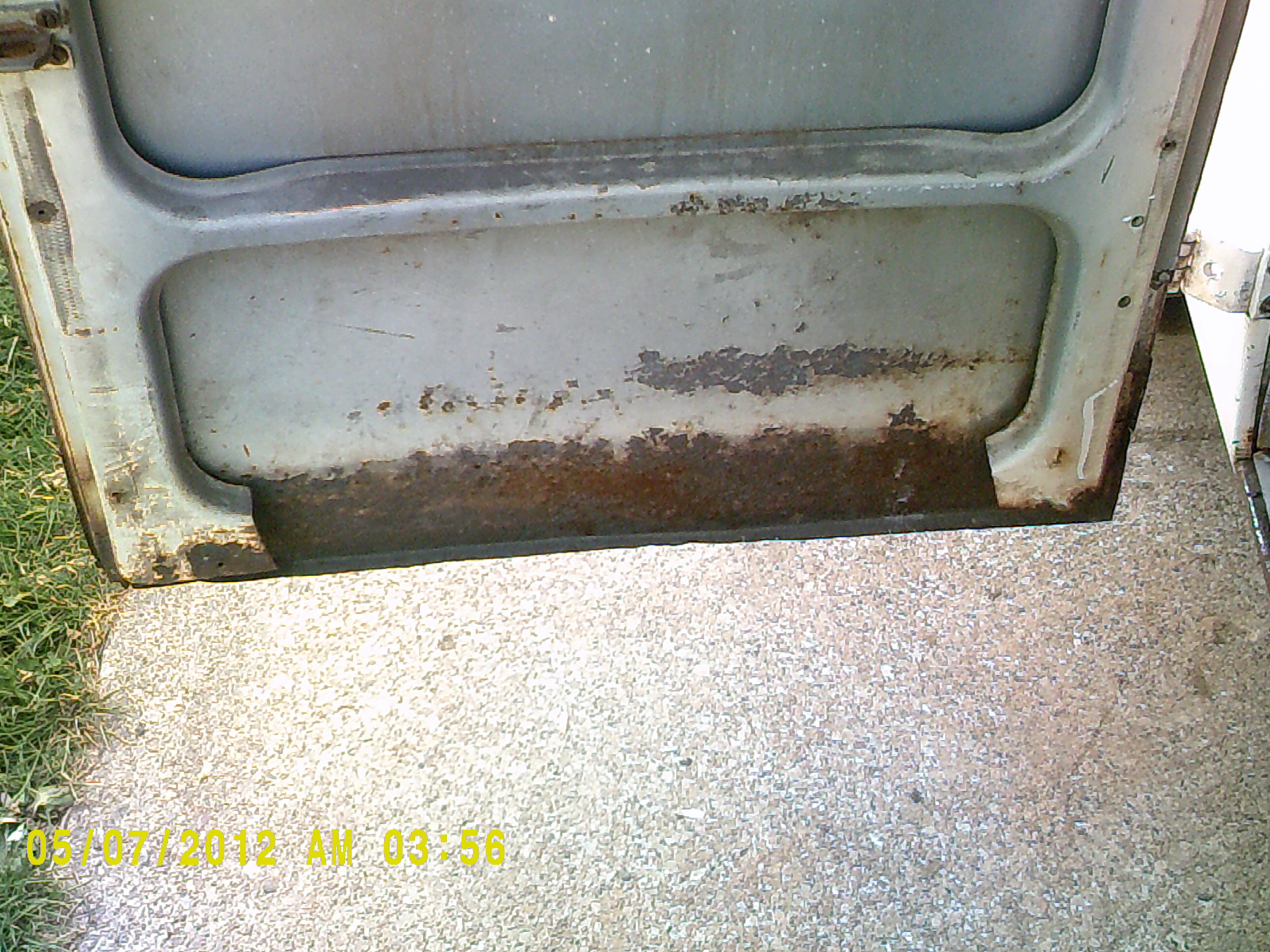

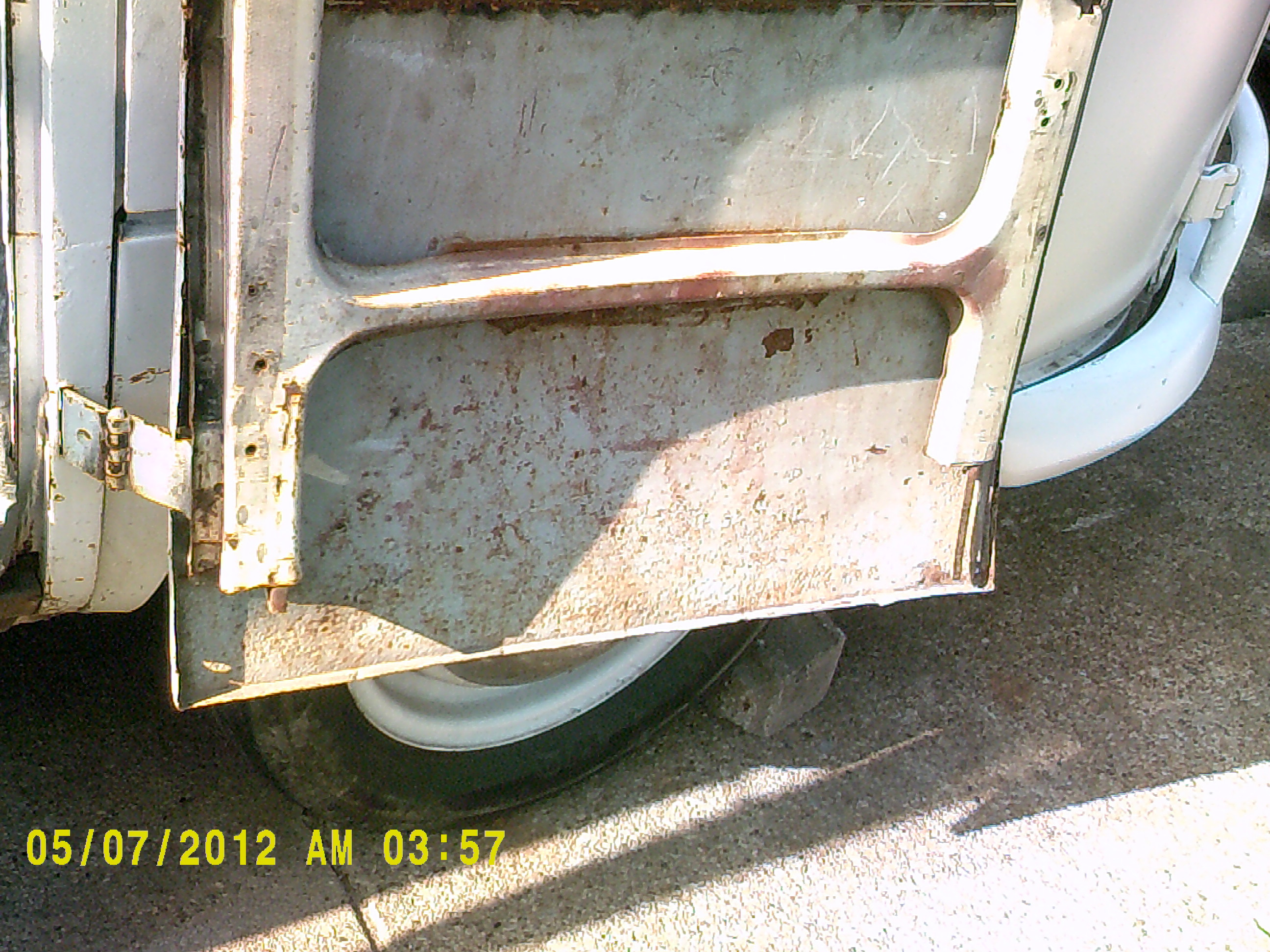

rear cargo door. still need to order this piece
Have this inner piece, B pillar needs some lovin' below the hinge
Interior panels coming off, every last piece is catalogued, wrapped in plastic, and put in storage
Panels gone, my brother in picture has been a big help with everything

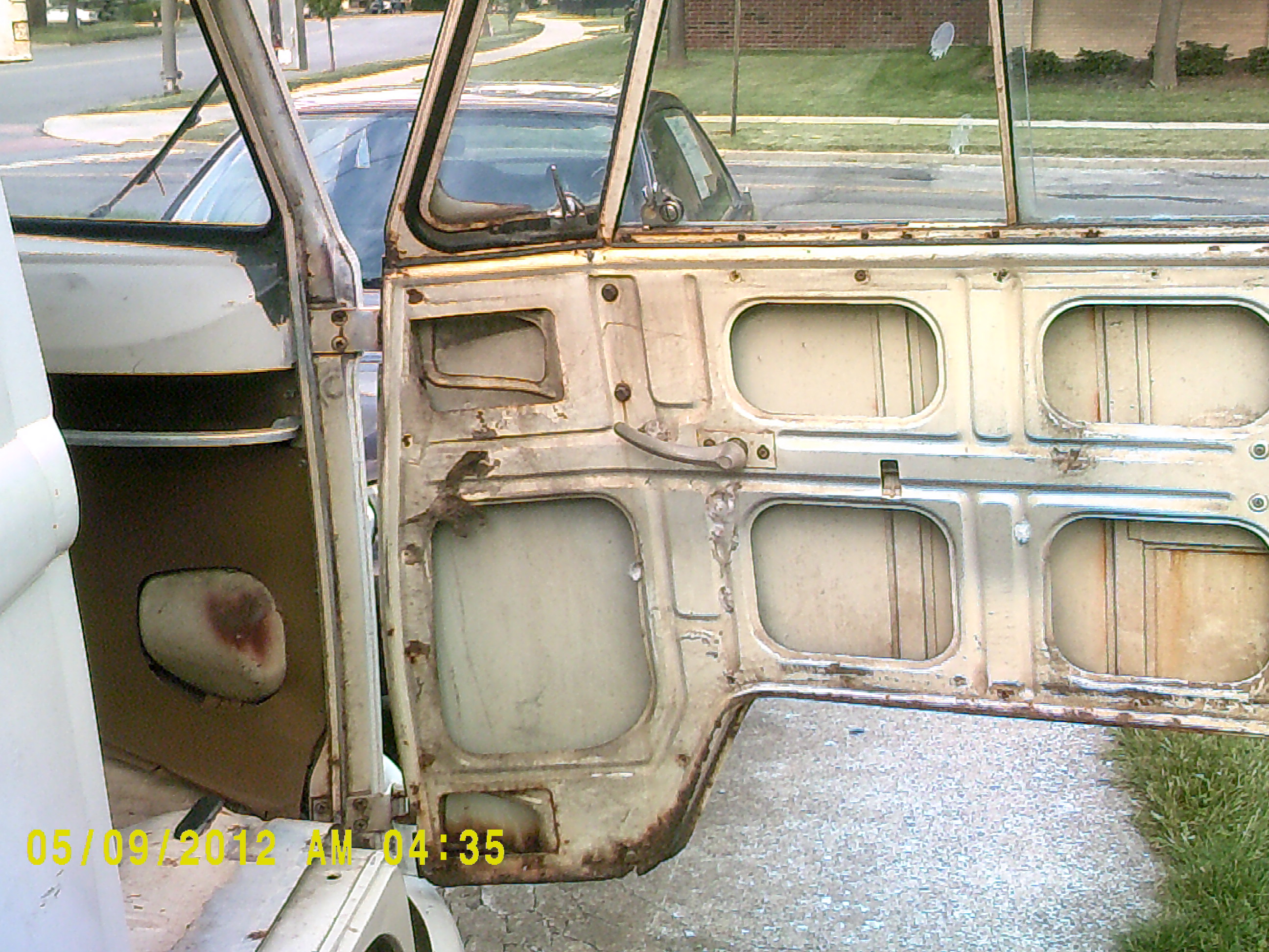

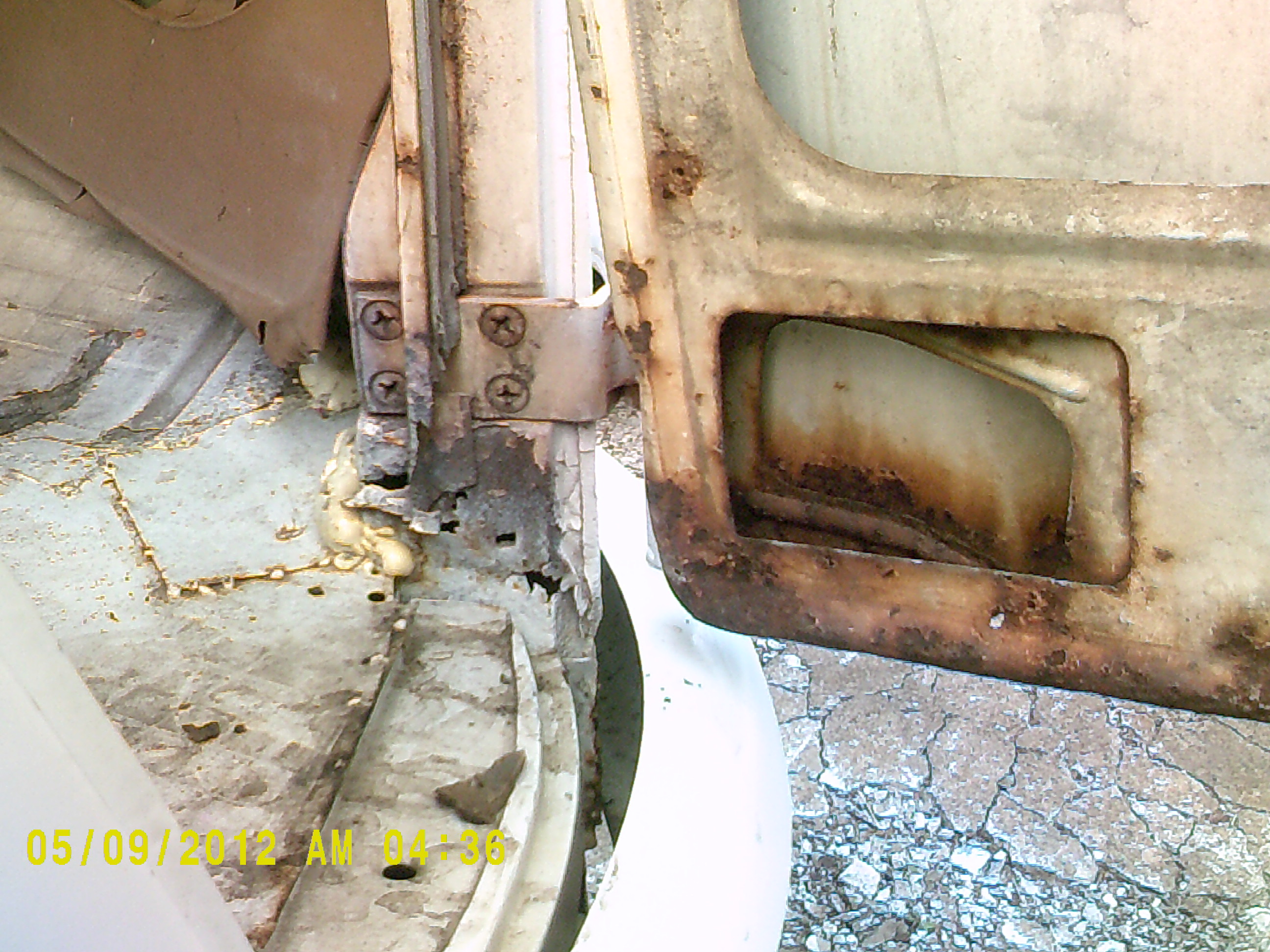

door skins off, forgot how hard these can be, definitely a 2 person and clean sock job

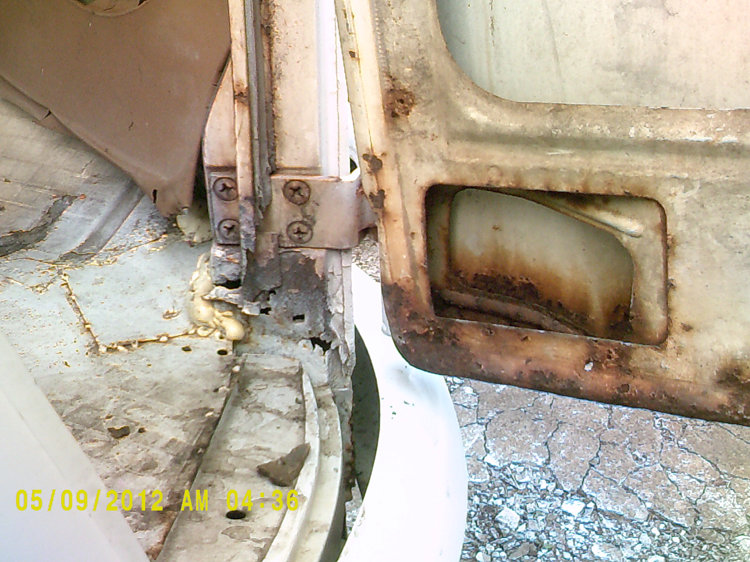

Re: 1961 Microbus
with the door skins off, you can see that I will need new lower inners and door skins on both doors, as well as A pillars below the hinge
also need to address the front floor, as the previous repair is not so much
