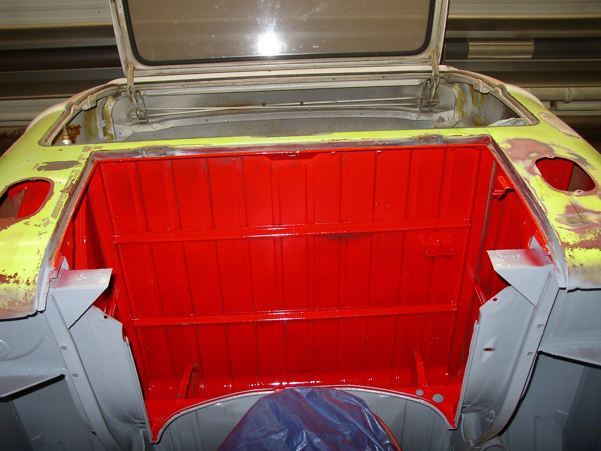

I prepped and painted the engine compartment. It's not quite this orangy, I think the camera is fooling us. I'm glad the safety chain was there when I was putting the tranny in, cause I could have easily knocked it off of the stands. The shell is as light as a feather when it's empty.
Probably at about 260 hours right now. I really want to get going on the outside bodywork but I figgered I better get the underneath stuff done first, as it's not wise to do that with fresh paint outside.
