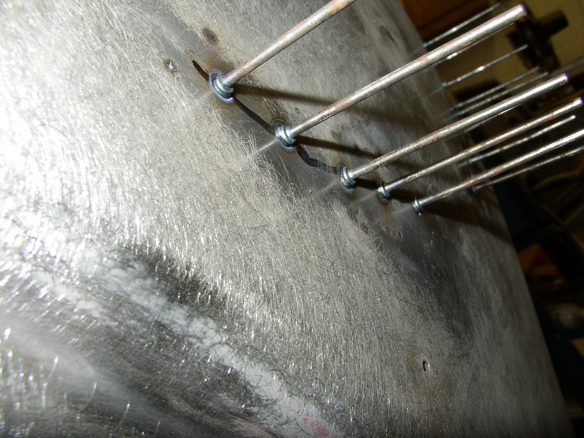

Well, here’s what we’ve been up to. Bodywork is a slow process, sometimes with many hours invested and not much to look at, that’s where the bus is right now. I’ve been spending nearly every day in the shop and Chuck has been there several nights as well, we've made considerable progress but not that shows up in photos.
I did use a stud gun to pull several minor dents out of the nose of the bus. This is a cool tool- it welds a nail to the skin, which allows you to pull the dent out when there is no access to the rear side. I'm thinking this dent is from someone bumping the front-mounted spare tire.
Once the nail is secured, a hand puller can be used to pull out the low spots along with a body hammer to lower the high areas around the dent.
If this is not successful, a slide hammer can be called in to provide more brute force.
The results were terrific- here’s a straight edge showing the dent is gone and the correct crown is back in the metal with only a super thin skim coat of filler needed. This one came out so well that high build primer might be all it needs. I use a straight edge as a cheat constantly because it's a lot better than my eyes or fingers.
All in all, the nose is looking really good. There were bunch of holes I welded up including those from a spare tire carrier, several minor dents including some that were right behind the bumper overriders, and other dents. This bus was pretty straight overall, with no major crash repair needed. The lower windshield frames were badly pitted from rot but the metal was still strong, so I sandblasted them very deeply and filled in the pits with epoxy gel. It wasn't bad enough to replace the metal and it came out great. You can see it a bit in this pic but I didn't zoom in on it.

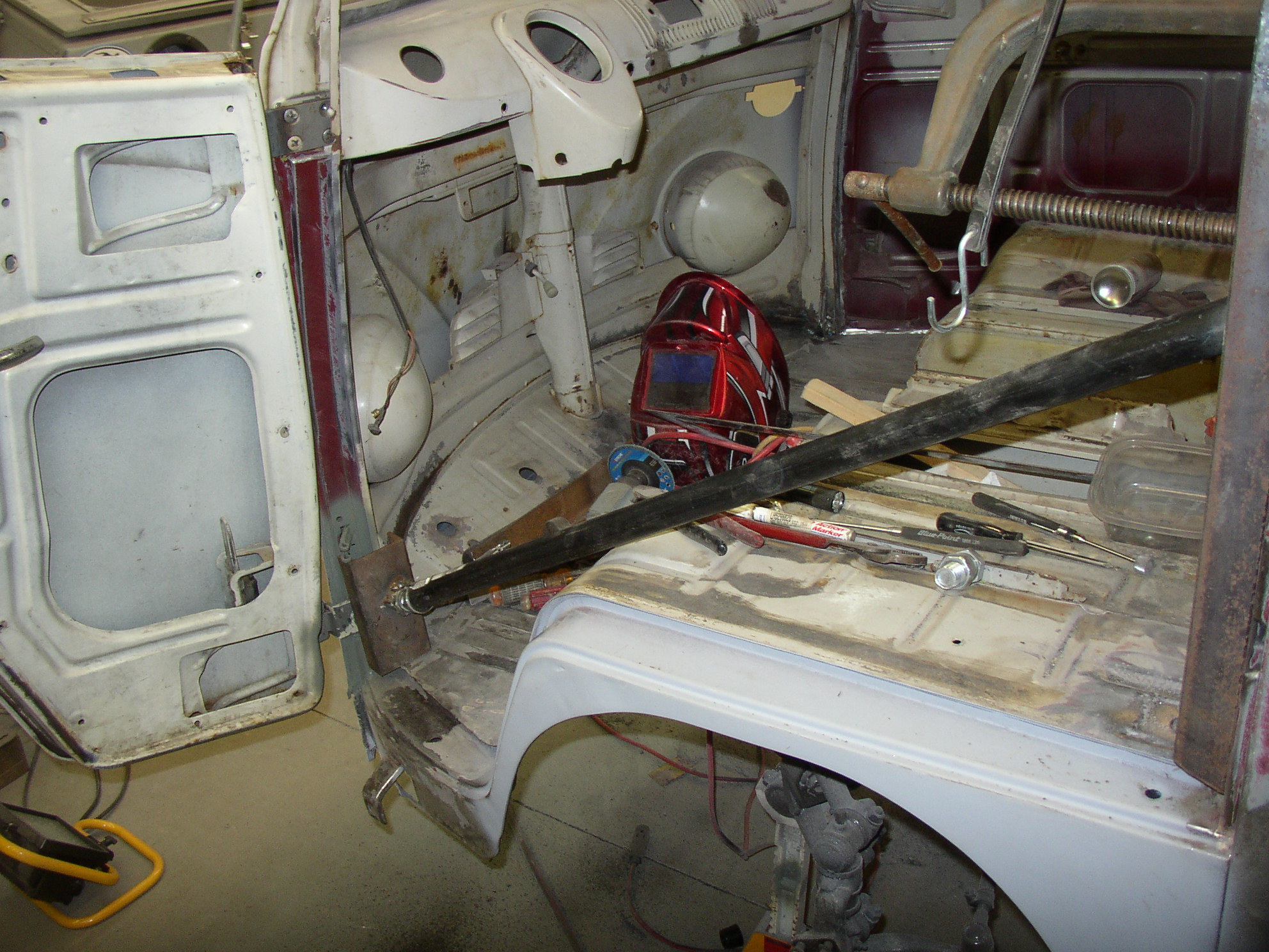

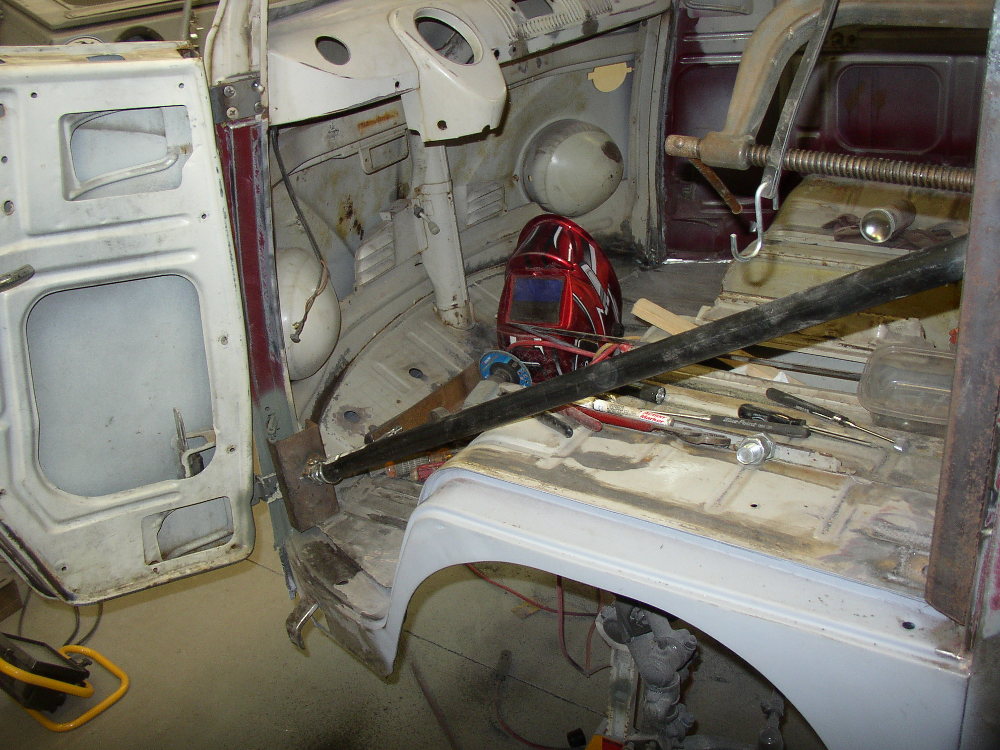

Well, my new door came in Greyhound and it's "pretty good" but not perfect. It has virtually no rust- some surface rust on the lower inside lip but not much, a wire wheel took it right off. It was hit in the lower center and has a spot of mud about 8” around in it, you can barely see the lines I drew with a pencil where the magnet showed mud. I wanted a 50 year old virgin, but I guess there's not many to be found. :cry: It came with nice deluxe trim and a hacked up window frame, but I didn't take pics before I removed them. The prior butcher bent the lower edge of the window frame out so he could pop the glass and hang his arm out the window. Brother.
It doesn't fit very good, not because of the door but because when this bus was tapped in the old driver's door it evidently pulled the A post rearward about 1/4", which is just enough to screw up the door gaps. Evidently it had a "custom one off" driver's door on it before, because it fit and worked perfect.
I did get it hung and after heating and bending the hinges it fits OK, but not perfect.
Right now it looks like it's too far forward, but in reality it's centered. The problem is the lower front gap is 1/32" and the rear lower gap is 1/8", when combined they should be much more than that, like 3/8" or something.
I'll sleep on this and decide whether to break out the PortoPower to fix the door gap. Hmmmmmmm....
