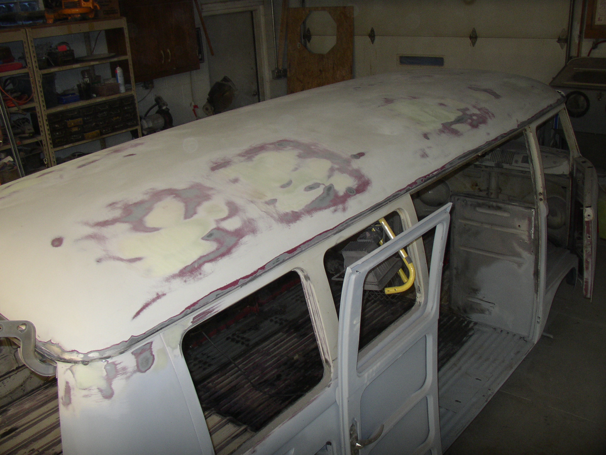

I don't normally work weekends on the bus but today was an exception. I got a lot done, wirewheeling the window openings, welding up a CB antennal hole in the roof,
DAing and started wirewheeling the inside of the window openings and inside the roof. The glue isn't so bad, this should only be a few hours tops.

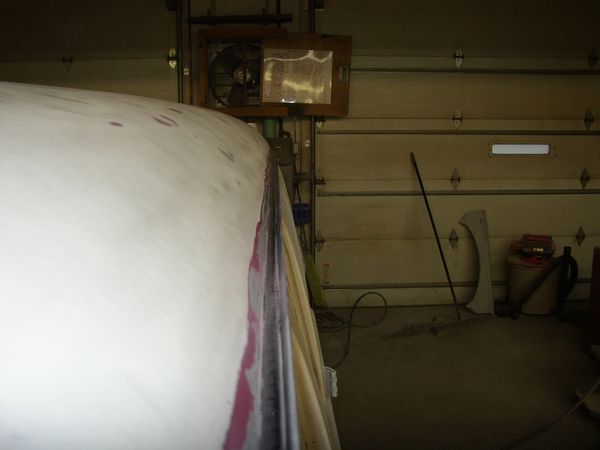

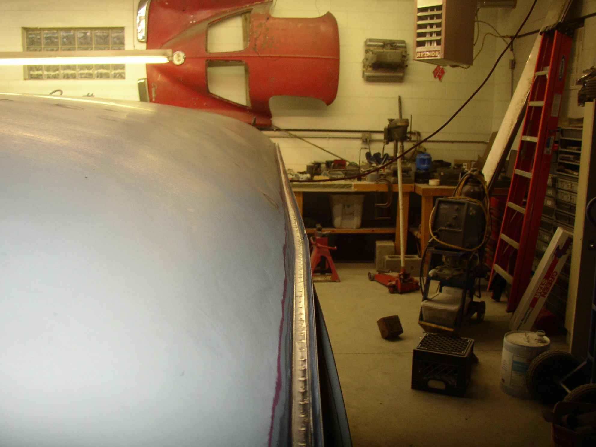

Here's a shot of the rain gutter after wirewheeling, this is one of the reasons I bought this bus. Pristine. Not even surface rust anywhere in the rain gutter and only a couple of insignificant surface spots anywhere on the roof at all.
Here we are at the end of the day after air filing the mud out a couple of times. Made good progress, the roof is just about ready for seam sealer and primer. :)
Anyone recommend an inexpensive seam sealer that sets up in a day or so? Many times the stuff I've used in the past takes weeks to harden. I know the body supply places have a two part that's like $40 or something, but that's kind of silly, I've heard of using a Home Depot product but I'm not sure which one.
