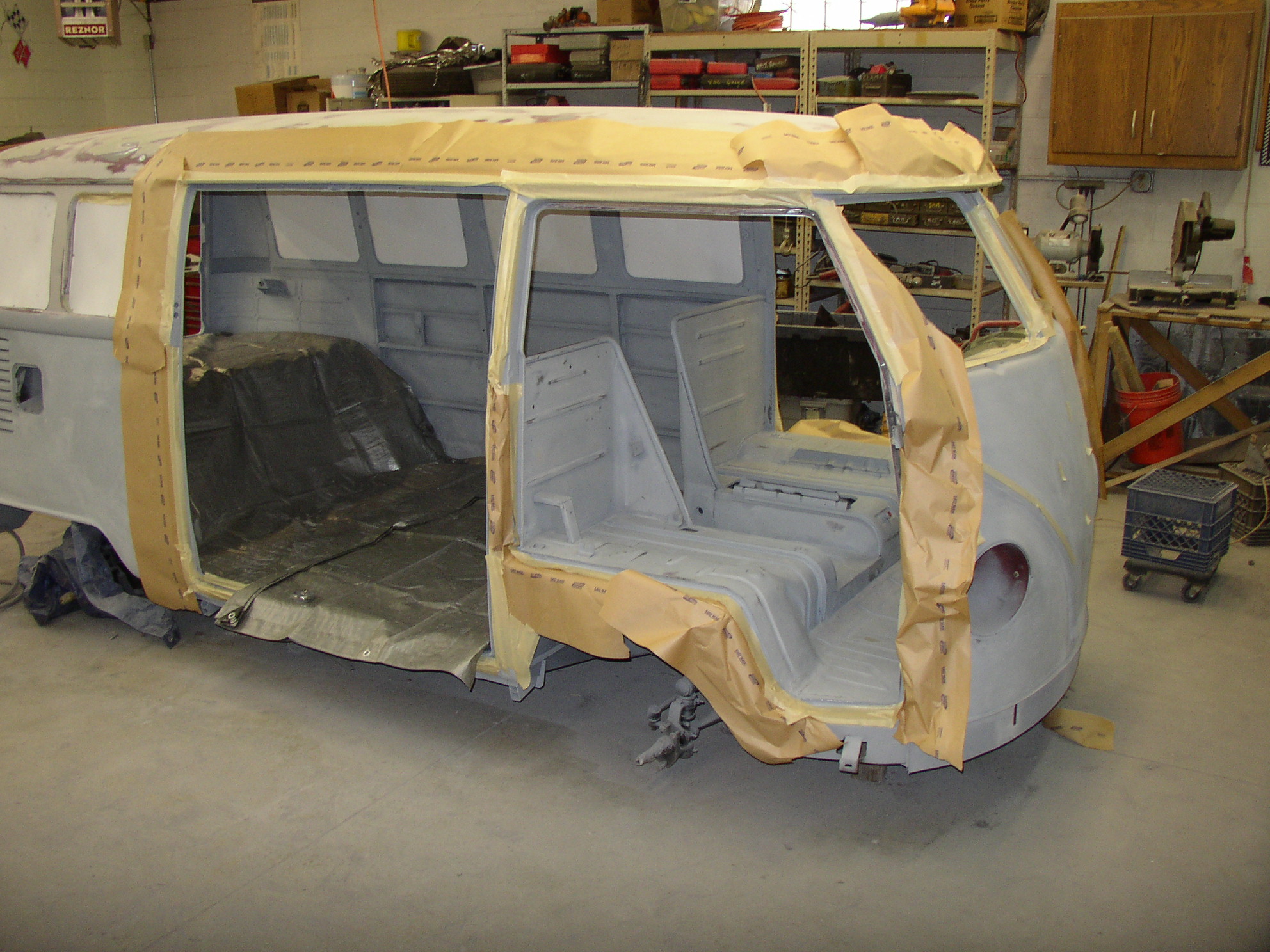

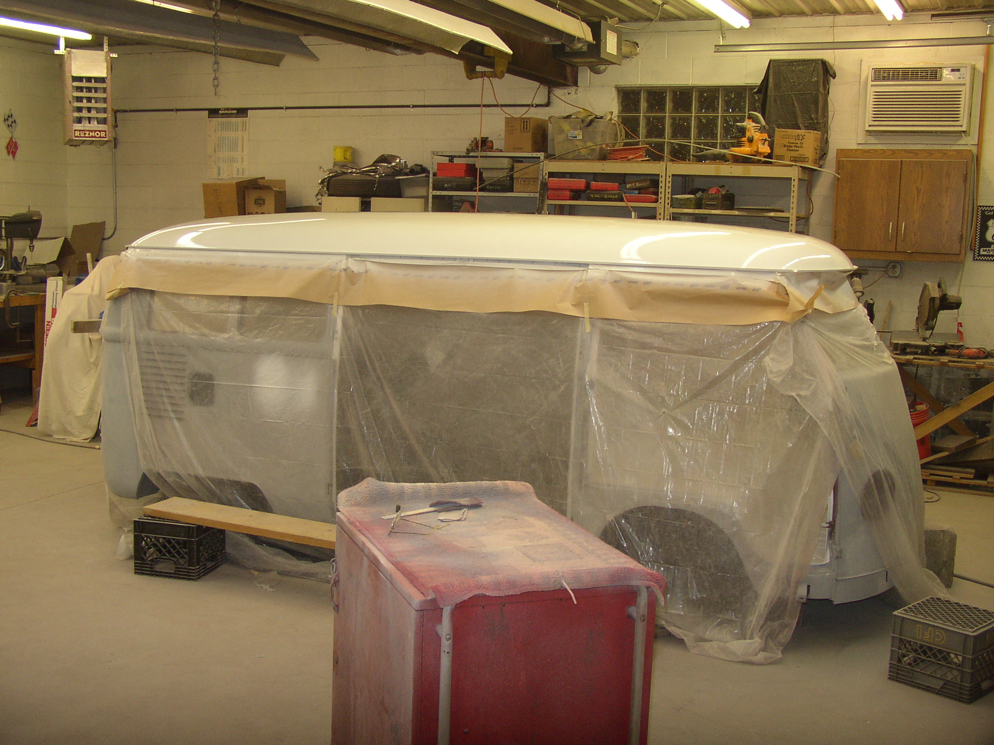

Finally got some time dedicated to the bus and got a lot done but not without a big hitch. Monday I finished prepping the interior with dabs of mud, weld and etc to fix all of those little things that show up in primer. I masked the bus and left the heat on warm all night so I could shoot yesterday on warm metal. I went in early (10 is early for me) looking forward to shooting the PPG DelFleet paint I bought a couple of months ago. I usually use the cheap stuff (Kirker) which I've had good luck with for decades but this time I was talked into the good stuff by a local authority (to be named later). I read the instruction sheet again and mixed the paint using a digital scale to exact gram measurements. The surface temp was 75ish with an IR gun when I started and shit went wrong from there in a big way. I was having no luck at all with this paint- thin, ran, wouldn't cover, wouldn't set up, I meant this shit was bad. It was like shooting milk from a spray gun. I called Chuck with a 'WTF am I doing wrong' tone of voice, he came right out and arrived at the conclusion I got a bad can of paint. Luckily I had 1.5 gallons of white Kirker in the cabinet, so I switched to that and had much better luck. All in all, a good day in the long run.

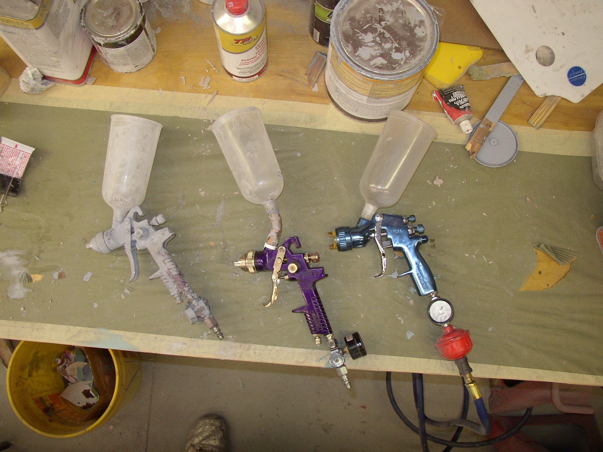

My arsenal- cheapie HF primer gun, another HF with a homemade 45* adapter for shooting inverted surfaces, and a DeVilbiss Finish Line gun. Not top shelf, but good.
Masked and tarped.
The idea is to shoot the inside of the roof with the 45* gun, then switch to the DeVilbiss gun and shoot the insides. Then pull the tarps and shoot the floor before finally unmasking the dashboard (to protect it from overspray and drips) and shoot it last. I also shot the white parts of the jambs so they will blend easier when shooting the exterior. I also did the funny "eyebrow" area over the windshields where the screens are as this will be tough later on.
Done and the dash came out nice, remember this was sectioned in from a radio job gone bad.
Chuck's help as a spotter (to see dry areas) was invaluable. Shooting the inside of a bus is quite difficult because of all the areas that can me missed.
