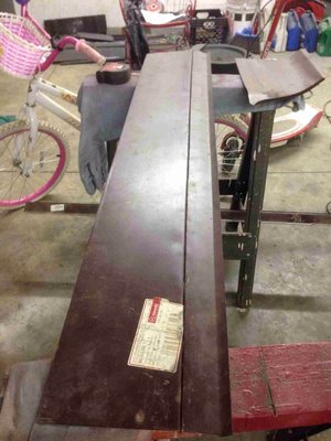

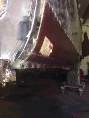

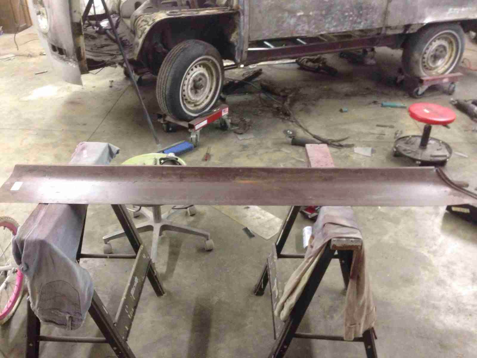

Re: 1971 Early Bay Panel
Then i did the long side rocker. The cheap panels do not have the seam in them so i made it by hand.
I cut it into two pieces and made 90 degree bends in it to create the seam.
Then i recreated the panel wall seams by using a chisel to offset the sheet steel. I cut those slots in it so it wouldn't bind when i bent the radius.
