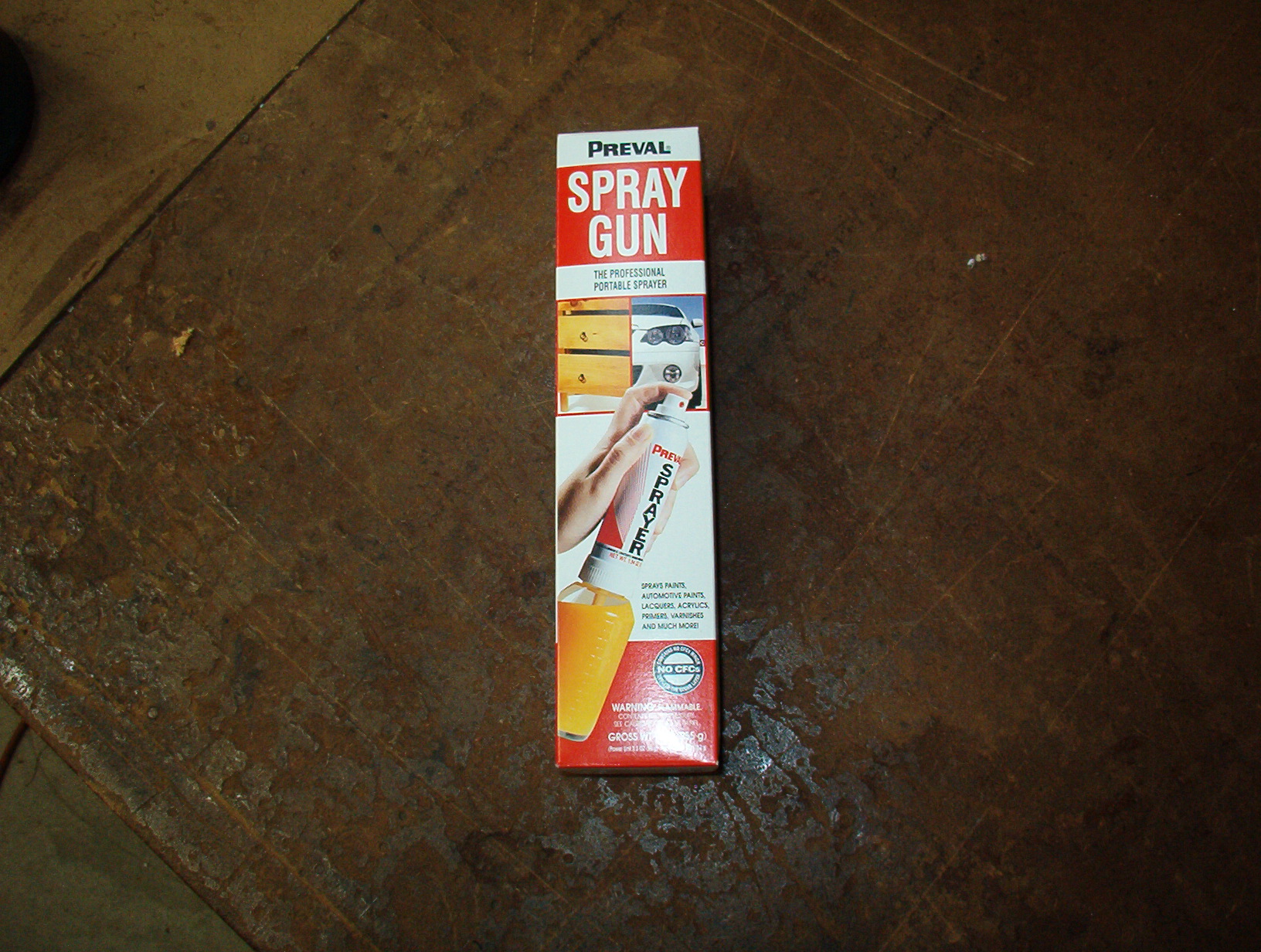

For the paint,instead of paying $20 a can. You could use this,available at most automotive paint supply stores. About $5. replacement aerosol is about $3. You can then have your paint mixed by the quart. Something any automotive paint supply shop can do.
