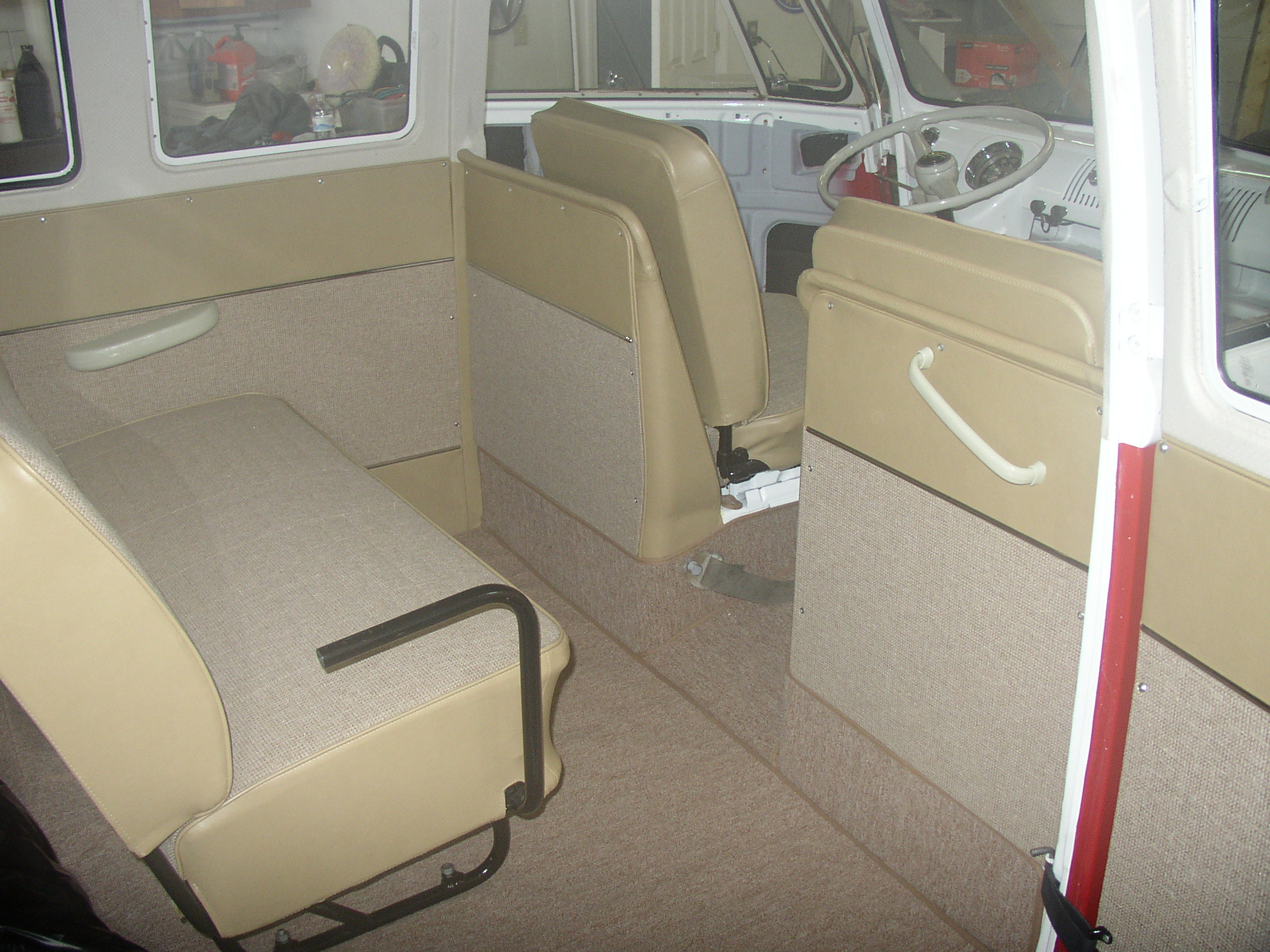

First of all a big thanks to Bill for getting the headliner installed, it looks great (like I expected anything less).
The rear area near the hatch torsion bars looks great.
And, of course, the seat upholstery looks great, too. I installed the shifter, bushing, stick, etc, and it works fine the first time!
Bill also started fitting the interior panels and found some imperfections that WW will have to correct. No big deal, just glad I'm not on a schedule for the interior.

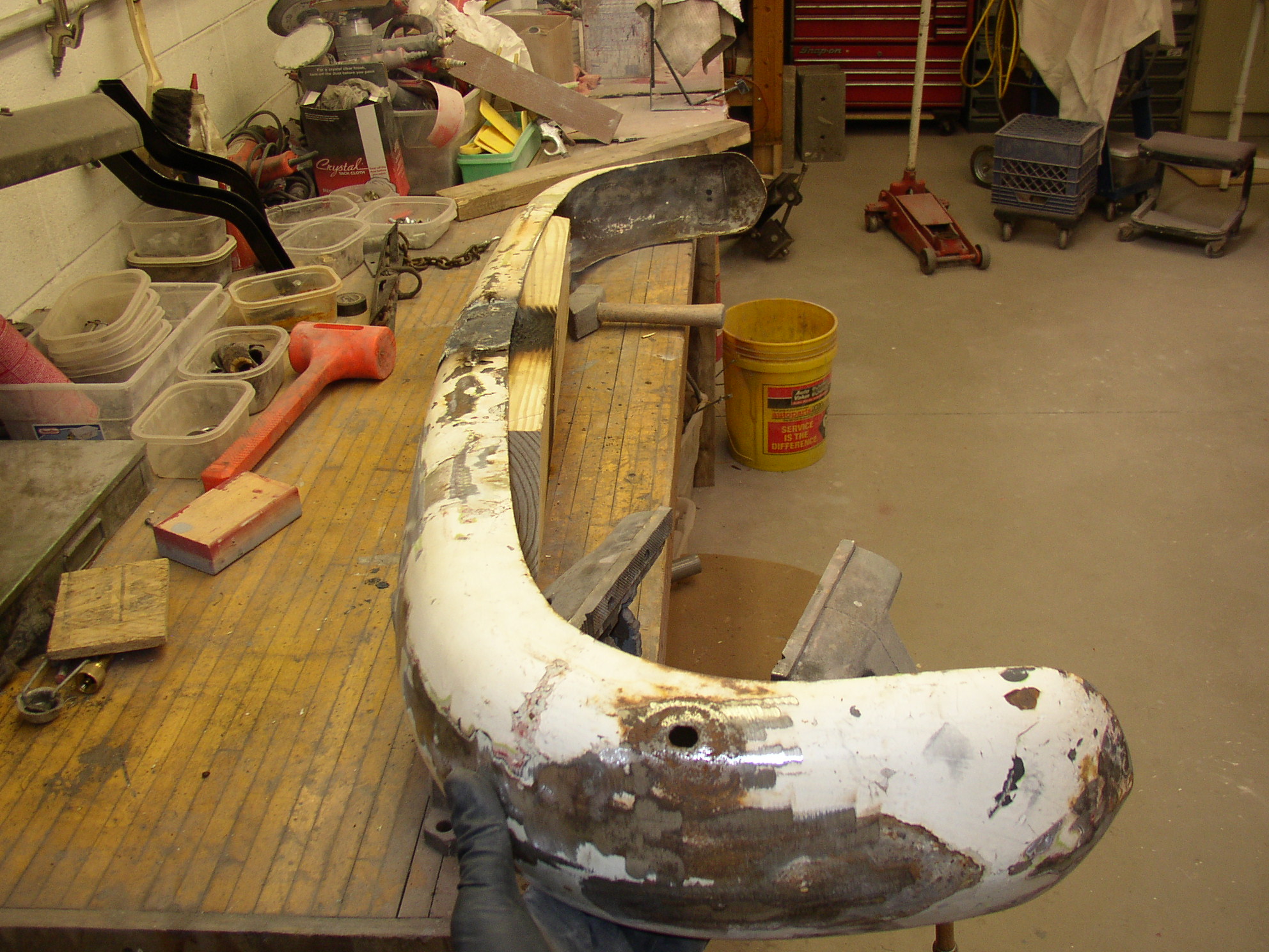

I was working on popouts while the bus was at Bills. I blasted some frames and painted them and was ready to assemble them when the bus came back. I was also straightening the rear bumper and painting a lot of small parts which will be installed. No pics of all that, though.

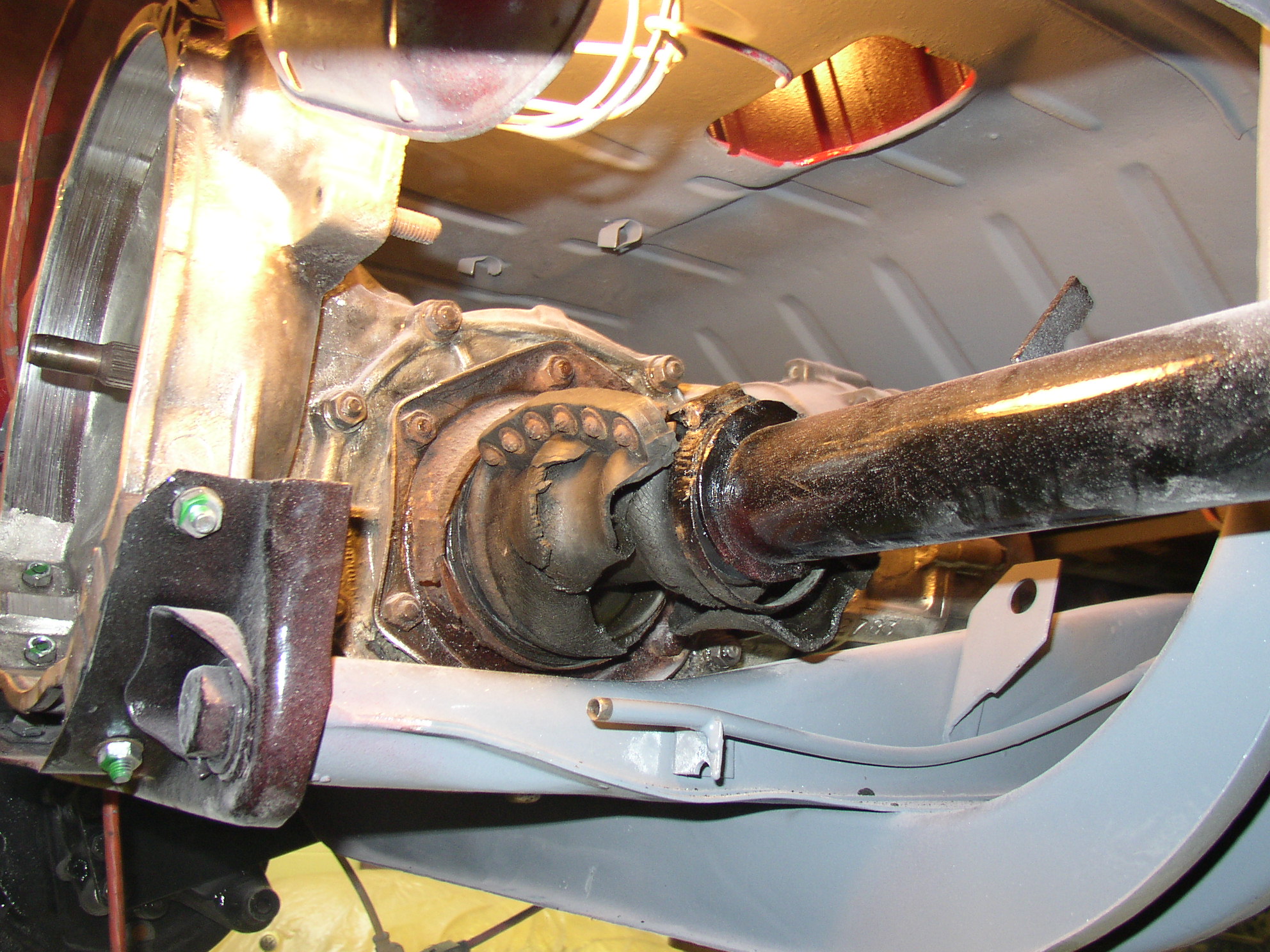

I changed the axle boots, and to do this the axles need to be level. On a Type 1 this is no problem, but in a Bus with no engine you can't get the torsion bars compressed because there's not enough weight. I fabbed up a tool to go between the shock mounts and compress the bars to level. Eat your Wheaties!

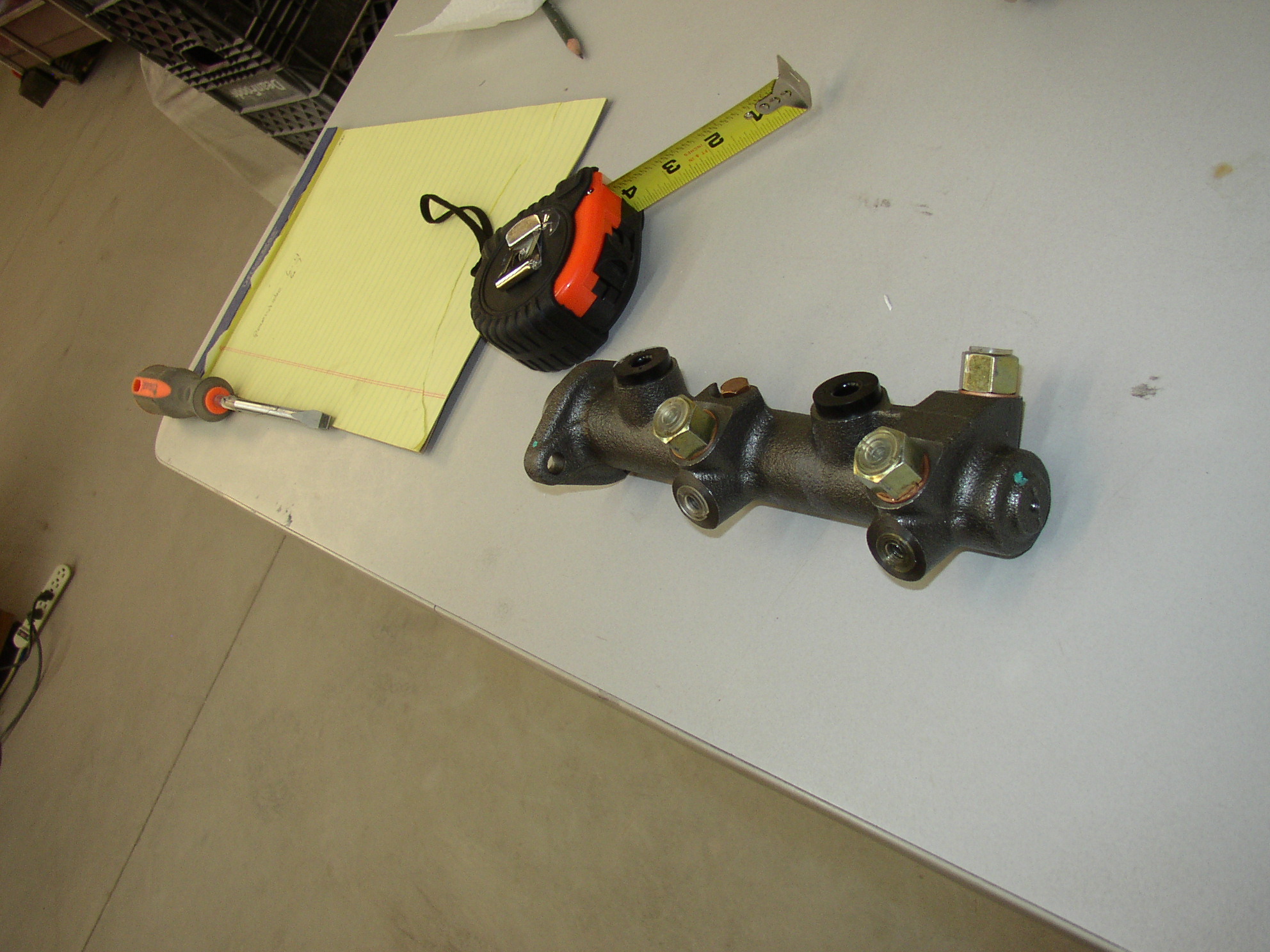

Now for the dual MC- here's the wrong MC, for a manual brake '71-78 bus. :
There's lots of reservoirs that all look the same at a glance, what you need is a Rabbit or Porsche reservoir (I think Volvo might be the same) What you need is outlets that are 3.325" apart center to center and .320" in diameter below the flared end. Another mistake I made- the 71-78 Bus master needs to be the power brake version and not the manual brake version. The manual brake MC has different spigot spacing for the reservoir that nothing fits. I bought my MC from Napa for $42 and the reservoir from a guy on Samba for $25 shipped.

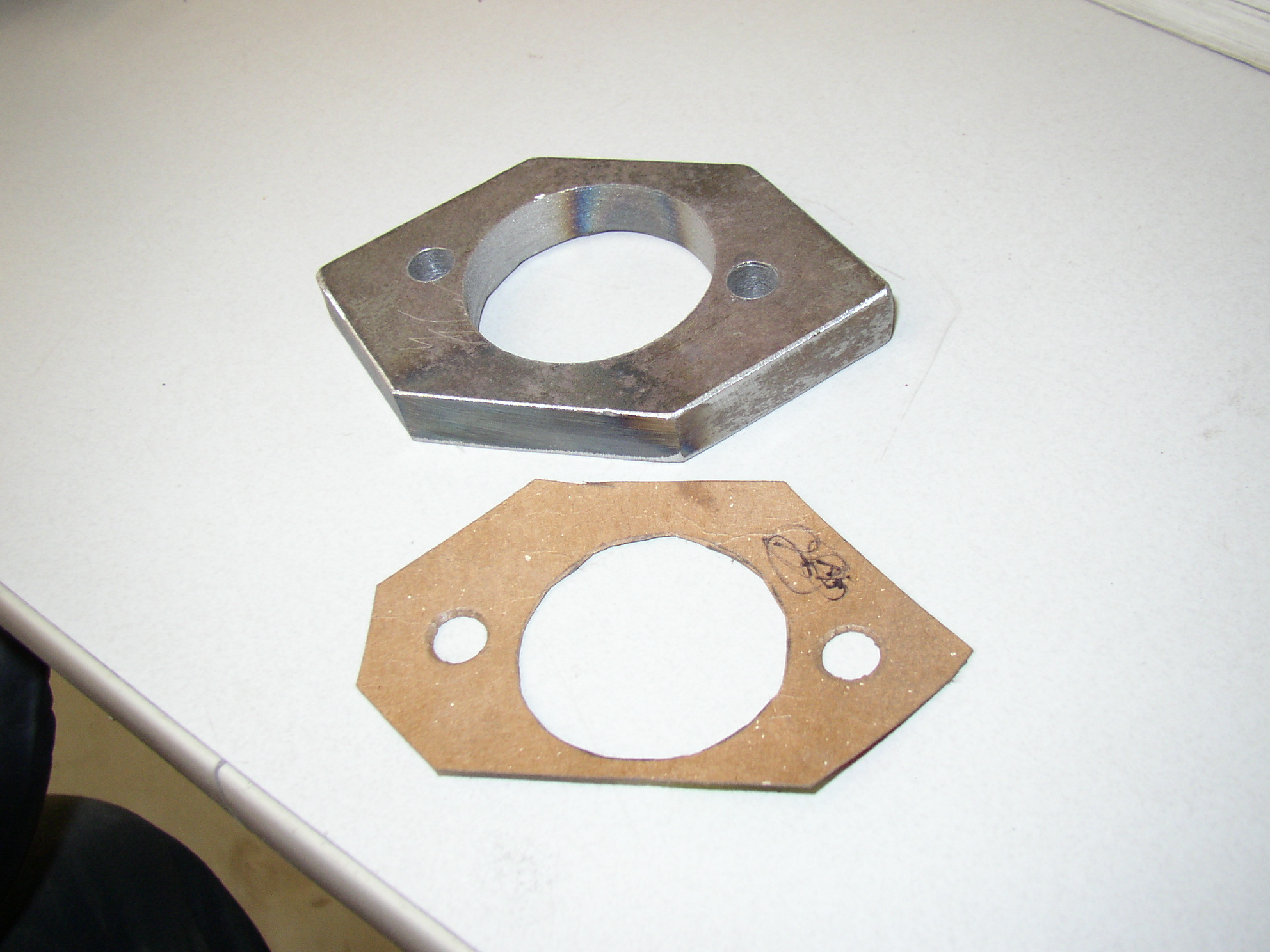

Spacers are hard to find and expensive ($40) by themselves so I made one from 1/2" steel plate. First, make a template from cardboard.
Here it is test fit without the boot, plenty of clearance.

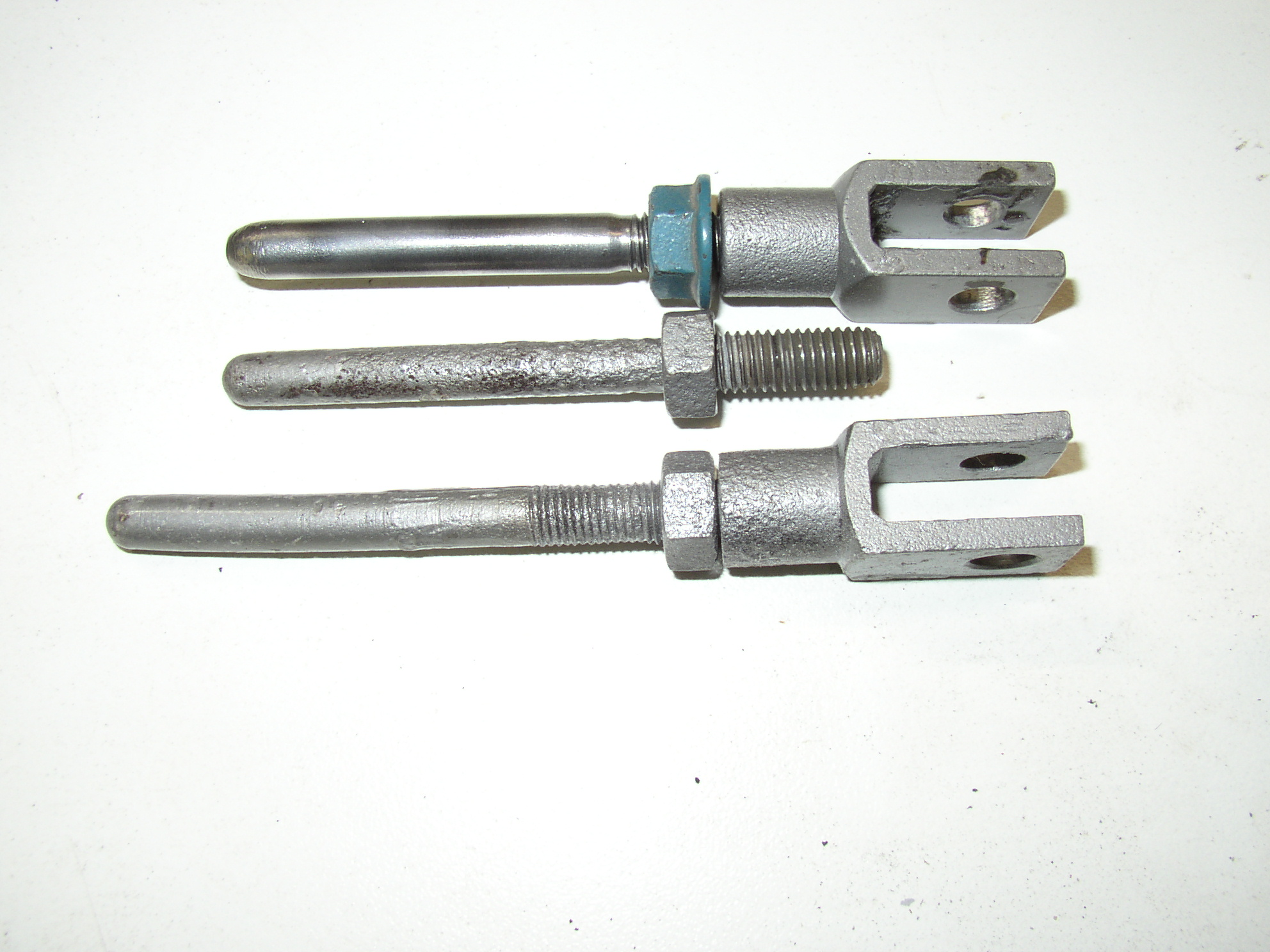

There's something interesting about the pushrod- I have two, and one is 8x1.25, and the other is 8x1.0! 8x1.0 is a bastard size and hard to find bolts in. I used some hard diesel bolts I had laying around for all of the MC and pedal mounts, I think they're all 10.9 hardness. I made a new pushrod for the hell of it since the old one was pitted badly.

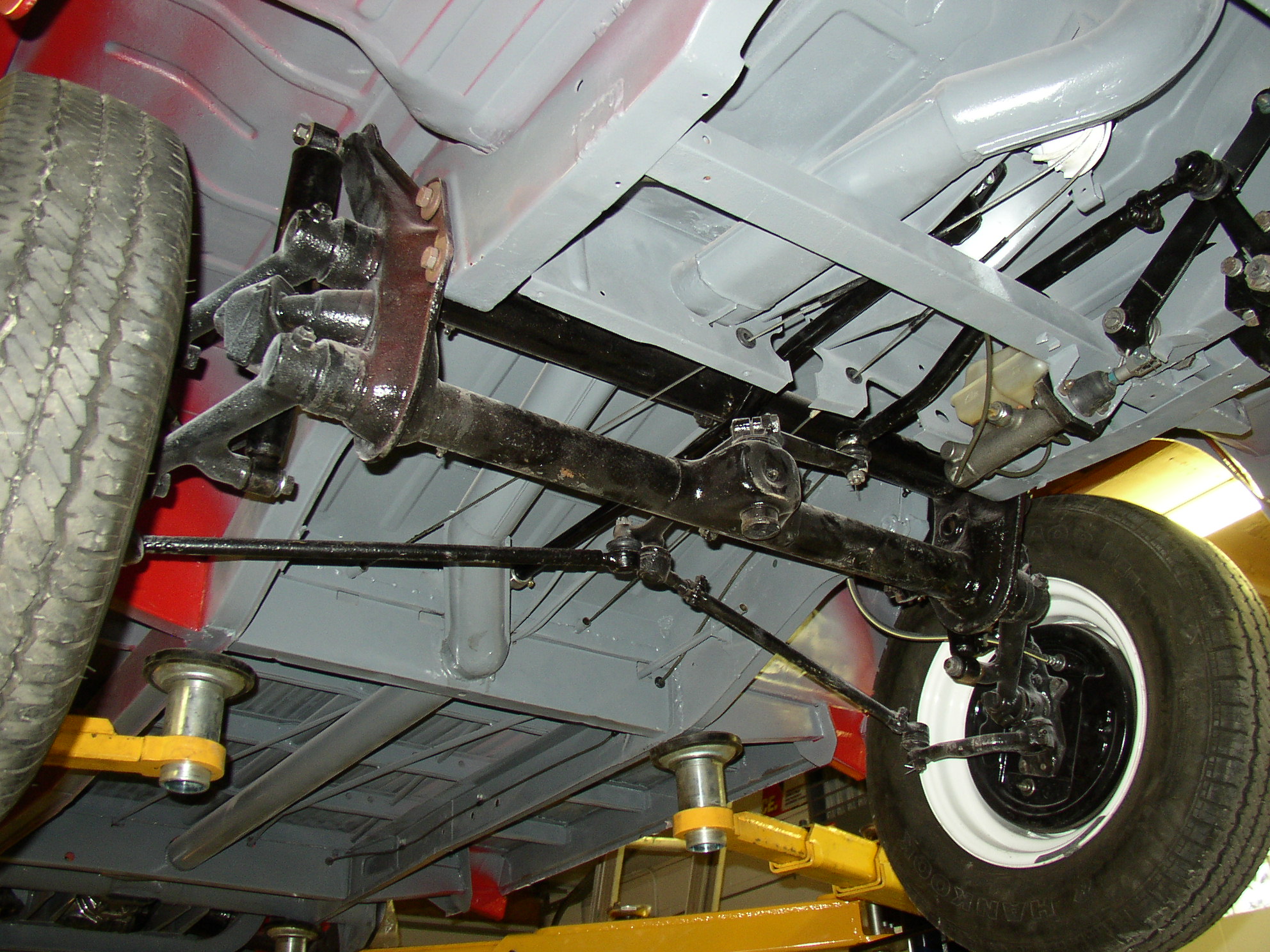

Here we are, MC installed with front boot, lines plumbed, bled, shocks on, most cables run, etc.
I straightenend out those stupid axle mounting washers that I installed wrong a few months ago and torqued them to 72ftlbs.
Yes, I need to take lacquer thinner and a rag and clean all of the overspray and dust from the axle tube.
I reshot the engine bay Tuesday to cover up overspray from the final paint job. The engine bay was originally shot last summer.
I left tonight after running the harness in prep for stuffing the engine. The brakes are done, shocks on, axle boots, and I bet the engine is in and running next week. Can you say Test Drive!

EIS now has the 67 only master ($38.99) and reservoir ($23.50) in stock. The 67 only push rod is a bit different, but less than 15 minutes on a lathe and you can mod an earlier one.
