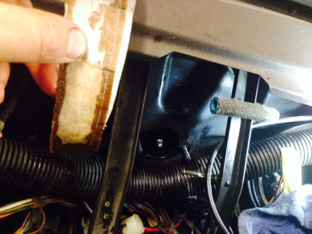

Brakes wouldn't hold pressure so I pulled dash apart and took out Master Cylinder (brilliant design) :(
Shoved a strip of cardboard down into booster to see if any brake fluid is resting down at the bottom and yes about 3"
of resting brake fluid in the bottom of the booster.
Will extract using an oil changer pump.
Master Cylinder on order

Might want to have the booster rebuilt if it was sitting long soaking in brake fluid.
Re: 80 Vanagoon
I am crossing fingers that its ok, but you might be right about that.

Re: 80 Vanagoon
Beats pulling the dash AGAIN...
Brake Materials & Parts can turn a booster around in 3 days.
