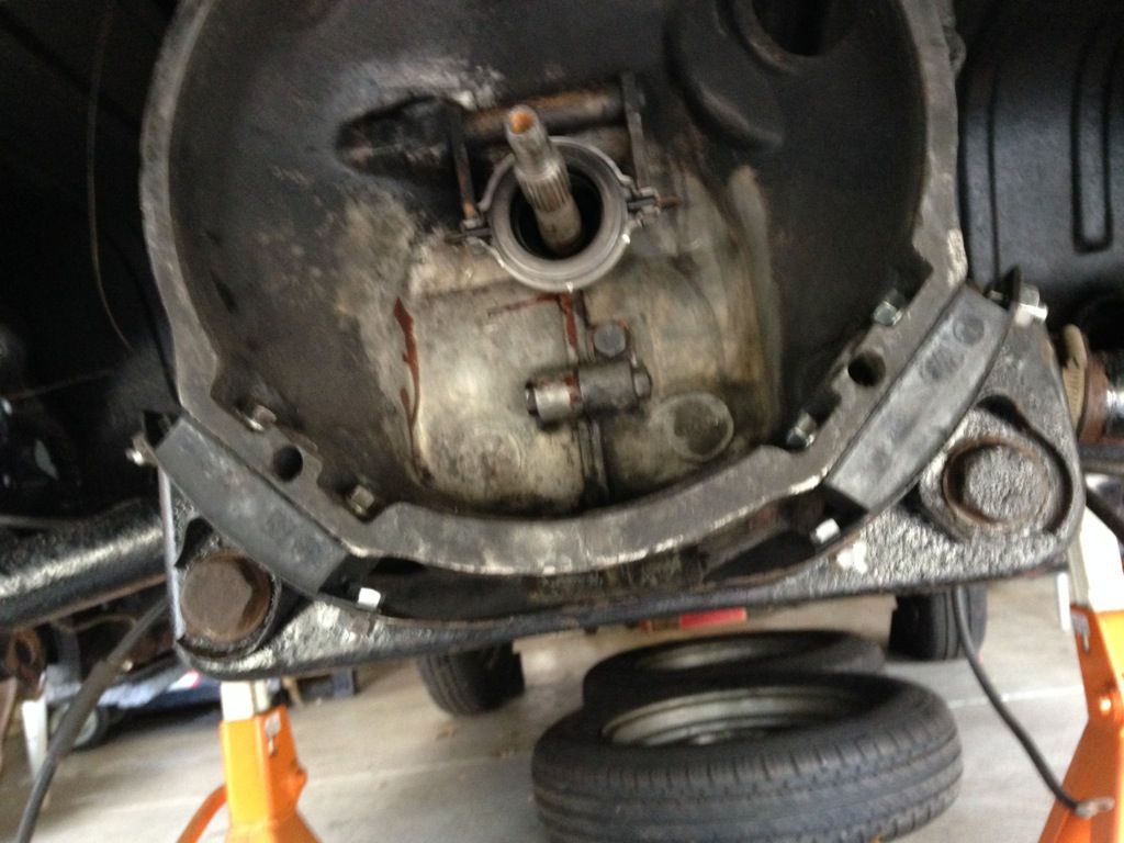

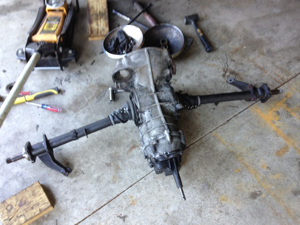

Long winter and you know me, I'm not happy unless I'm needlessly pulling motors! :lol: Well, I'm graduating in 2014 to transmission pulls. :shock: This little '59 beetle has been crying to get on the road and hapless me hasn't been moving things along at an acceptable pace. I'm giving up on the later tranny that came with it. After leaking all over Bill Webner's place (thankfully cardboard intervened) and making some real creepy noises on the pull home, I found a period correct stock '57 splitcase tranny as a replacement. And it has non-syncro first gear! :lol:
Anyway I yanked out the later tranny.
Got a period correct mount installed.
Cjhanged the tranny seal and put in a Sachs throw out bearing.
Got it up in place.
Still need to get the backing plates back on and redo the rear axle seals. Stay tuned for that upcoming train wreck! :lol:

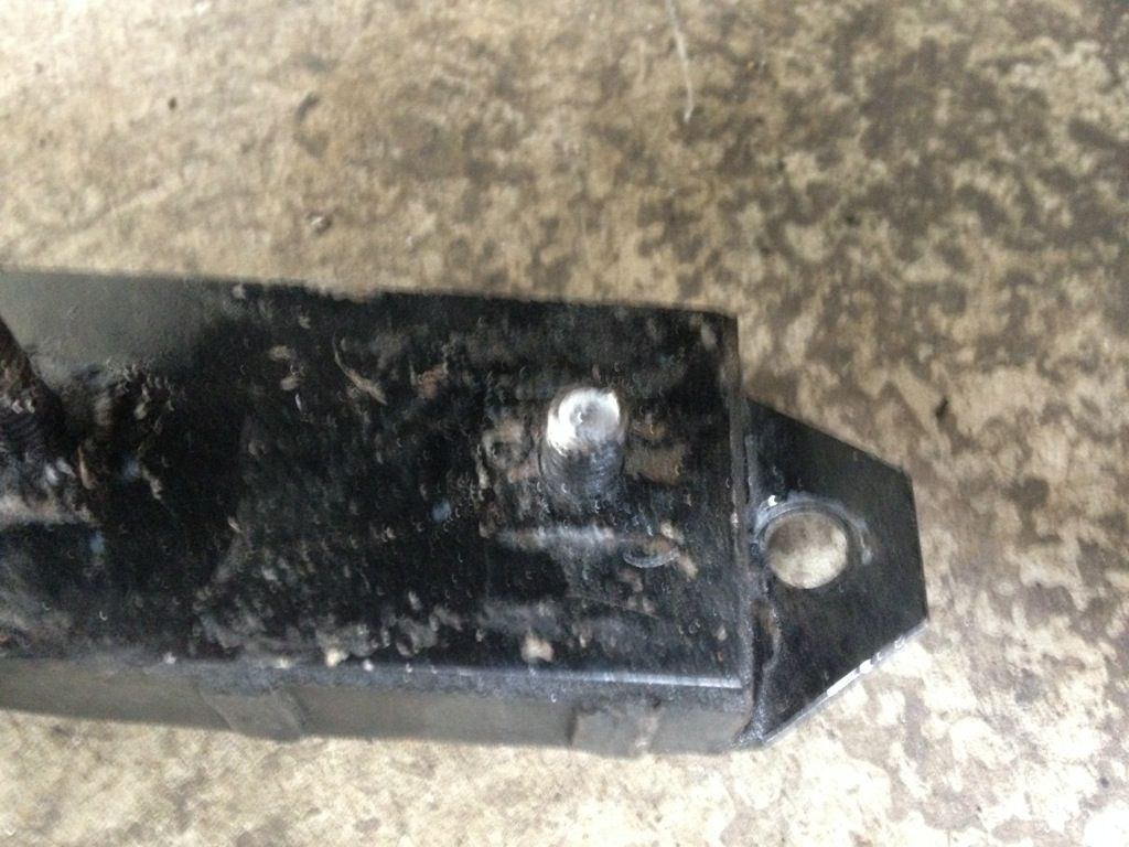

So I broke a stud on one of the tranny mounts delaying me once again. There are differences in quality between the ones Wolfsburg sells and the other aftermarket crap I had. I ordered the Wolfsburg mounts and you could see and feel the quality difference. Here's the broken one.

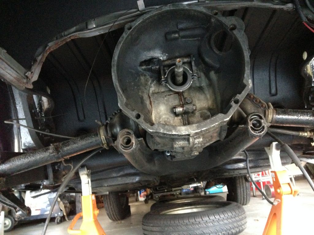

Got the tranny back in with all the nuts tight. If you're doing this job its best to get everything lined up and loosely bolted then tighten everything down.

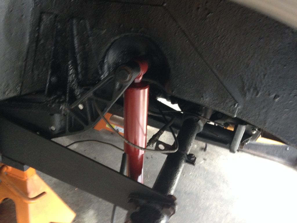

Since Chuck raged on me about my 50 plus year old shocks I ordered the replacements from Wolfsburg. These particular ones also fit early bus fronts. I don't know the quality but at $25 each they were a lot cheaper than KYB.
