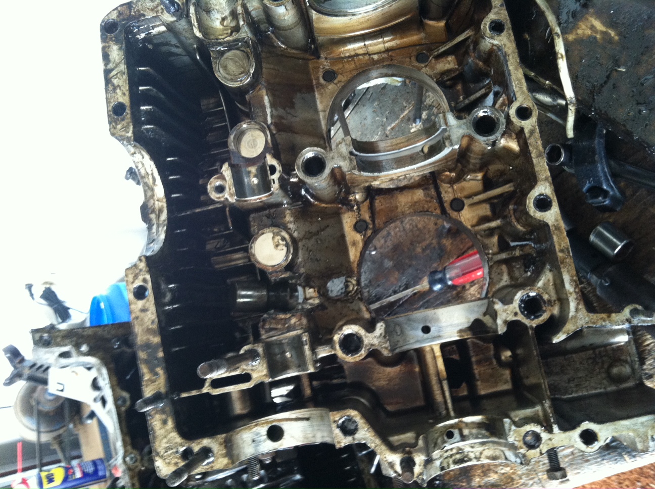

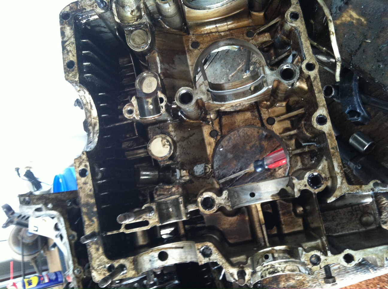

Well
It's RIP for this engine. Cam is broken. Lifter socket destroyed Finger sized hole just below the lifter.
What a drag.
Moving forward what do you think the chances are of finding half a case?
What a drag.
Re: My New Project
That looks painful.
Case halves are machined for one another. Sourcing a case half is not the best of ideas because they won't match up very well. I can ask if the 3 or so T4 cases are still around at the aircooled shop out here in Omaha that went out of business and get a price if you want.
Please don't toss the case though, I may be able to find a secondary decorative use for it when I'm east again.
Edit: I just sent you a text message. The T4 cases are $100ea and should be good. The guy taking care of the final closing can still ship and take credit cards.

Avoid the craigslist 1800 unless that's the only case you can find, (1800 internals... yuck) I have a OK 2 liter case that I can give you, buy a NEW camshaft! type 4 cams wear out due to the lifter geometry (and sometimes they break)....
