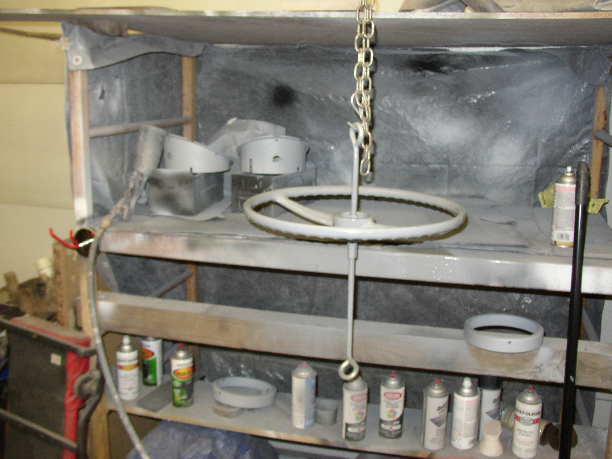

I saw a filthy, messed up steering wheel at Ypsi last year and picked it up, figuring I could use that on the bus while I restored mine. After I wiped it off with lacquer thinner I found it was in better shape than the one I had! I figured I'd do a hillbilly restoration.
First, take a Dremel and grind out the cracks.
Fill them in with epoxy gel.
Sand out, mud, sand out, primer....
Two coats of color, 4 coats of clear, wet sand, buff....
Put the cancel ring back on. Sure am glad I bought that steering wheel puller....
And install it. It actually came out quite nice.

Disassemble, bead blast, prime, paint with a mix of black and white to get a light gray. I know they're supposed to be beige but this ain't going to Pebble Beach.

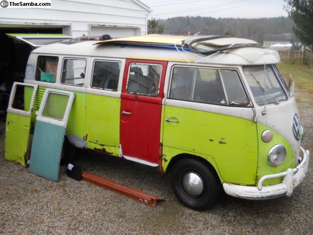

WOW - - - YOUR HARD WORK AND COMPLETION OF THE 66 DELUXE HAS BEEN AN INSPIRATION TO ALL OF US, AND IF I MAY, ON BEHALF OF BUS LOVERS EVERYWHERE, DECLARE YOU - "SUMMA CUM LAUDE" (FINISHING WITH HIGHEST HONORS).
