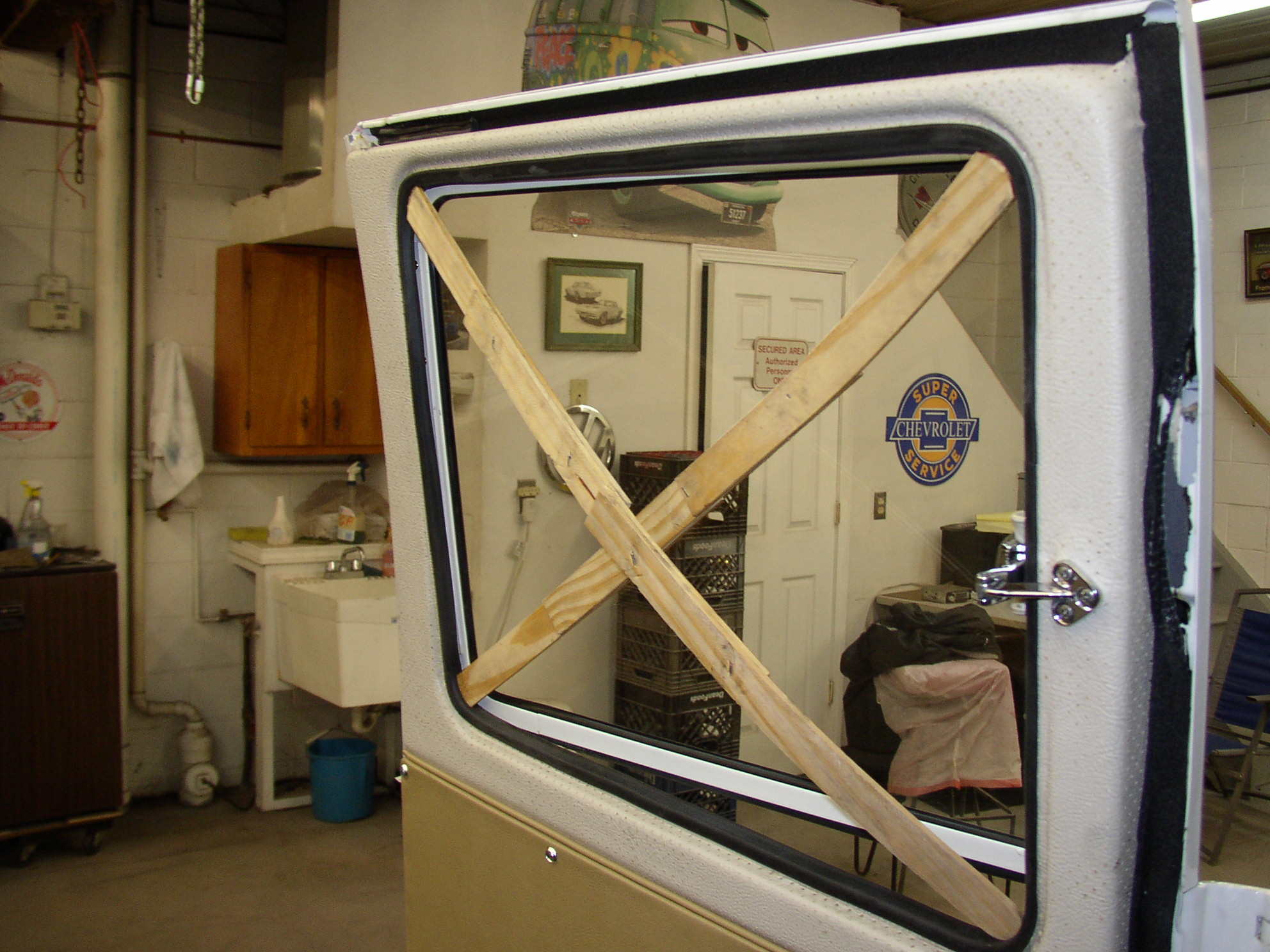

I put the rest of the popout inner gaskets on, a trick is to take paint stir sticks, glue/staple them to 22 3/4", round the tips, and use them to prop the rubbers in place. Put a bit of glue in the corners as they tend to pull out.
I buffed the popout latches and installed them. They work great- the tip is to use baby powder to lube the seals. (Thanks, Lurch!)

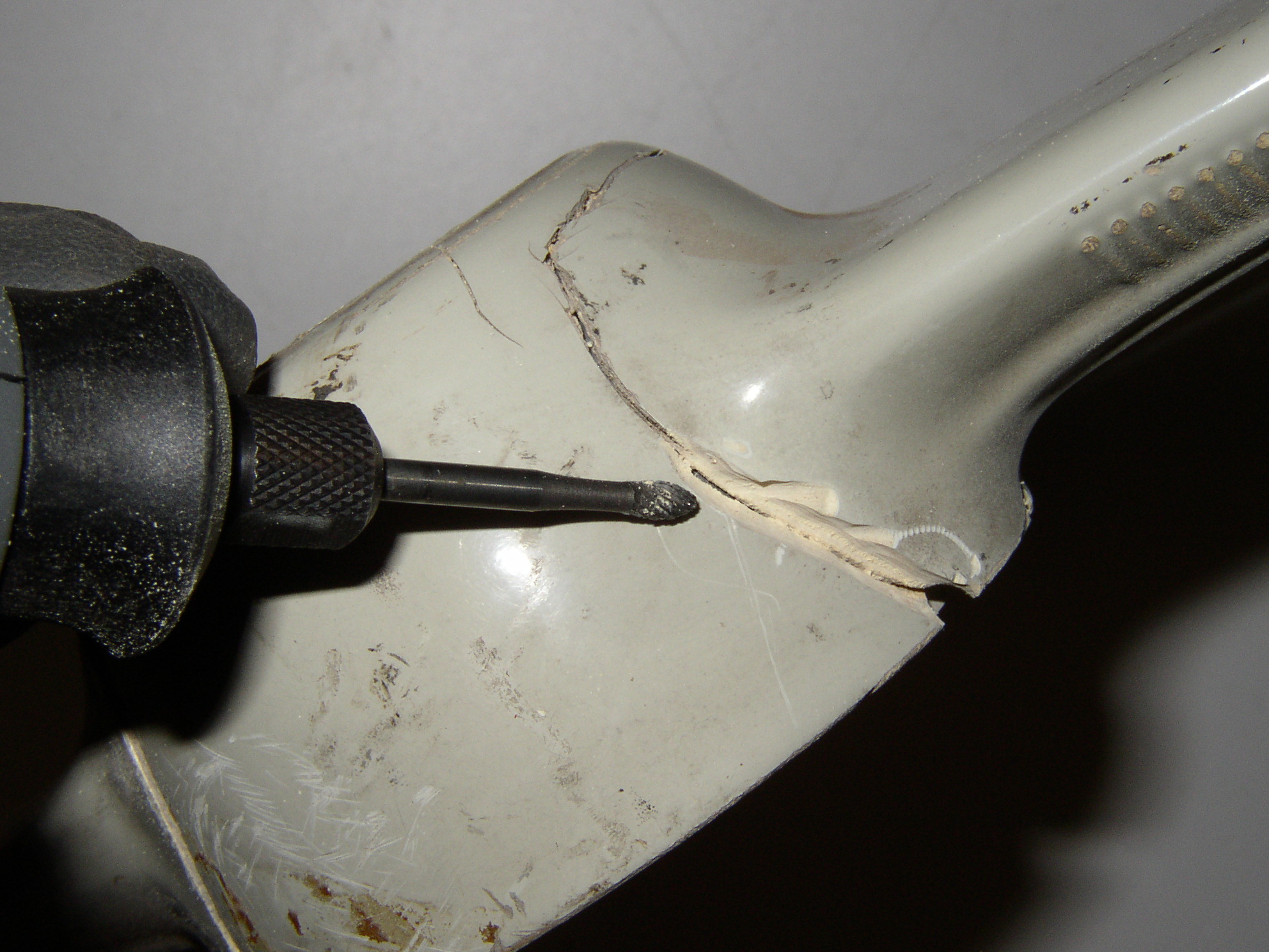

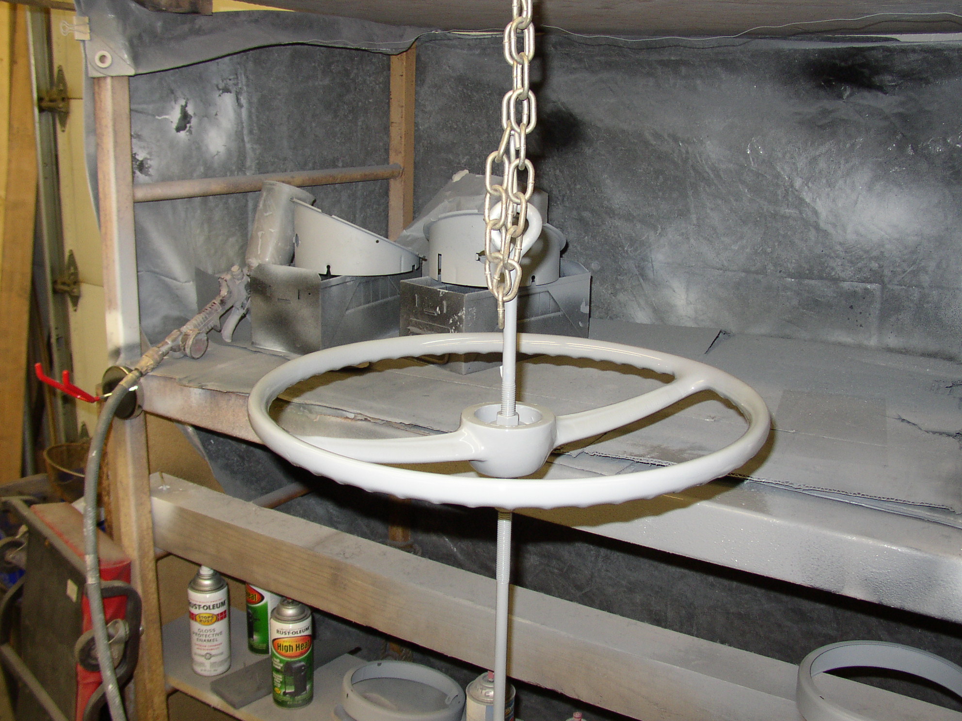

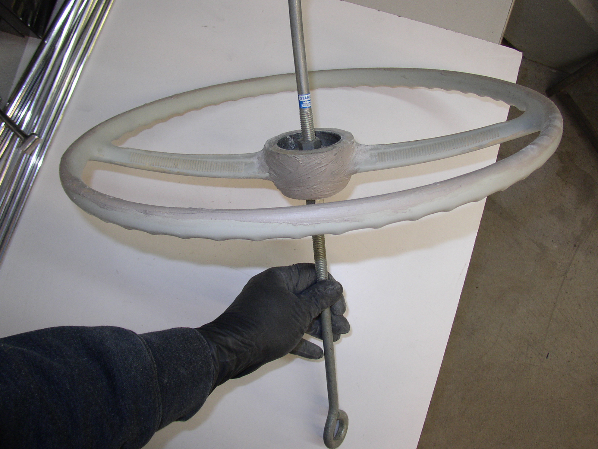

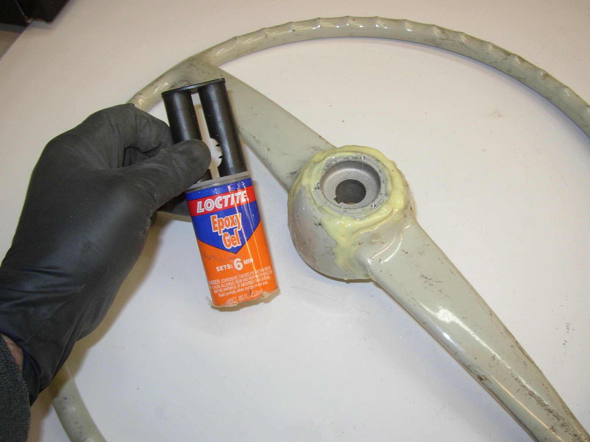

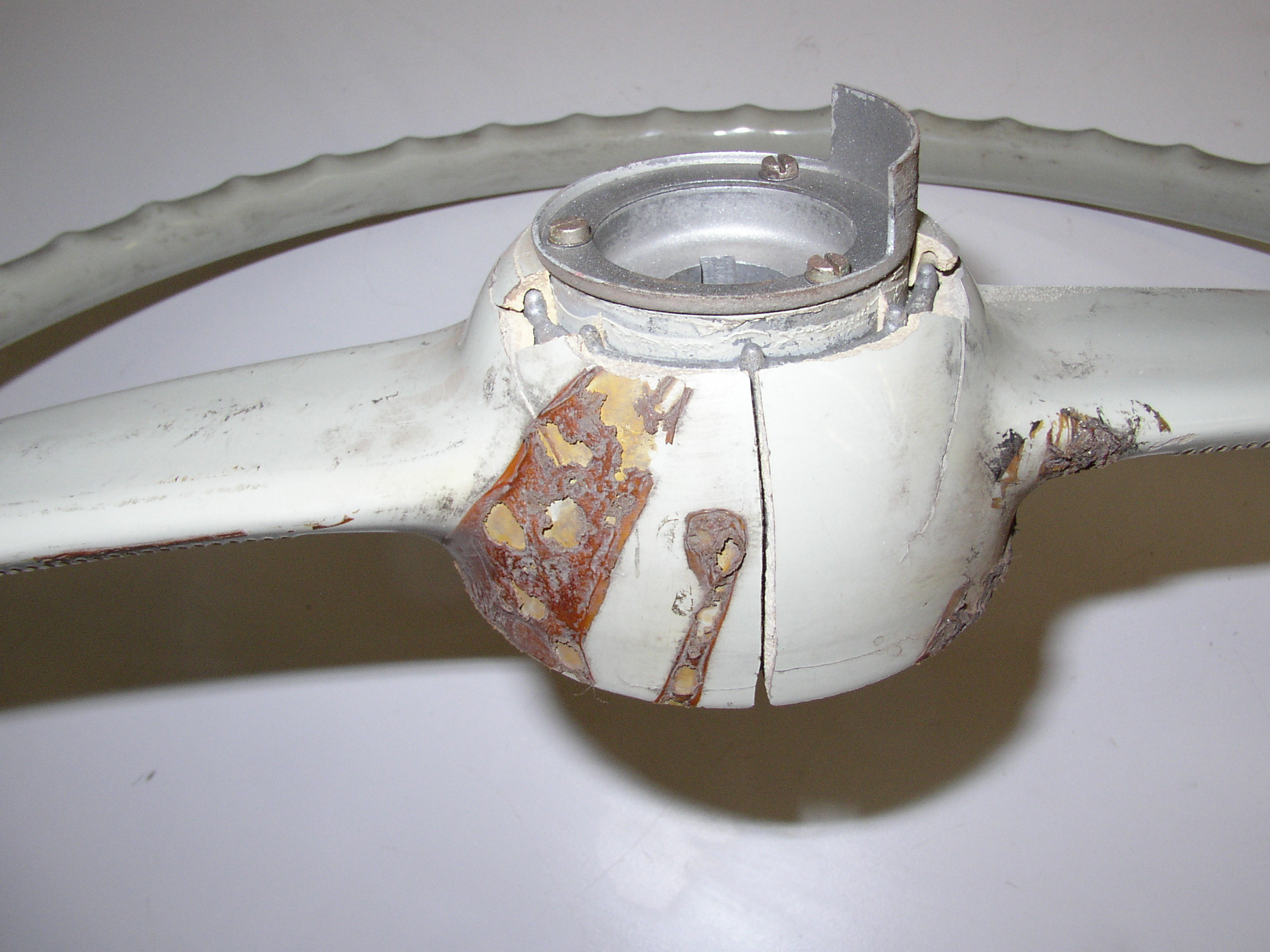

I saw a filthy, messed up steering wheel at Ypsi last year and picked it up, figuring I could use that on the bus while I restored mine. After I wiped it off with lacquer thinner I found it was in better shape than the one I had! I figured I'd do a hillbilly restoration.
First, take a Dremel and grind out the cracks.
Fill them in with epoxy gel.
Sand out, mud, sand out, primer....
Two coats of color, 4 coats of clear, wet sand, buff....
