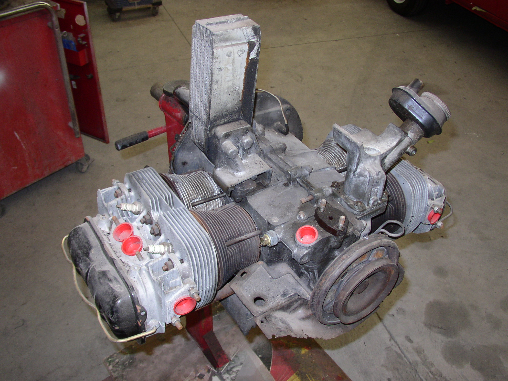

A few years a go I was bored and did a top end on this 1600DP. I did rod bearings, rings, ball honed the jugs, and had the heads done by LA. I didn't have a use for it at the time, I just didn't have anything to do that day. I figured it would get used eventually.
It's been sitting for years corked up and filthy, now I'll switch it over to SP and put it to use.

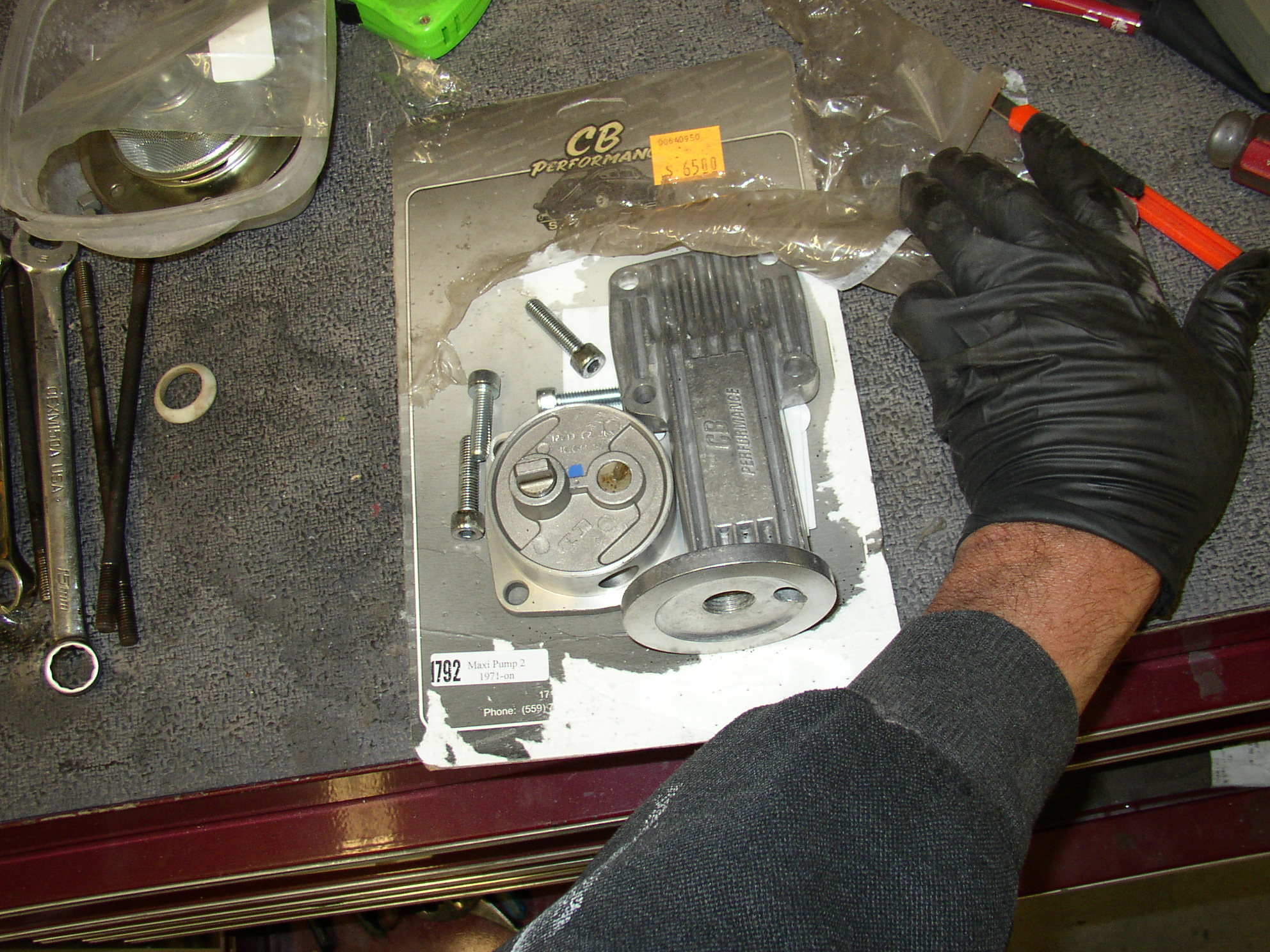

Make sure you get the right pump, it depends on what cam/gear you're using. Mine is a stock late DP setup with the dished cam gear, I've had good luck with this CB pump, it ain't cheap, about $60.
Remove the old oil pump studs, clean the case flange (yea, and the case too :roll: ) with a razor blade, brake clean, and install a couple of guide bolts to make sure it's straight. A bit of spray tack on the gasket, and knock the pump body in with a block of wood and a mallet. The case wasn't clean at this point but the flange was spotless.
More spray tack and the cover goes on. I keep a spare cover gasket on hand because I have several of these pumps on engines.
Torque to 18 ftlb and install a filter with a bypass valve, Napa 1374 fits this application. This is critical! If the filter does not have a bypass, it will crush the filter material on a cold start, starve the engine, and lose a crank. It happened to me years ago and ruined a vacation to the Outer Banks. I sold an engine (w/filter pump) to a buddy who changed the oil the night before we left, the parts store crossed the filter PN to a Fram which did NOT have a bypass. After towing it to Ocracoke, he started it up, the filter crushed, spun a bearing, and ended his fun. We bitched to Fram, who amazingly paid for the engine parts and labor but not the vacation. I still won't use Fram filters to this day, and that happened in 1986. :x
