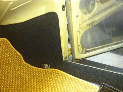

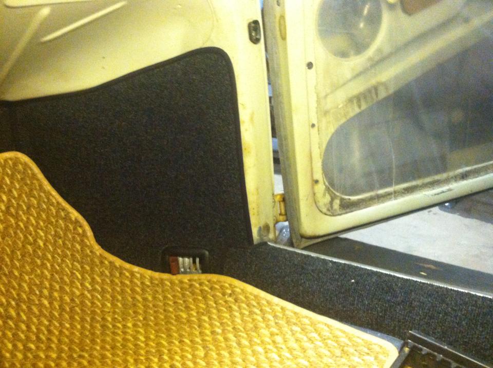

I've been focusing on the interior lately. Feels good to have gotten so far this winter.
The carpet, rubber mats, coco mats and tray from Wolfsburg West went in with very little trimming. Speed Roof and carpet pad underneath almost everything. Really changes the whole feel of the car. It's got that new car smell.

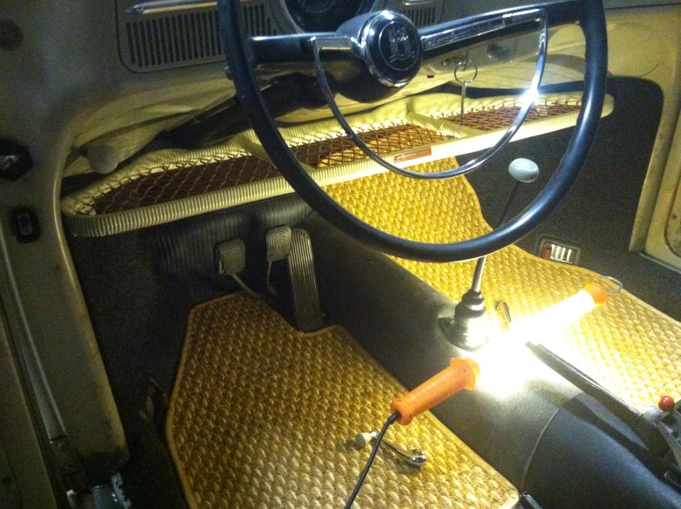

Another shot of the 66 interior.
