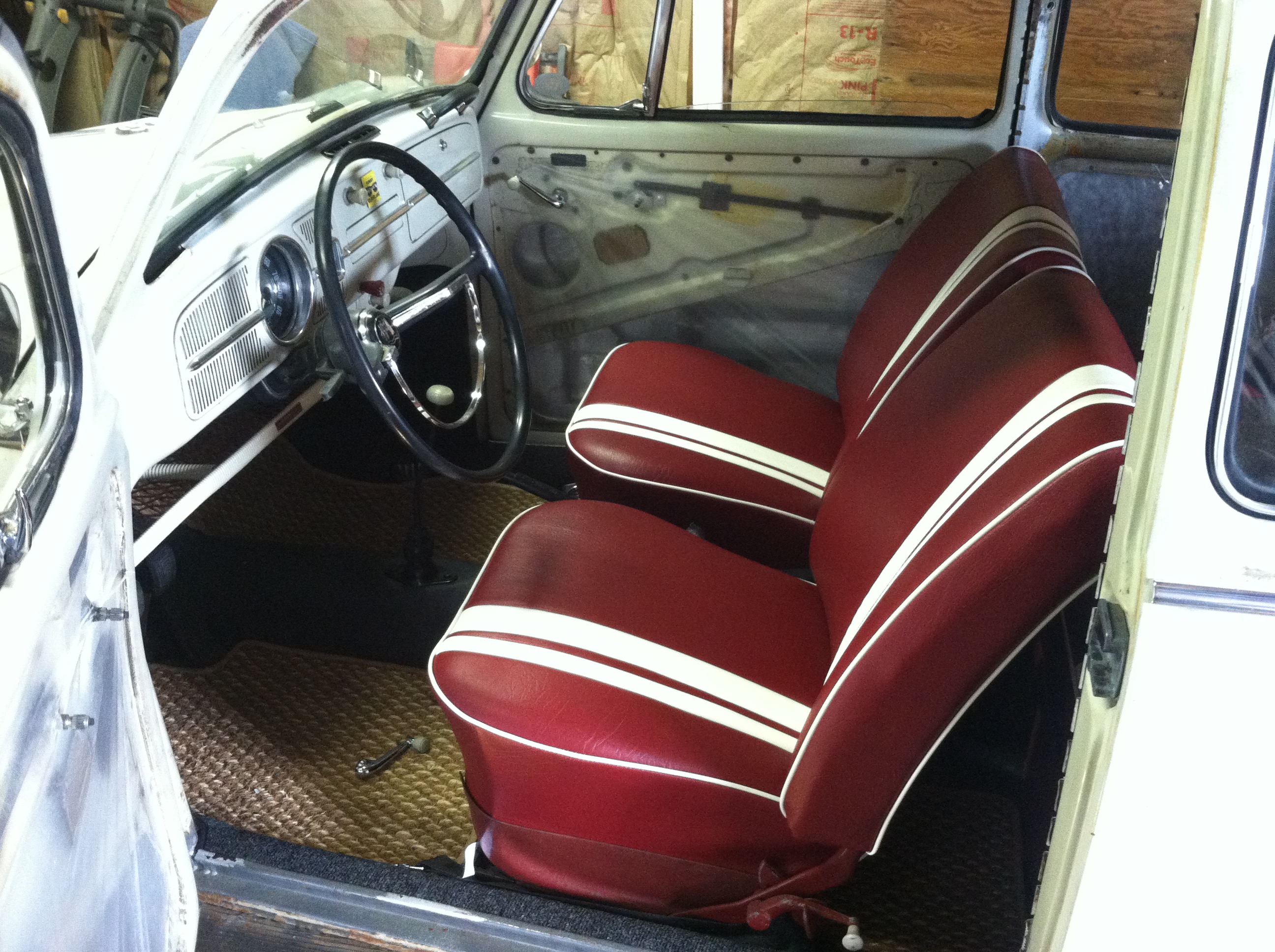

Newly upholstered seats from Russ Upholstery. Super sweet job.

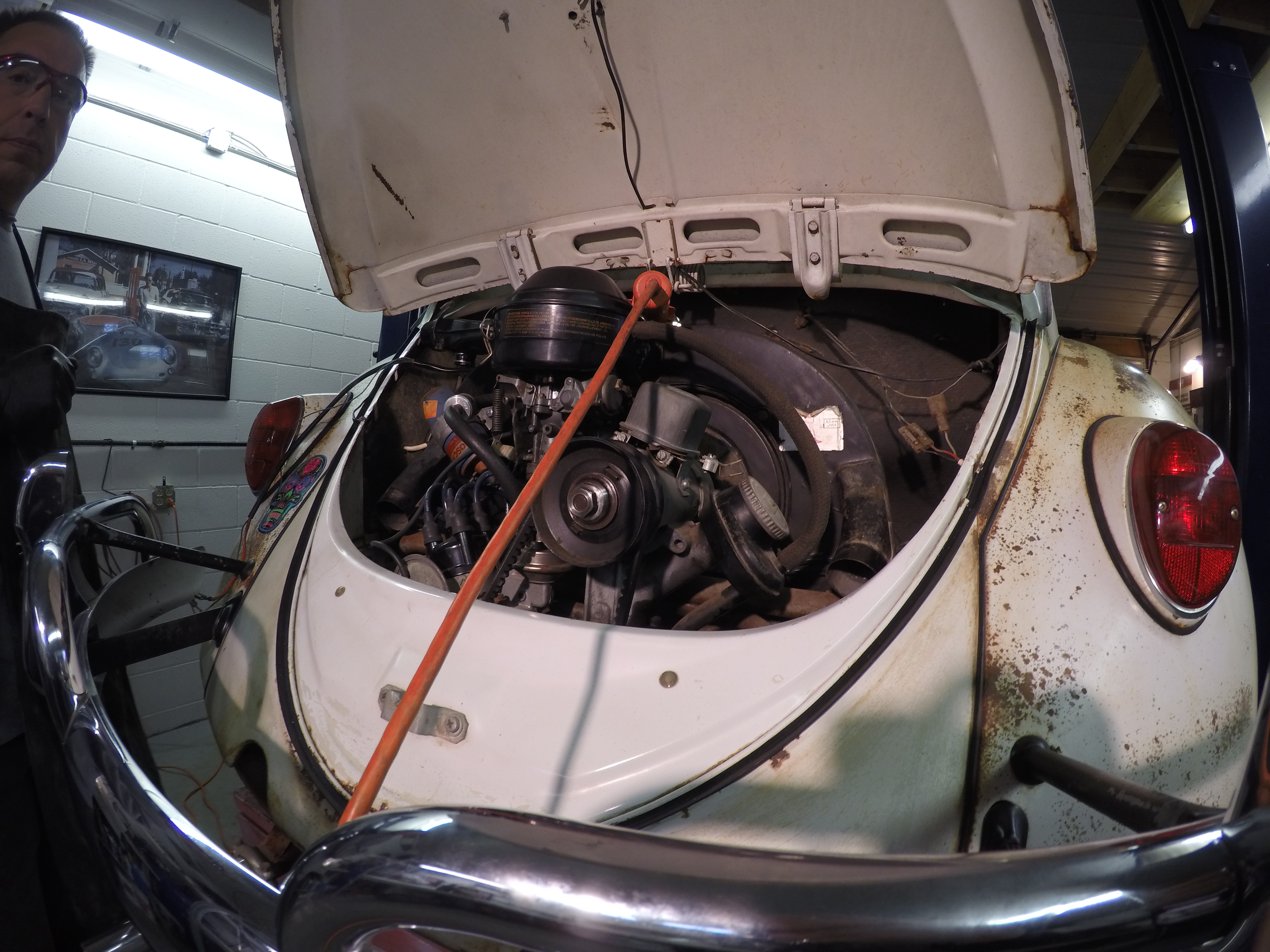

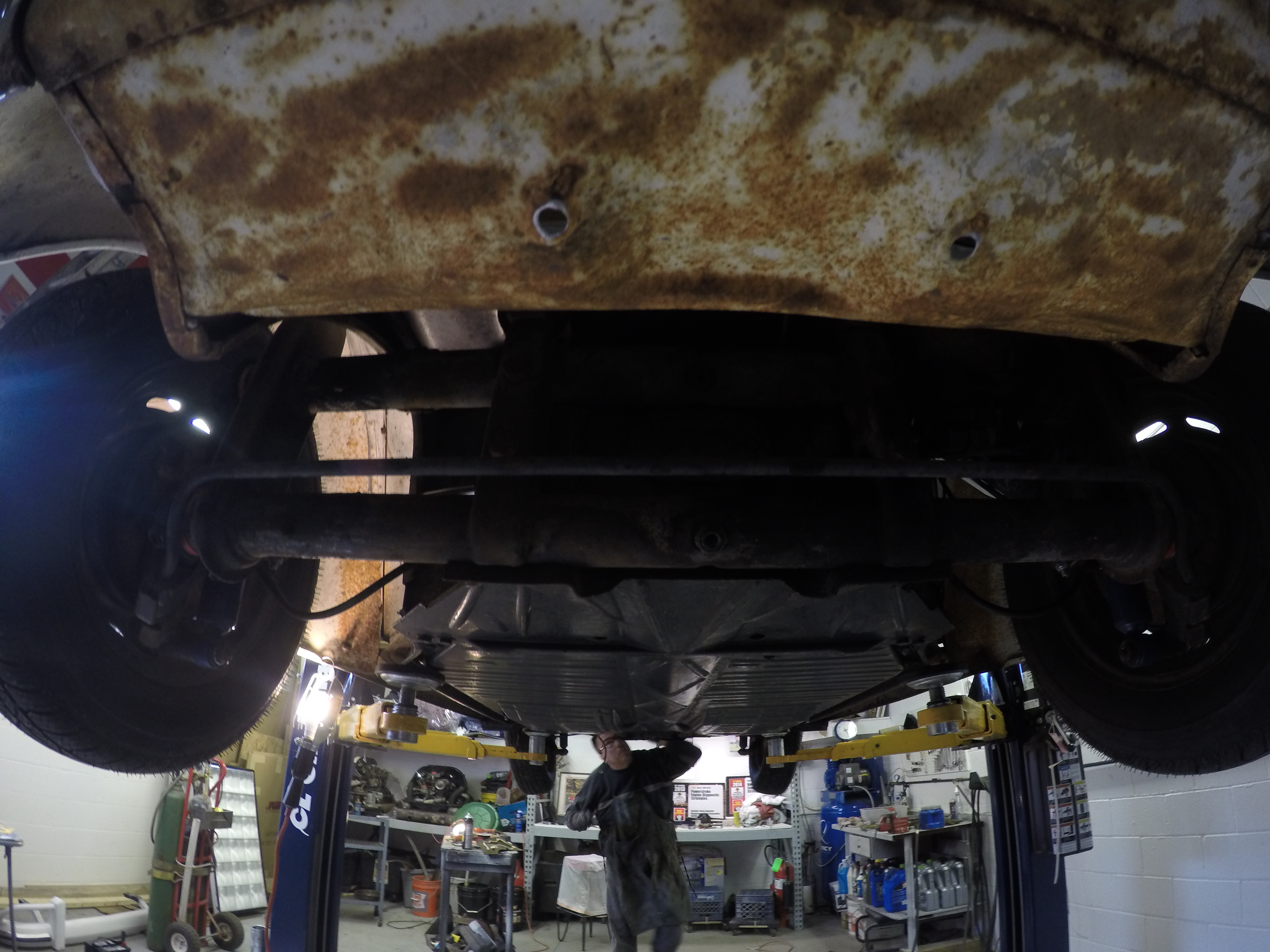

Trailmix brought his Beetle down for a 12v conversion. Man, this car is nice! Originally a Texas car, it's as dry as they get and probably the cleanest Beetle I've ever worked on. And it's unbelievable that this car has gone almost 50 years without a dent, ding, or any paint work, a true survivor. I'm really not a patina guy but this car really shouldn't be touched.
The kick panel area where the pans and body always rot out:
Check out the front fender and horn area- cleaner than any car I've ever seen in Ohio.
Anyway, let's rack it and get the engine out. I'm putting on a 12v gen and regulator under the seat like a '67-72 would have.
Like before, the engine comes out on the cart. It's an H case single relief.

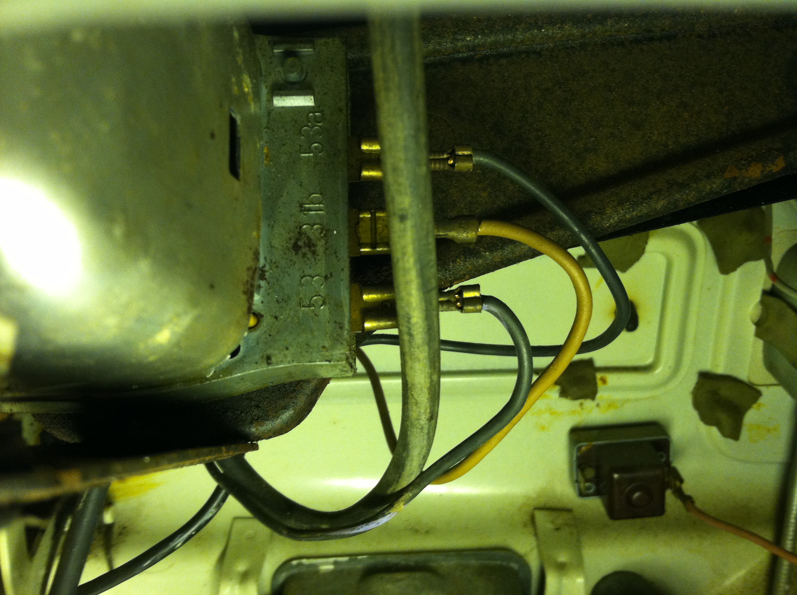

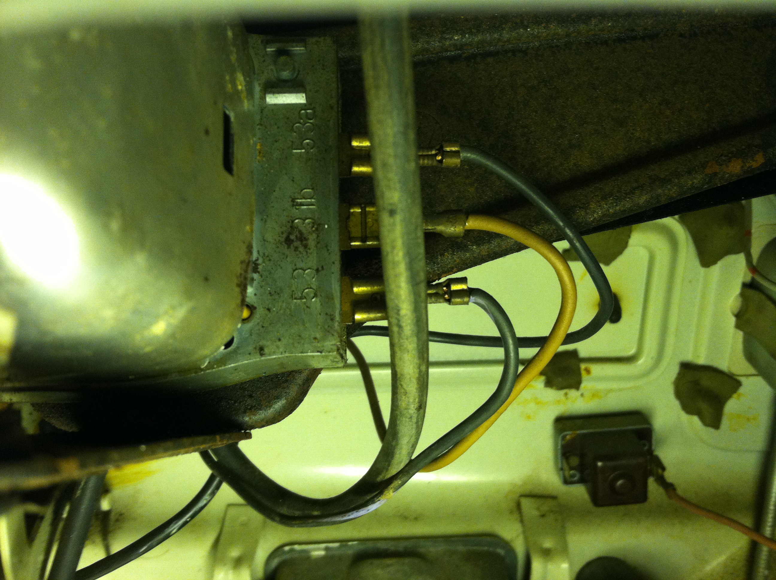

I am trying to finish up the 12V conversion behind the dashboard. I ordered a new 12V flasher box from WW and it works great, even have 4-ways again.
I also ordered a new 12V armature for the wiper motor. "It just drops in they said, like five minutes they said". I looked all over for video or just a thread that explained how to replace it and couldn't find the exact motor that I had. The way it was sitting in the magnets and brushes, there was no easy way to get it out so I had to force it. Fortunately, it went back together nicely.
So now, when I turn on the key, the wipers turn on. Even with the switch off. It seems like its on a fast delay setting. Then when I pull the knob out (one speed switch) they are in fast mode.
So after researching some schematics (which I don't understand but I was trying) and watching some videos, I decided to pull the "parking" wire from the motor. Now they work fine except that they don't "park" at the bottom of the windshield. You have to be right on time with the switch to get them to stop so their not in your face.
I did notice on the old armature that there were countersunk drill marks on the magnets in random places. Is the WW replacement armature just a "fix all" and not specific to my switch?
I didn't take a bunch of photos but I did take a few to make sure I had the wires right when I went to hook everything back up.
