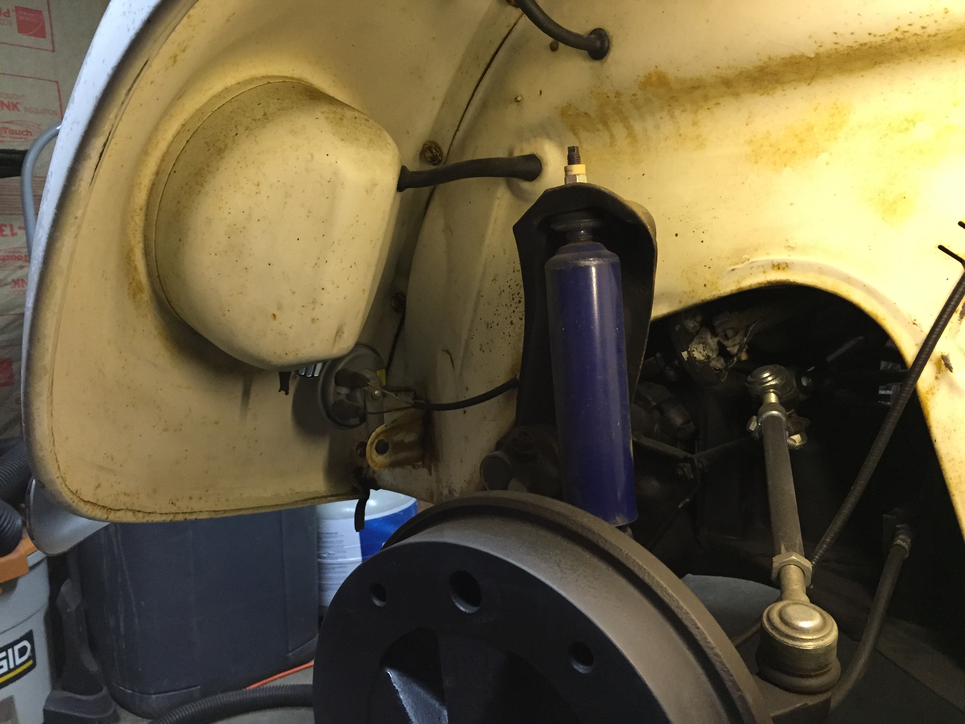

My next project is deep wheels with the tabs for domed caps.(See pic below) But, I need to replace the front beam with a narrower one to accommodate the new deep wheels and to address the small rubbing problem due to the drop spindles. What is the best vendor that offers quality narrowed beams?

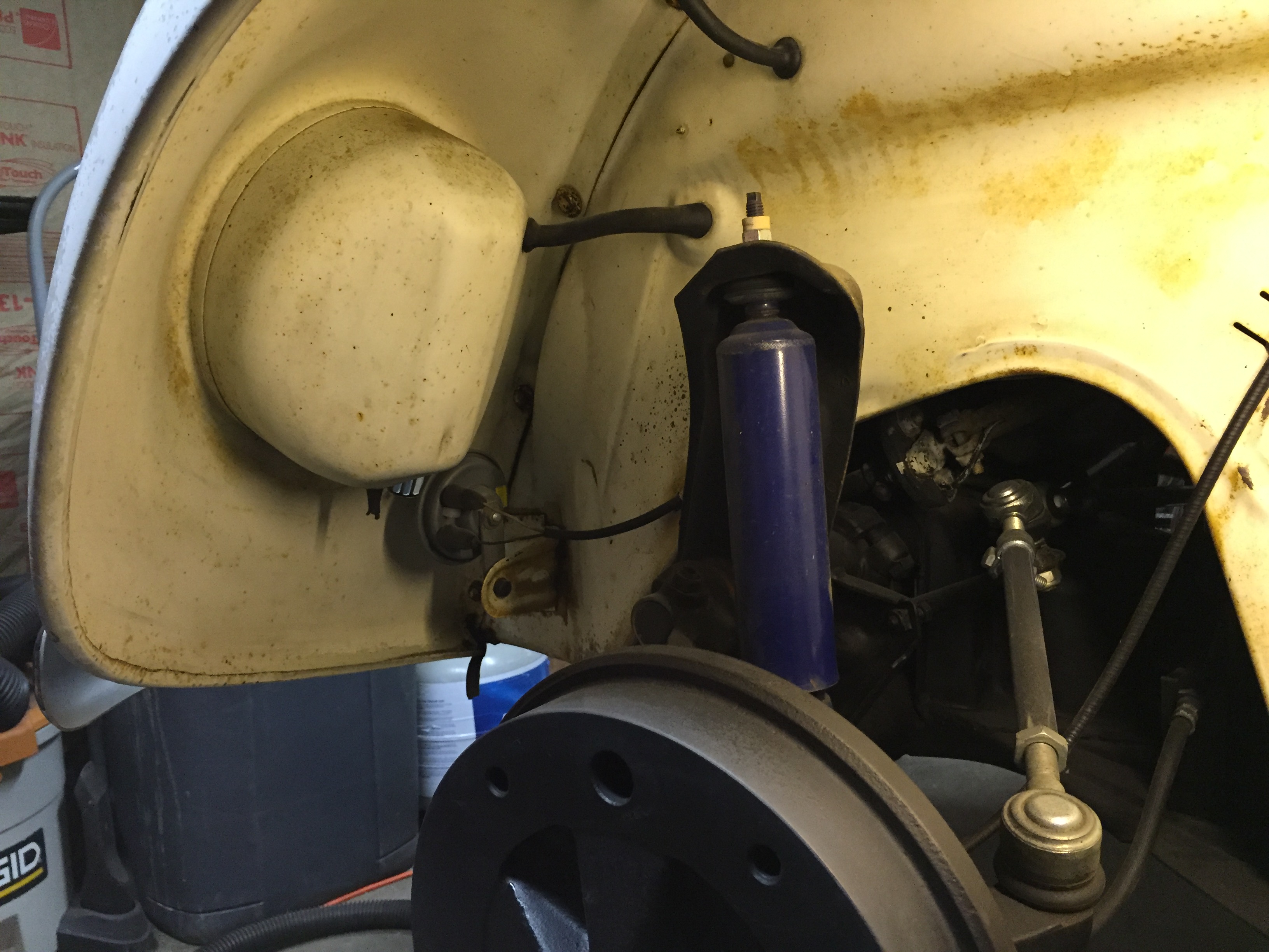

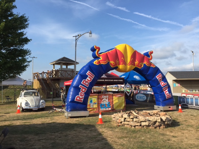

I took the car out to a big bike race this weekend. I used it to gain attention to our display. I talked to more people about the car than I did about the business. But that's OK, I would rather talk about the car anyways!!
Re: Trailmix Beetle
that seems to be what happens when you show up in a VW
How many "used to have one" stories did you have to hear

The next project I need to do is a narrowed front beam. (4" is the goal) My question is this: should I find someone who can narrow the original beam or just buy a new narrowed beam and keep the original the way it is?
Is there anyone local that will narrow my current beam and add adjusters?
Re: Trailmix Beetle
I believe widefive is the guy to talk too on this. I'm not for sure but I know he is way more knowledgeable on the subject than I.
I'm sure someone will chime in to steer you in the right direction.
Re: Trailmix Beetle
Widefive doesnt do T1 stuff for the most part. I would just buy a new beam. T1 beams are very common and shouldnt cost much. It will probably come with adjusters which is nice and you can keep the og beam around if you ever want to go back. You will have either get cut down springs or cut down the ones in your beam now. And do your homework on how narrow you go.

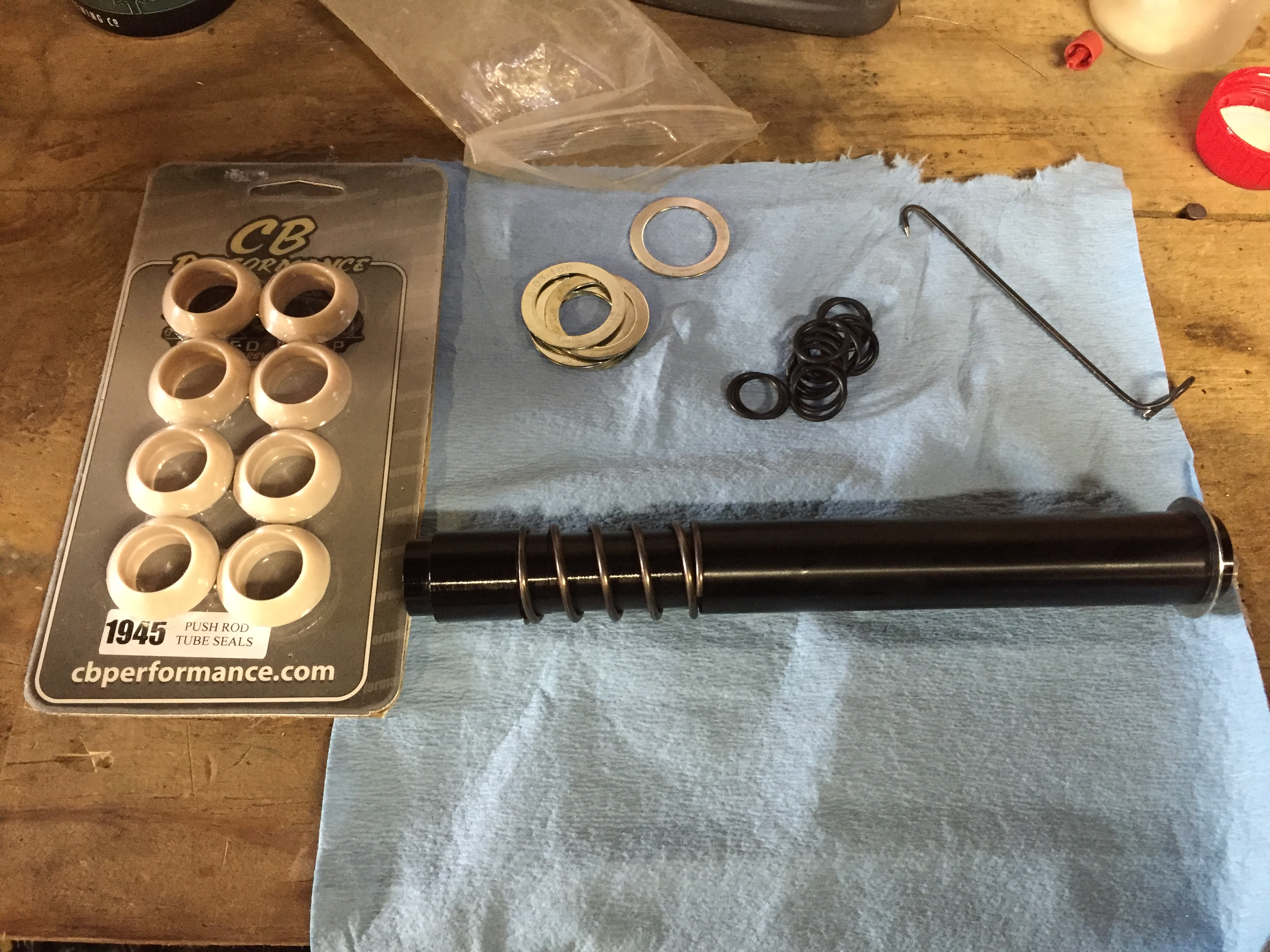

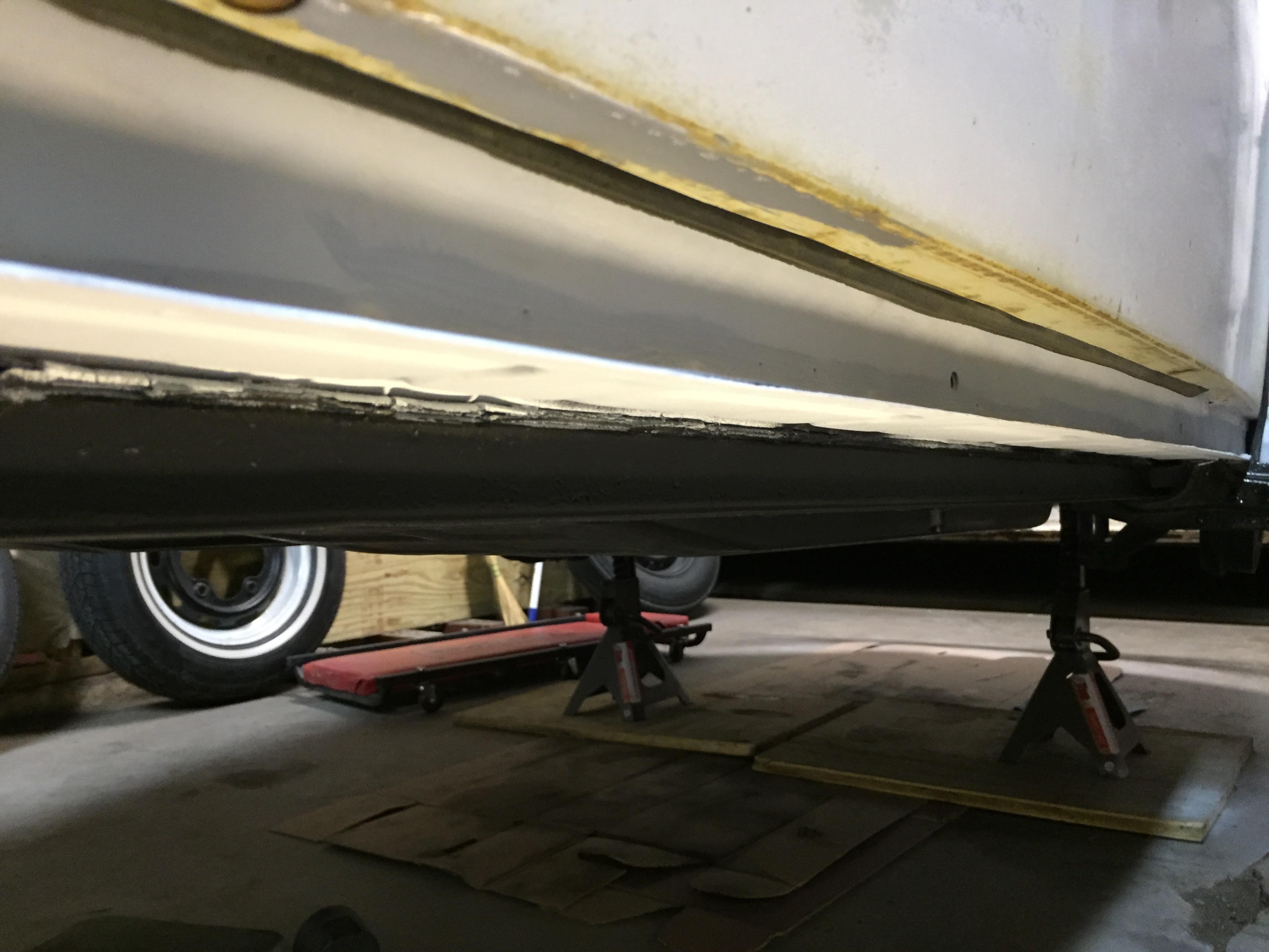

I've been busy cleaning and preserving the last few weeks. Today was the muffler painting with new gaskets and clamps. Installed new Jaycee push rod tubes this week as well! Replaced running boards with some cheap ones but they actually went on with little persuasion. Lots of painting and POR 15 application on everything that needs it.

If you have not done so already, you should top coat the POR15 areas with their topcoat product or a layer of paint. POR15 is not uv resistant and can flake off in a couple years if you do not
