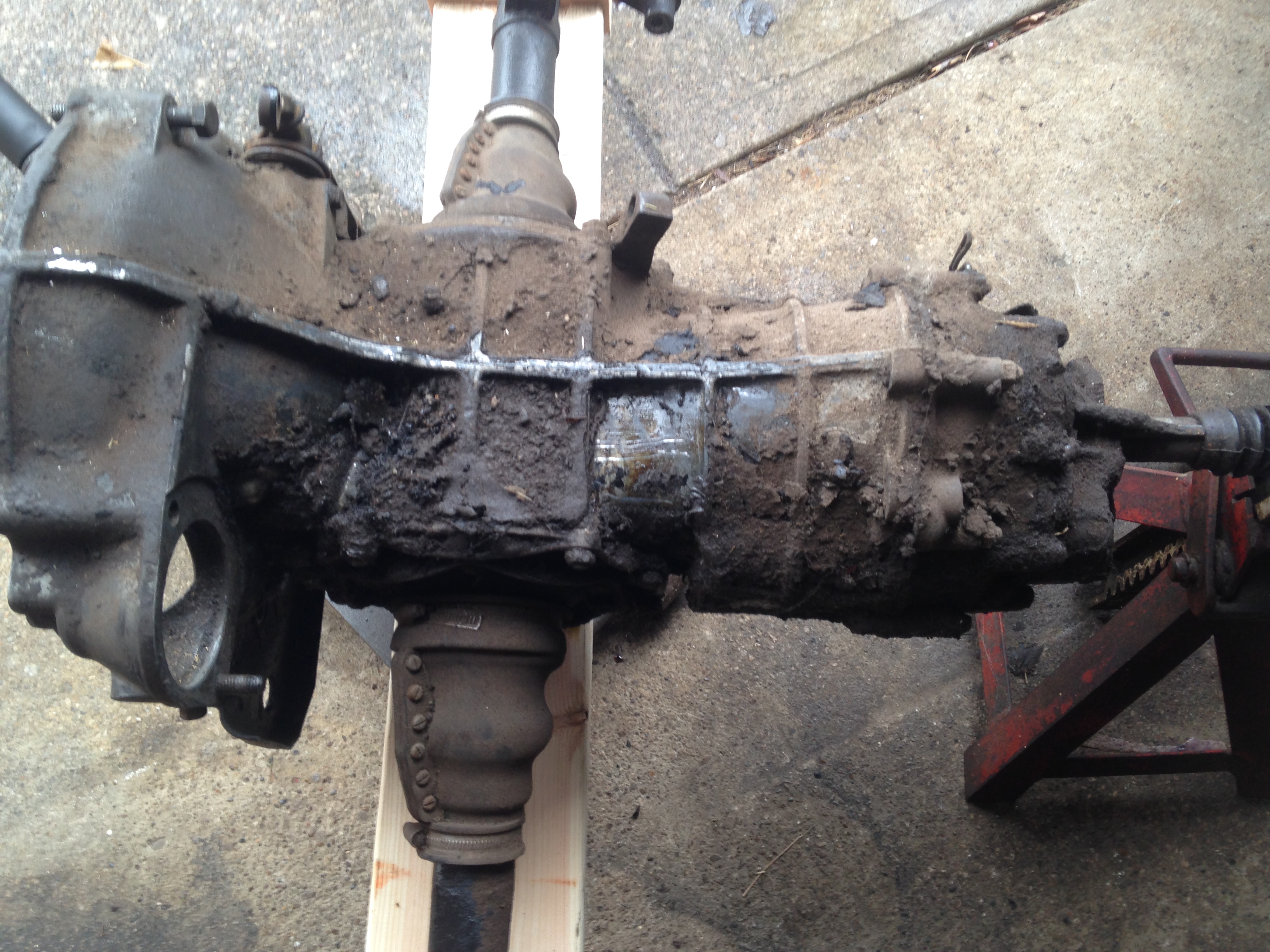

Love the wooden jig. :D My tranny was scuzzy as hell, too, and I wirewheeled it which makes it look like chrome. It also wipes out the synchros when you clean it too well, take it from my experience. ;)

Dual Port wrote:Love the wooden jig. :D My tranny was scuzzy as hell, too, and I wirewheeled it which makes it look like chrome. It also wipes out the synchros when you clean it too well, take it from my experience. ;)
The wooden jig was born out of necessity a few years ago. It makes pulling the transaxle out by yourself with just a floor jack a breeze.
It's a flat 2x6 with notched 2x4 at each end that "cradle" the axle tube. Side to side balance is perfect, and you just keep a hand on bell housing to keep front to back balance. You can also set it on 4x4s on a furniture dolly to make is easier to move around, or put it up on Jack stands like I did to work on it.
It cleaned up really well. I used as little water as possible.
Only scraped it, then used brass, stainless, and nylon brushes on it with purple power degreaser. Then a quick blast with a garden hose. Gotta love being able to use the hose at the end of December :)
