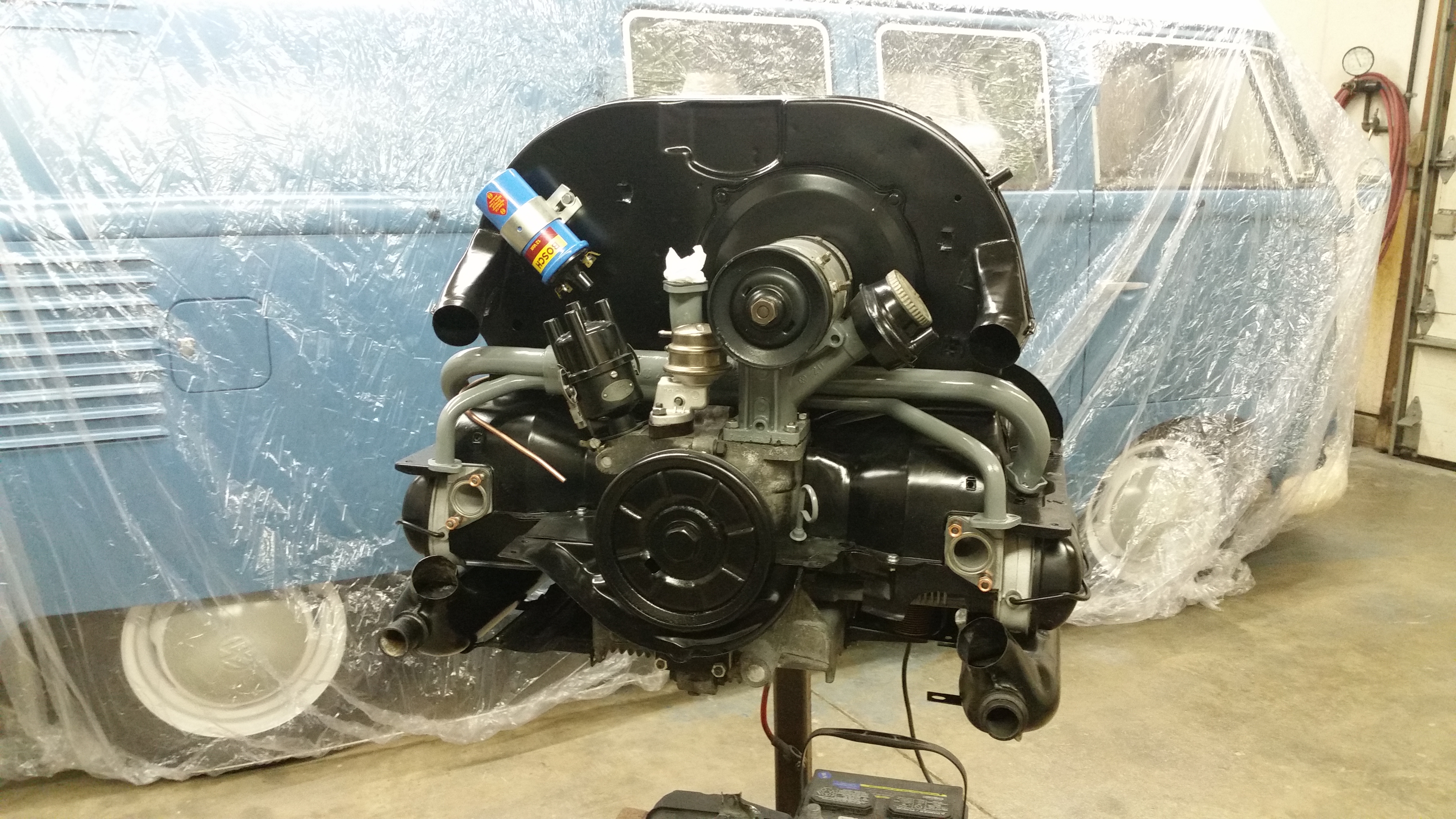

The new engine has been test run and almost ready....
I was planning on having to use the adapter to get the heat to work.
Thanks for all of the help on the engine Kirk. I will be scheduling a pick up soon!
