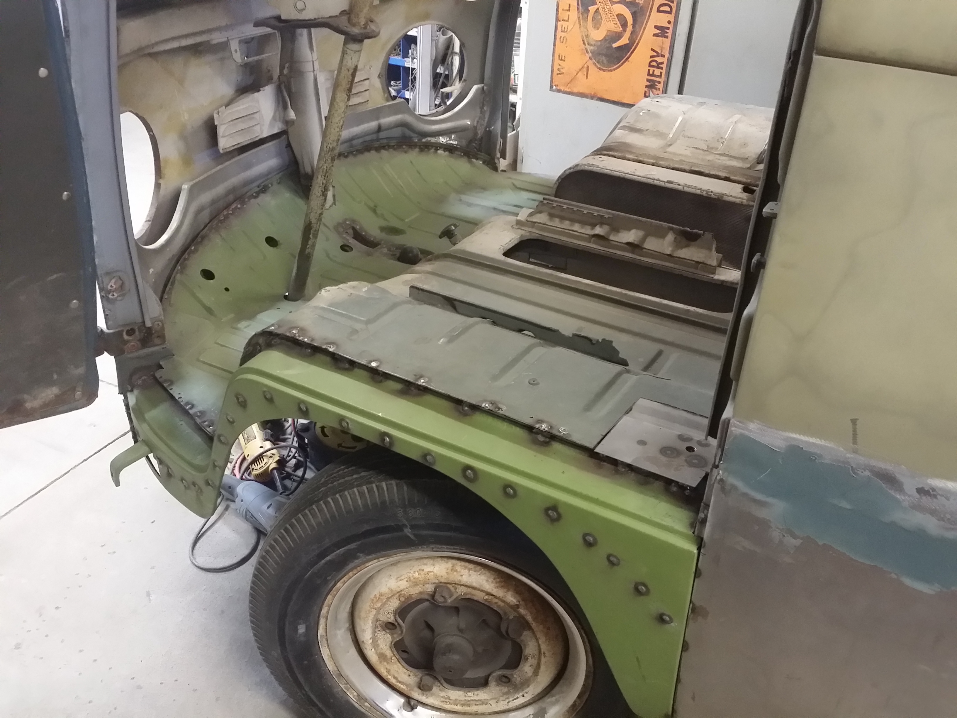

Plugging away
Can anyone tell me what these holes in the cargo floor are for. I assume for seat bolts?
Re: My daughters 67 deluxe
Seat belt anchors?
Posts: 910
Ken wrote:Seat belt anchors?
Correct. 66 and 67 had them and possibly 65 and 64.

The holes end up right on top of the I beams....is there a bolt with some kind of special backing plate that you weld to the I beam?
Could someone take a pic if they have this setup in og form?
