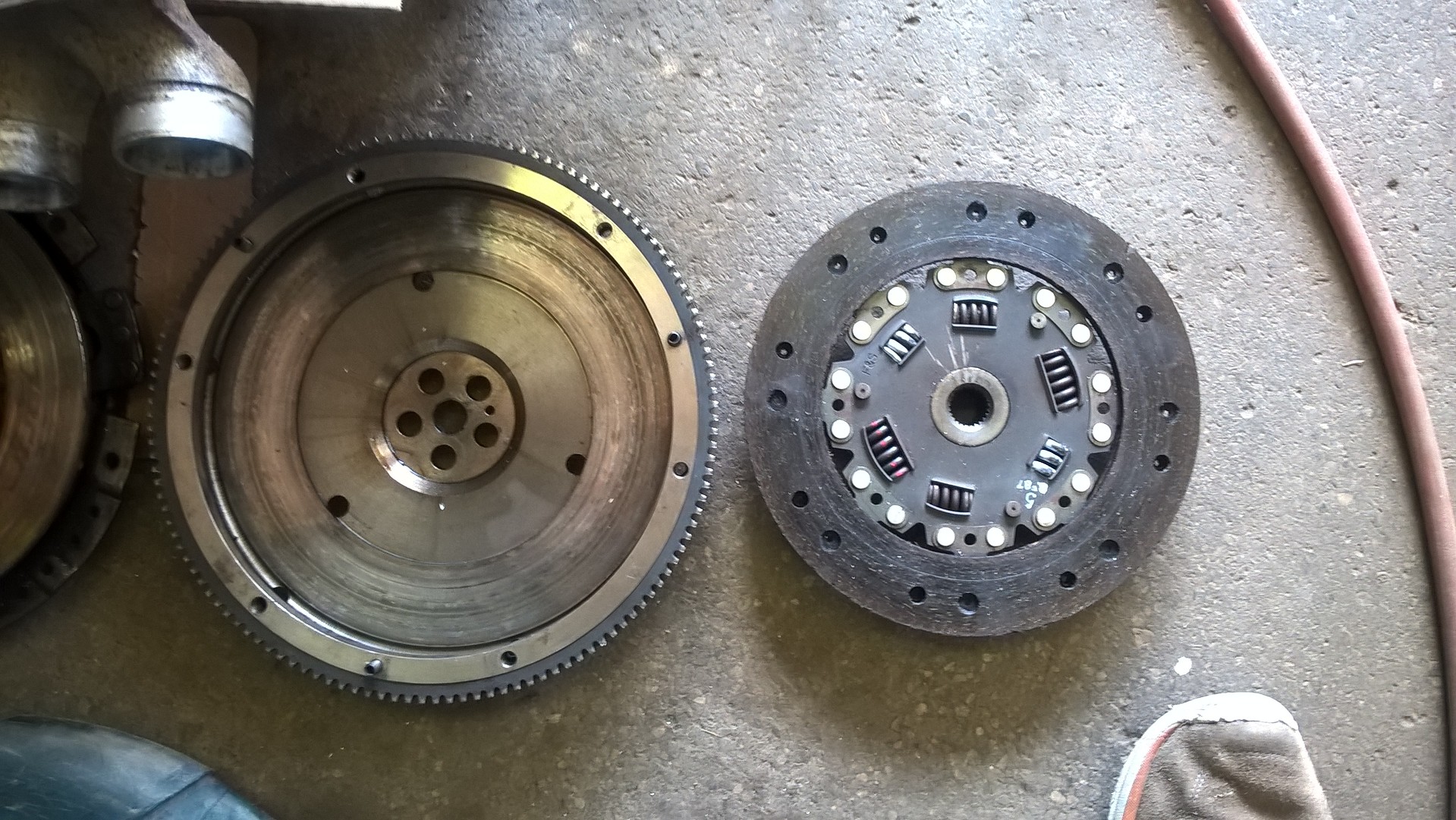

bus came with a weird clutch disk with continuous facing
got replaced with a proper one
and new pressure plate
