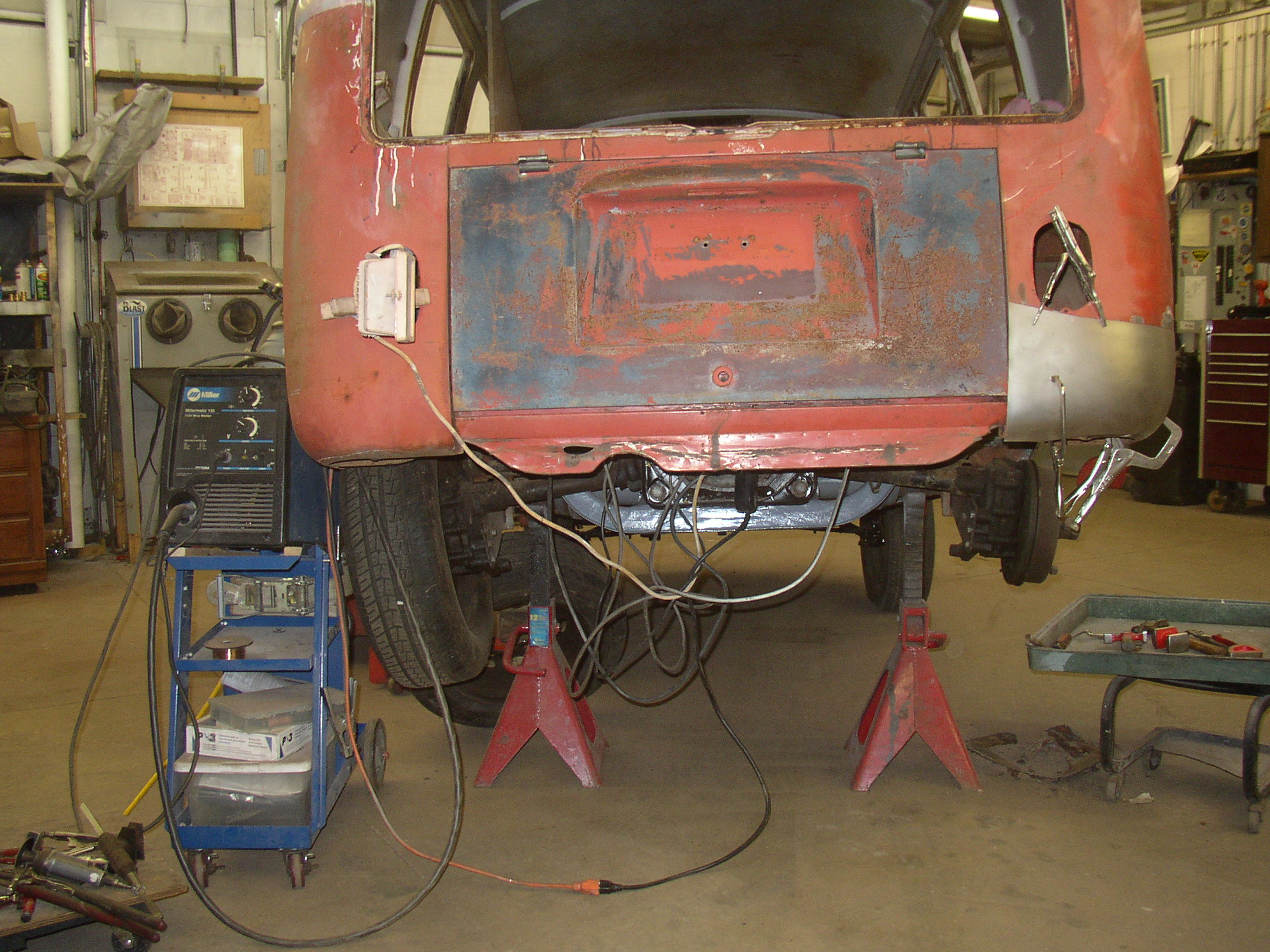

I’ve been kind of busy with work crap, like writing two new classes. For you techheads you might get a kick out of this- I built 5 demo boxes to use in class that consist of a late Powerstroke 6.7 ECM, power supply, and 2 DLC connectors for scan tools. This will let us have 10 (5x2) live Ford IDS scan tool setups in class for teaching how to use the software. It was fun to build these but it took waaay longer than I thought it would.

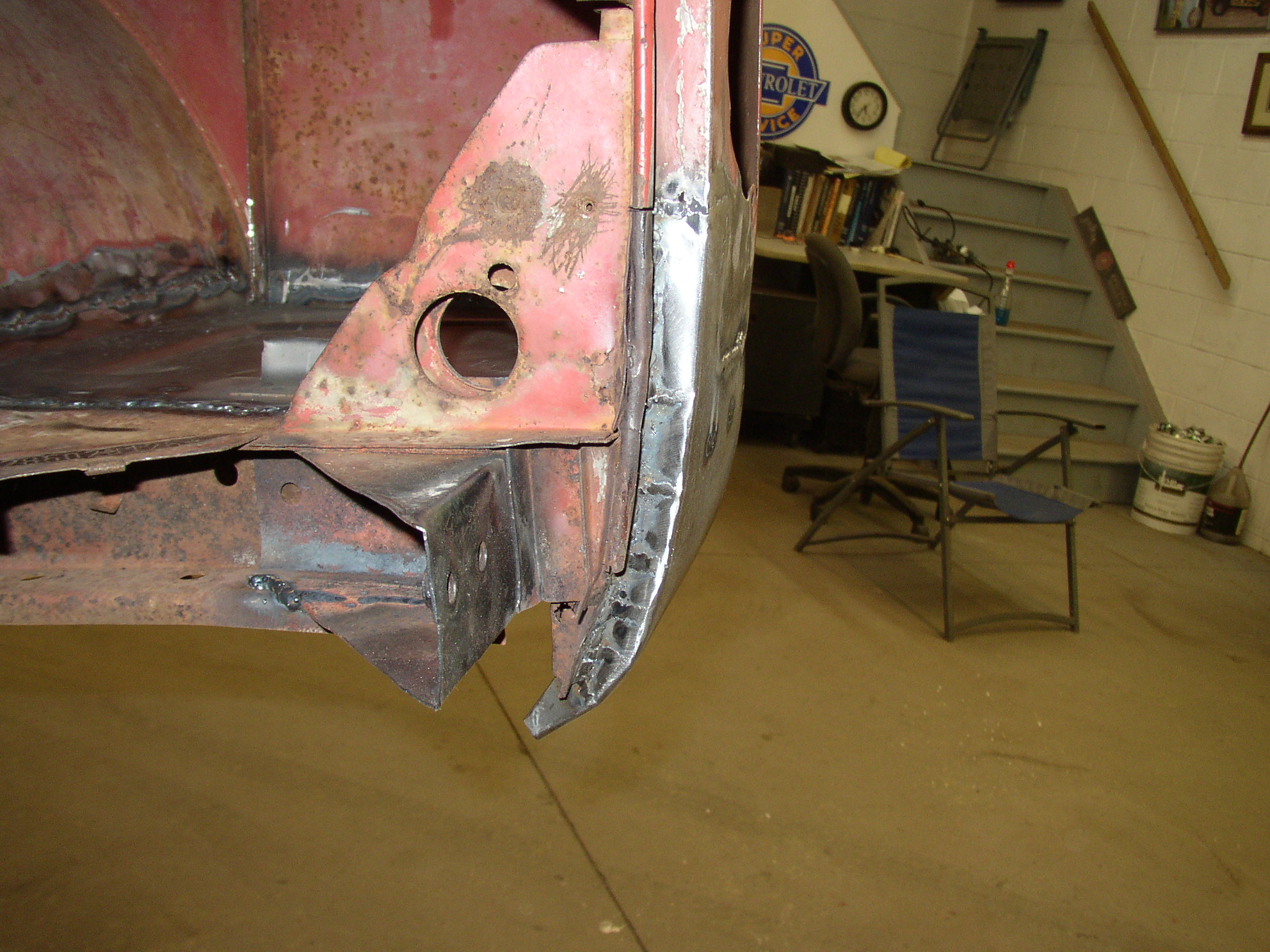

Anyway, back to the bus. The RR corner was next and it was crumpled up from a light hit. My gut instinct is to not cut the crumpled metal off, I generally straighten it back to near-correct before cutting so I don’t get too much going on at one time. So I took my monster wire wheel/bondo/flesh remover and took off all of the bondo, which takes about 30 seconds. Then I hammer and dollied out the crumpled metal until it resembled the correct profile.

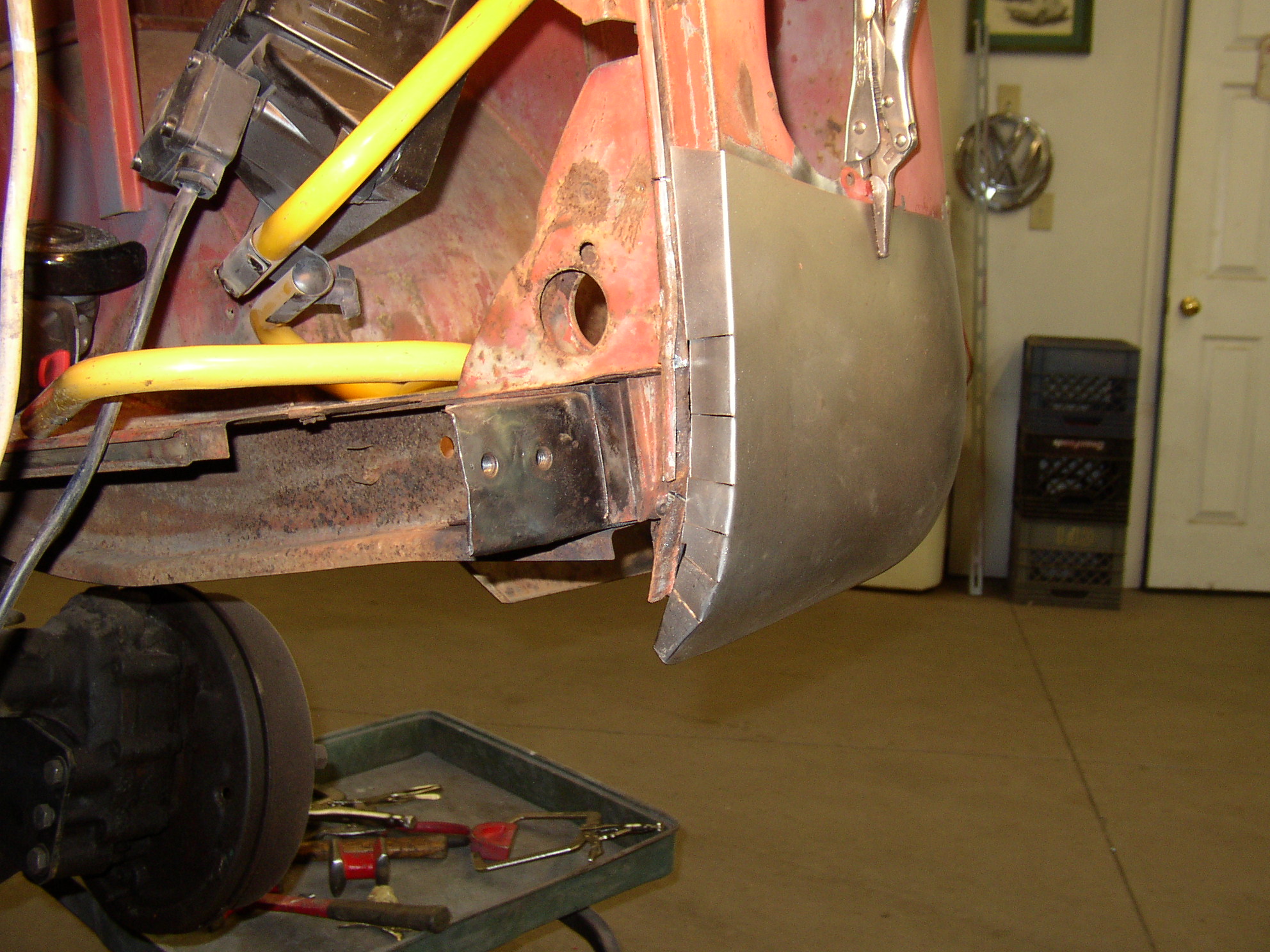

I then cut the wasted portion of the metal away and started eyeballing the new panel, which was the curved section and not the flange next to the engine lid.
I cut reliefs in the edge of the metal and folded them over to create the curved flange needed. I put a piece of I-beam in the vise and clamped a hunk of angle to it to create my hillbilly brake.
About this time I realized I needed to have the engine lid and rear apron in place to get my gaps right. Both were somewhat mangled and took some time with a hammer, dolly, and long I-beam to make them usable again. When I went to mount the engine lid a previous “tech” had broken both screws off in the nut plate. I intended to get these out with the welder so I sandblasted them to get a good weld started.
When I hit the welder trigger the wire would just bounce off of the bolts! Both had no continuity to ground, even though they were frozen in place. Rust, ugh. Using a DVOM one had 10KΩ resistance and the other was infinite. This require me to cut open the back side of the hinge panel to access the nut plate.
From there it was easy, glow it, remove the stubs, chase the threads, straighten it, and reinsert it.
It also need some hammer/dolly work where the “tech” tugged and twisted the engine lid in anger trying to get it free. This guy did a shitty job of drilling out the hinges, too, which required me to re-do his work. That meant glowing the hinge, removing the pins, brazing the hole up to fix his sloppy work, and drilling it back to correct size with new .225” stock as a pin in the drill press.
A dot of braze keeps the pin from walking out.
Oh well, it’s now back on, works well and has good gaps.

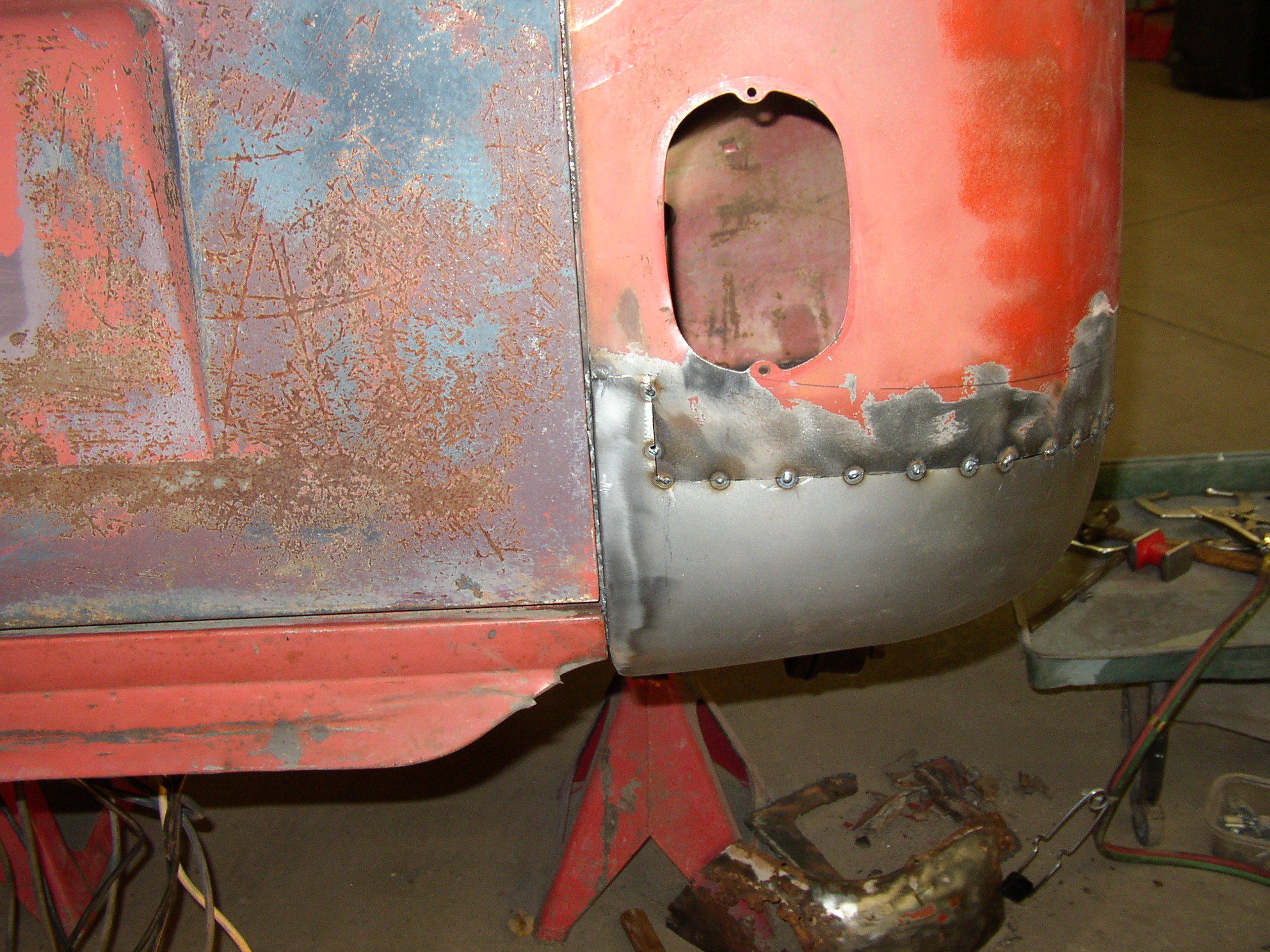

Here I’m test fitting the piece, the big flange in the foreground was also mangled pretty good so I glowed it, straightened it, and welded it back where it belonged.

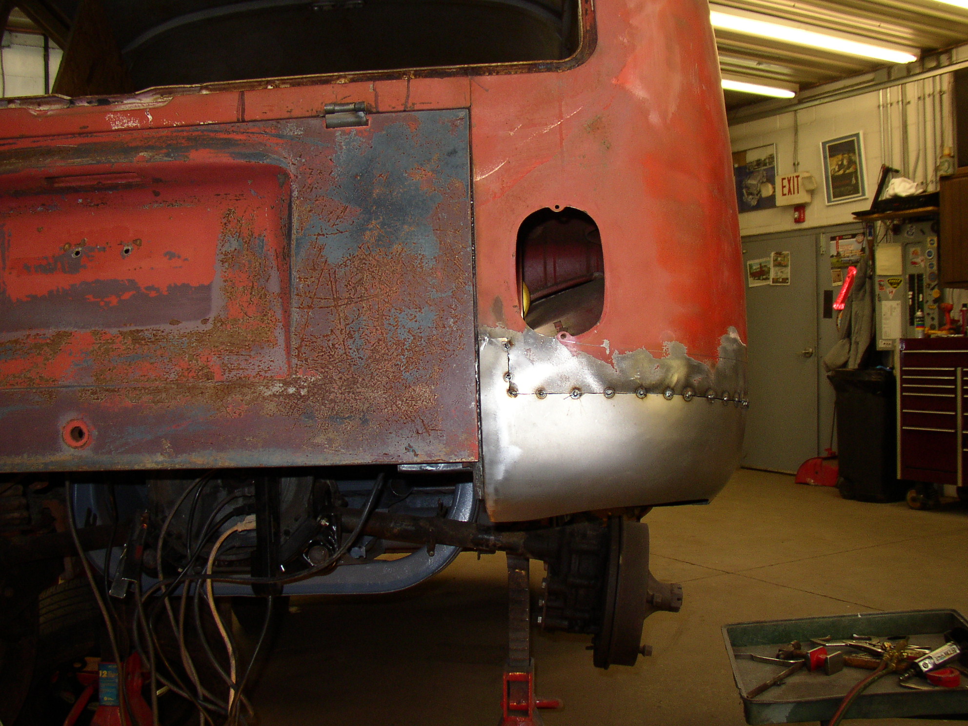

Here the corner is tacked in with the lid and valance showing the gaps are good. No overlaps here, those panels are butted with zero clearance.
Welding….

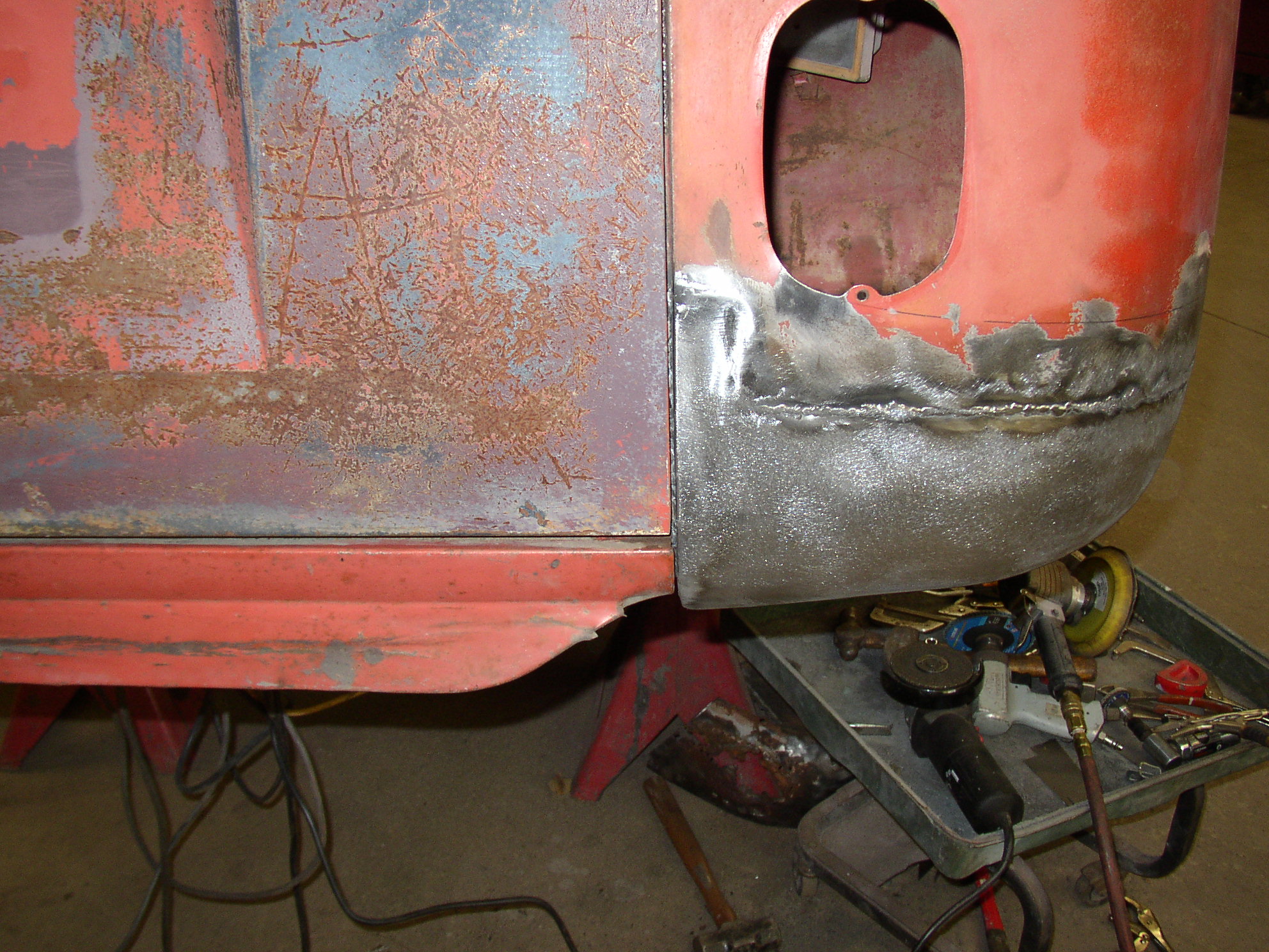

Fully welded and rough ground, nice gaps.
Here you can see the relief cuts welded together. A bit more finish work and this won’t be visible at all.

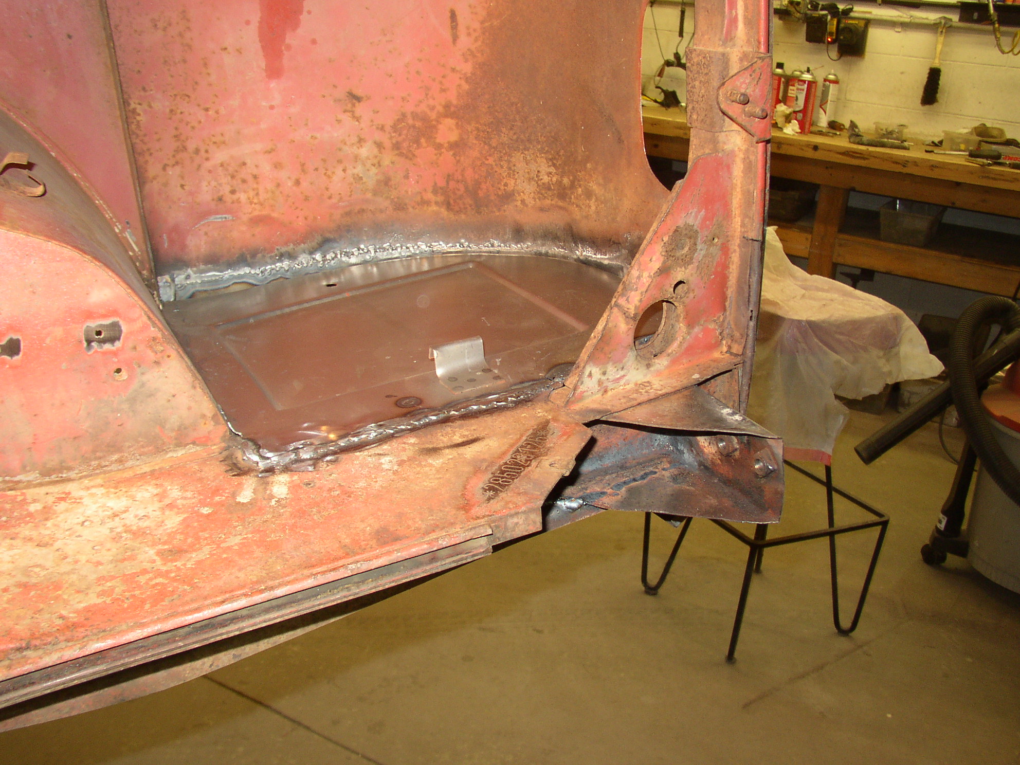

Here I’ve welded in a new bottom in the spare tire tub. The sides were pretty pitted so I reinforced them with epoxy paste rather than replace them. I’ll drill a couple of drain holes so if water gets in (which it will) it won’t float the spare tire around. Image

Here I’ve cut the floor out, note the driver’s step area is rotted and the lower A pillar has a big hole in it, I’ll address those soon.
I’ve cut out the rotted piece in the driver’s step but for some reason it doesn’t show up well in the pic. Take my word for it, there’s a big fing hole there. I also cut the lower A pillar out where it needs a patch. I take a piece of cardboard and template the replacement pieces.
I then transfer this to .032” and rough it out, bend it in my “brake” and fit it using the flap wheel. It needs a little bit more trimming here to get it butted and not overlapped. Image
Here it is welded and rough ground using the hard wheel and flap wheel.
Lather, rinse, repeat on the right side but this one’s a bit tougher cause the A pillar is a bit worse.

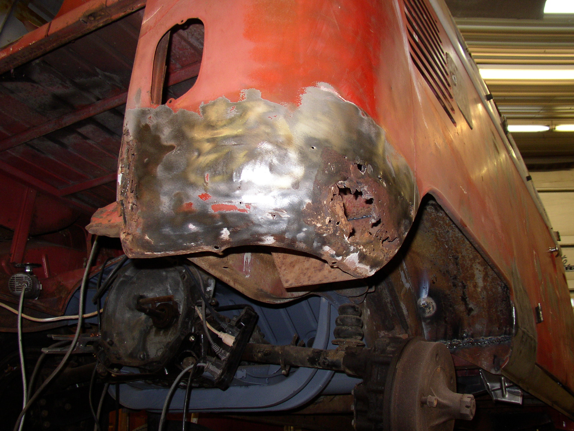

On to the long rocker while I’m waiting for the panel bond to show up. Here I’m cutting all of the crap metal out, which was quite a pile. The same deal goes for the spot welds and etc, and once it was roughed out I rolled the bus outside and sandblasted the left rocker area and front floor area to get the rust scale off. (no pics of sandblasting)
Here I’m test fitting the new panel, the first one I bought was from CIP1 and I though it was poor quality so I ordered one from WW which was only slightly better. I think AutoCraft was out of stock.
