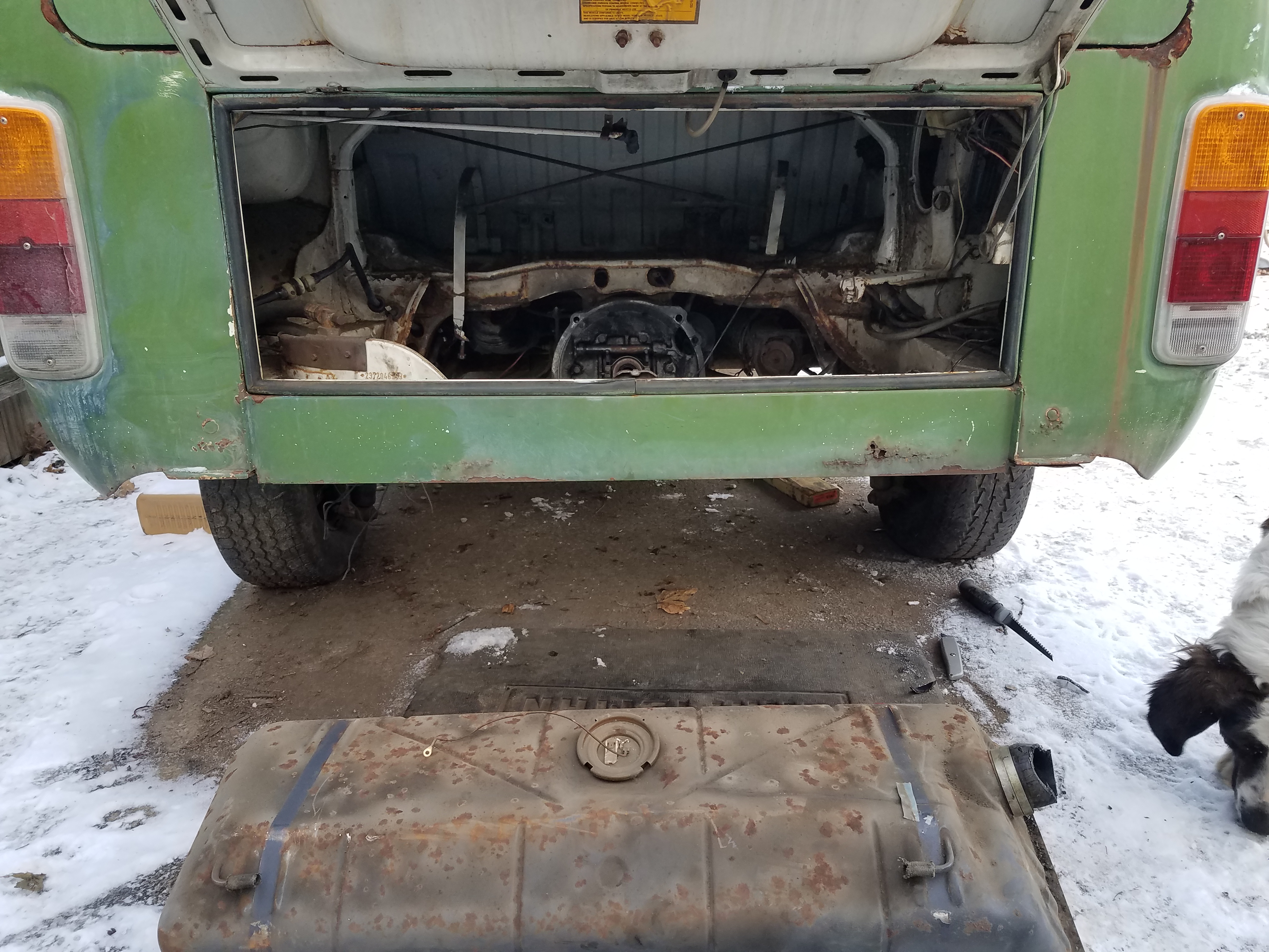

Having a really tough time getting the gas tank out, the filler hose coming off the tank is stuck
Cut it. Replace with a tank to neck hose off of a Dodge Sprinter van, about $15 and good for today's fuel blends.
Posts: 1390
I don't know the size ID you need, but Napa and FLAPS sell fuel filler neck hose in various diameters.

Thank you for the tips on the fuel filler neck. I will have to get in there with a utility knife, the cut off wheel I tried didn't work.

Made some progress today.
Removed the gas tank. Looks really clean inside, minimal rusting and no sludge.

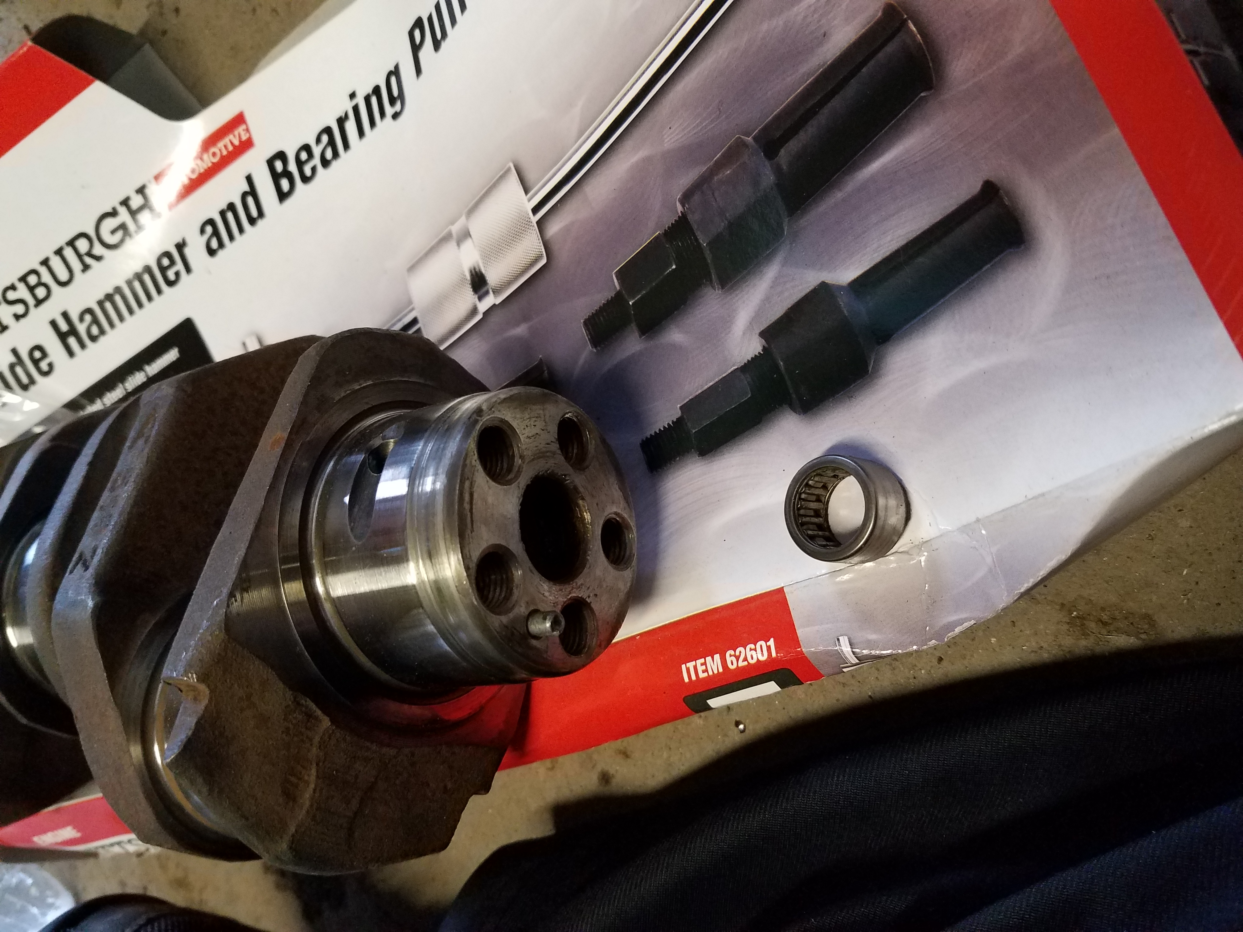

Bought a slide hammer/bearing puller kit from Harbor Freight and pulled the pilot bearing out of the end of the crankshaft

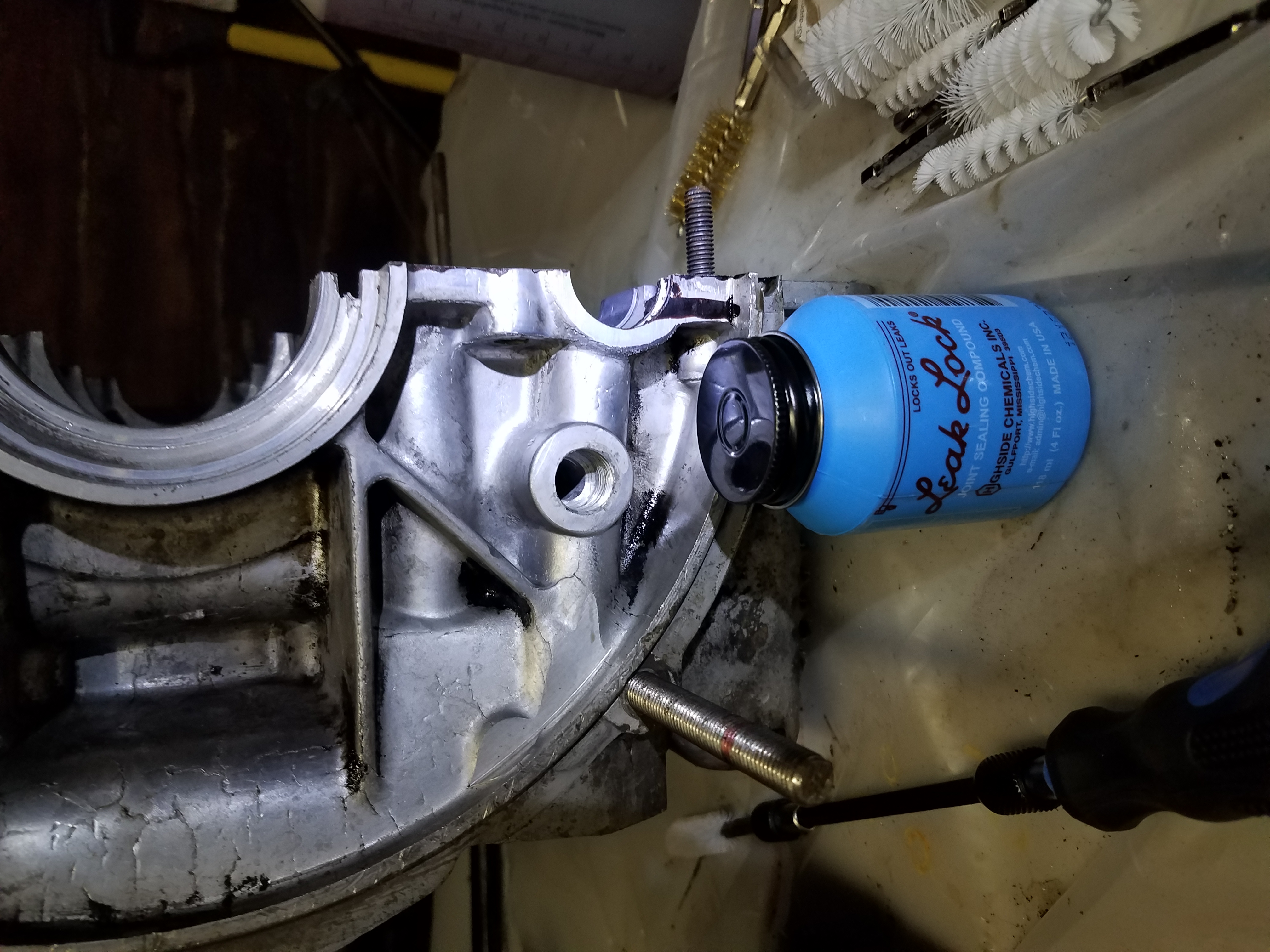

Used nylon brushes in this brush kit (also from HF) to clean out the oil gallerys
Sealed all the oil gallery plugs with Leak Lock.
Cleaned up the case some more.

Built up the crank, mostly. Hung the rods and got the #3 bearing along with both gears onto the crank. The rod nuts need to be torqued to 24 ft lbs, I only have torque wrenches 10-200 in lbs and 50-250 ft lbs so I'll need to find and buy one tomorrow. I'll also need to buy a pair of snap ring pliers to fit the crank's snap ring, none of mine fit.
Welding gloves from harbor freight won't stop a hot crank gear from burning you. Why I would ever trust PPE from harbor freight, I have no idea.
Kooper271
Posts: 197
Post by Kooper271 »
My bearing driver kit broke and ruined my new pilot bearing so I have to pick one up. LA Products has them in stock luckily
Building a crank without a holding fixture or bolted down vise is difficult. I also couldn't find an appropriate pair of snap ring pliers for the crank snap ring so I spread it with vise grips and got it on like that. I was worried about stretching it too much, but the gap measured okay.
