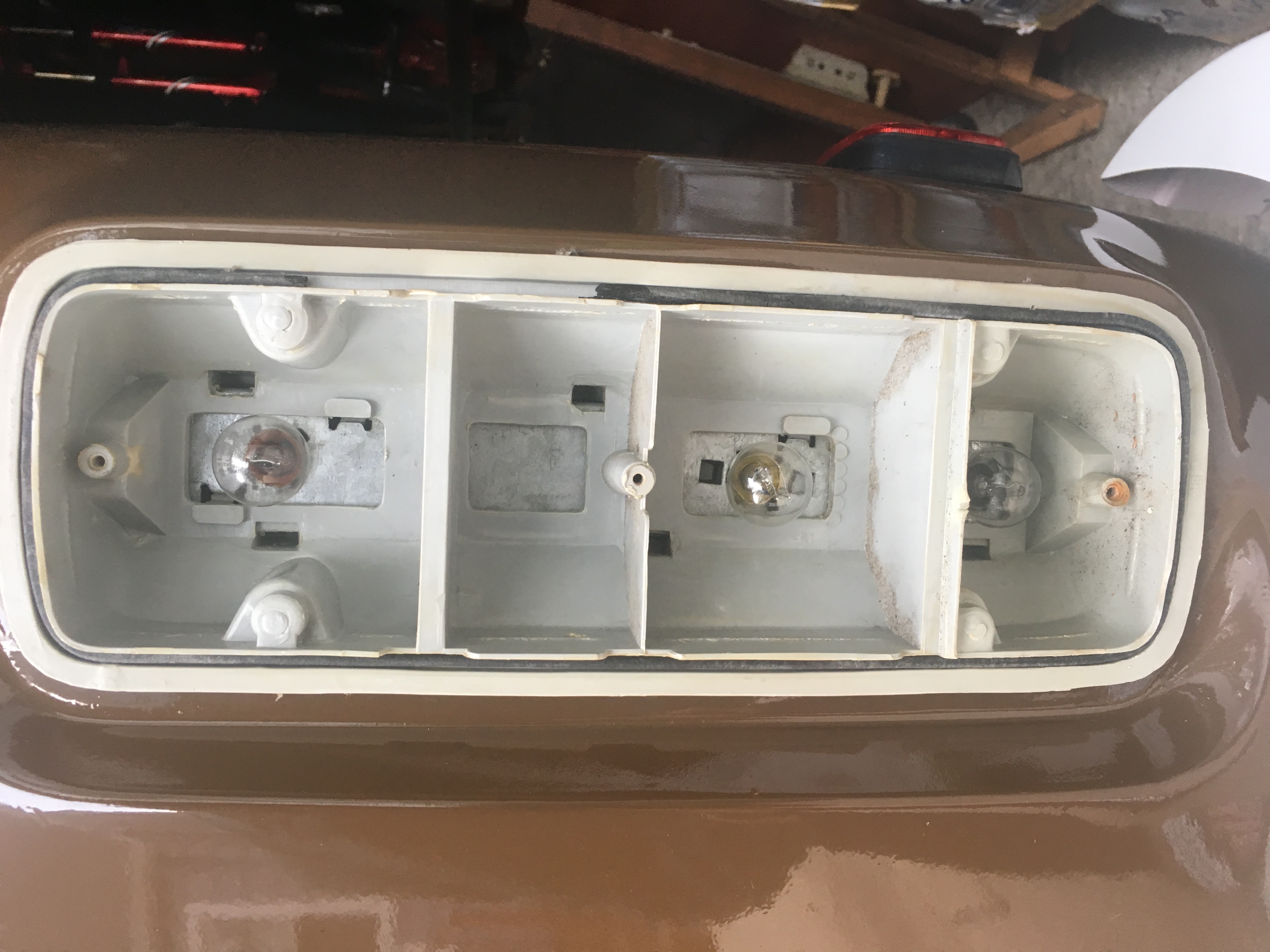

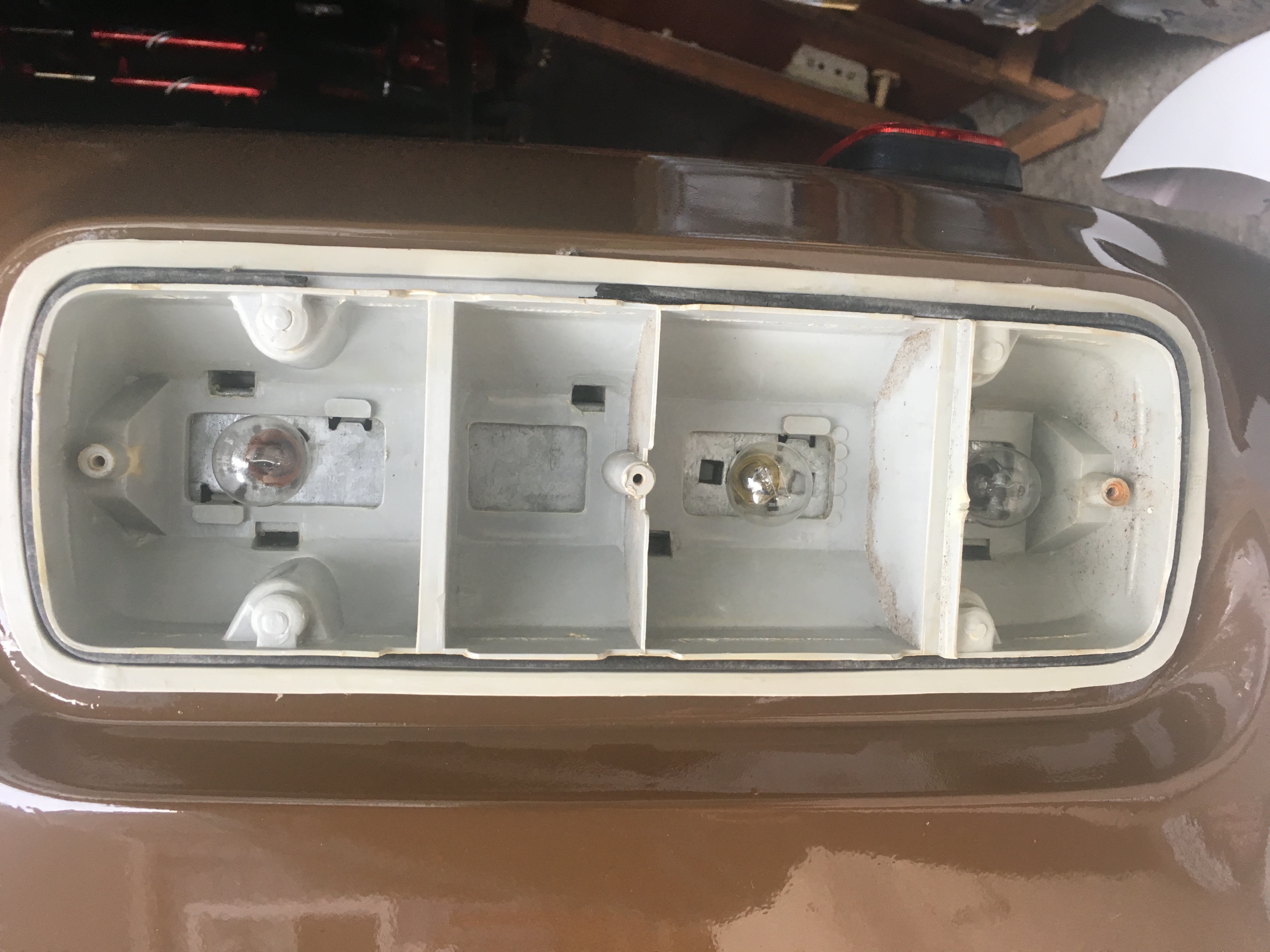

I came home after the DMV and took off the previous owners plates, which surprisingly was not that easy. I was feeling quite adventurous and took the covers off the tail lights. I can tell I need a new bulb for one of the brake lights. I was going to call a general auto parts store and see if that is something I can just pop over and pick up? or are these vintage as well? (I know all of these questions are going to be so dumb - sorry in advance!). The left brake light will come on when the lights are on but will not come on when you hit the brakes. I took that bulb and tried in the right side and it doesn't work period. I went to my trusty manual and changed out all the brake related fuses, no dice. By the way, I am now out of 8amp fuses, are these regular fuses I can pick up anywhere? That was a lot for my first day, so I thought I would read up and start a thread on my new project to see if I can get some guidance. I'm a quick study, I just need a group of bus aficionado friends who have A LOT of patience.

All of the bulbs can be found at any parts store.
You may want to replace the housing for the tail lights. The lenses held up good to uv light but the housings generally do not.
Best quality is hella. They're probably tough to find.
Second best are the Brazilian ones from busdepot. They're around $50 or $60 each and fit with a slight modification.

The bulbs for the tail lights are 1156 and 1157 and can be found at any auto parts store.

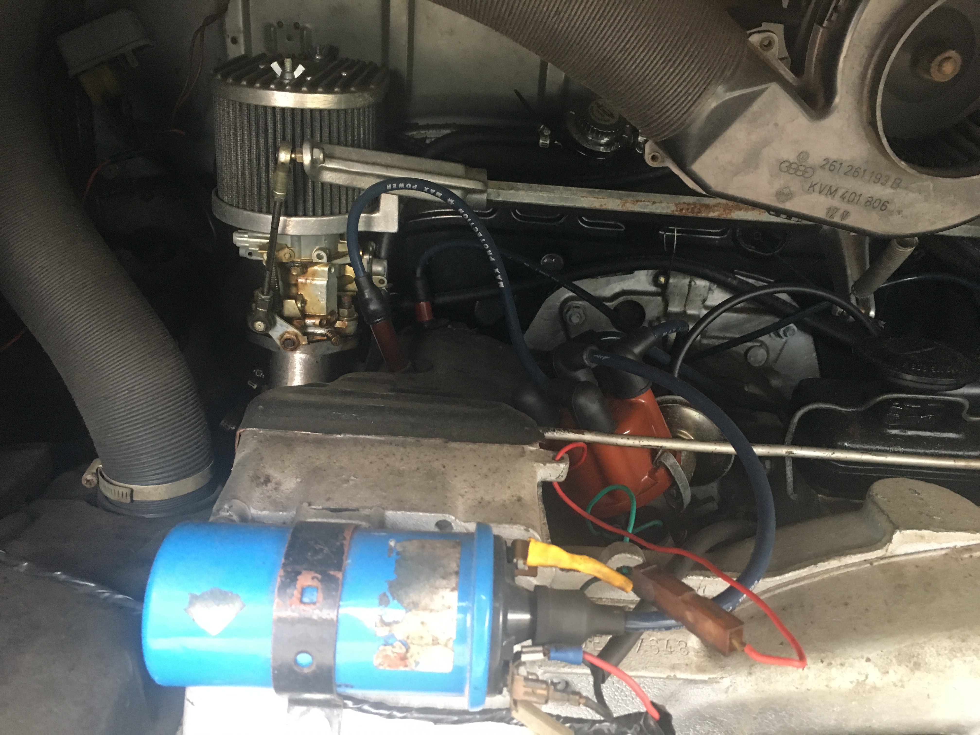

Might want to call Bruce or Chuck and pay for a comprehensive inspection before you go needlessly replacing things. The first thing on the list should be EVERY SINGLE FUEL LINE, VENT LINE, FILLER LINE, SENDER O-RING and VACUUM LINE. This will cure 80% of drivability issues and your Bus will not reek of fuel or catch on fire.
As the new owner you will need to undo years and years of hacks and band aids that have been done by previous owners and less than qualified/familiar mechanics. Even though this is a simple vehicle they were advanced for their time and not all mechanics understand how the systems operate and interact with one another.
Post a bunch of engine and other pictures and we can tell you a lot of what is going to be needed.

Sounds like your brake lite issue may not be bulbs, more likely brake lite switch ( on master cylinder) or wiring. You are going to need to learn how to use a VOM and a test lite. Or as Toolbox mentioned,contact Dualport or Chuck.

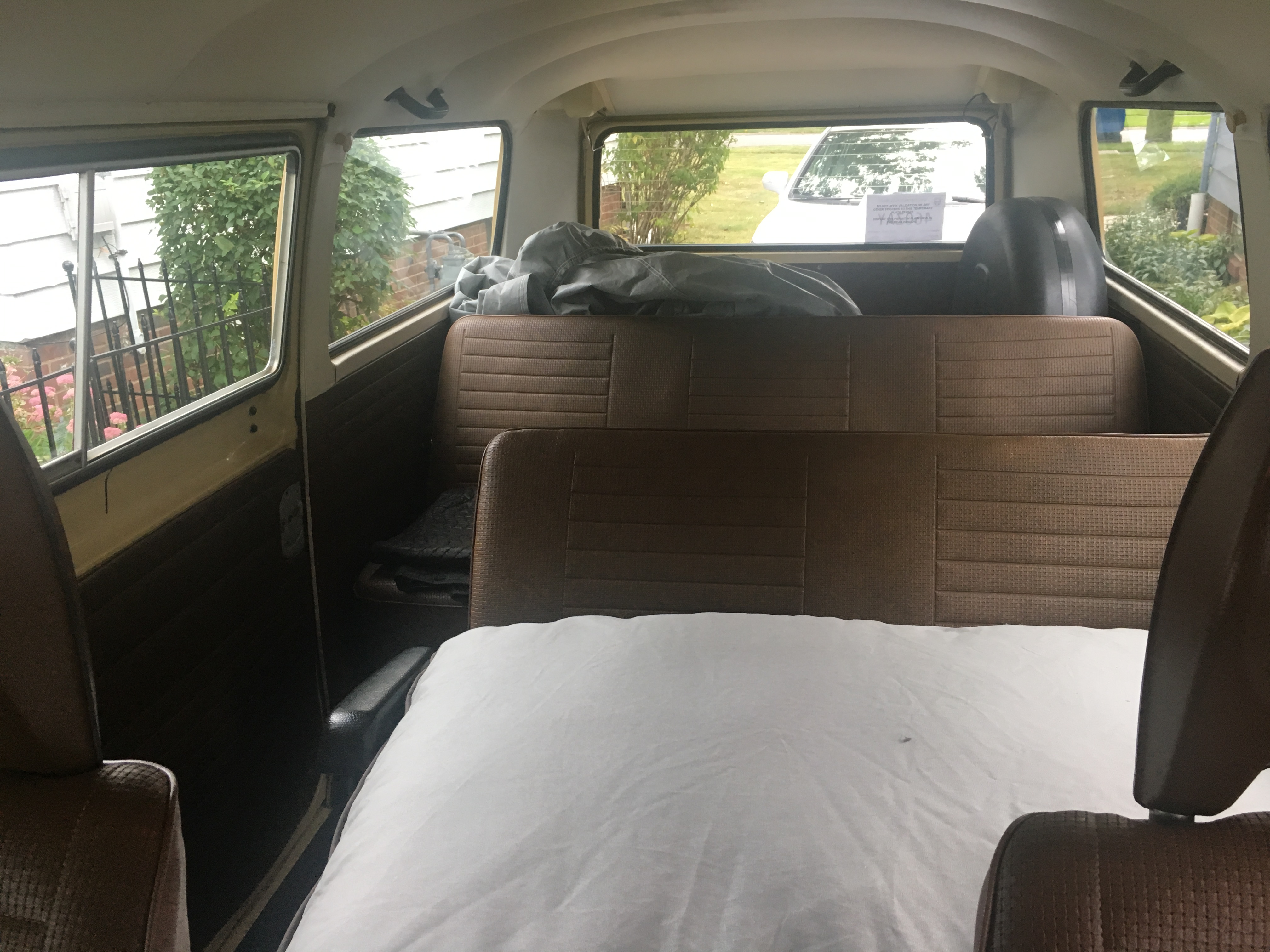

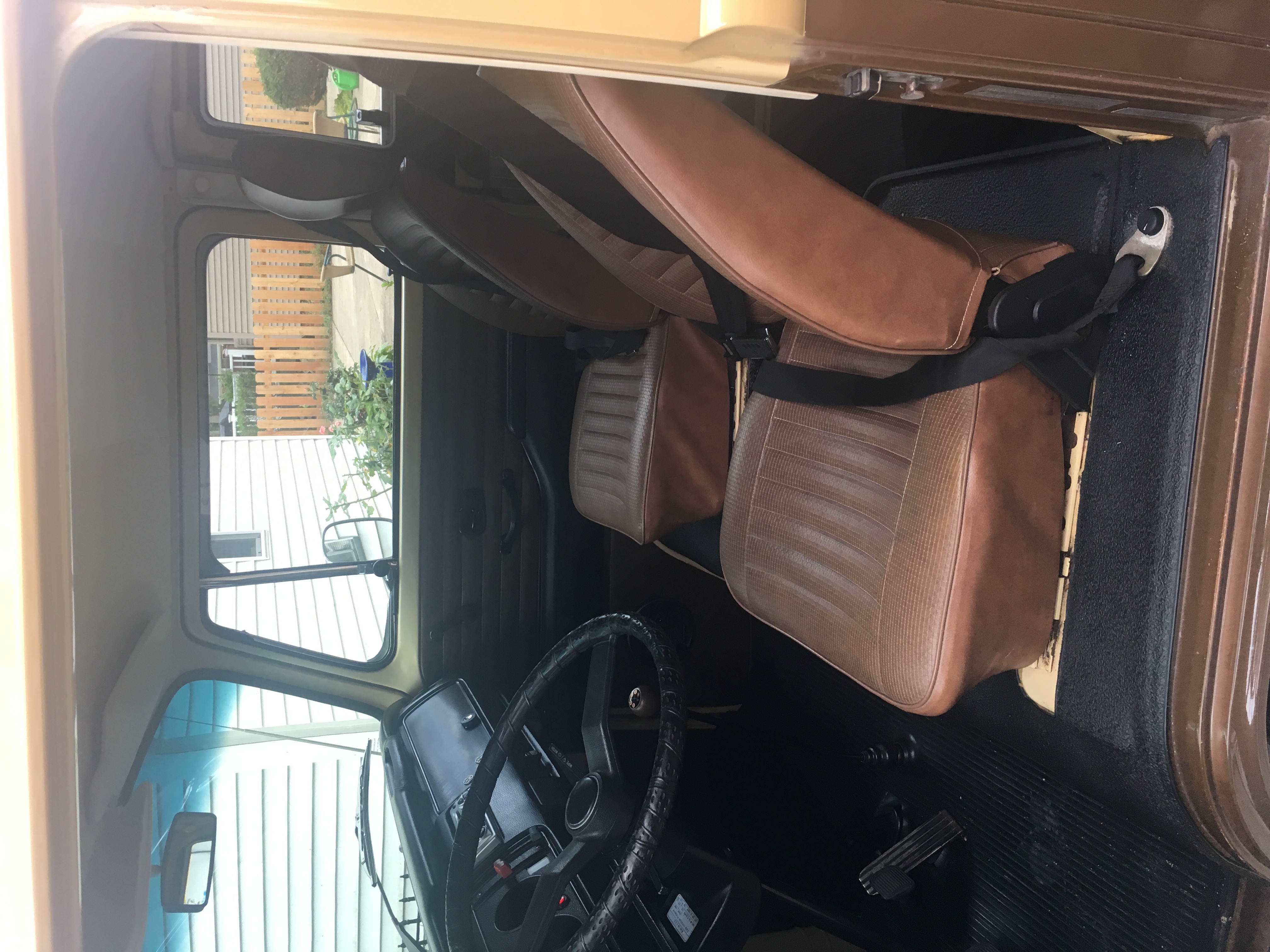

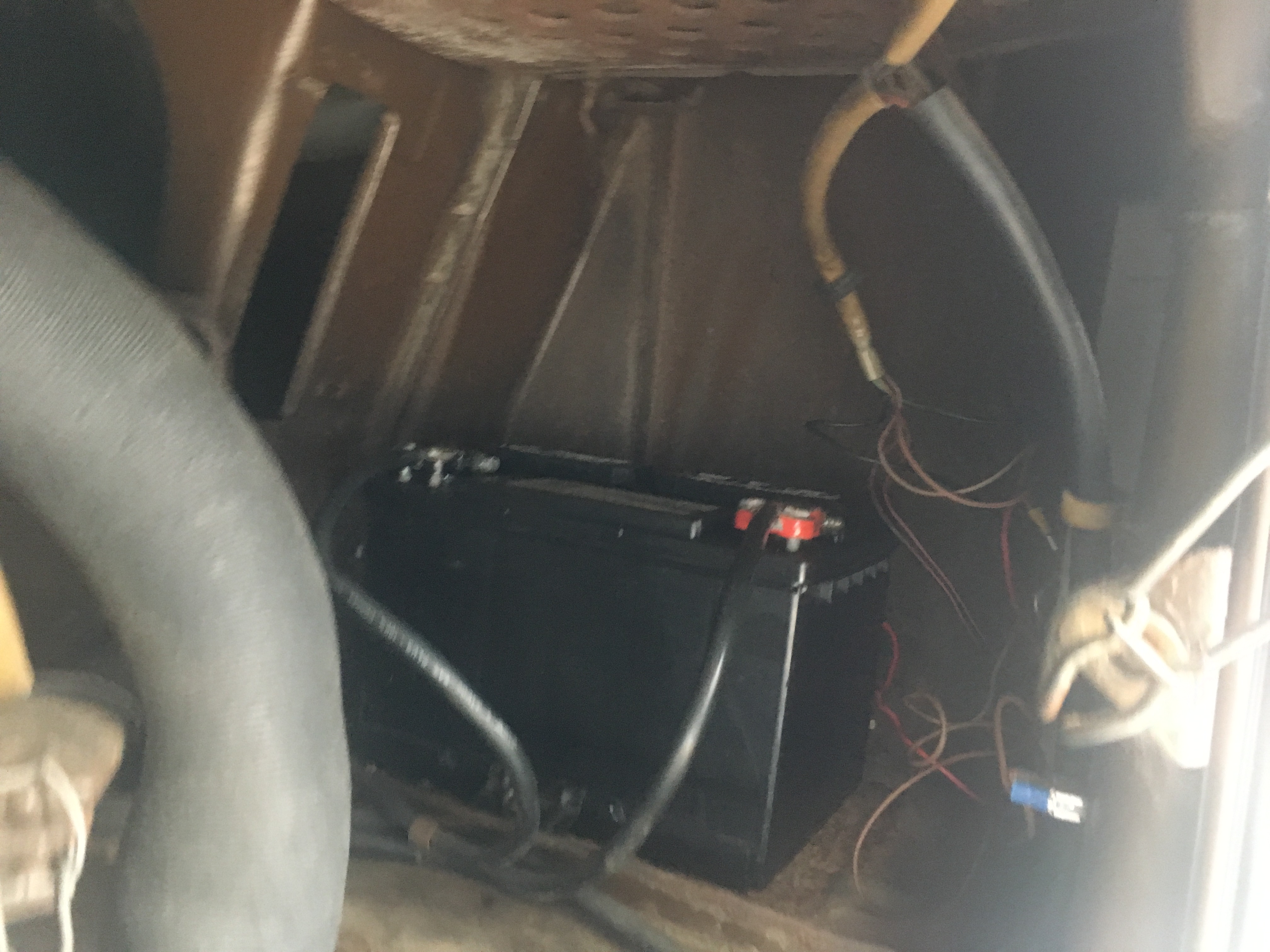

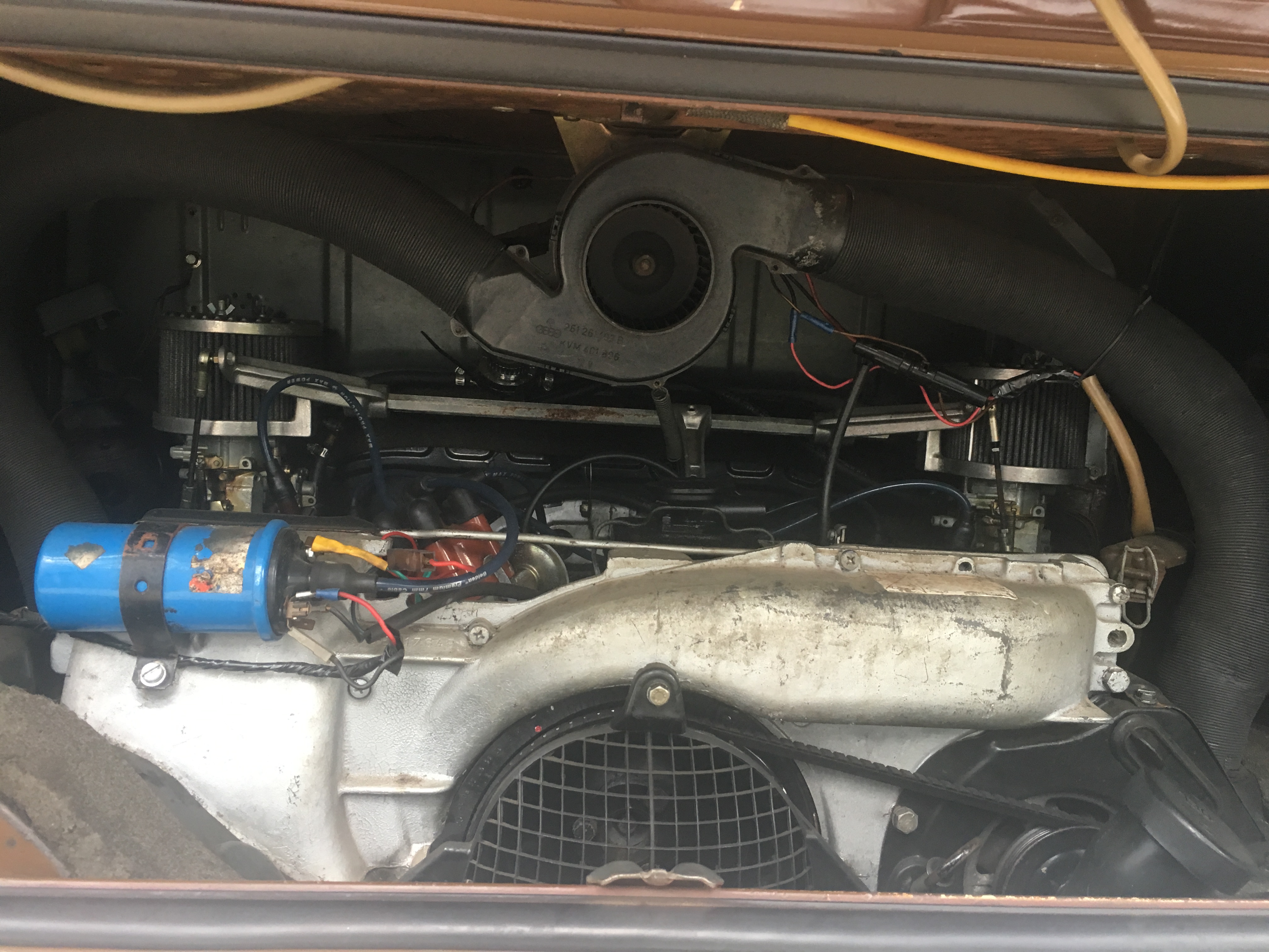

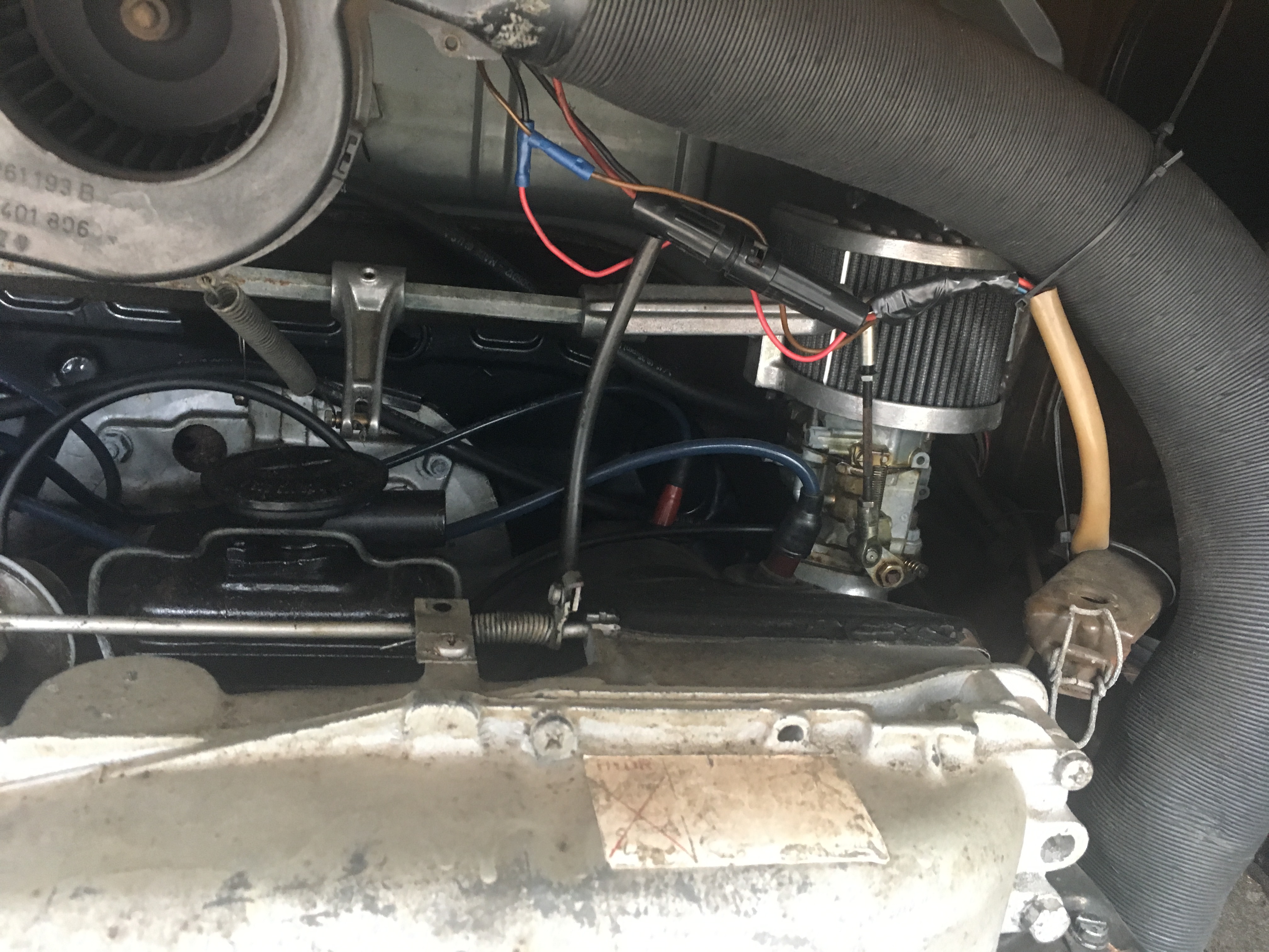

Got some photos. She runs great as far I can tell. She shifts well, starts up no issues, sounds good, etc, but then again I have no idea what I'm looking for. Husband has owned some older VWs and he says it runs well. He doesn't know much about cars either though. The only things are she does smell a little like fuel after being driven for a long period like someone pointed out so I'm sure the fuel line and all lines need cleaned, she does gurggle or cough as my mom says (who has also owned older VWs in the 60s and 70s), and the battery light comes on when I start her up but goes off as soon as you hit the accelerator.

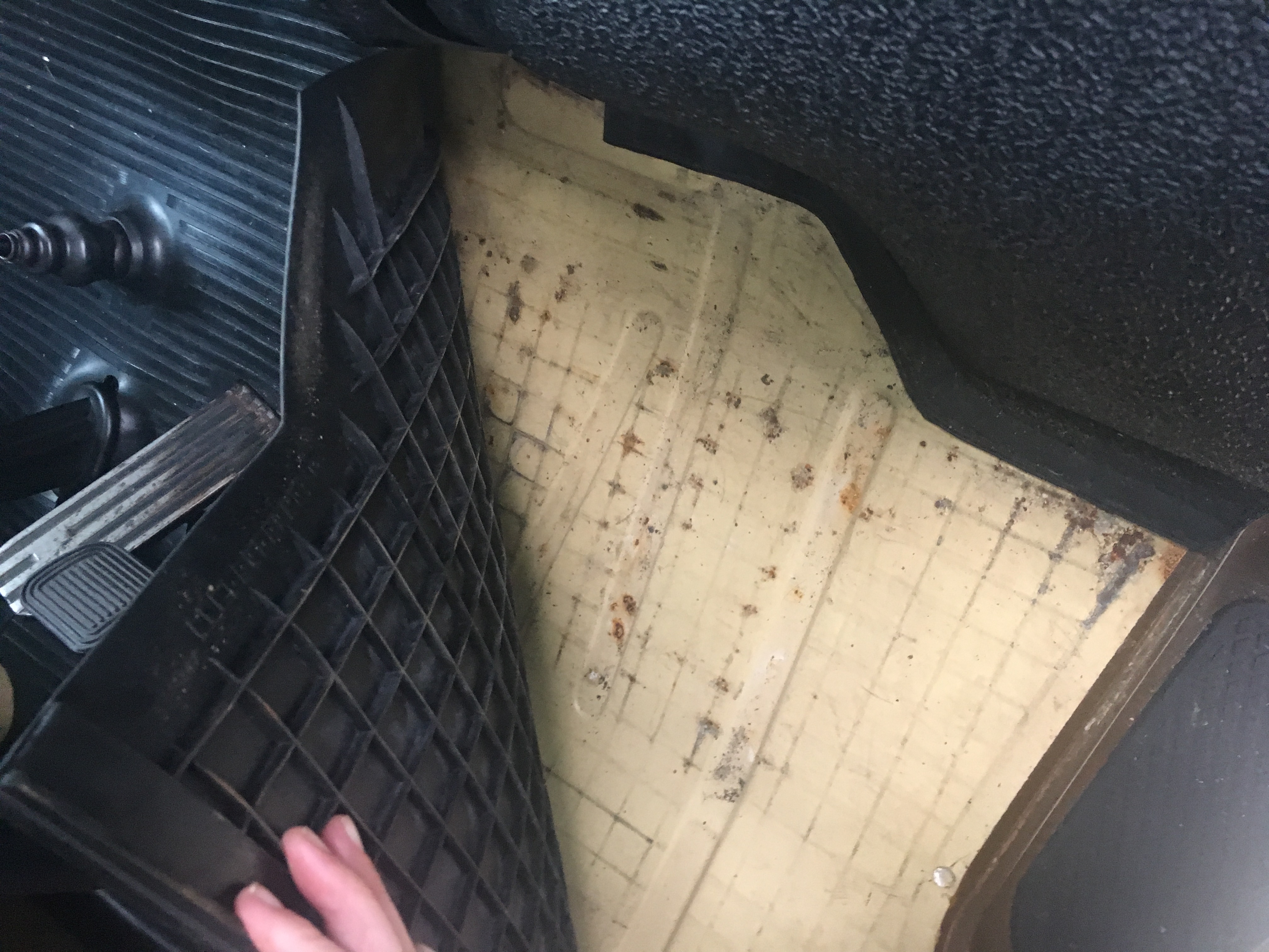

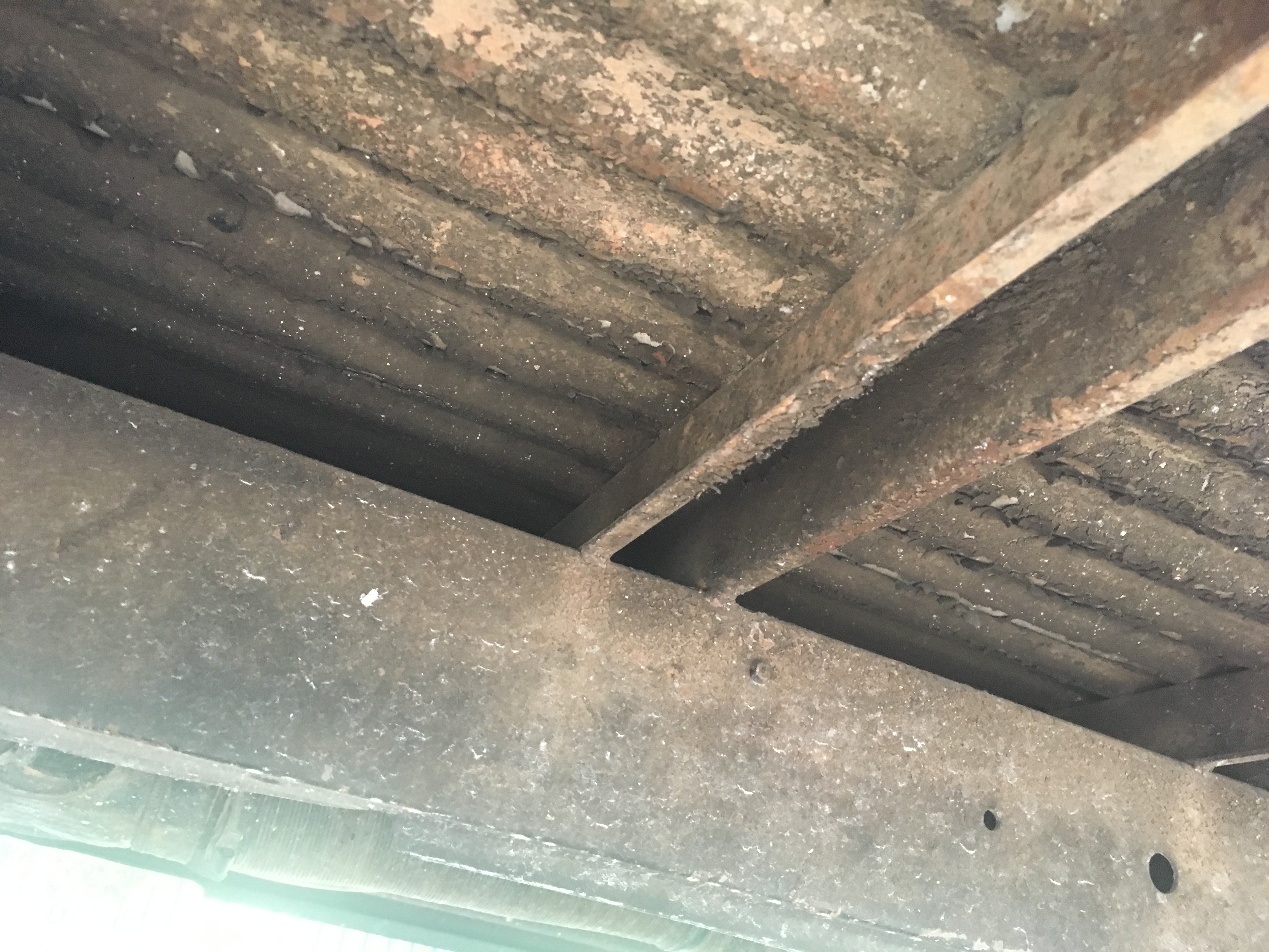

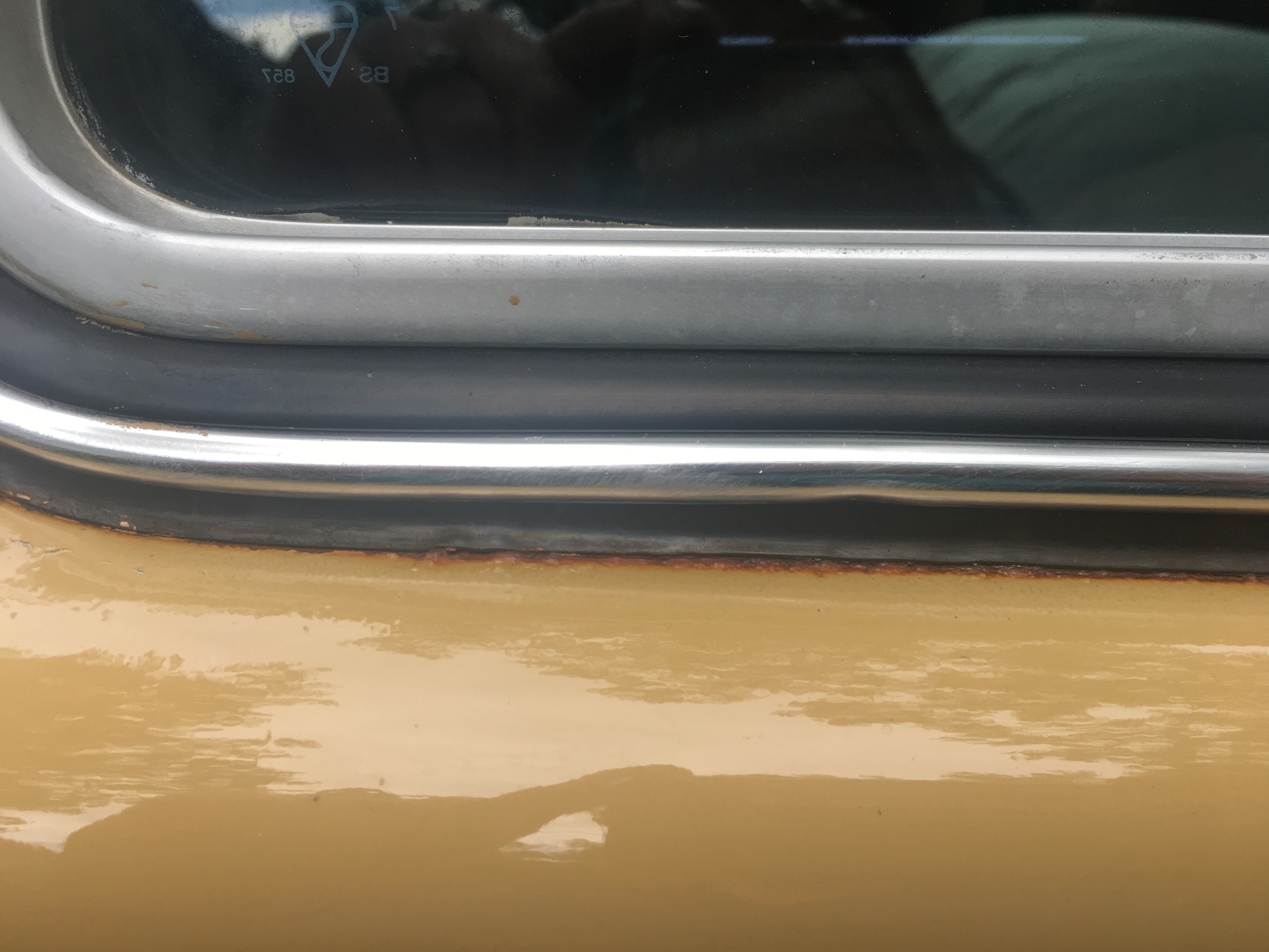

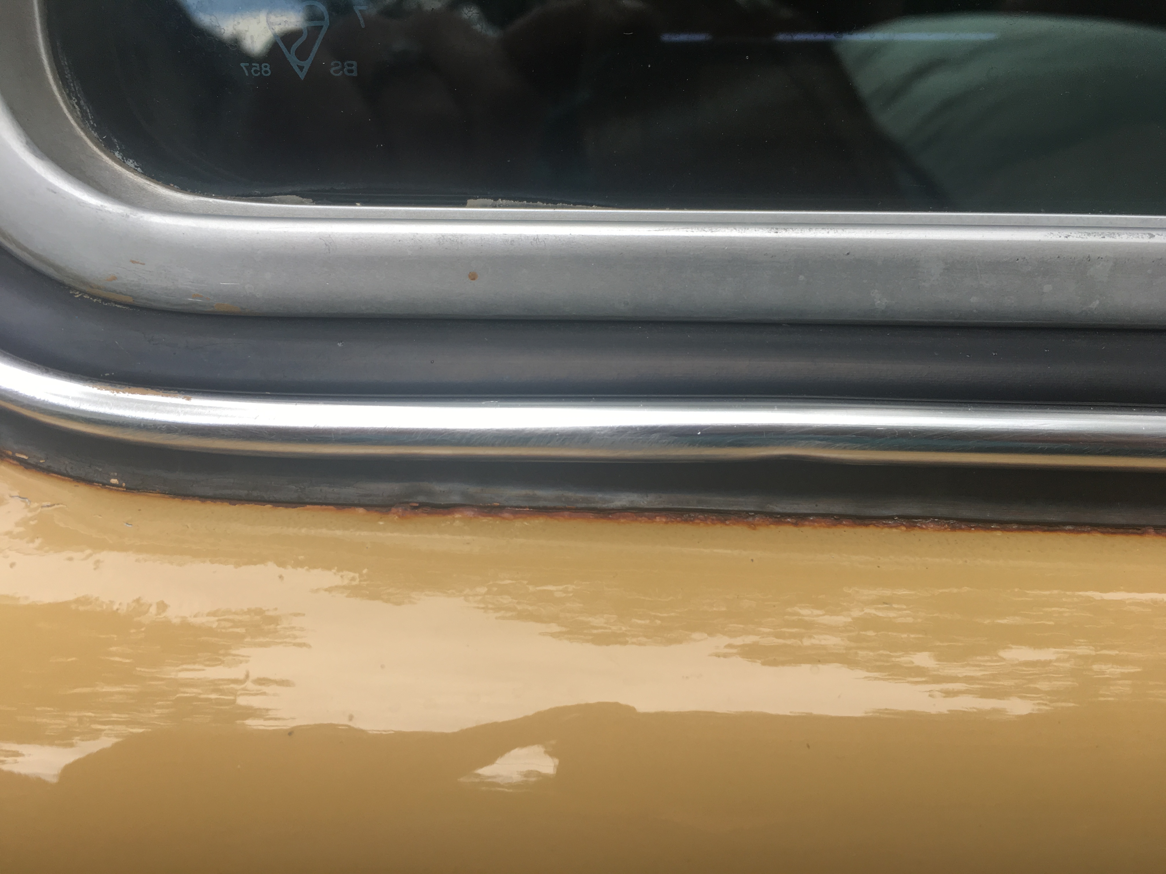

She seemed to be in great shape when I bought her. She came from New Mexico and apparently was a barn find. Interior is all original and pretty pristine. The owners here had her shipped and put less than 2000 miles on her in 10 years as it was for the wife and she never learned to drive stick shift. They didn't know much about buses either so I have no idea what work has been done by them. They did give me a huge stage of paperwork and a shoebox of little parts. The only issue I found with her were the rust areas around the windows which I would like to address soon so it doesn't get bigger. (I've added some photos of the rust). I'm guessing she is going to need new seals and they look old. The NM owner painted her and I'm guessing put the original windows seals back on but I could be wrong.

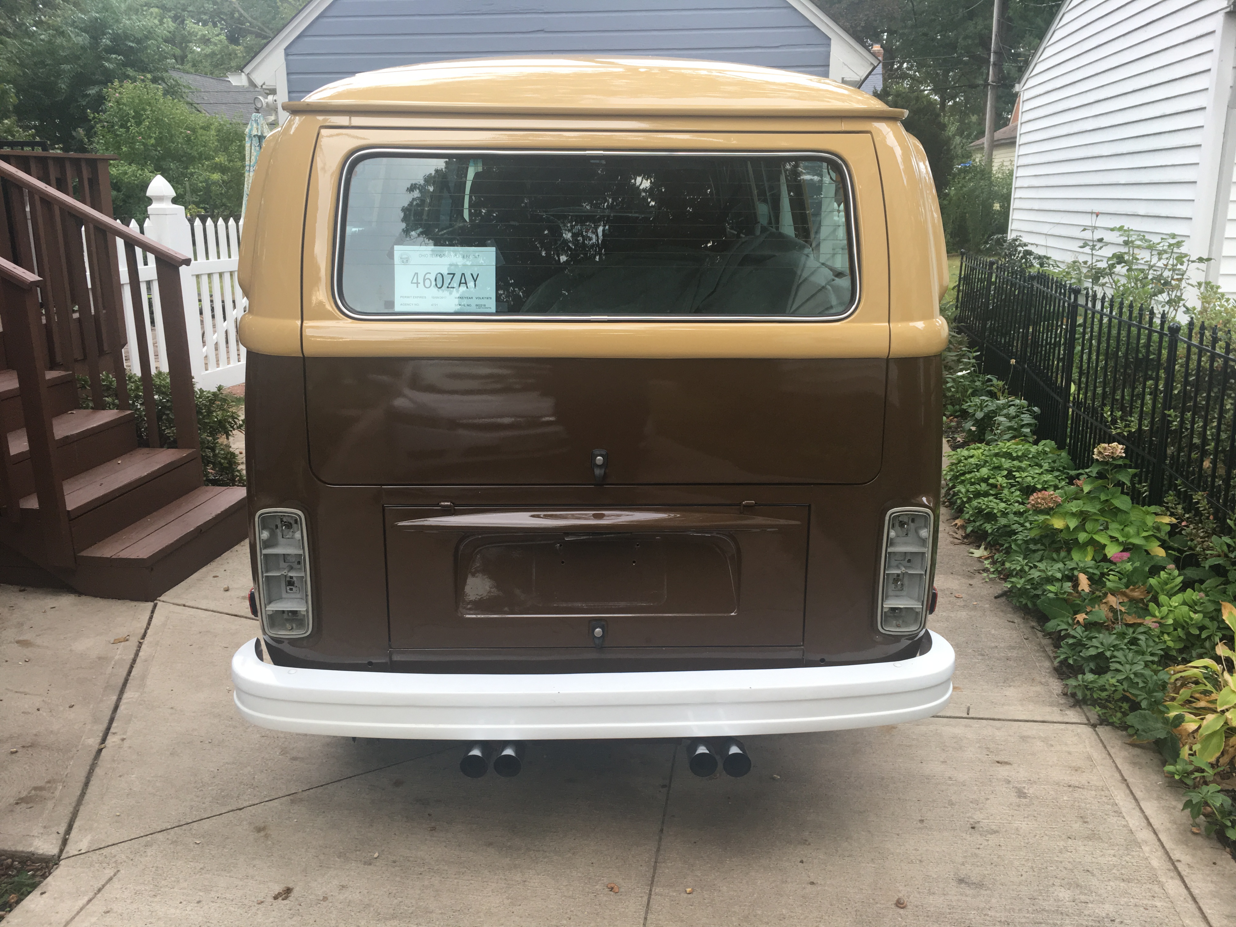

Ok here she is...

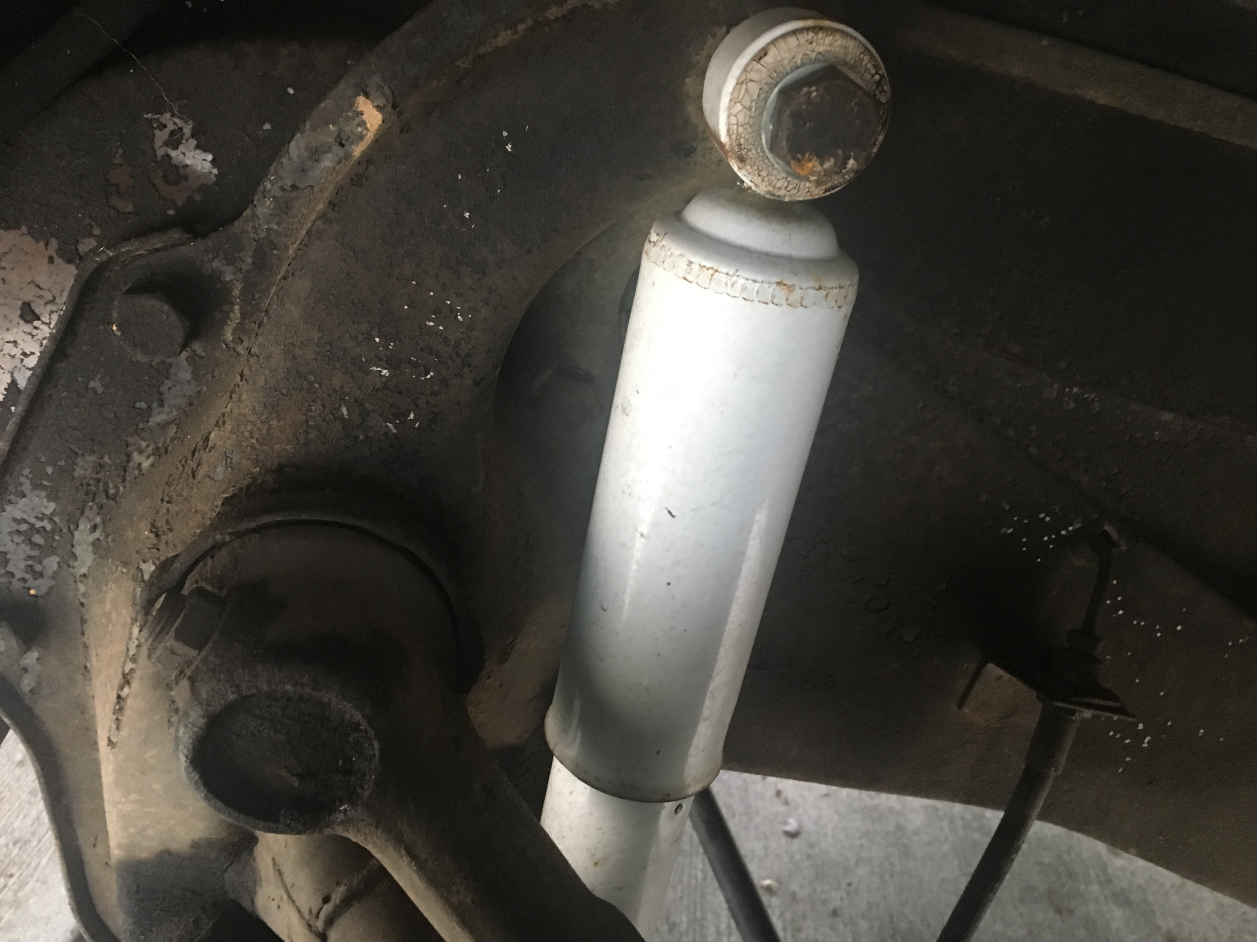

More photos...sorry they seem so big and un-rotated.

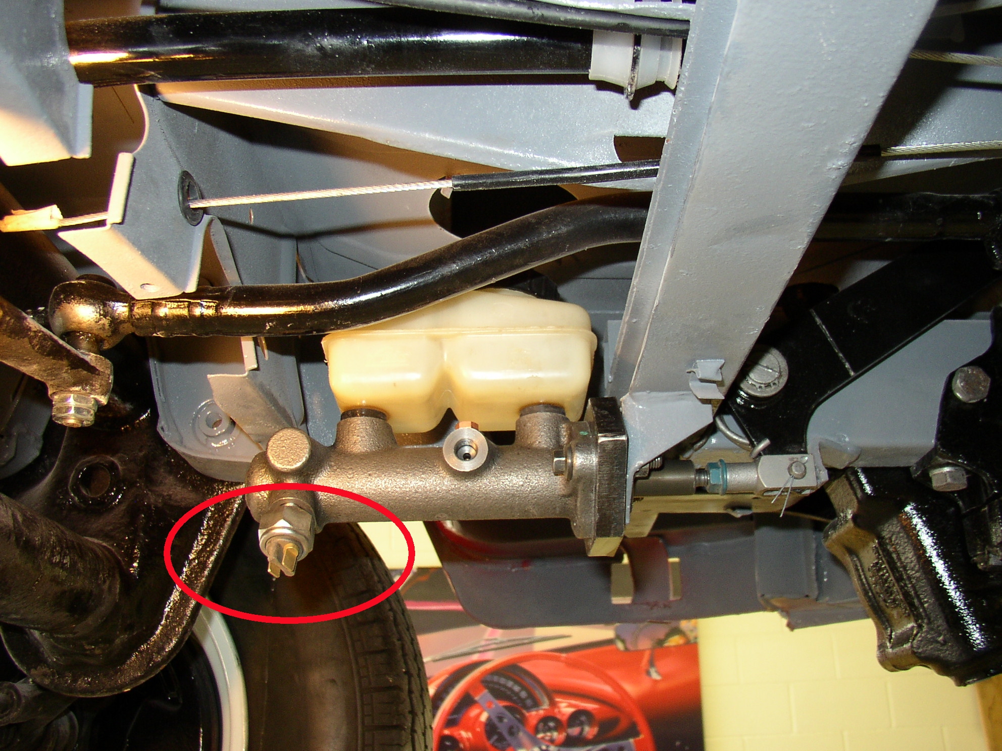

As for the brake lights, take your pan off (if you have one) and look for the creature I have circled below, it's your brake light switch. (The picture is from my '66, yours will look slightly different) You will now need a test light or voltmeter. There will be wires on the switch, it should have 12v at one terminal with your foot off the pedal and 12v at both terminals with 10+ lbs or more pressure on the brake pedal. It is common for the switches to fail, but it's also common to have wiring problems or a dozen other reasons the brake lights don't work. Find the switch and check power, or check/clean the fuses for a start. A test light works good for that, too.
Good Luck!
