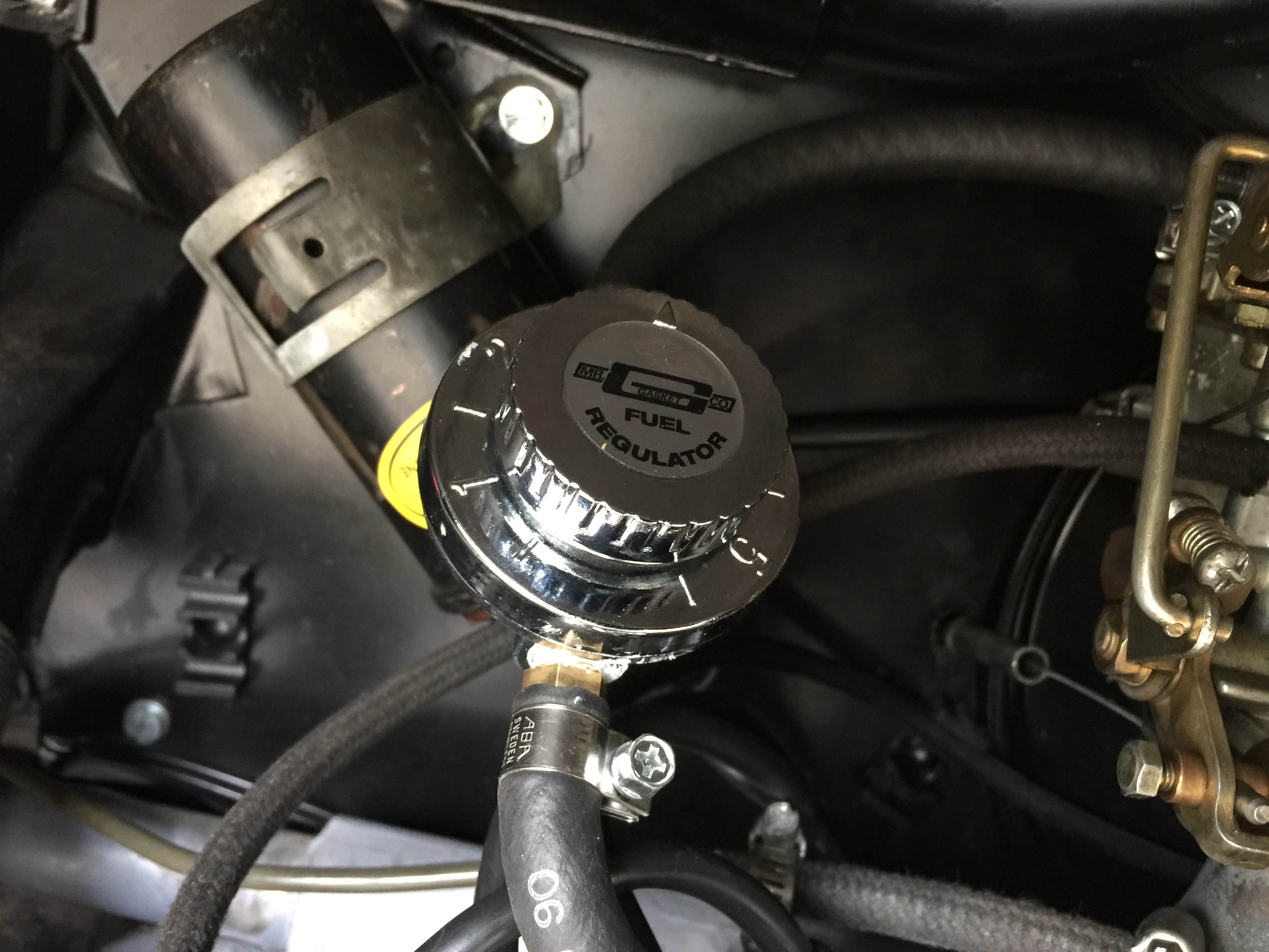

I decided to put a regulator on the fuel line. I'm not thrilled putting anything in-line in the engine compartment, but until I get a properly dispensing fuel pump, I'm using the regulator. The regulator came with 1/4", 5/16" or 3/8" connectors and obviously I opted for the 1/4". I wanted to use my 5MM fuel line, but 1/4" fit better on the nipple so I got 1/4" 30R7 line and used the better quality non-pinch clamps. I used permatex teflon to seal the threads, so we'll see. I looked around for the Holley regulator, but couldn't find one, so Mr. Gasket will have to do for now. OIl light is out, but I really haven't had time to take it on a hard run on the freeway, so the jury is still out.

I hate crap in the engine compartment. What can go wrong? :lol:

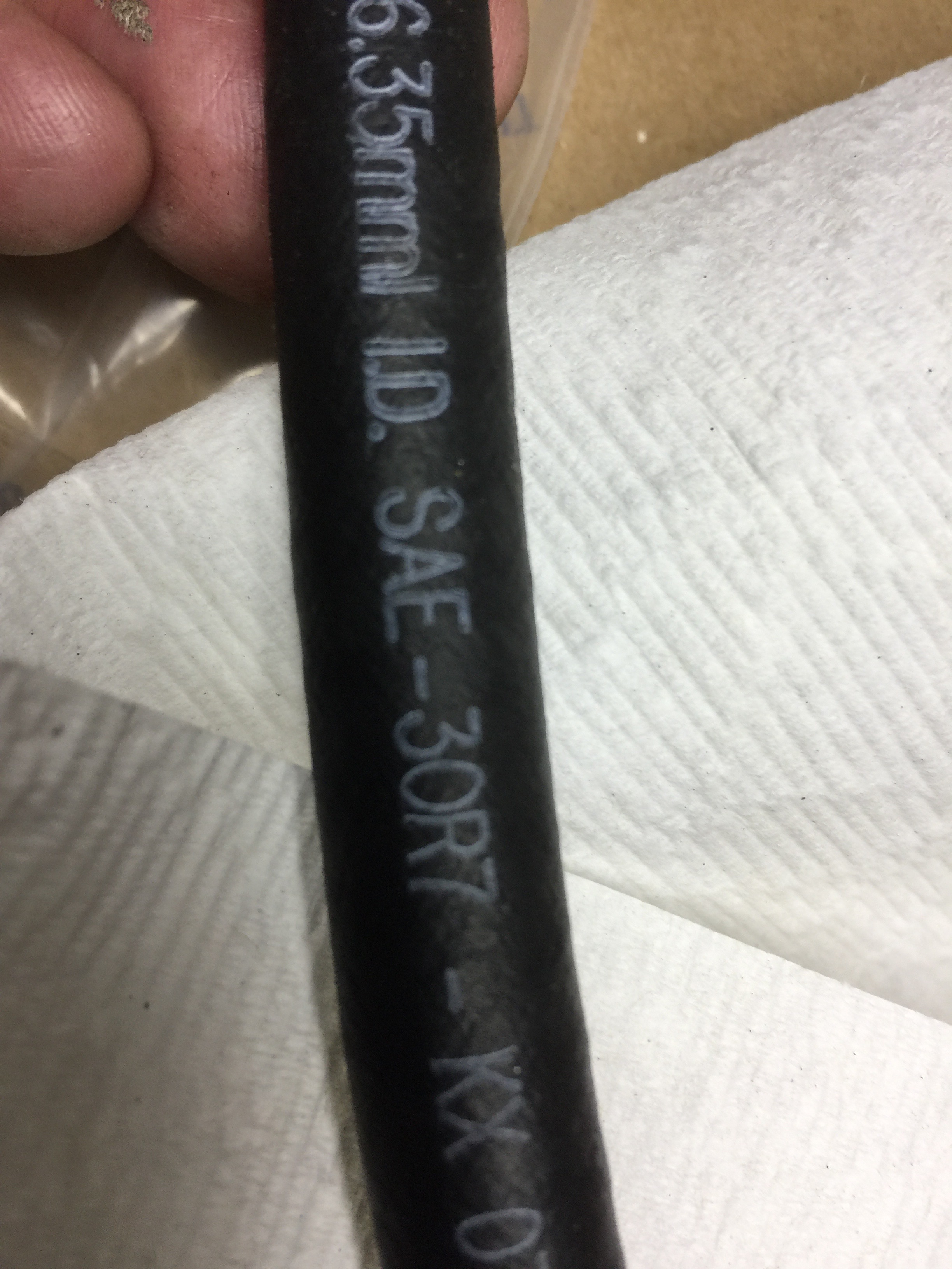

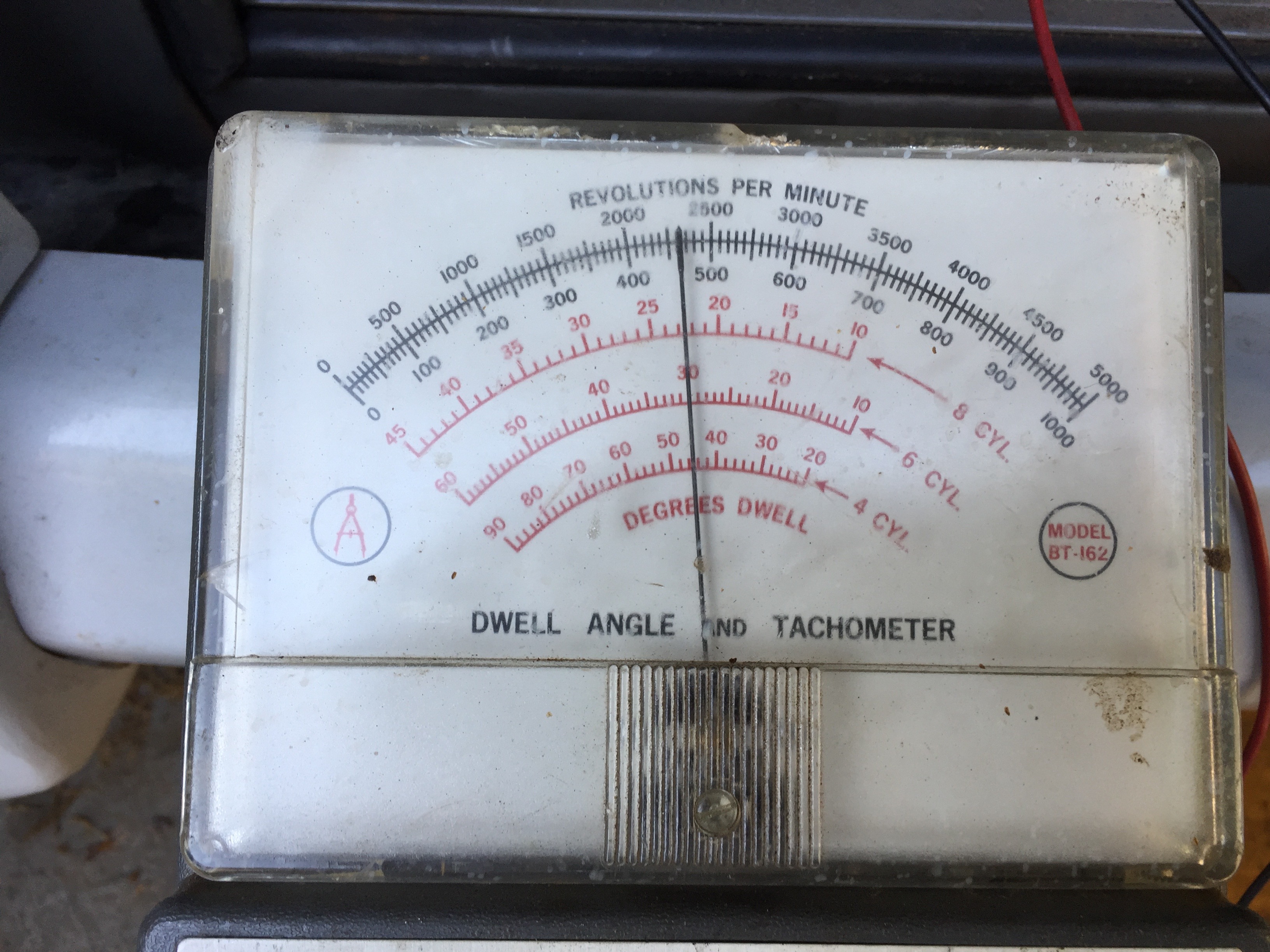

Here's the 1/4" line I used.
30R7 is not ethanol safe, you want 30R9 or better.
Re: Sean's '59 Panel
toolbox wrote: Mon May 20, 2019 9:49 am 30R7 is not ethanol safe, you want 30R9 or better.
Thanks for that info. I asked the guy at Auto Zone if it was ethanol safe and of course he athoritatively said "Sure!" :roll:

I wish it came with some mounting hardware so I could mount it on the fan shroud. Anywhere but hanging precariously above the distributor! :cry: I mean, what could go wrong? :shock:
I hate having anything extra in the engine compartment. I even hate having any braided or rubber fuel lines. The old 36er's had all metal lines with metal threaded connections. Eventually I'll sort out the fuel pump and see if I can eliminate the need for a regulator.
