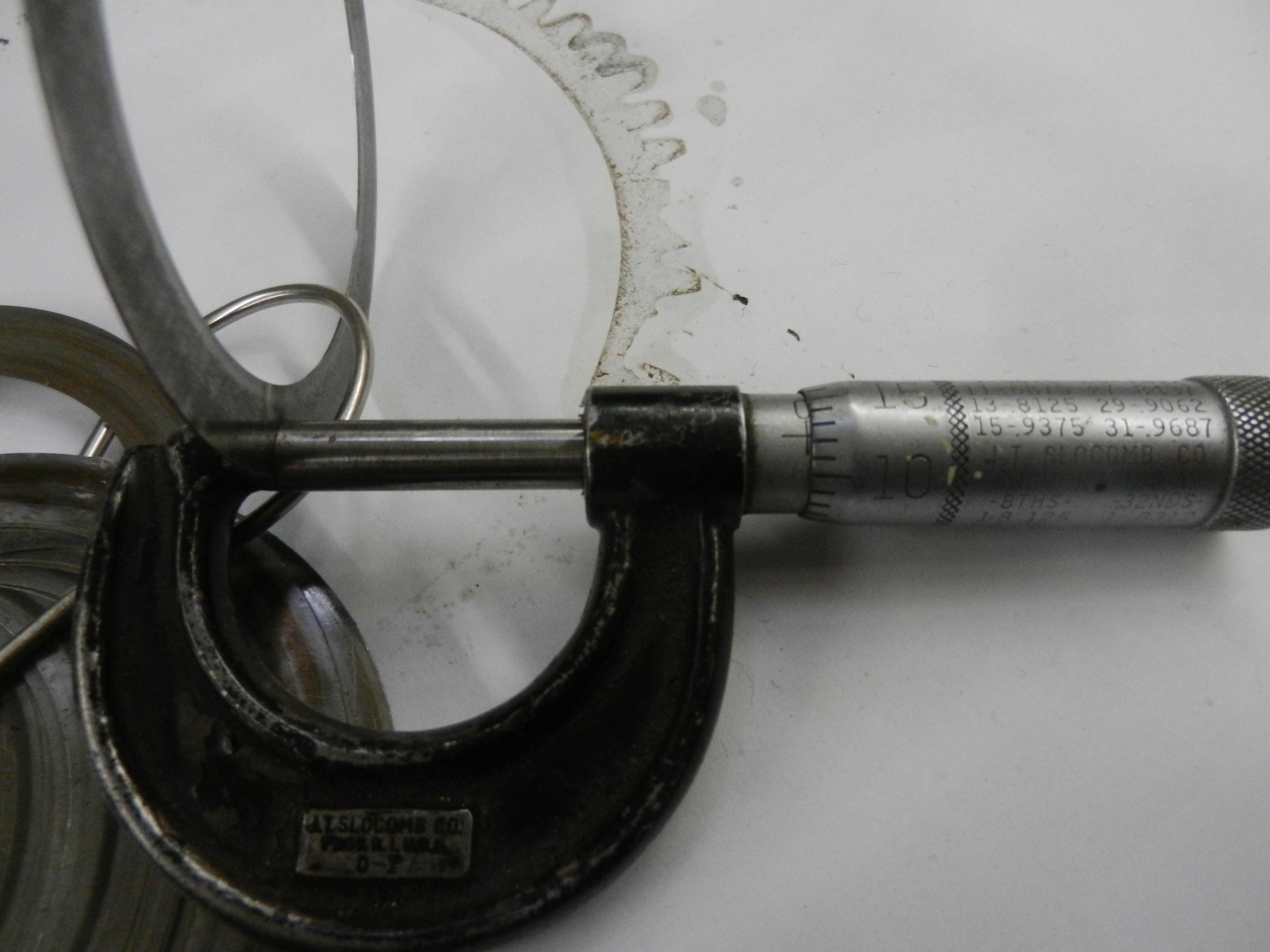

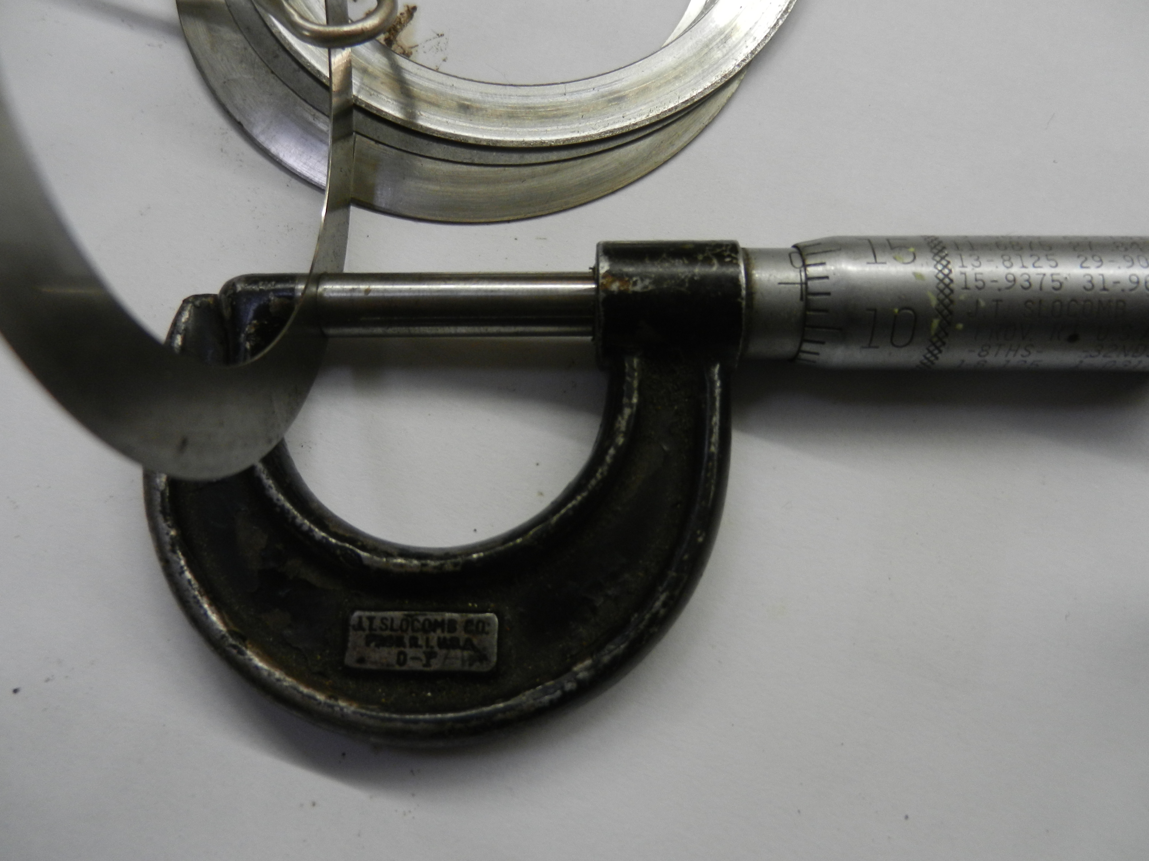

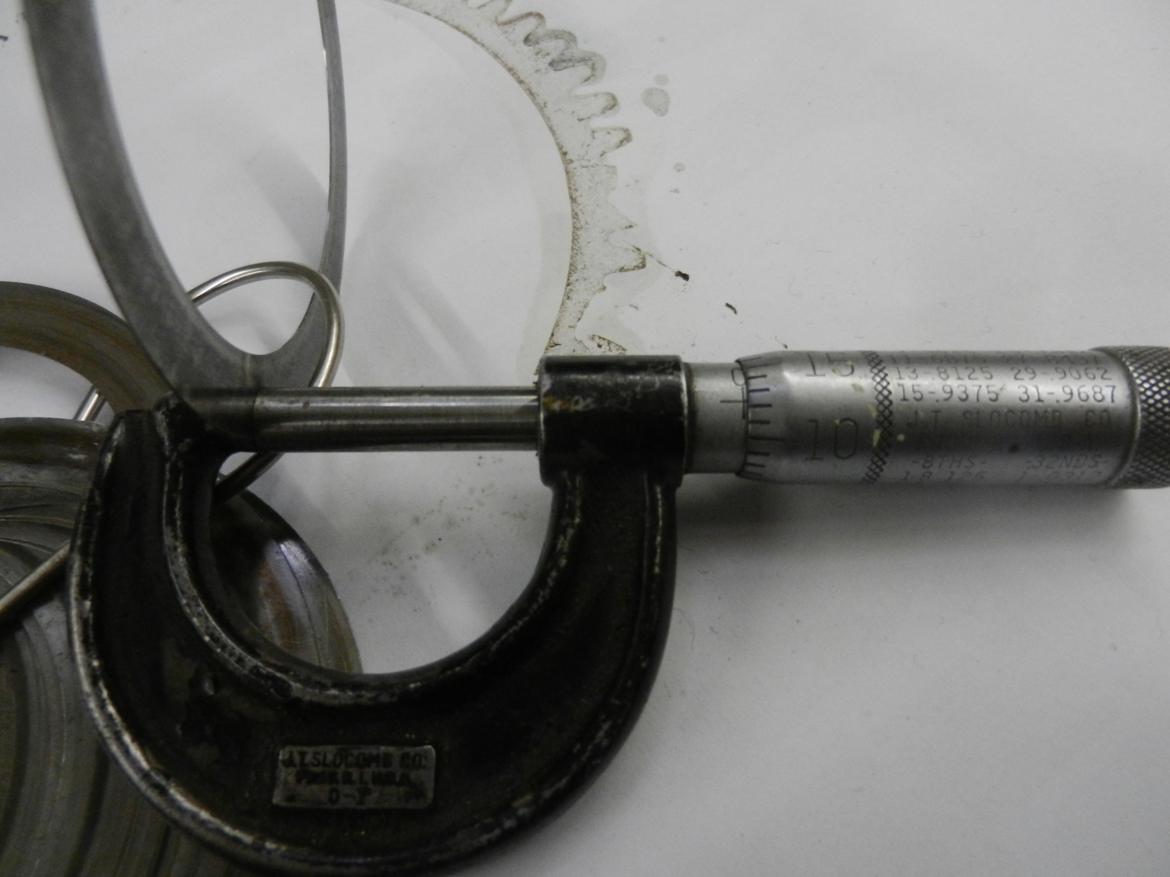

I doubt that any of us have a metric dial indicator or micrometer.
as mention prior, I pick 2 shims and measure them.
We'll call this one .013 (actually .0134)
This one .014 (actually .0142)
So, we have a 2 shim set of .027in

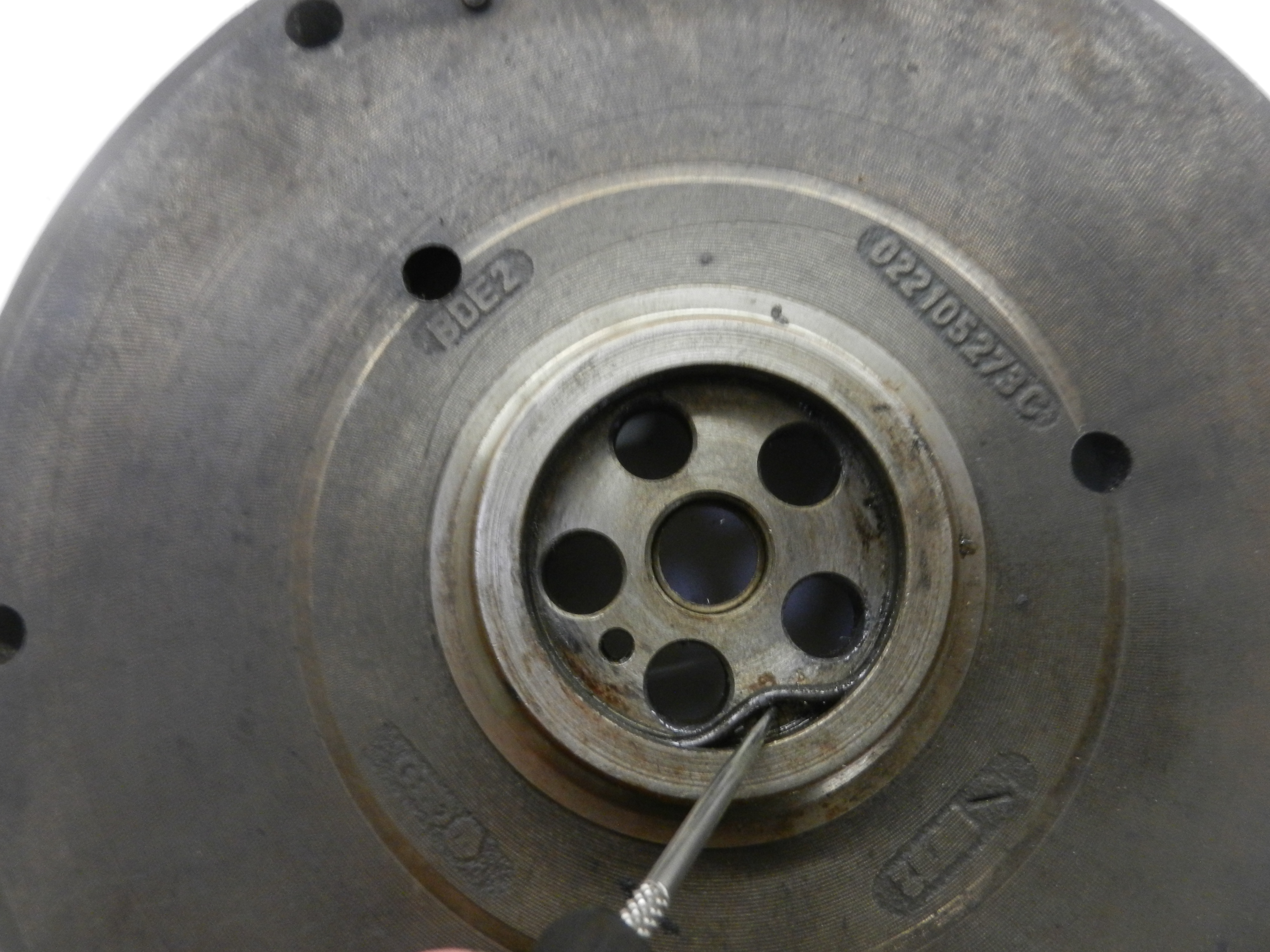

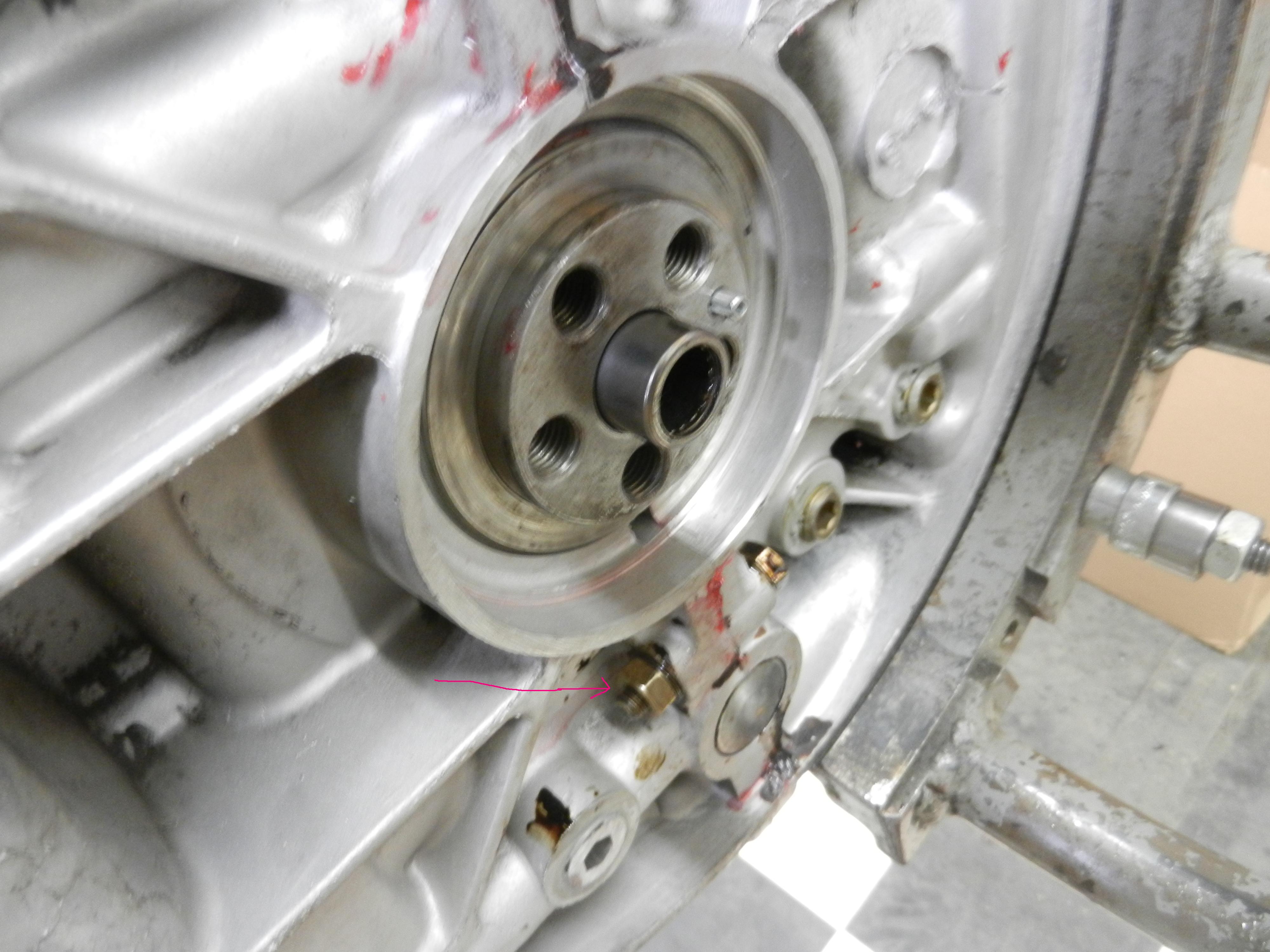

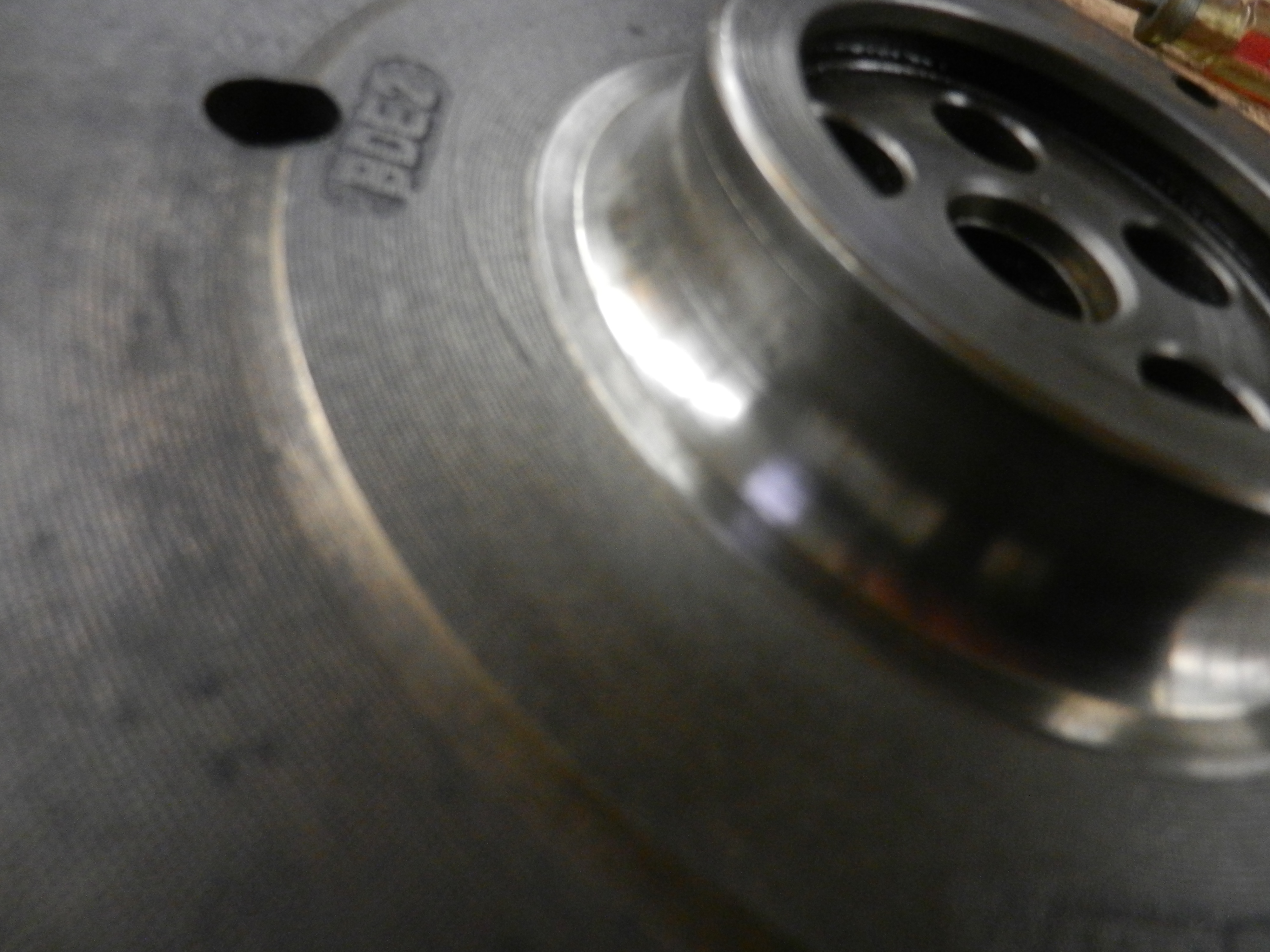

Before we install the flywheel, clean up the mating surfaces and remove the o ring if it is still there. ( don't forget to install the new o ring from the gasket set before final installation of the flywheel)
clean well, both mating surfaces.

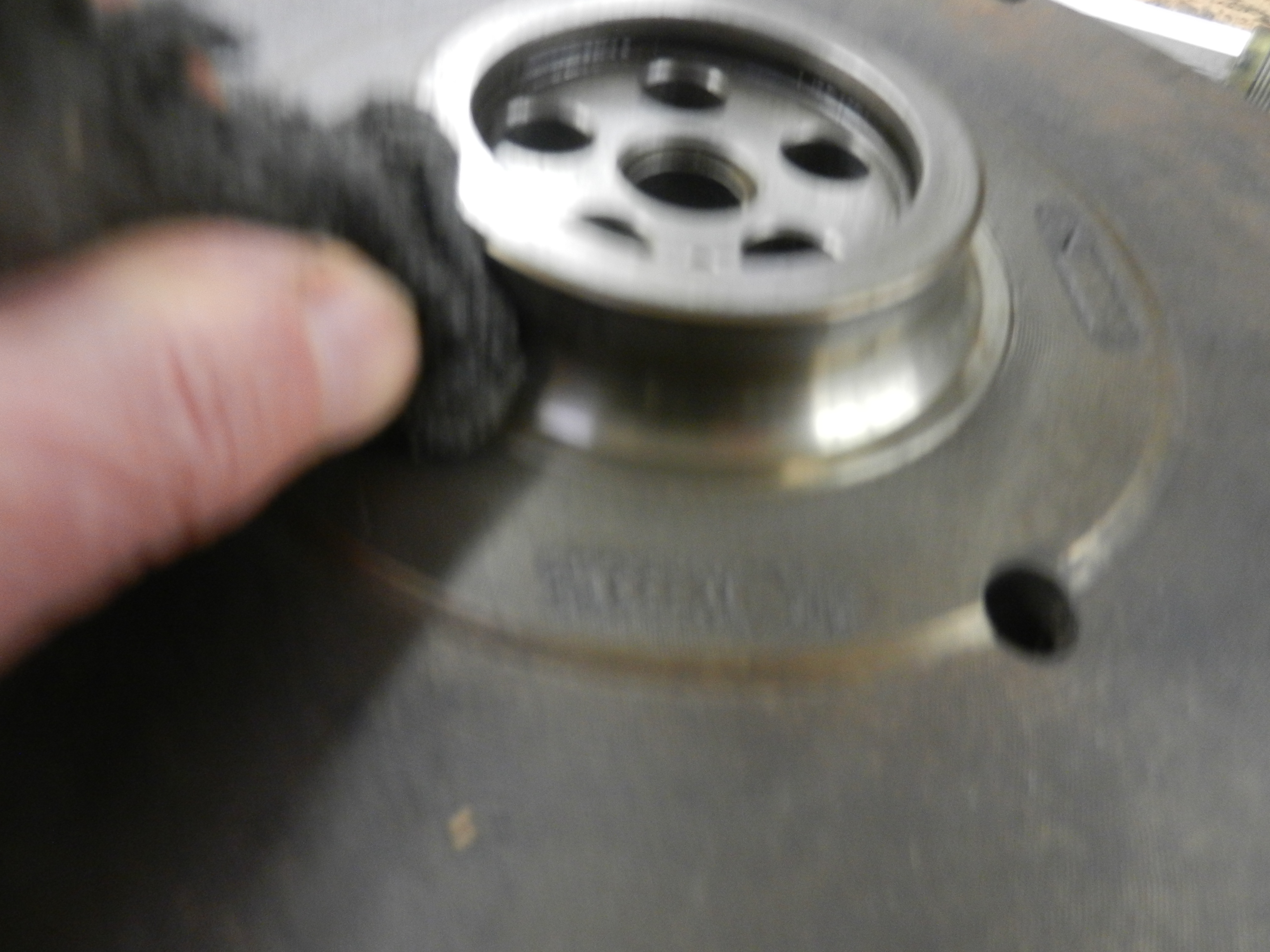

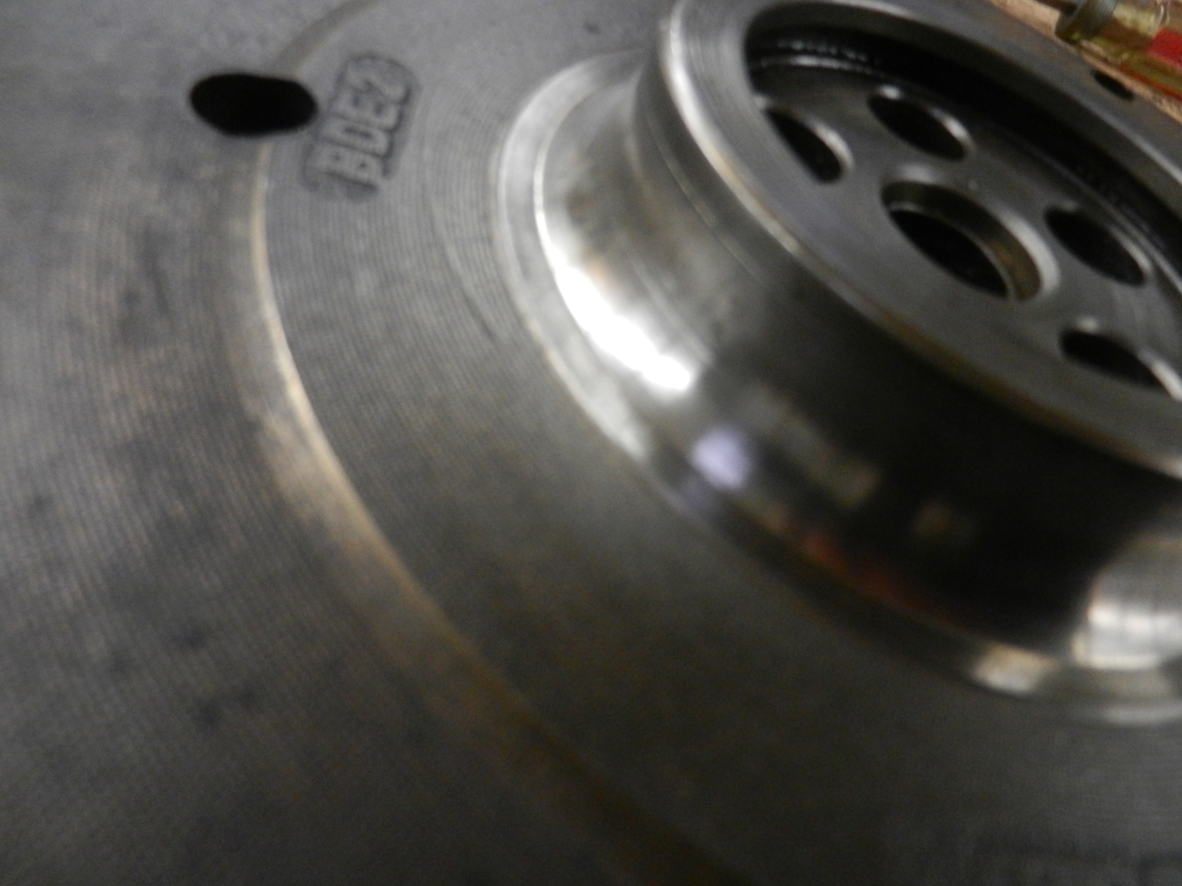

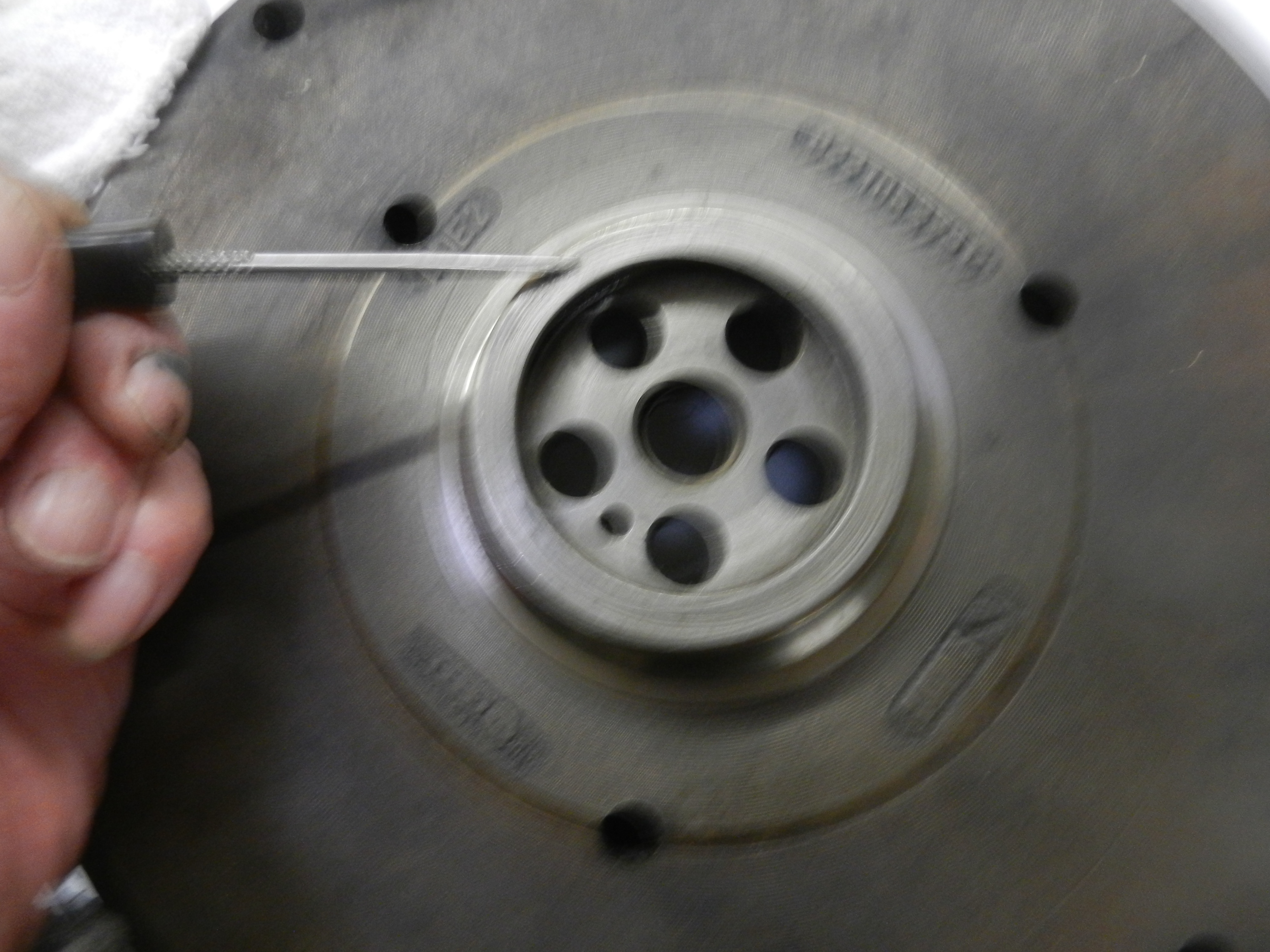

A good time to clean up and polish the nose that sits in the oil seal. Some fine steel wool works.
I like to polish this area. check for any grooves. Just make sure it's nice and smooth to avoid oil leaks.

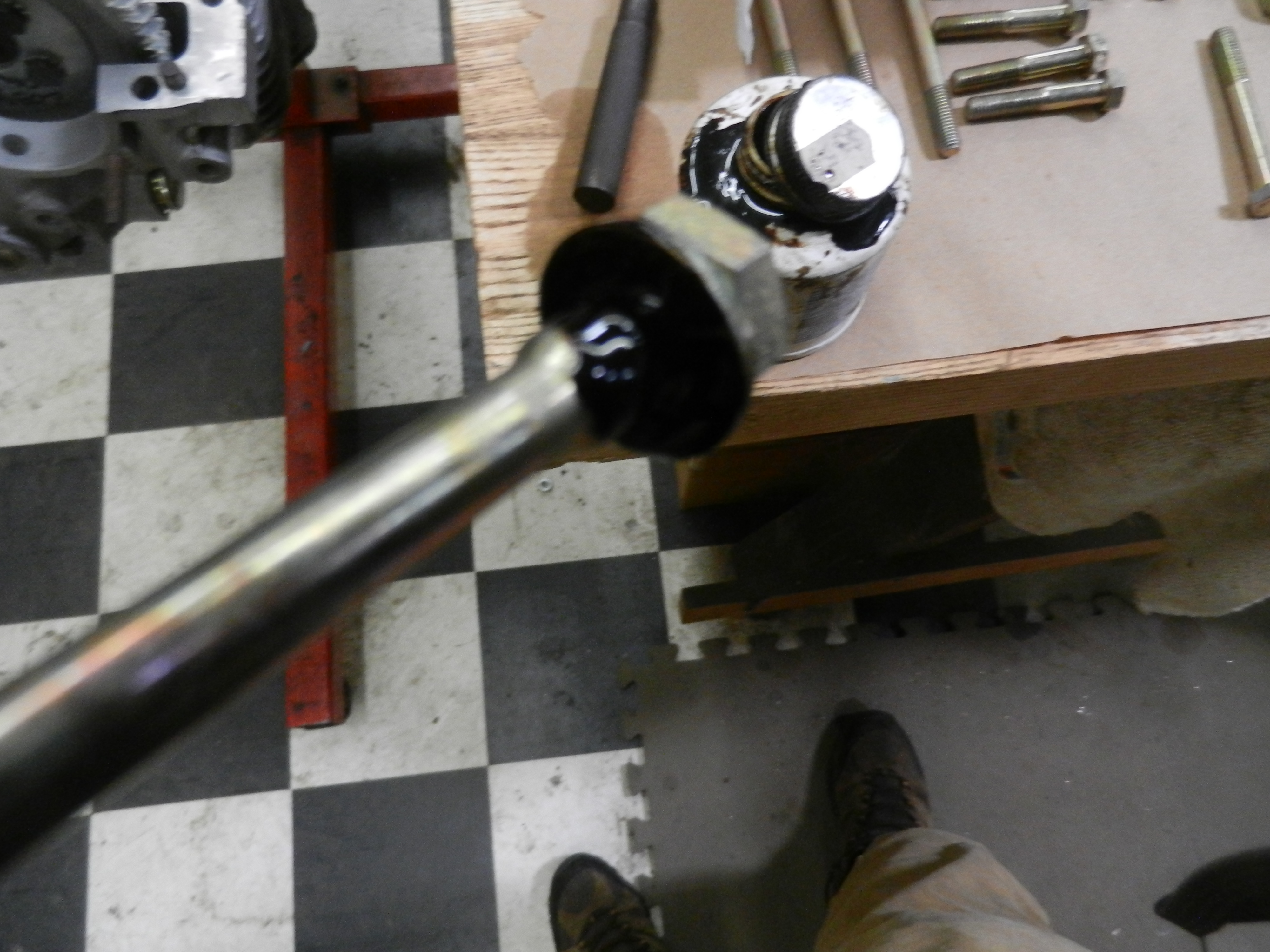

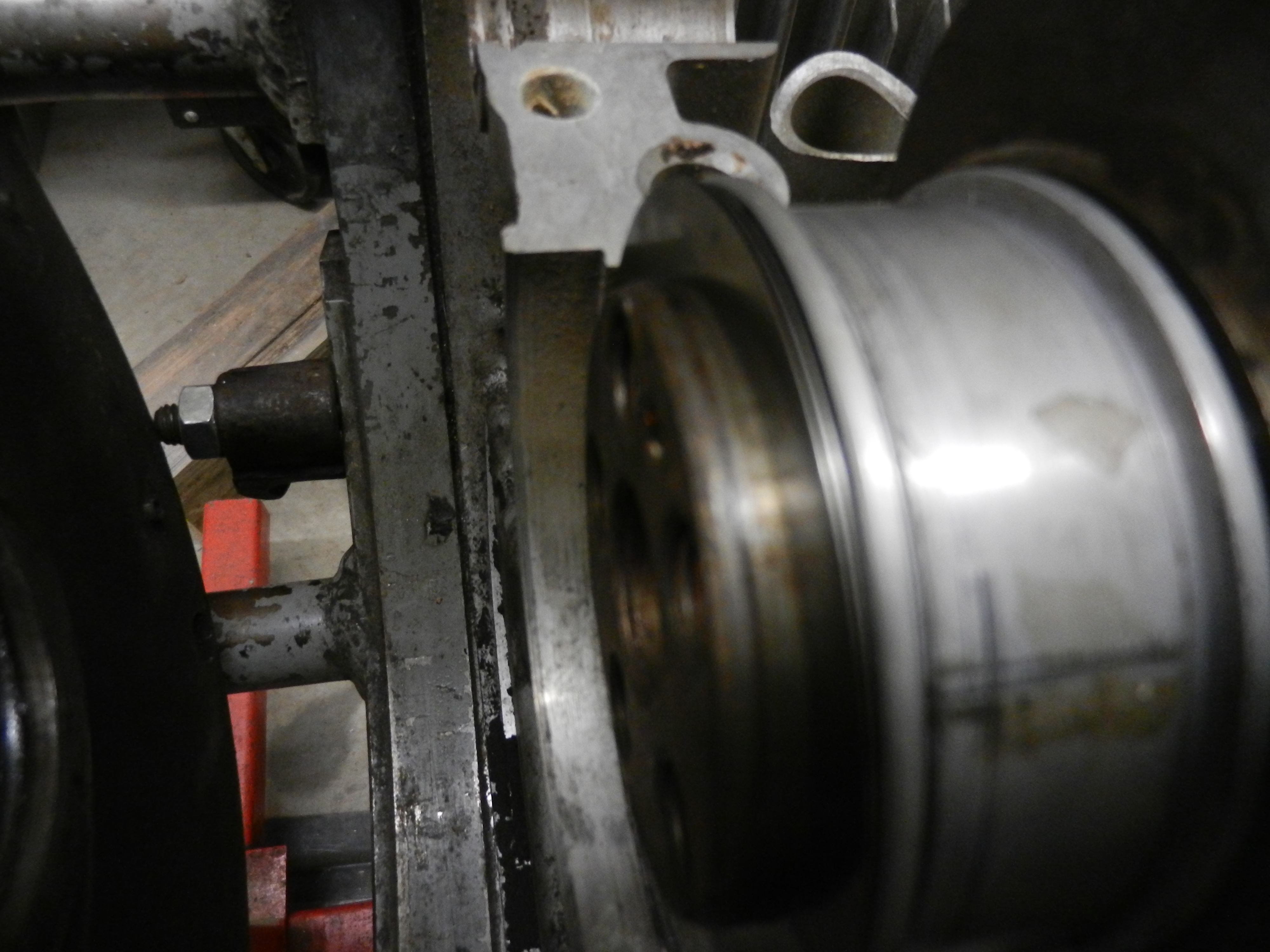

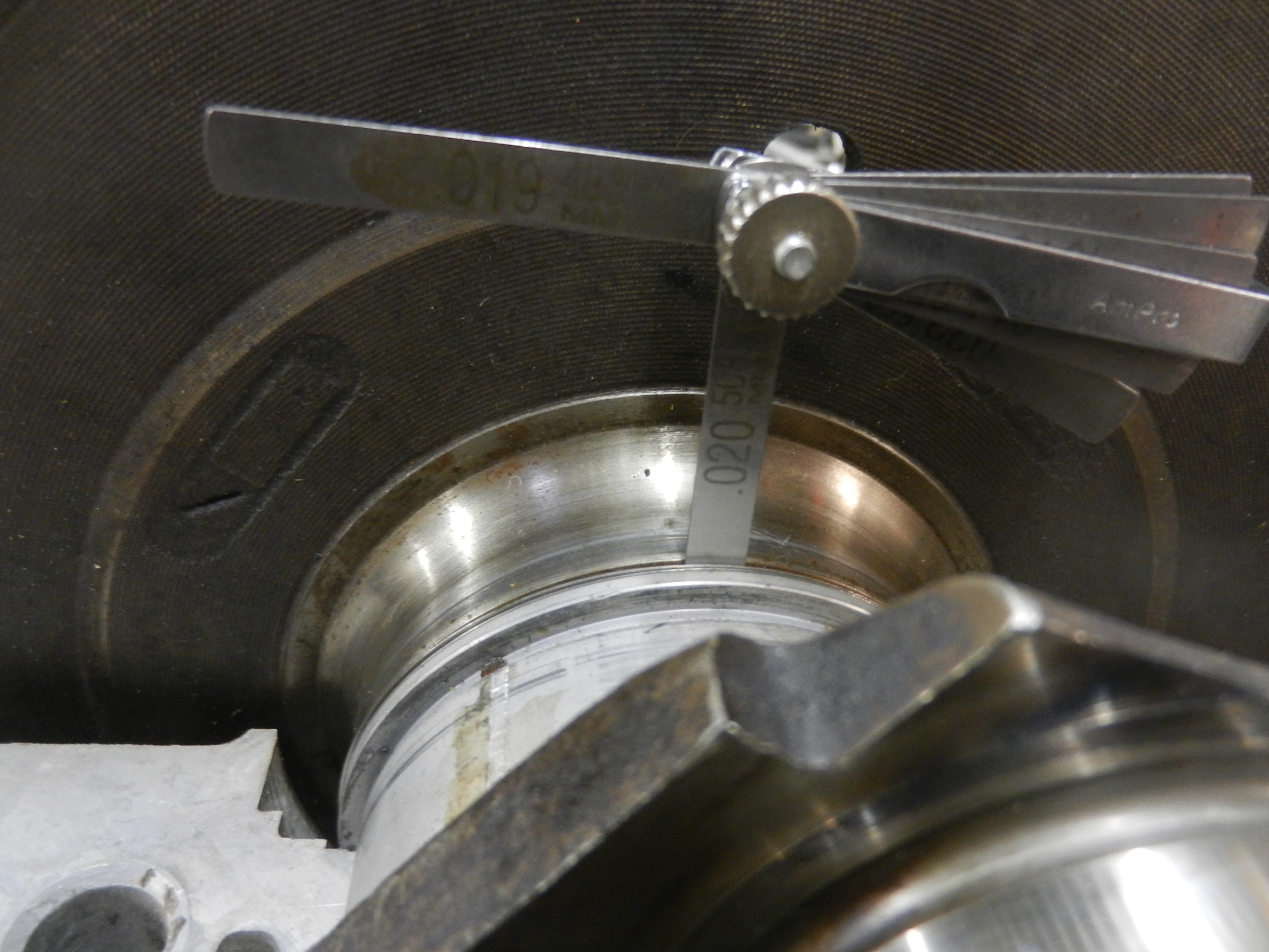

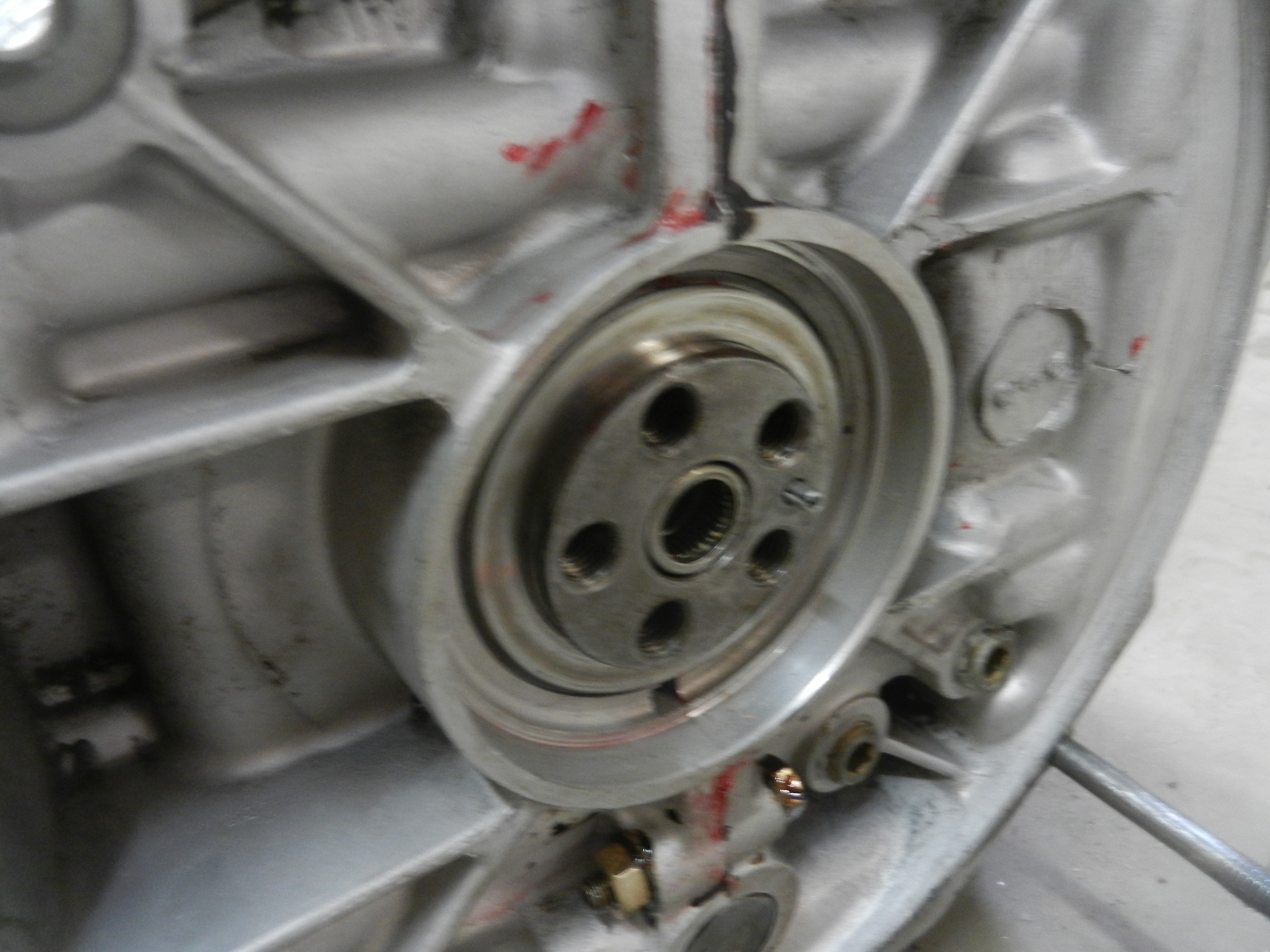

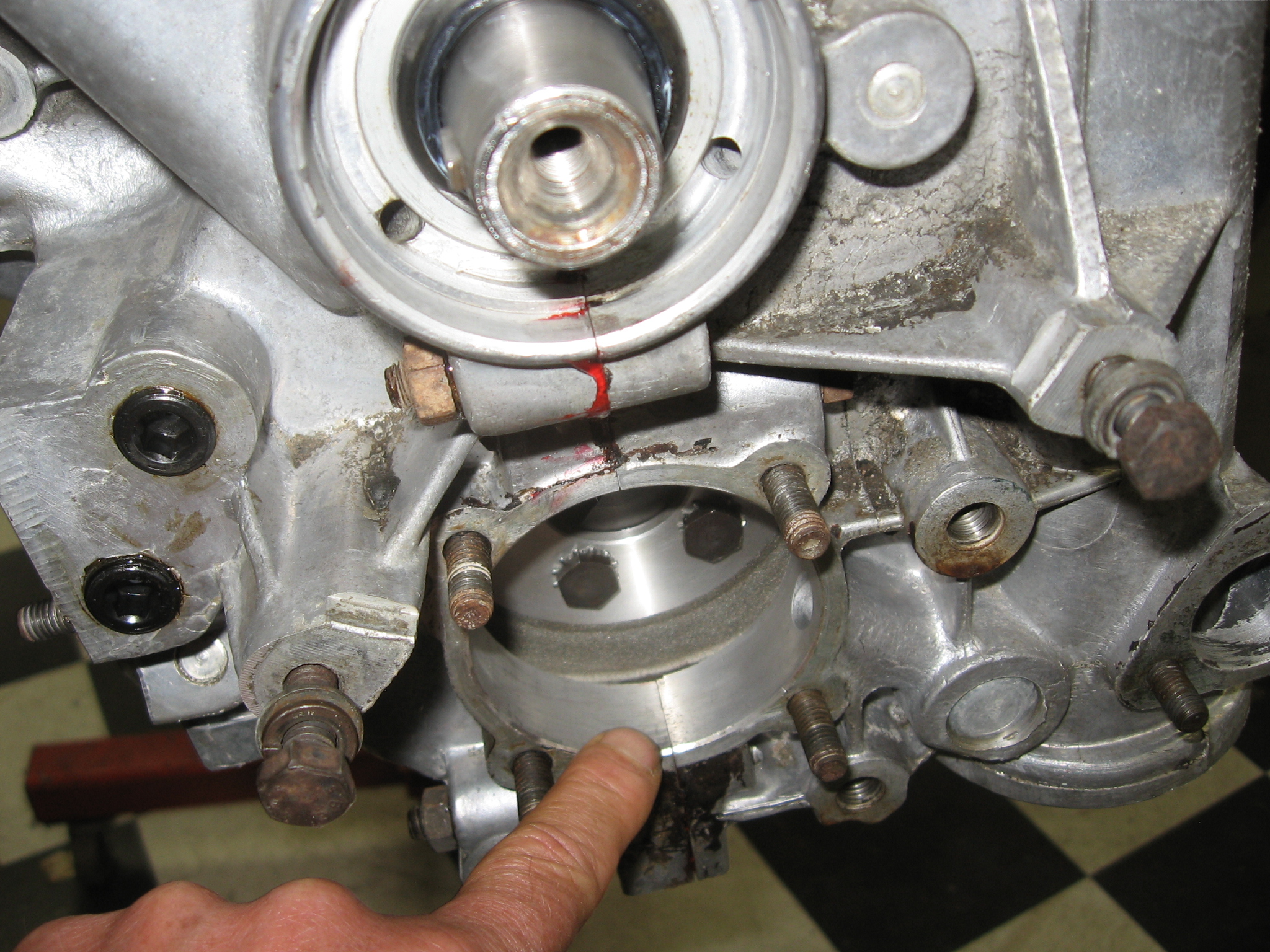

Install the flywheel and attempt to torque it. this can be difficult to get to 80 ft.lbs without a flywheel lock, A large flat blade screw driver in the flywheel teeth will work. Get the bolts as tight as you can. Even is more important than getting to actual torque spec. Getting a dial indicator mounted is also tricky when working with just the case half. So. we are going to use a feeler gauge here.
Here we have a nice tight .020in.
Now for some math.
we want to get to .004in (+- .001) to be at spec.
We have .027in in shims. .020in gap. deduct the .004 from the .020in. that we want for our desired end play = .016 shim needed for the 3rd shim. there is no .016 shim, so we use .015 and should end up with .005in for our end play.
You can work various combinations for this. But, in searching various suppliers, they cost between $8-$10 each.so use what you have and determine the shim you need before dropping $'s on a bunch of sizes.

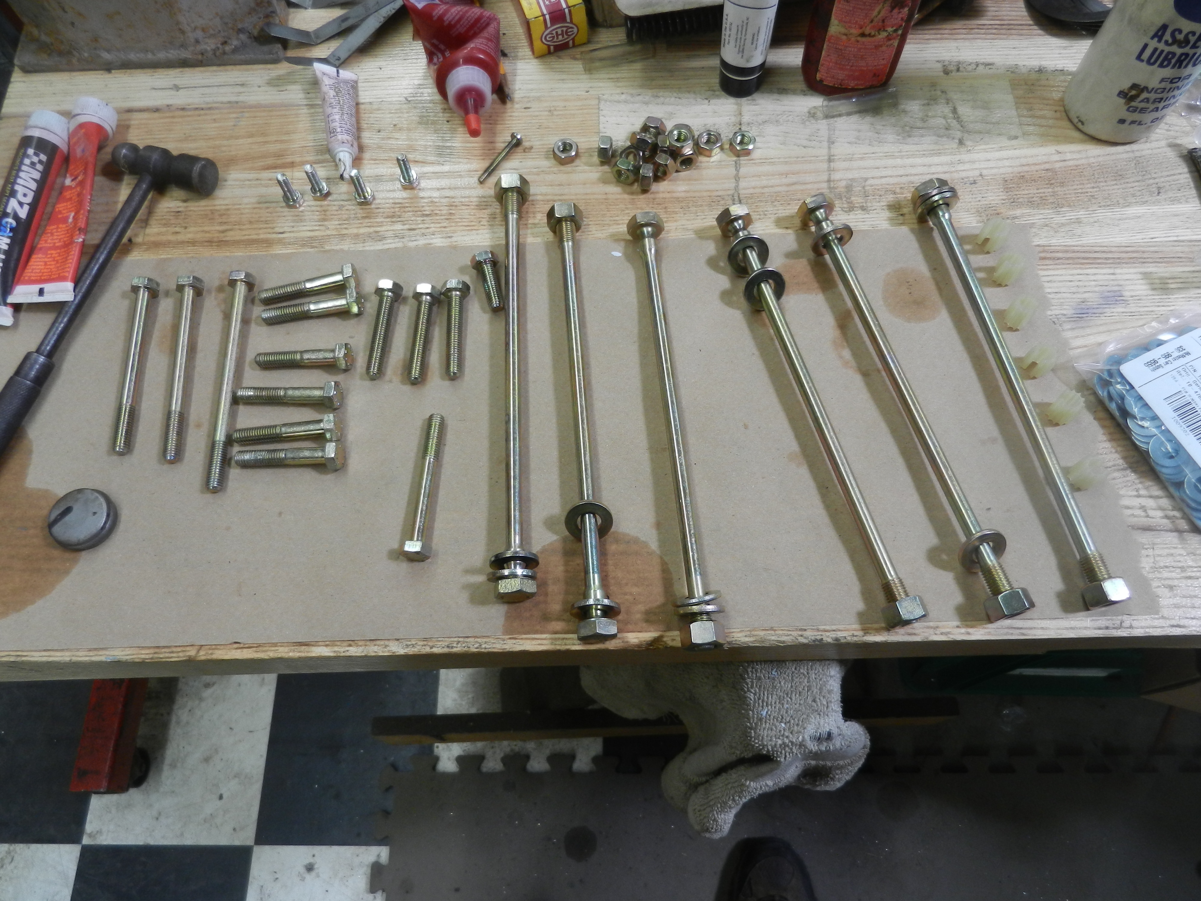

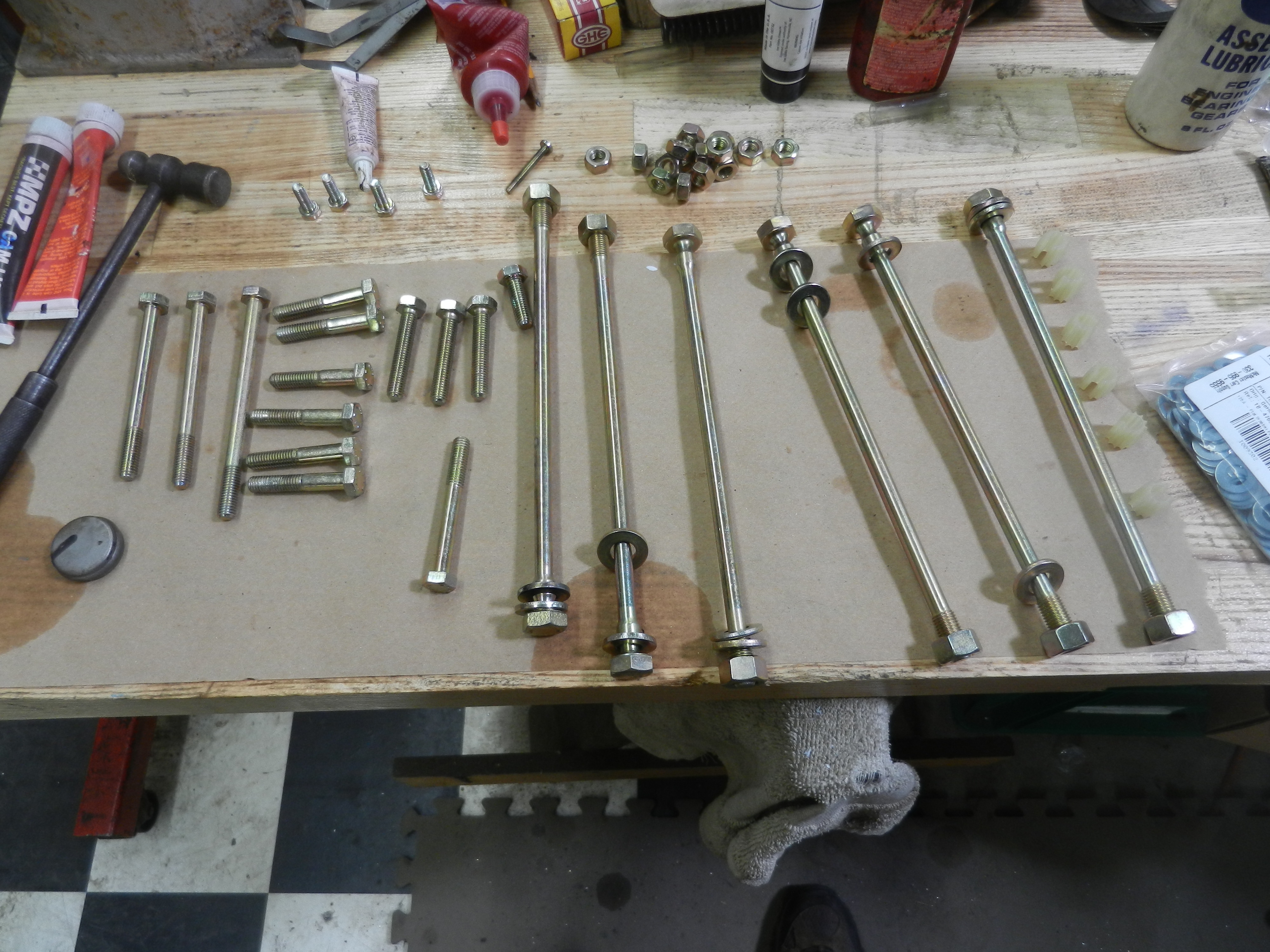

OK. Back to getting the case have ready to assemble. NOTE: we will check end play after assembly again.

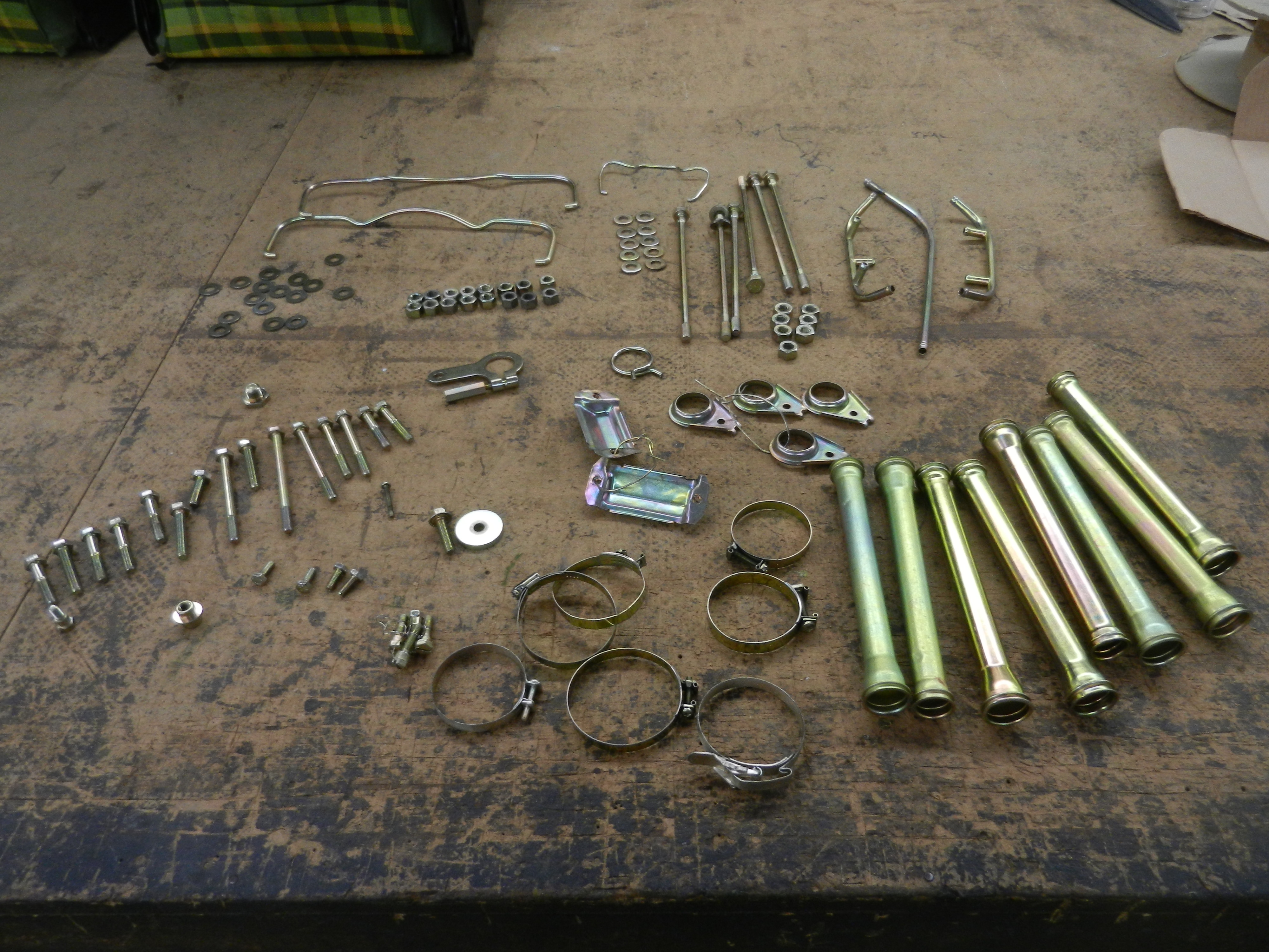

First, get all the case hardware together. There are 20 bolts/nuts, including the 6 long thru bolts around the crankshaft.

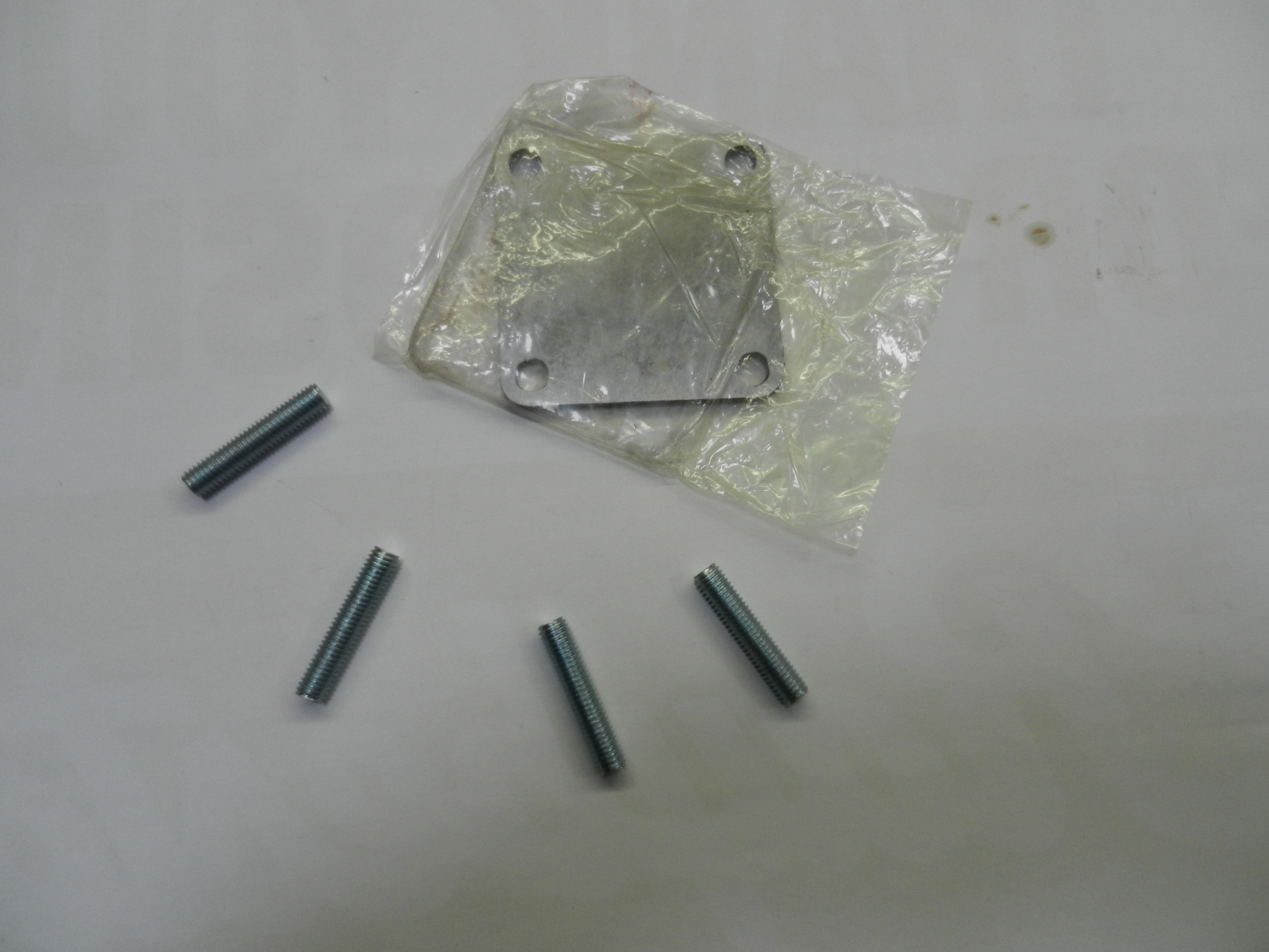

(you did set them aside ;) ) I had all mine plated, as a local plater will plate a hole bucket full of stuff for $50, and I had a bunch of other grungy stuff to plate. Nice part is, he has to bath them before plating, which saves the time ans mess of my doing it.

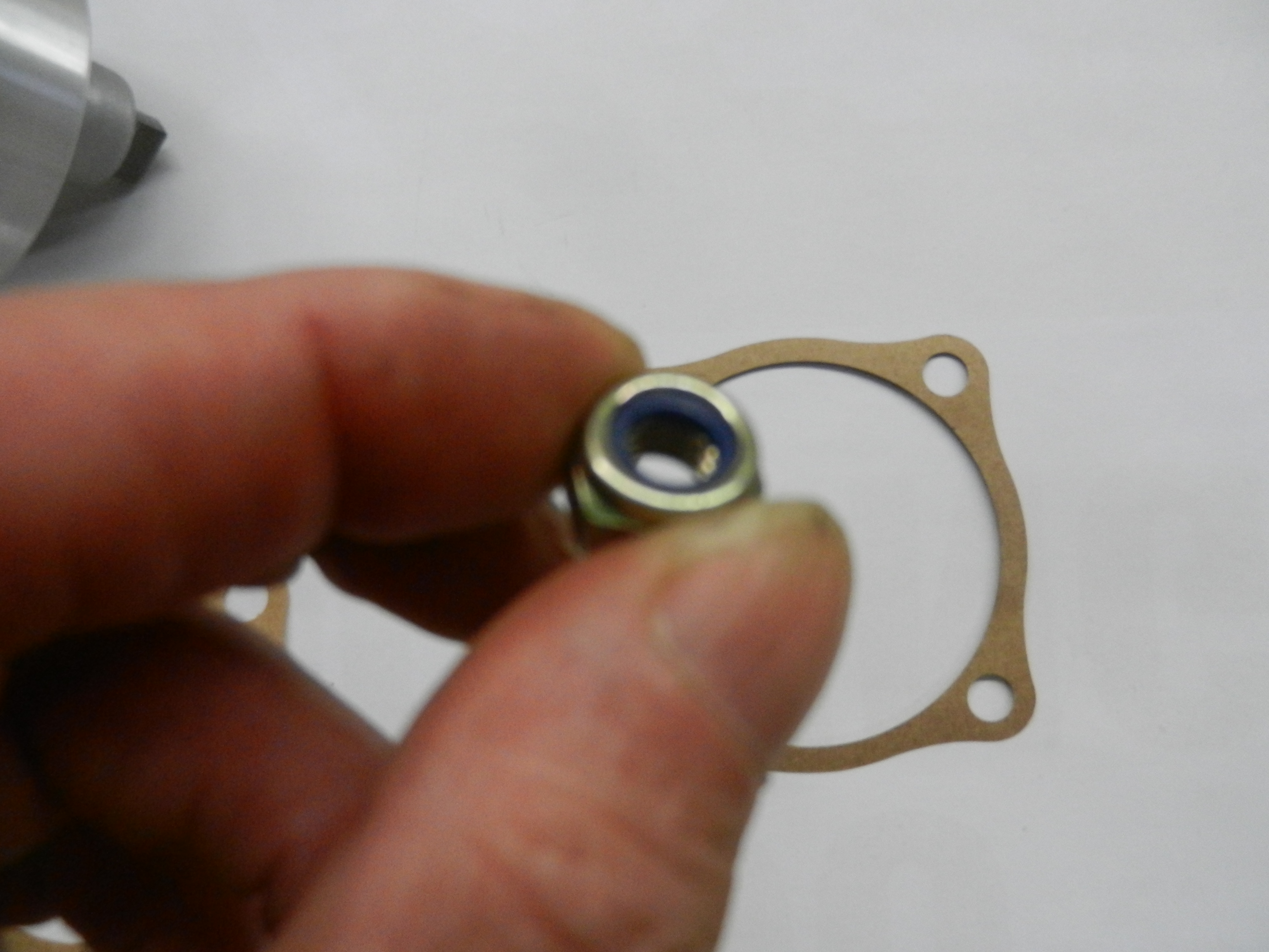

ALL the nuts and washers get a little Permatex to seal them up.

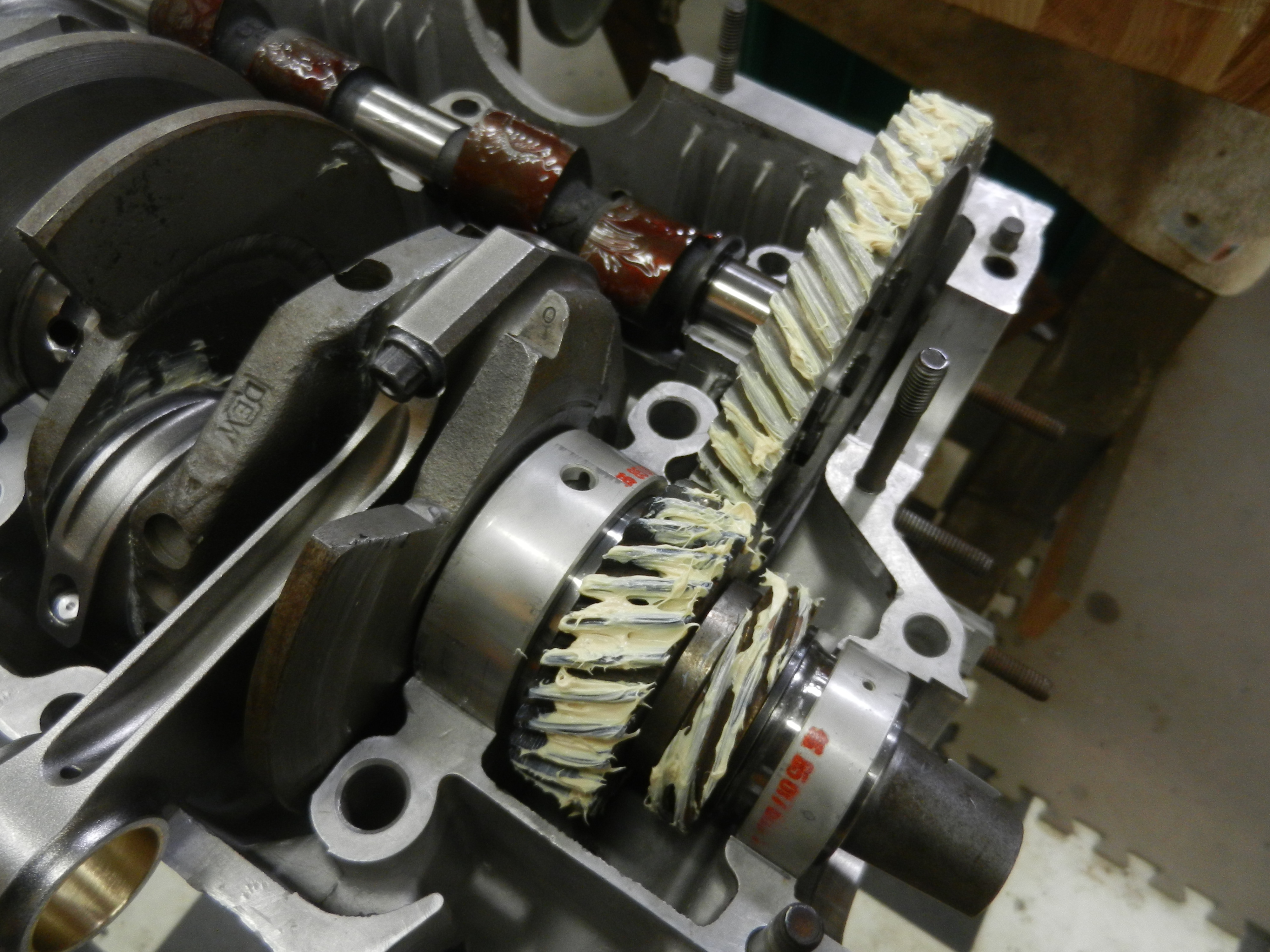

Smear some white grease on the gears. This helps cushion and lube things up until we get oil pressure when we first crank it over.

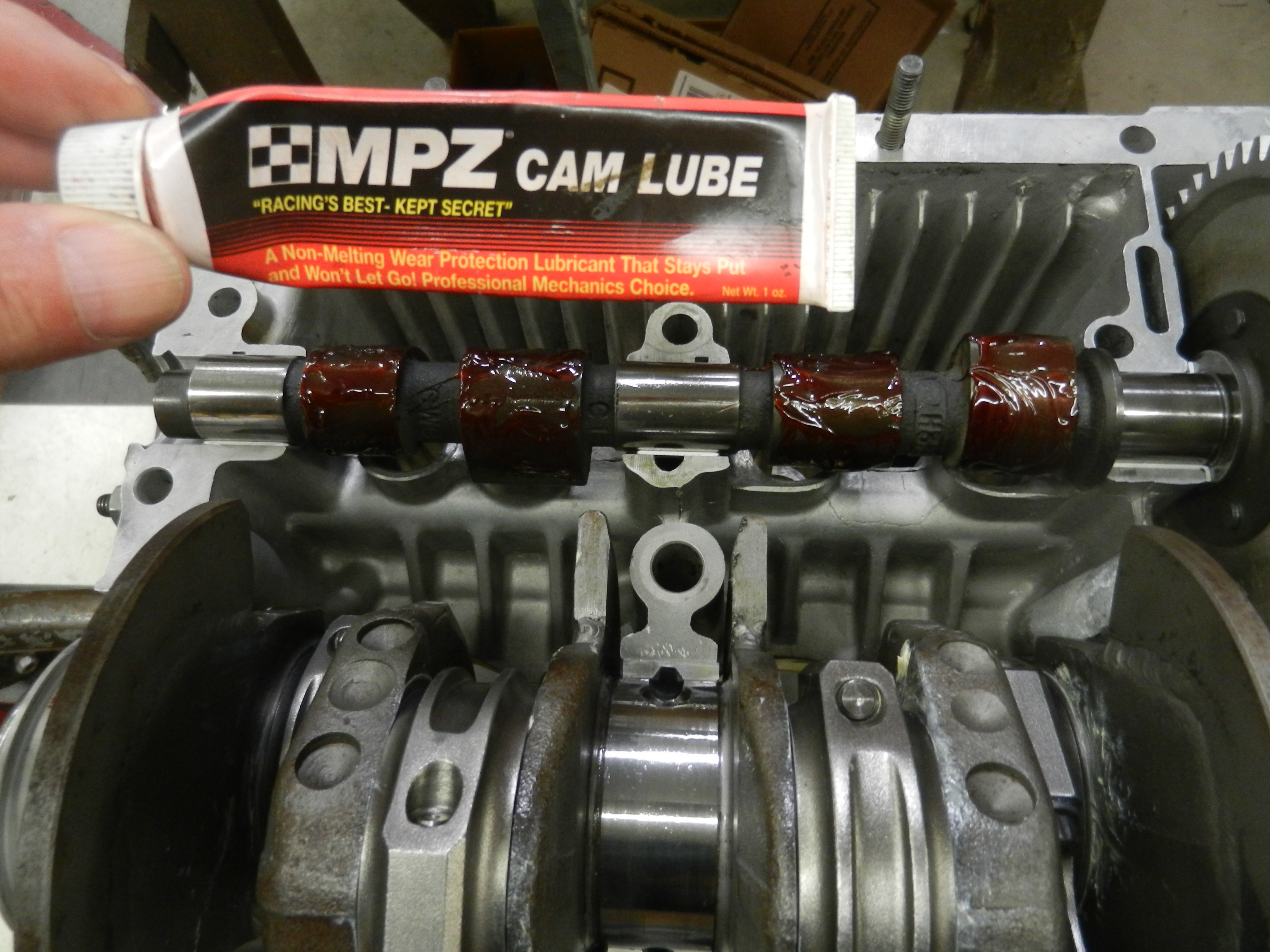

Some cam lube on the cam lobes. In the "old days" we used STP for this.

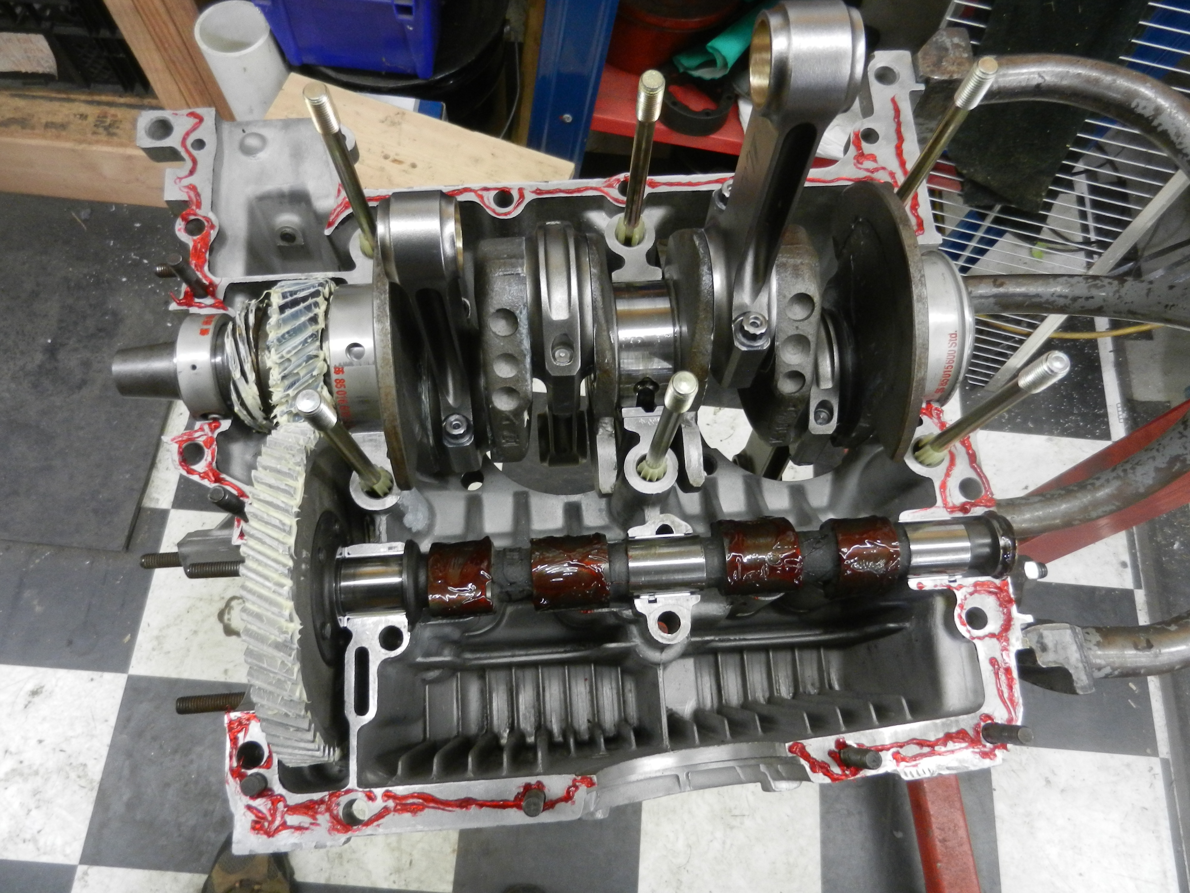

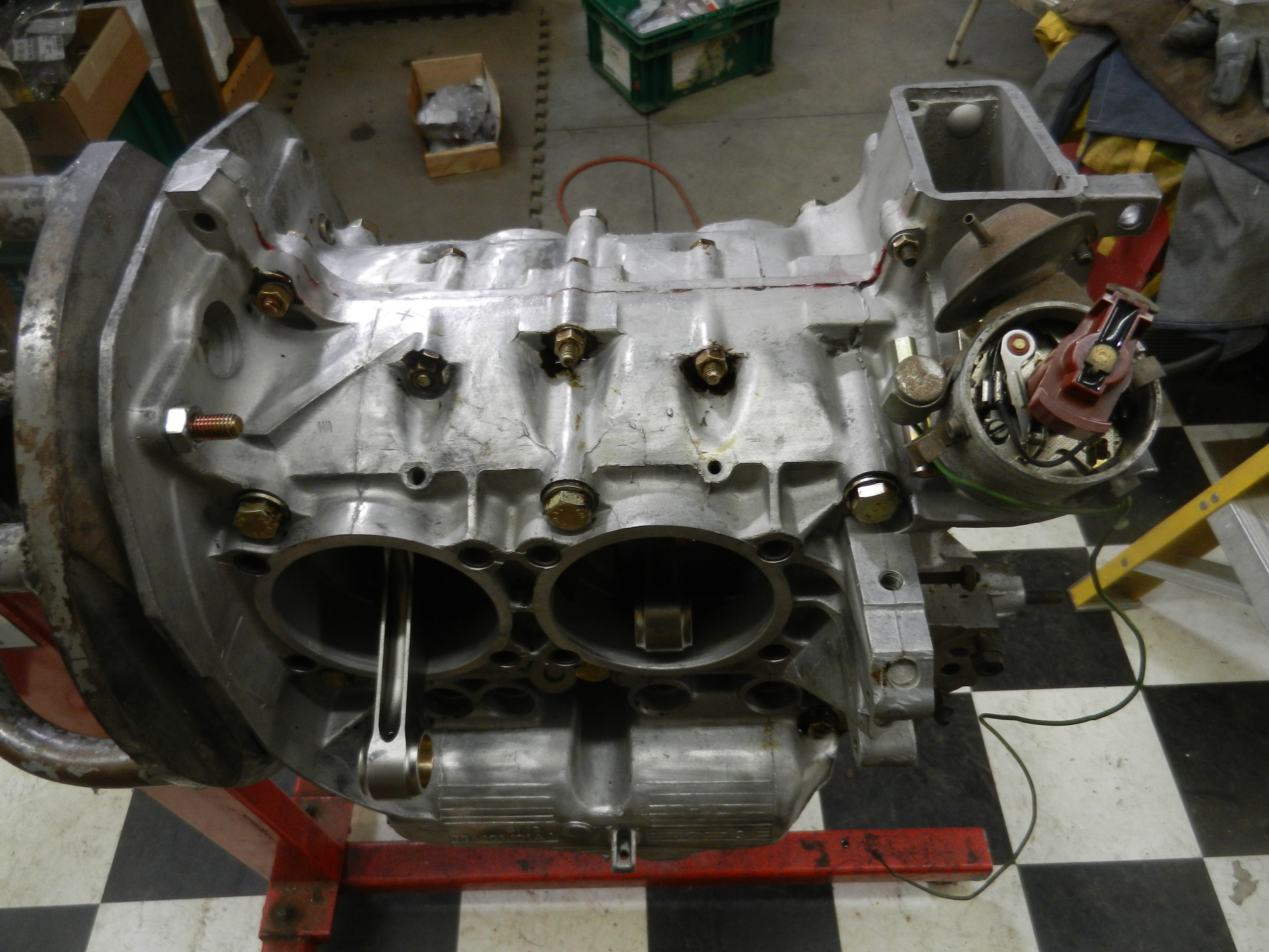

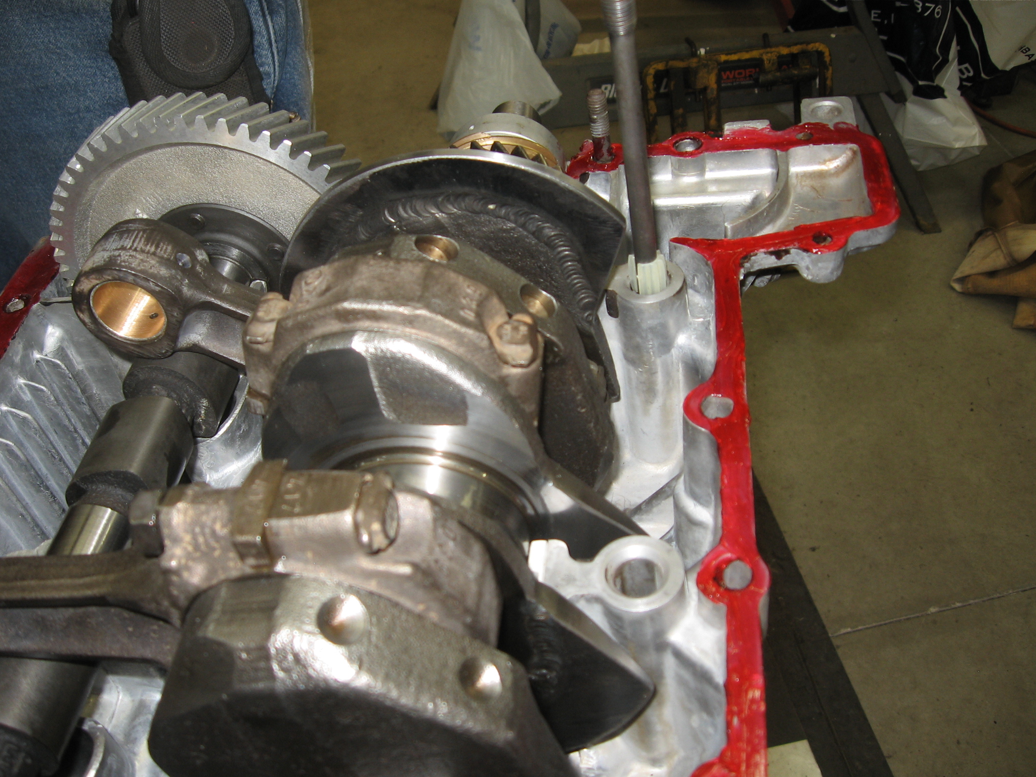

Now we are ready to mate the case halves. Before we do, this thread is not meant to be a step by step instruction. Just a guide. You do need a manual or two. The Robert Bentley, and Tom Wilson's " How to rebuild your Aircooled VW engine are excellent.

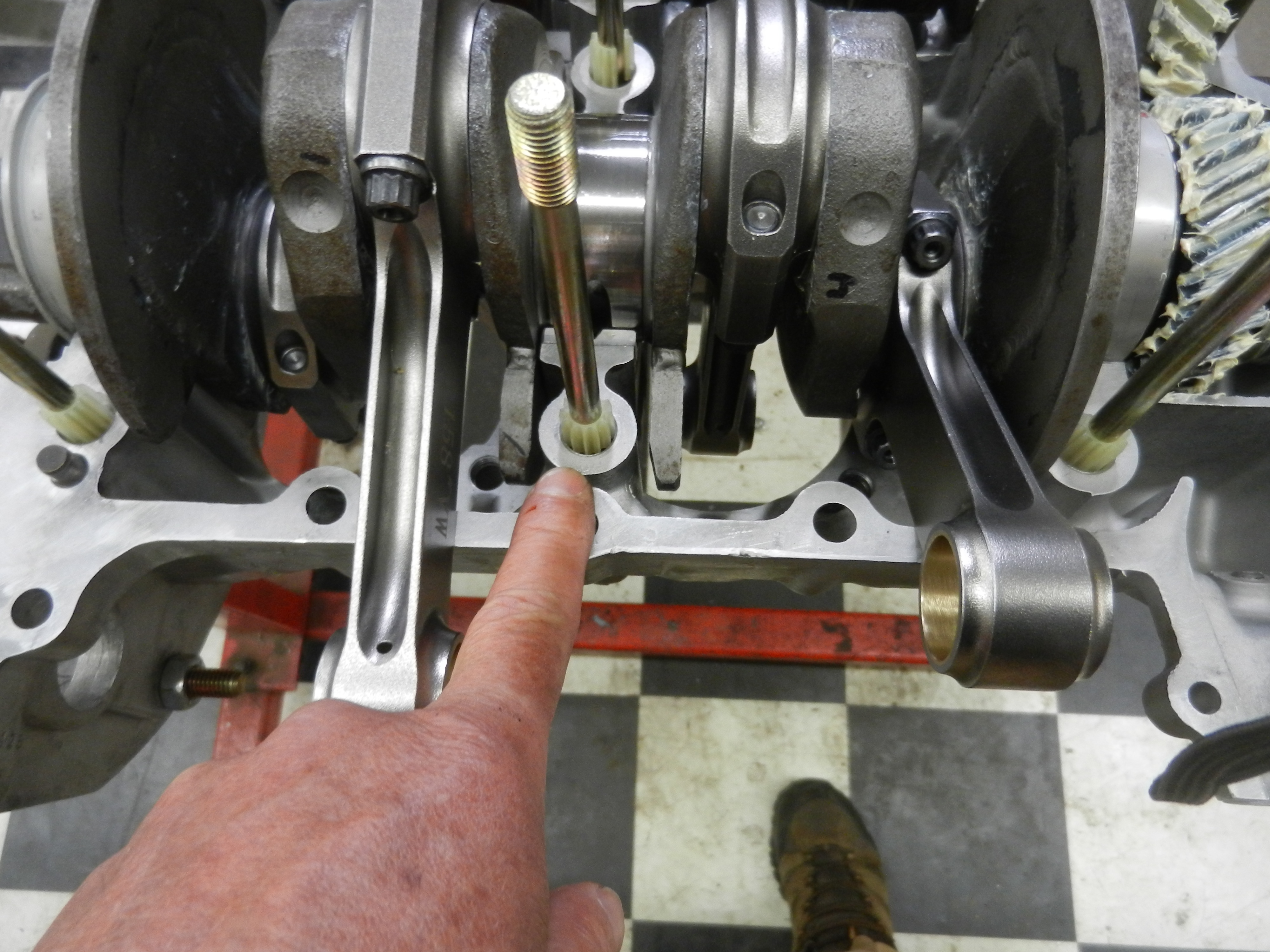

Now, an extra pair of hands helps. You need tho get the 6 main case bolts aligned in the other case half, while holding the 1 & 2 connecting rods up. I tied the rods after getting the thru bolts inserted in the other case half.
When you get the case halves seated, coat the washers and threads with some Permatex 3H.
I like to snug these up and rotate the assembly before going any further. You can bolt the flywheel on to help rotate.
rotate several times. If all is good, install the rest of the case parting hardware. There are wavy washers on all of them,bolt heads and nuts. I still like to put a little 3H on them.
Don't miss this one.

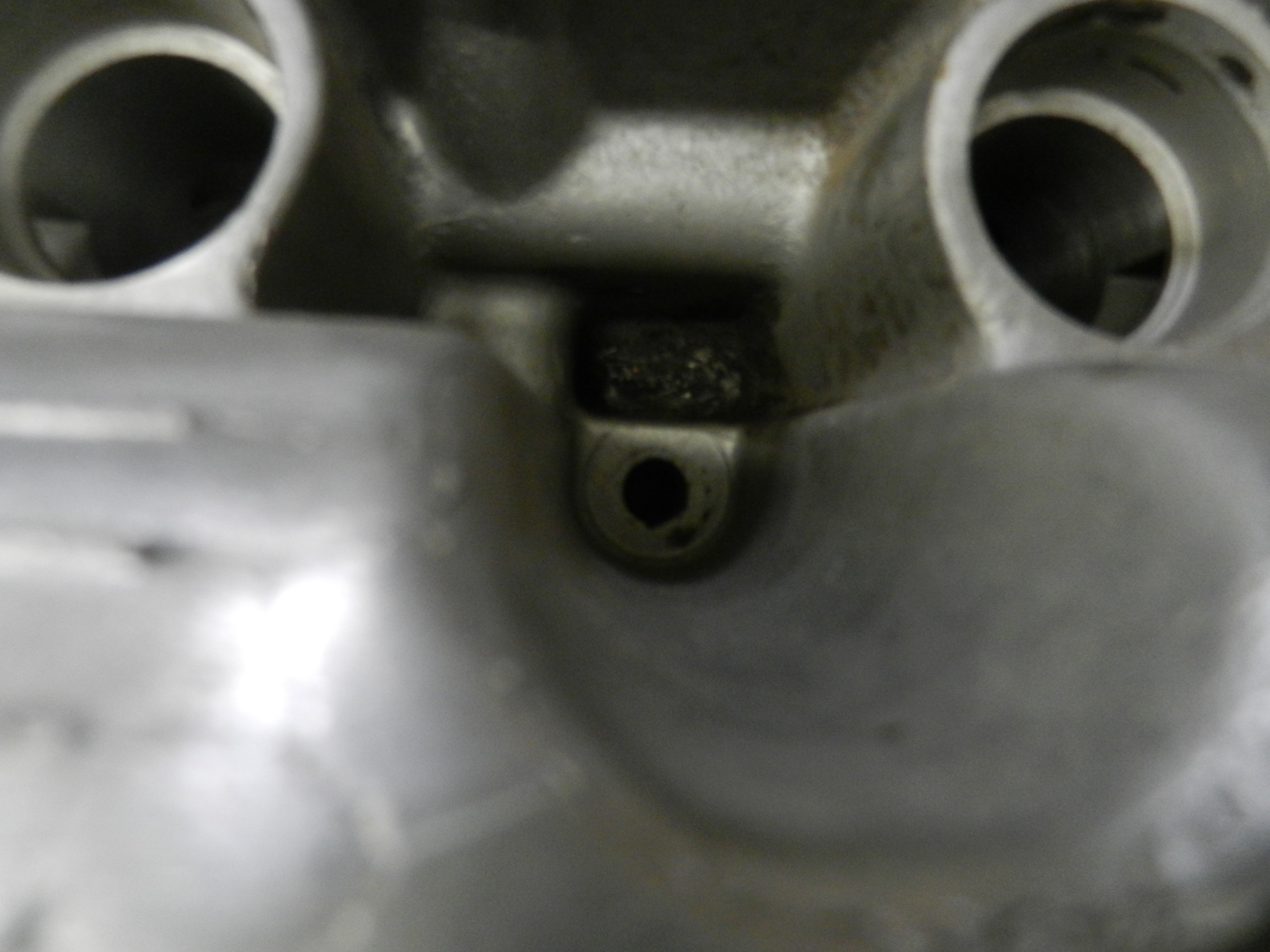

Or this one. I like to get this one first (after the 6 main), just to be sure the pick up tube is aligned. Sealer here,along with the wavy washer is important, as it sits in the sump area.
Torque them all according to sequence in the manual. Rotate the assembly often to be sure nothing is binding.

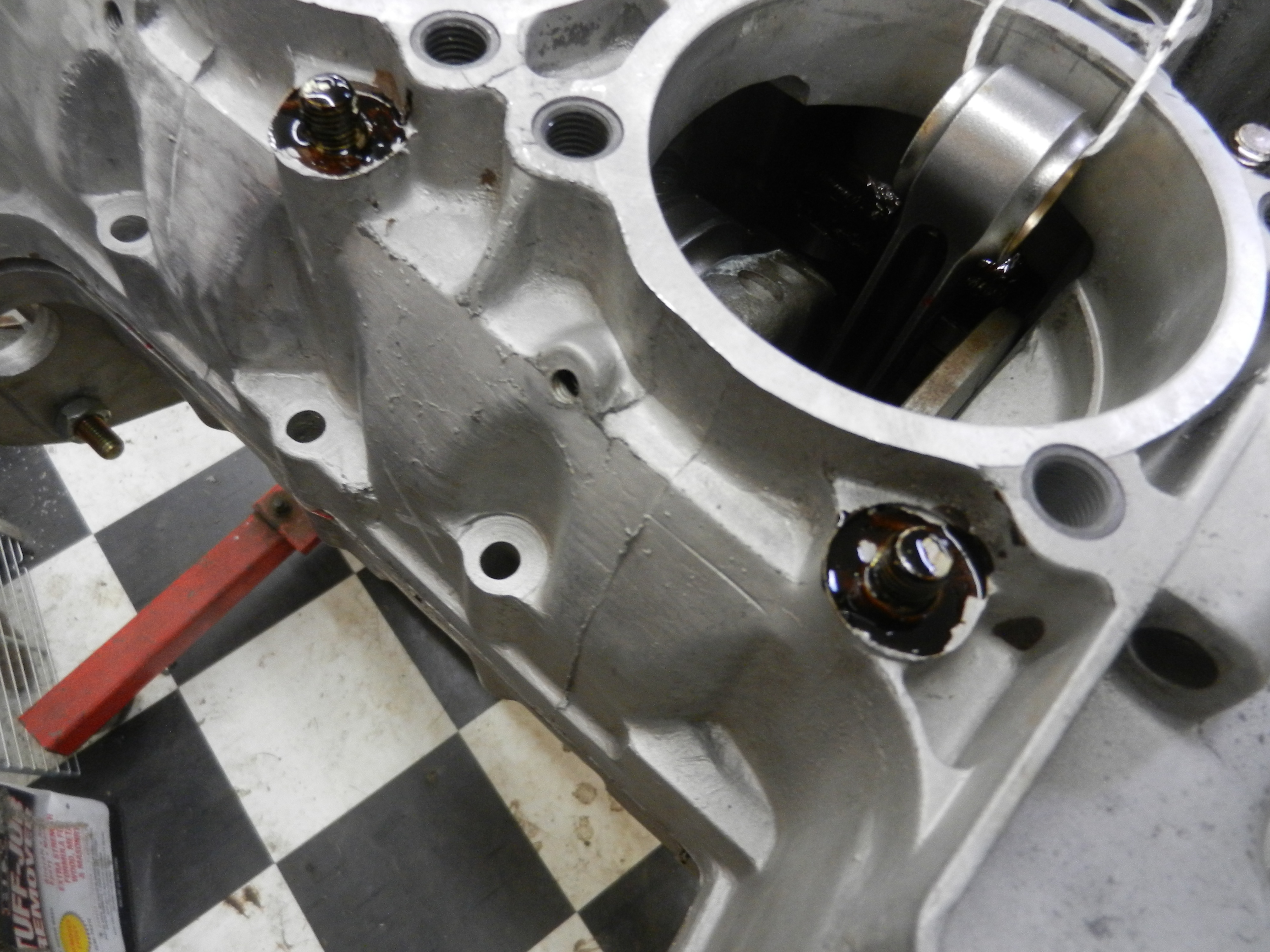

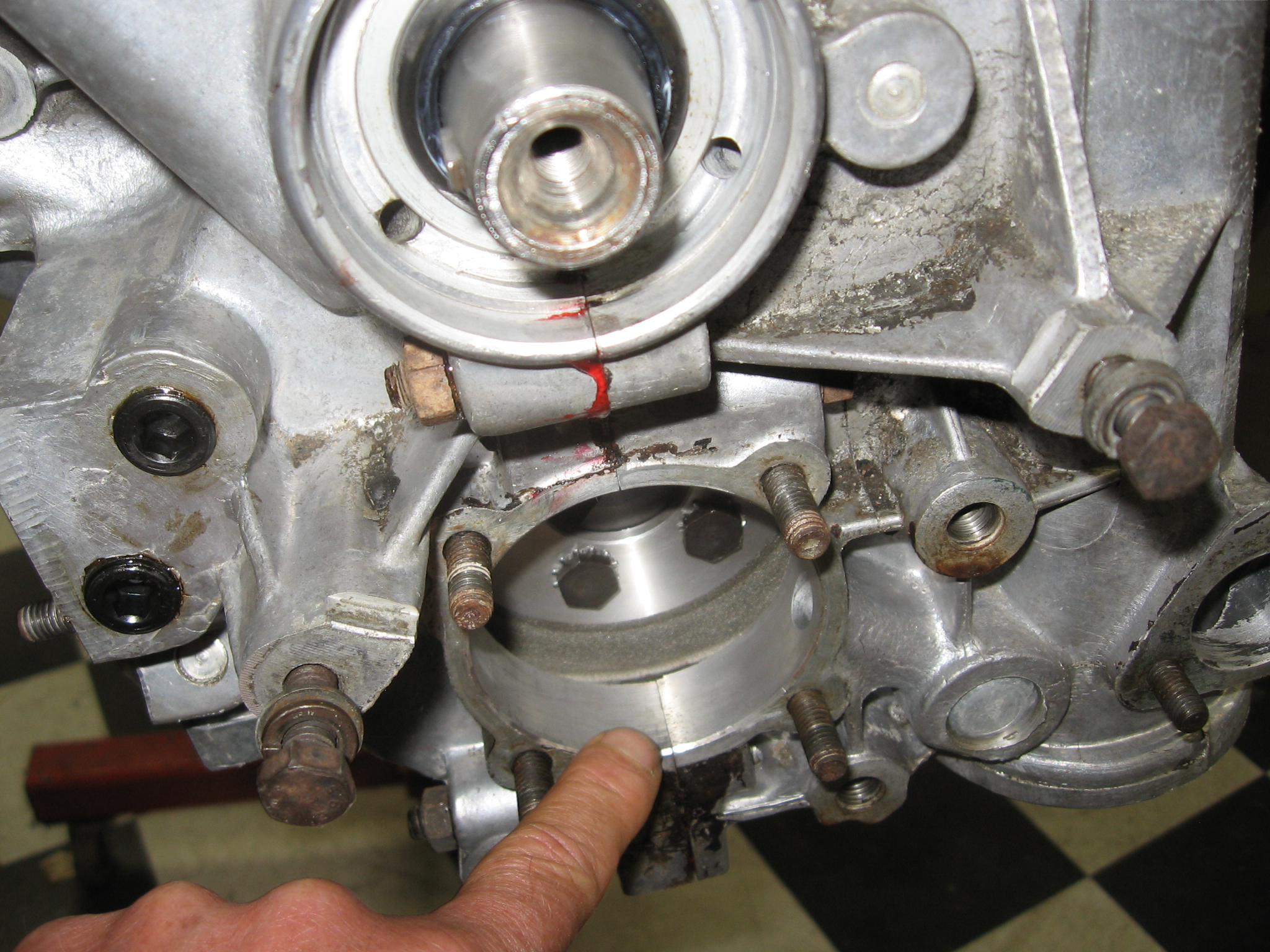

Once you are satisfied that all is good, wipe excess sealer from the oil pump area, and both crank seal areas.
Whoo Hoo.

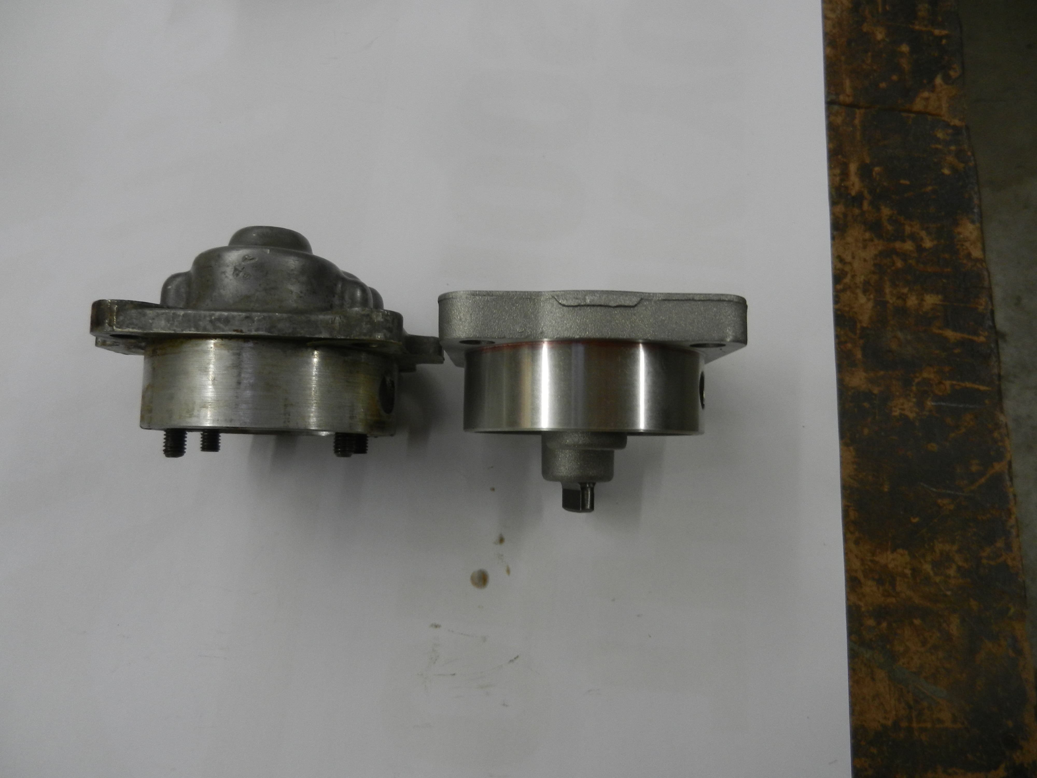

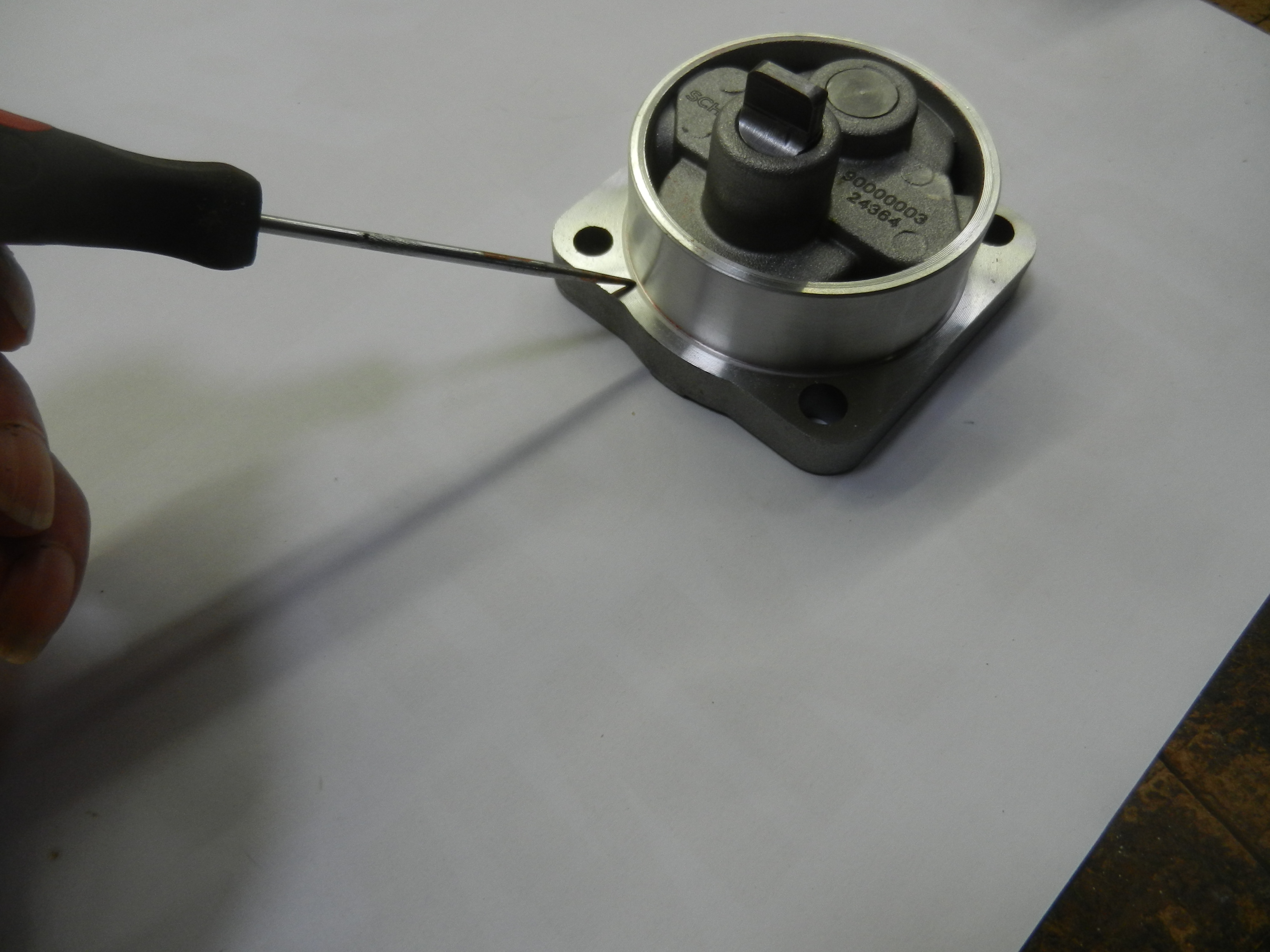

Sorry for the delay in continuing. Got a little busy. I'm going to back up a bit. Since I did not take pics and document the modified type 3 oil pump from European Motorworks, I'll explain a little now.

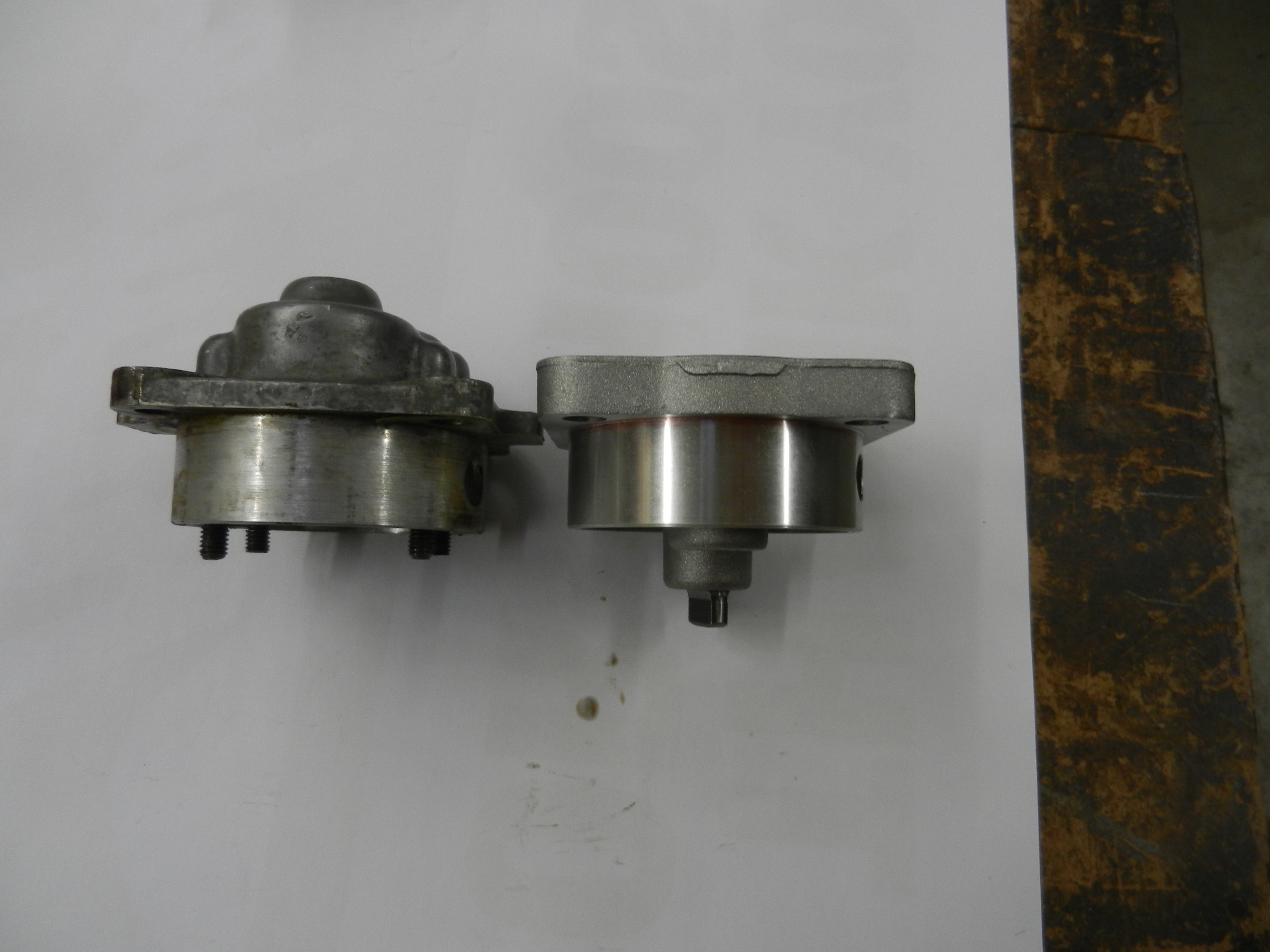

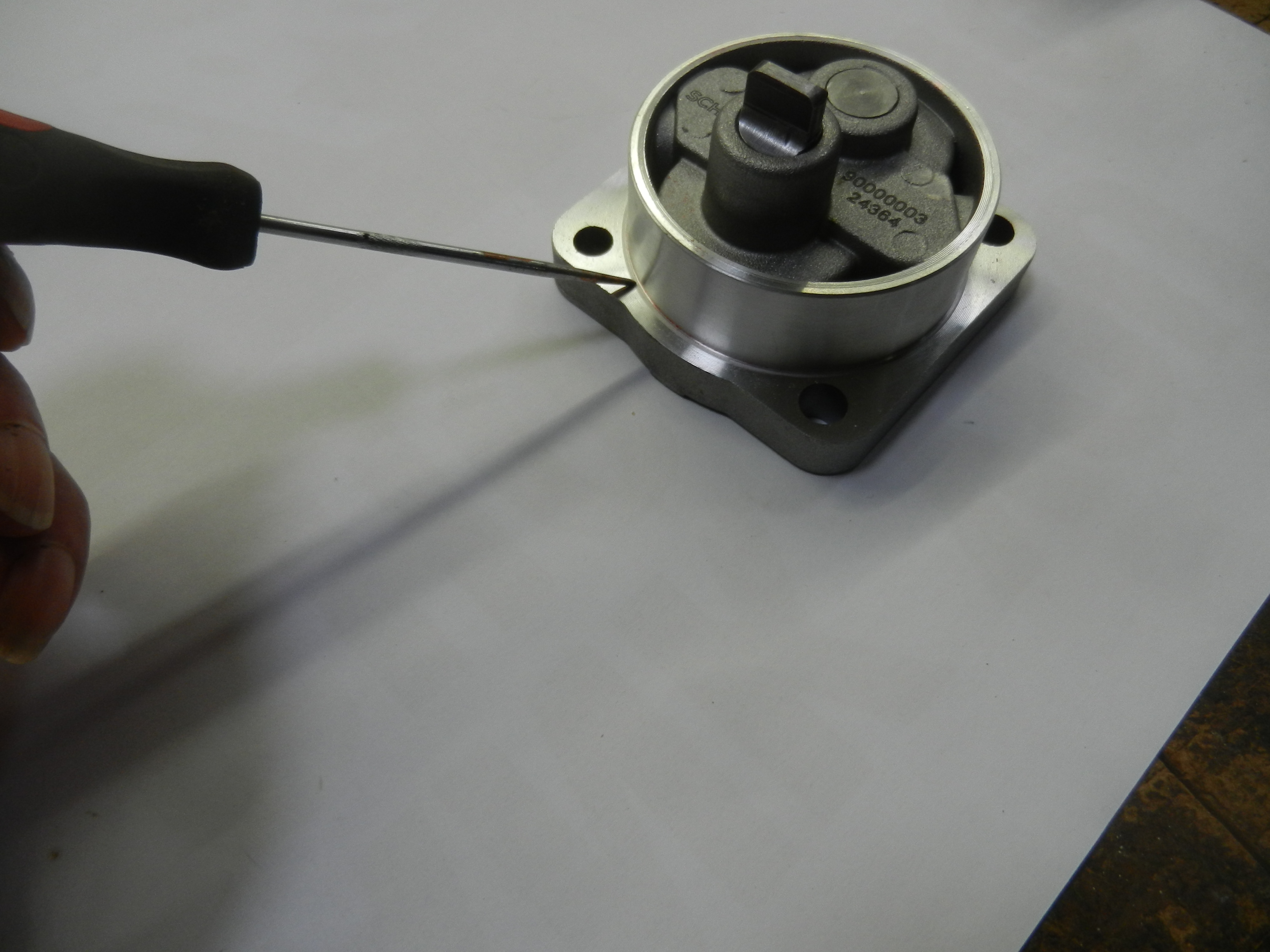

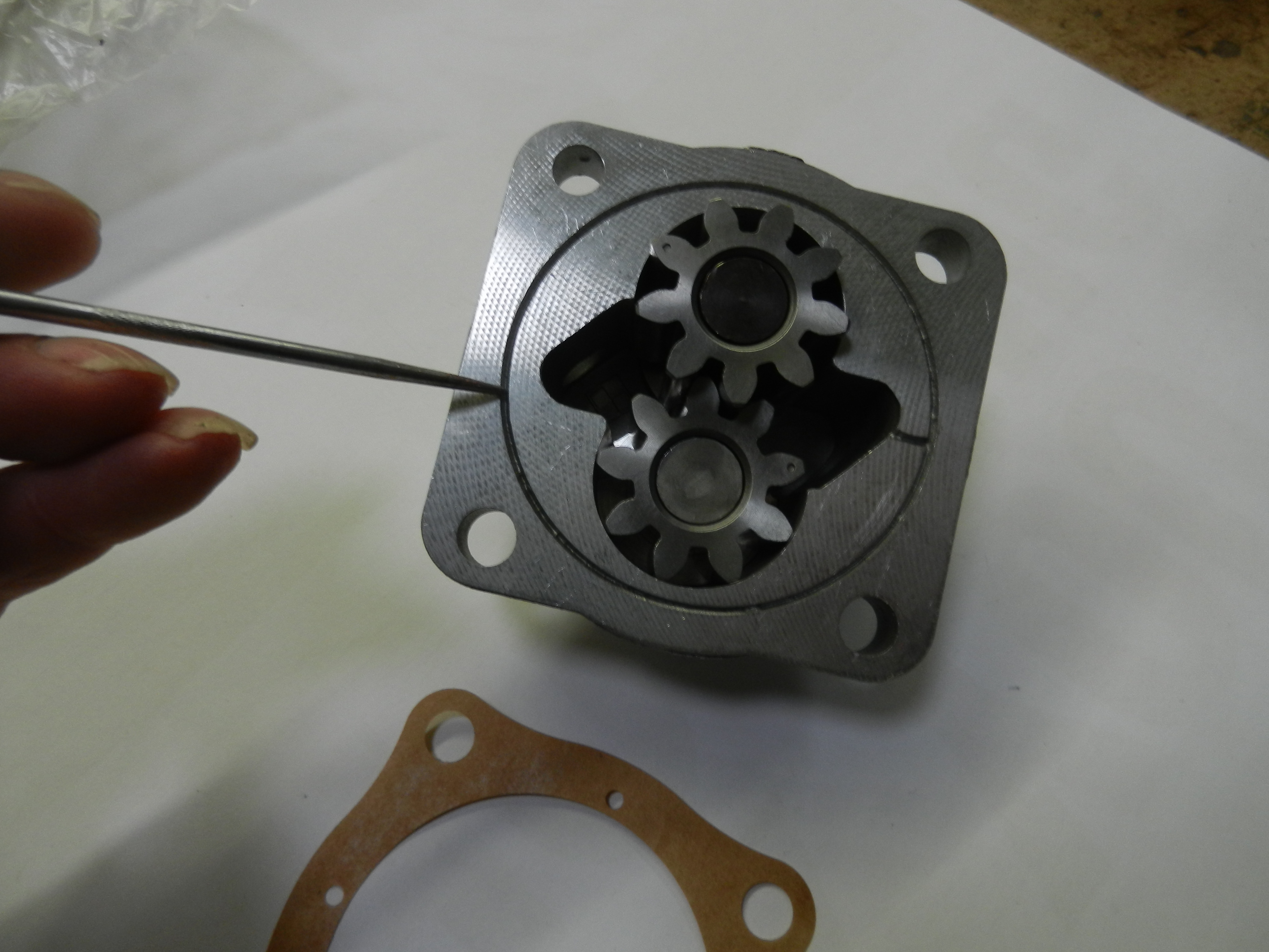

Jorge modifies the type 3 pump shaft to work with type 4 cam gear.
As you can see, the flange on the type 3 pump is considerably thicker than the stock type 4 pump. This requires installing longer studs.

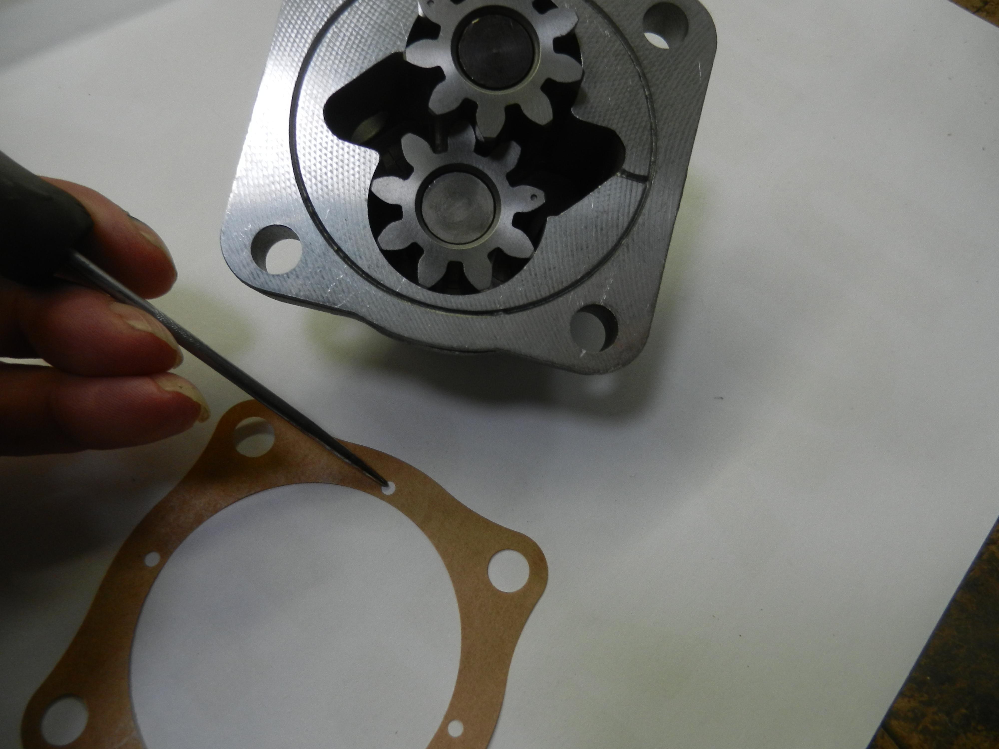

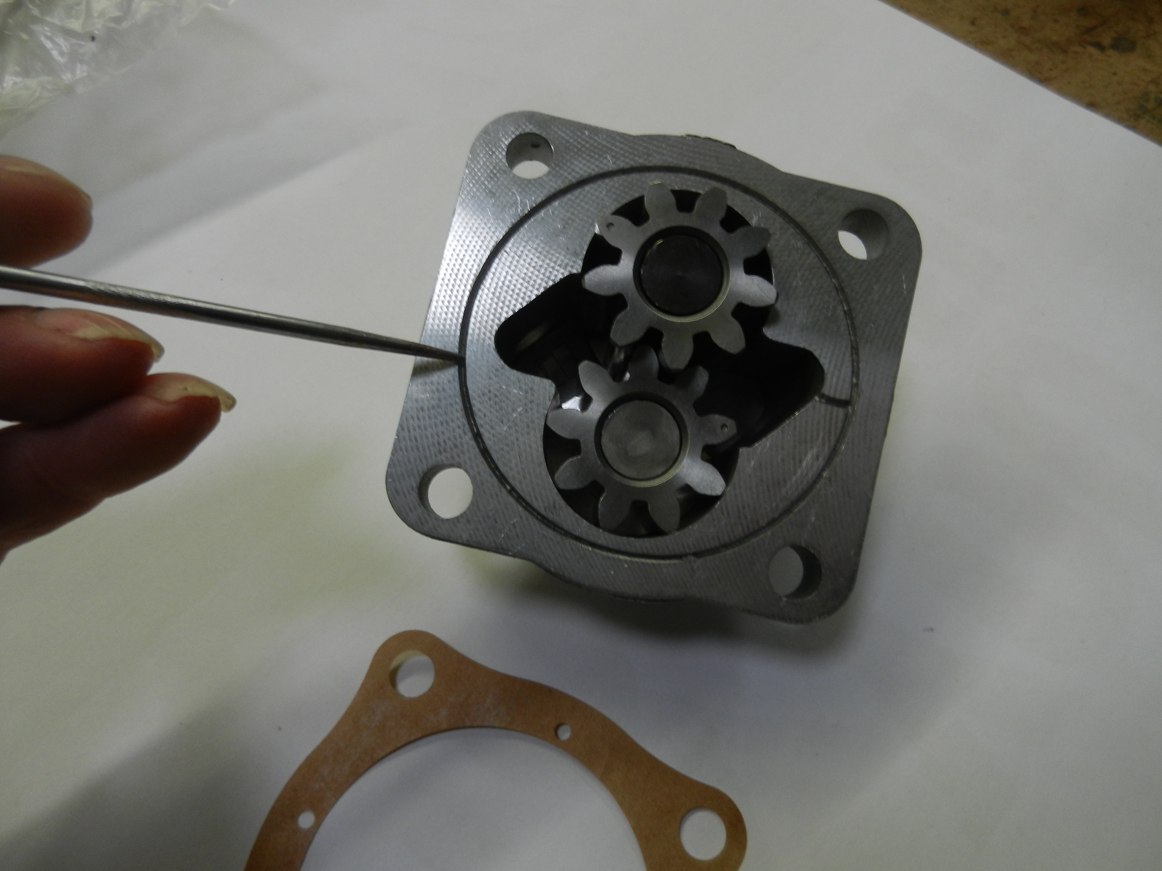

Installation is the same as type 1. A thin coat of permatex 3H on the gaskets, or if you choose,or hi tack, or gasket shellac. Just a thin coat. Be careful to not get sealer in the oil groove in the pump or the holes in the gasket.
Also, a thin bead of Yamabond around where the pump body to ensure no leaks.
Pack the gears and the pump body with white grease. This helps priming the pump to get oil pressure quickly. I also pump some oil down the oil pressure switch hole prior to initial turn over.
Install the cover gasket and cover and coat the stud threads with permatex. I also like to use a sealing nut.

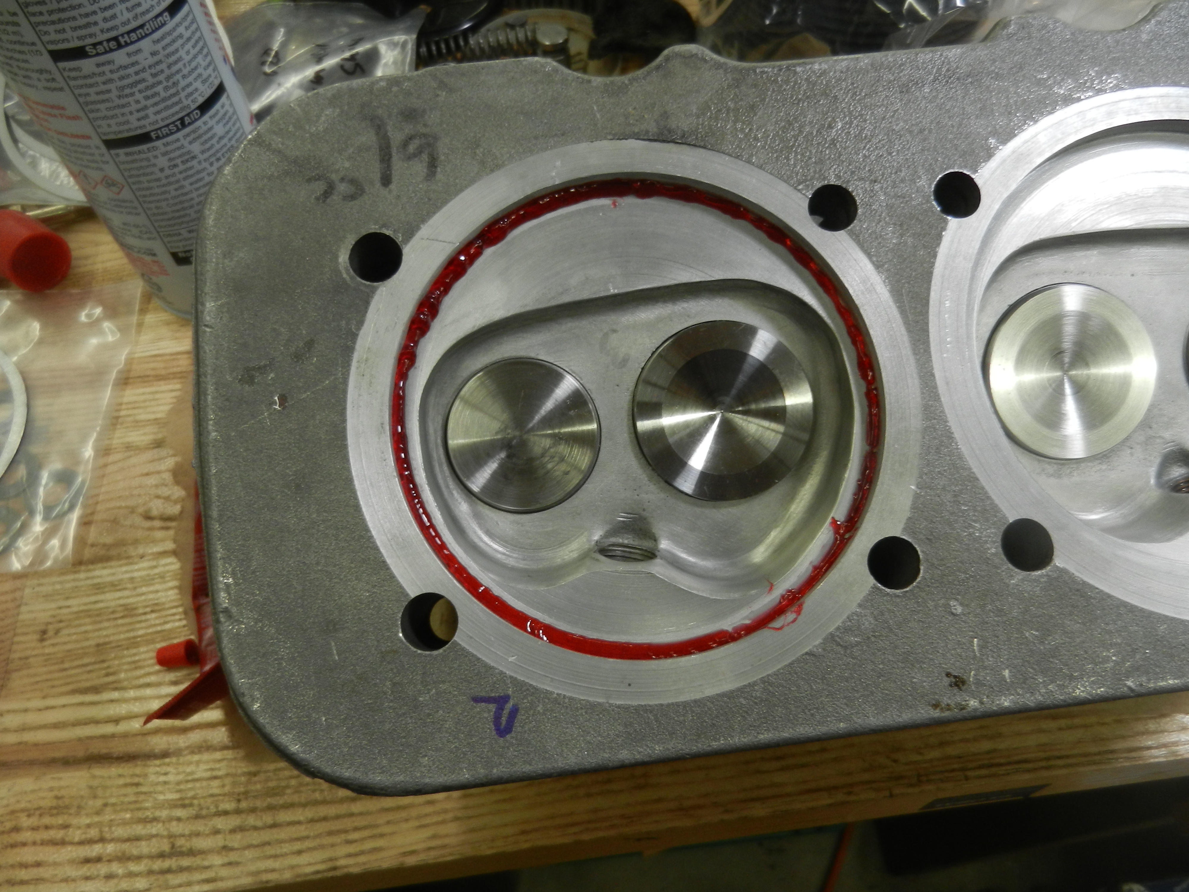

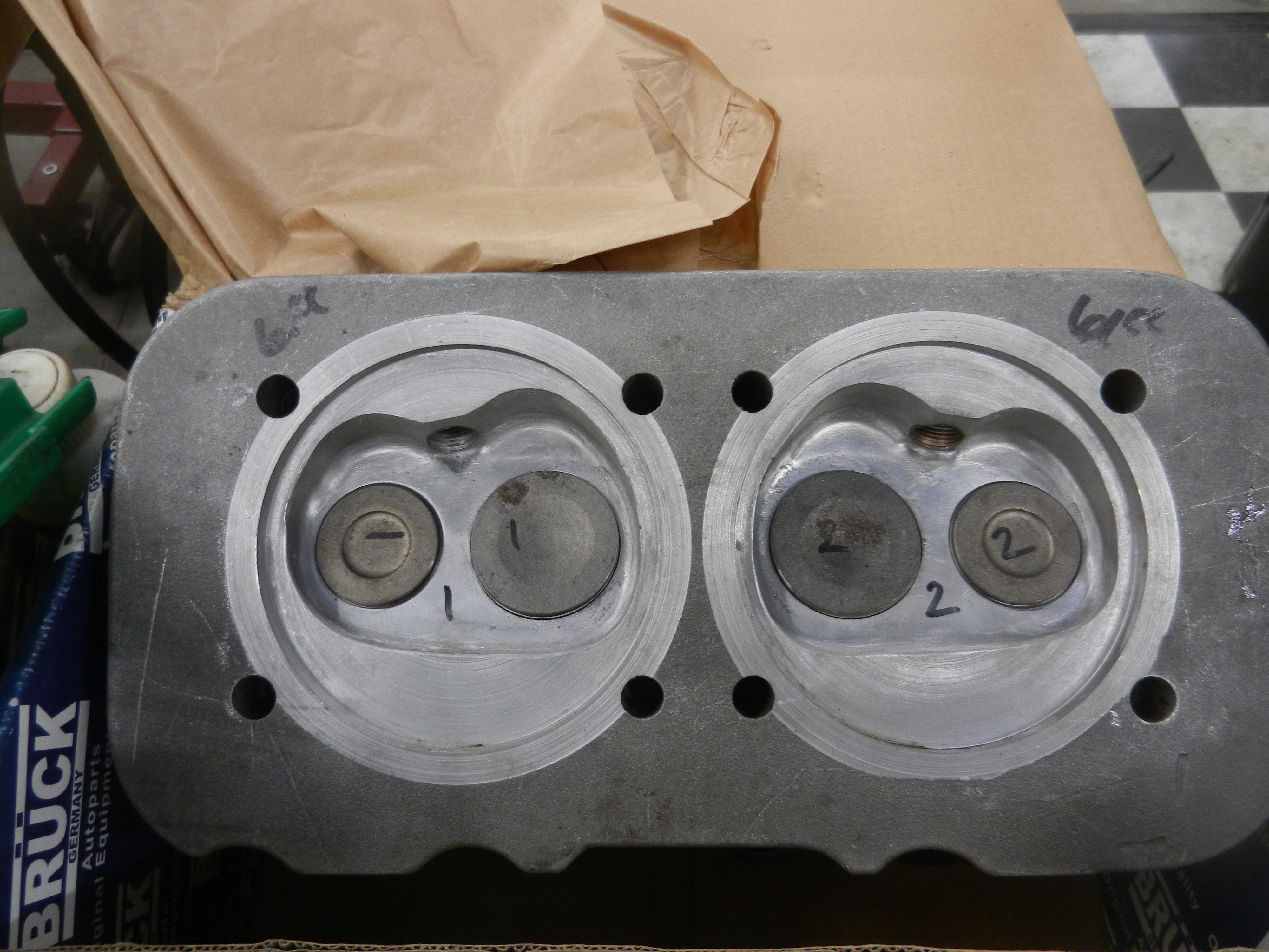

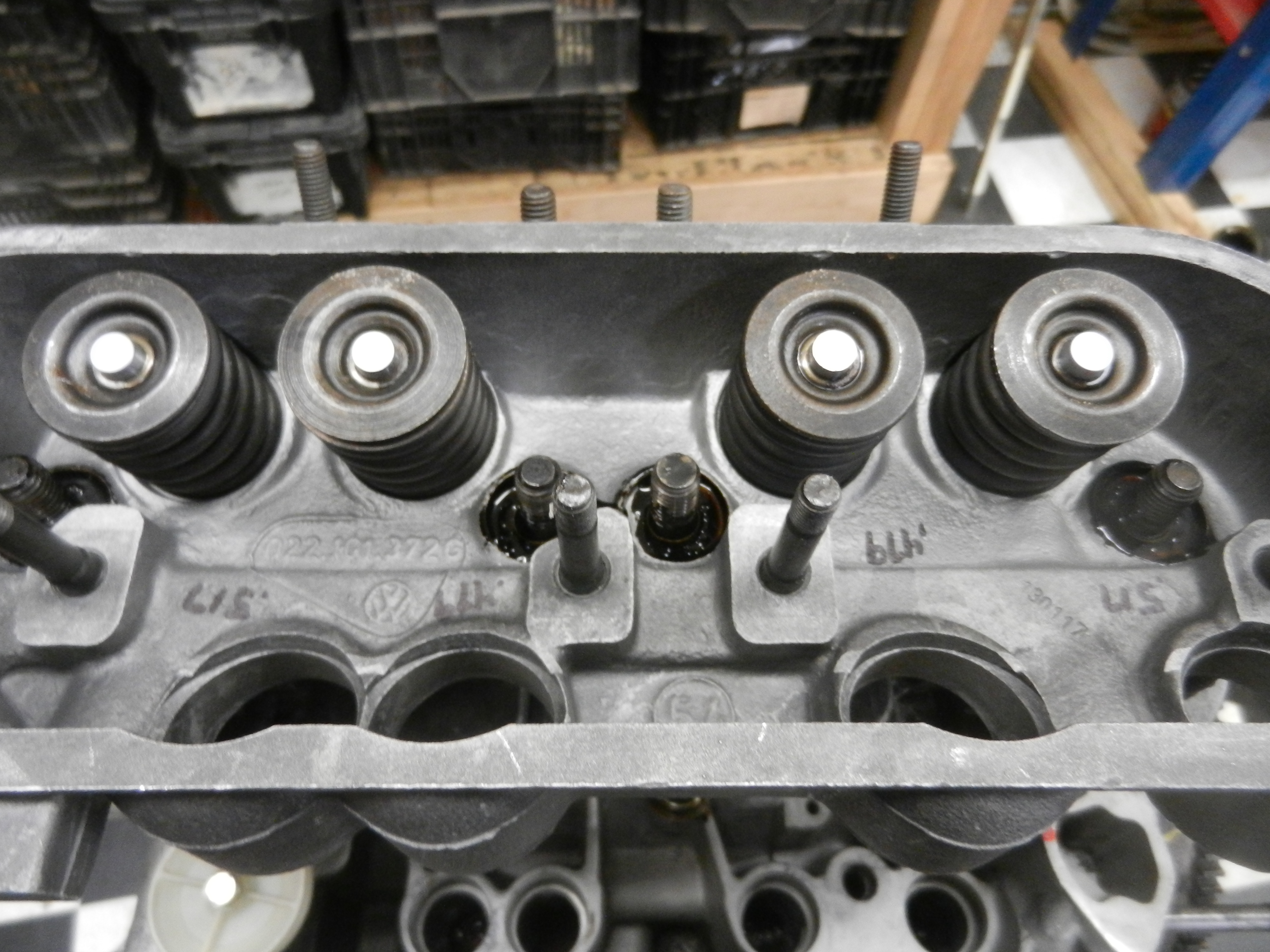

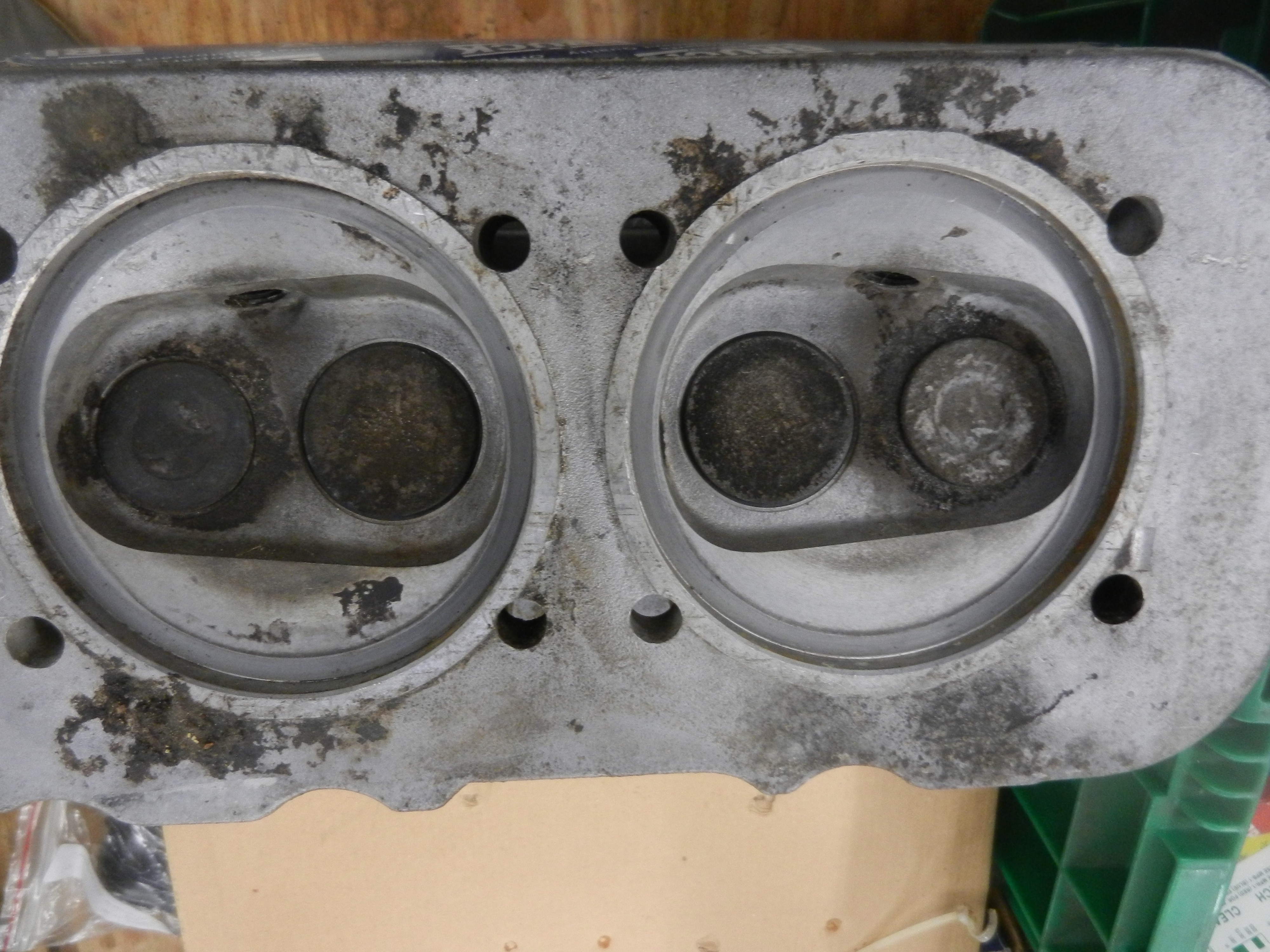

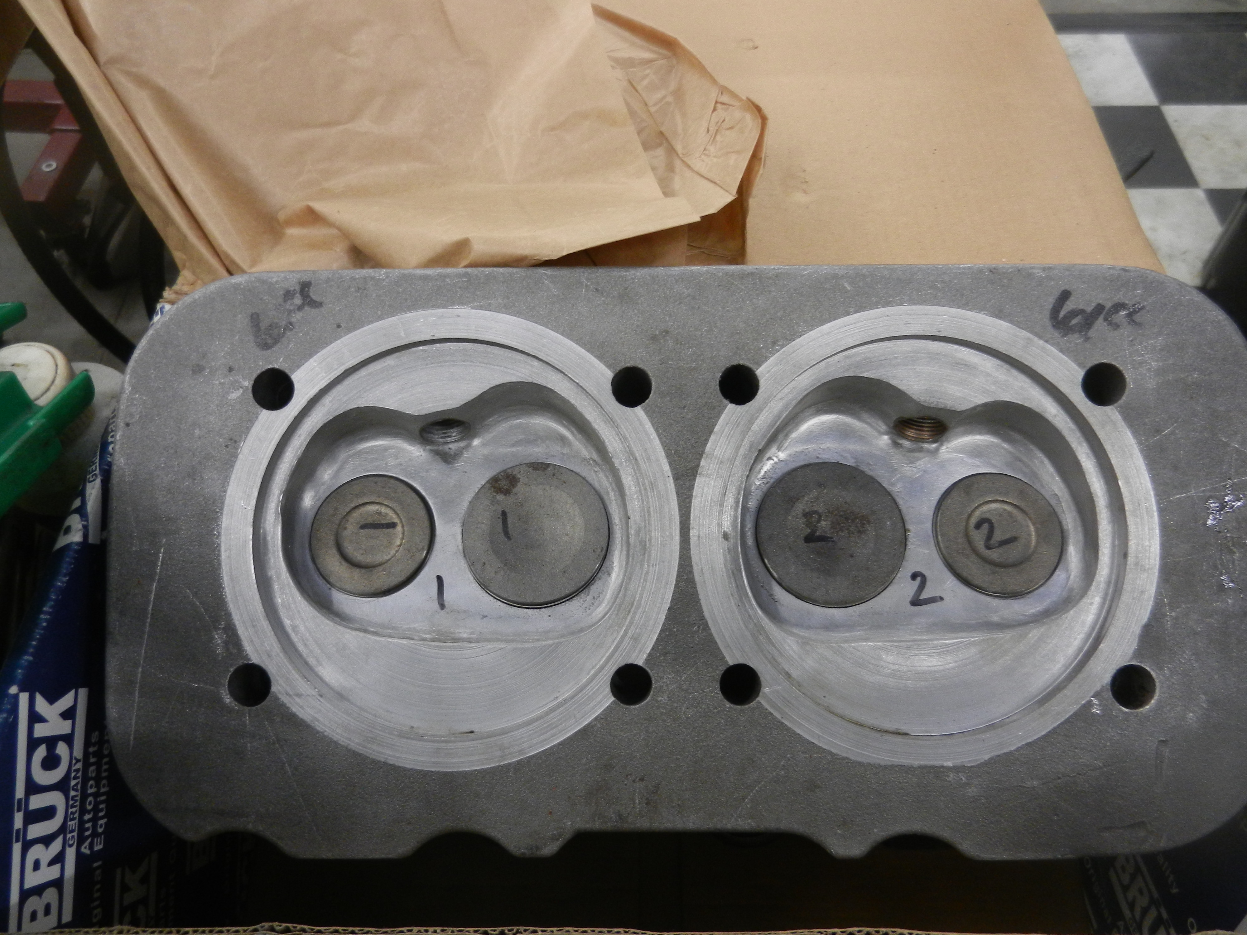

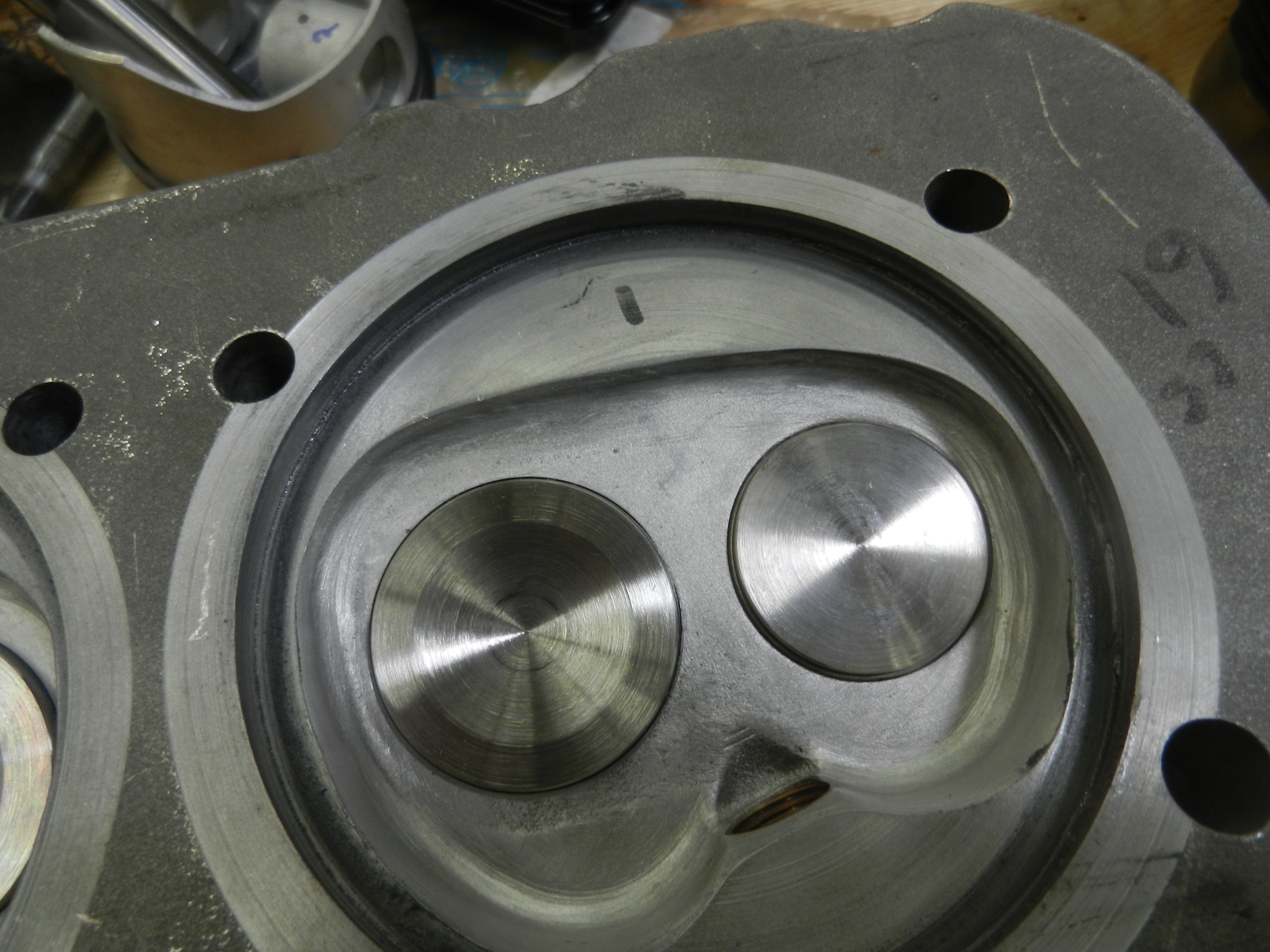

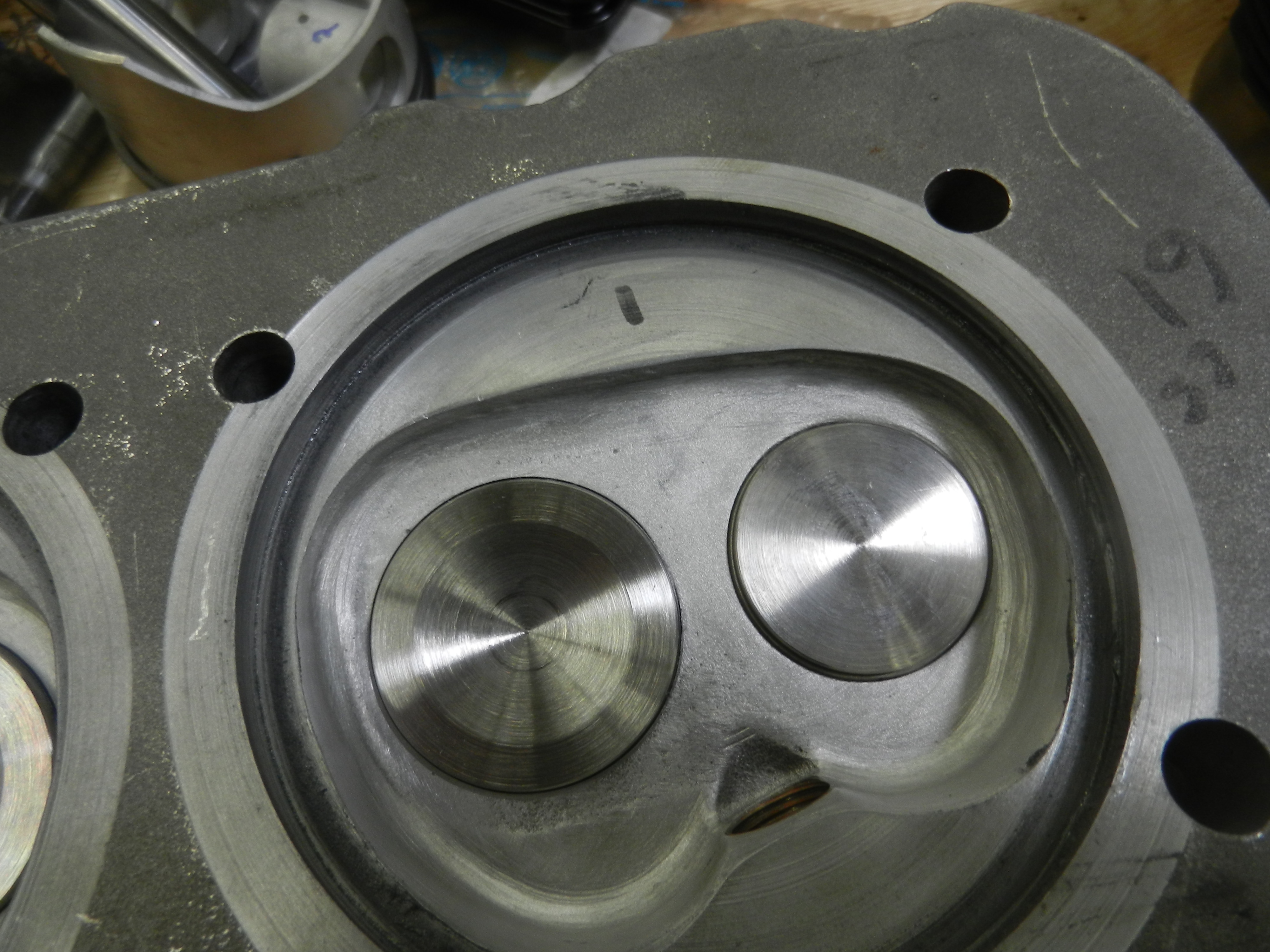

Moving on. I will spend a minute on the heads, which we will get back to later. I acquired these heads 15 or 20 years ago
and set the aside for this future build. Short story, they were part of a gift to me from a customer. They came from Mark Stephens High performance around the time they were closing the shop. the first thing I noticed, along with the port and polish work, was the chamber work AND, the head cc. 61cc as opposed to the stock of around 55cc.
Stock 2 liter head.
My head.
My original intent was to use stock 94mm 2L pistons which have a 7cc dish. plugging the 61cc head chamber volume along with my desired deck ht. of .035 to .40, I realized that my comp ration would be too low, under 7:1
So, while the heads were sent off to Delzani's to install my new stainless steel valves and the valve springs supplied by the cam manufacture, I explored my options.
Option 1 was to use 914 Euro spec 94mm flat top pistons.

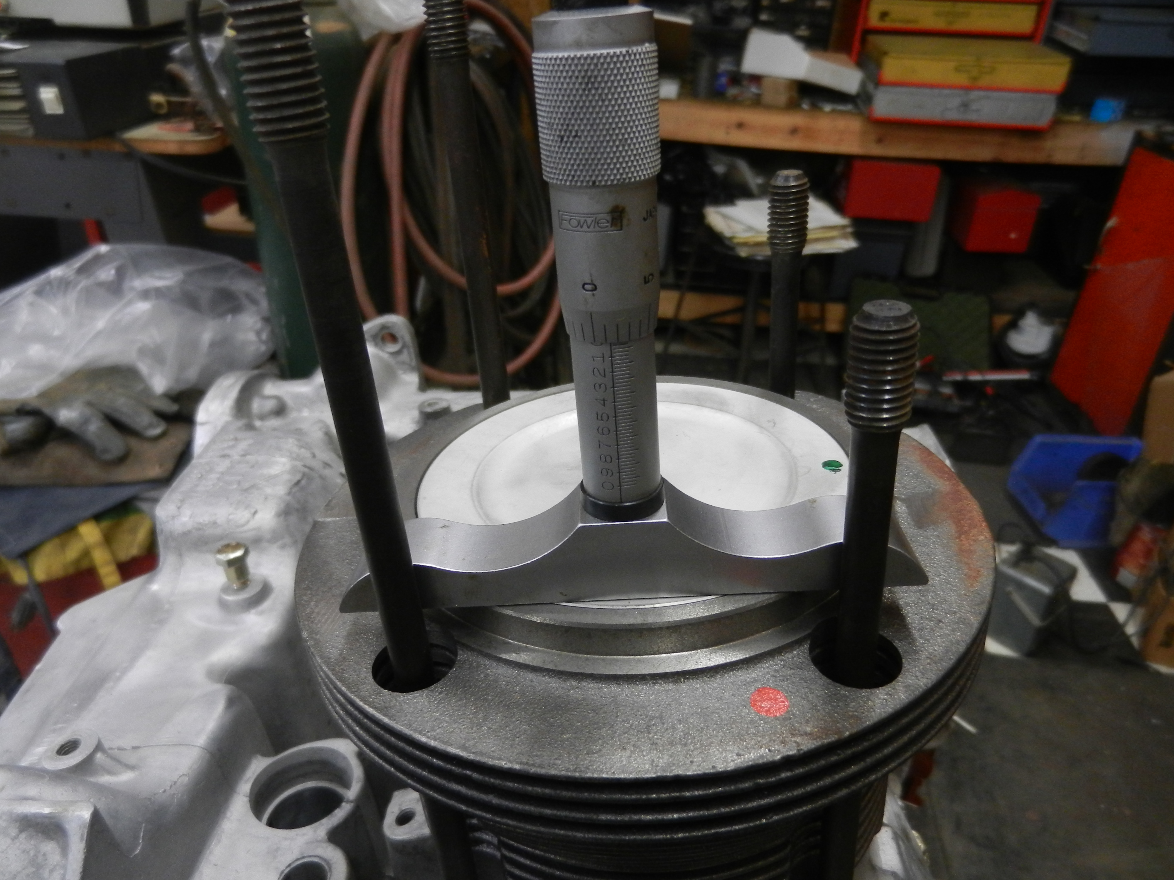

This pic is not the 94mm flat top but shows the deck ht. .001 not clamped down. .000 was the measurement clamped.
This was an unintended result of decking the case. But worked, as I could now choose the appropriate shim to get my desired deck ht. and comp ratio.Assuming a .030 deck shim. I came up with 8.4:1 comp ratio. acceptable, but I tend to be conservative when it comes to comp ratio for a bus. .040 deck shim got me 8.2:1. Again acceptable but I was shooting for under 8:1
Option 2 was to use 96mm NPR dished pistons. Using a .040 shim, for .040 deck ht( The max I would accept), I ended up at 7.72:1 comp ratio. Larger displacement 2.1 liter and a comp ratio I can live with.
Just a word on deck ht. In addition to being part of the comp ratio formula, There is a happy number. Too low deck ht and you run into the problem of the piston hitting the bottom of the combustion camber, BAD. Too much deck ht and you have an issue with "squish" The goal is to have the combustion energy directed to the center of the combustion camber and the center of the piston. Too much deck ht and too much of this energy extends to the outer area of the chamber and the pistons putting more stress on the rings and the sealing area between the cylinder and the head.
Mark Stephens determined that somewhere between .020 and .025 deck ht became 0 on fully warmed aircooled VW motor. Making .030 to .040 ideal. This means that on a fully warmed engine, the comp ratio is going to be higher than your cold calculations. Also, eventual carbon build up decreases the chamber volume which also increase you comp ratio. This is why I tend to be conservative on comp ratio and like to be a bit under 8:1.
We will get back to this when we get back to the heads. Next up will be piston prep.

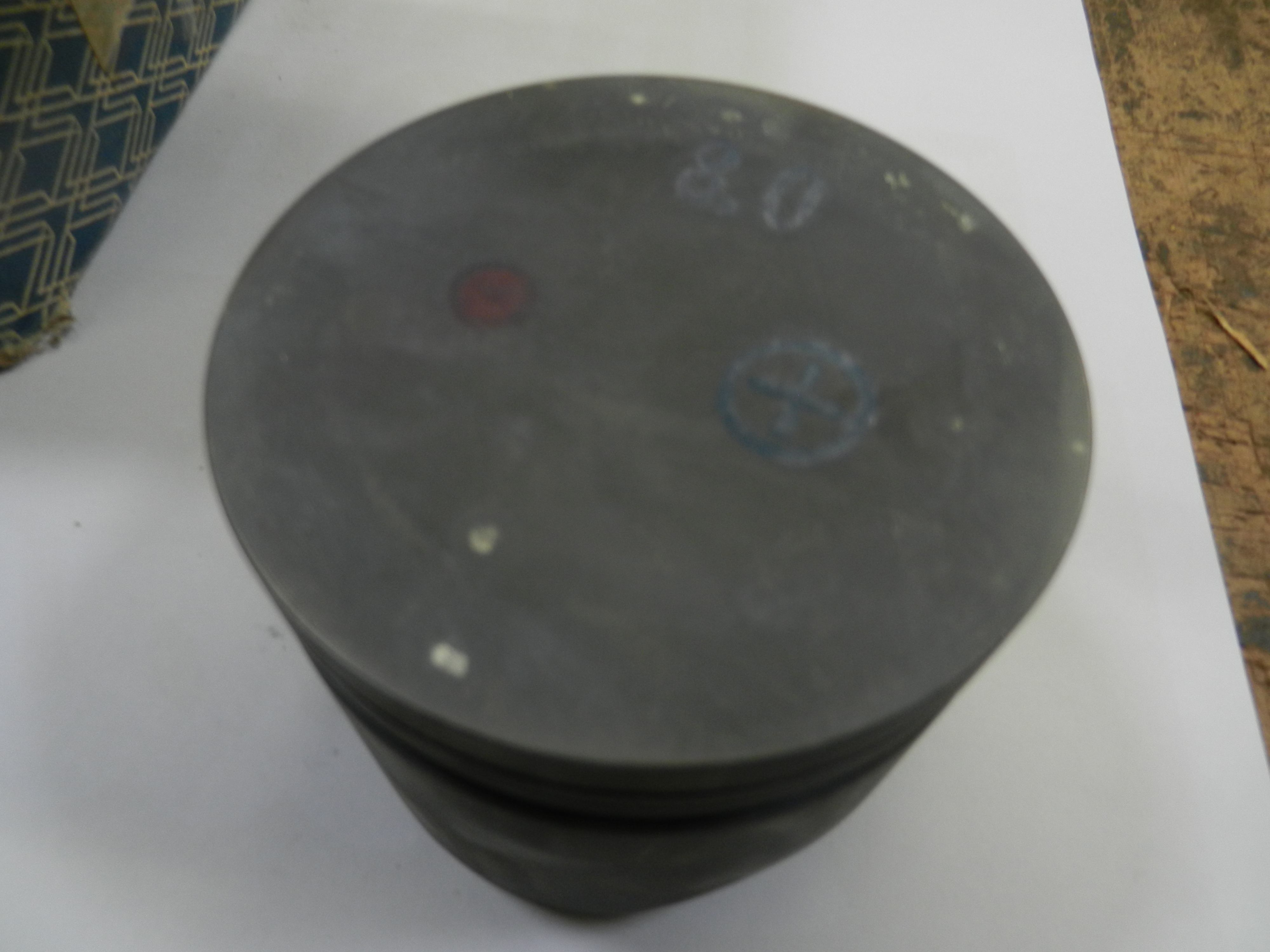

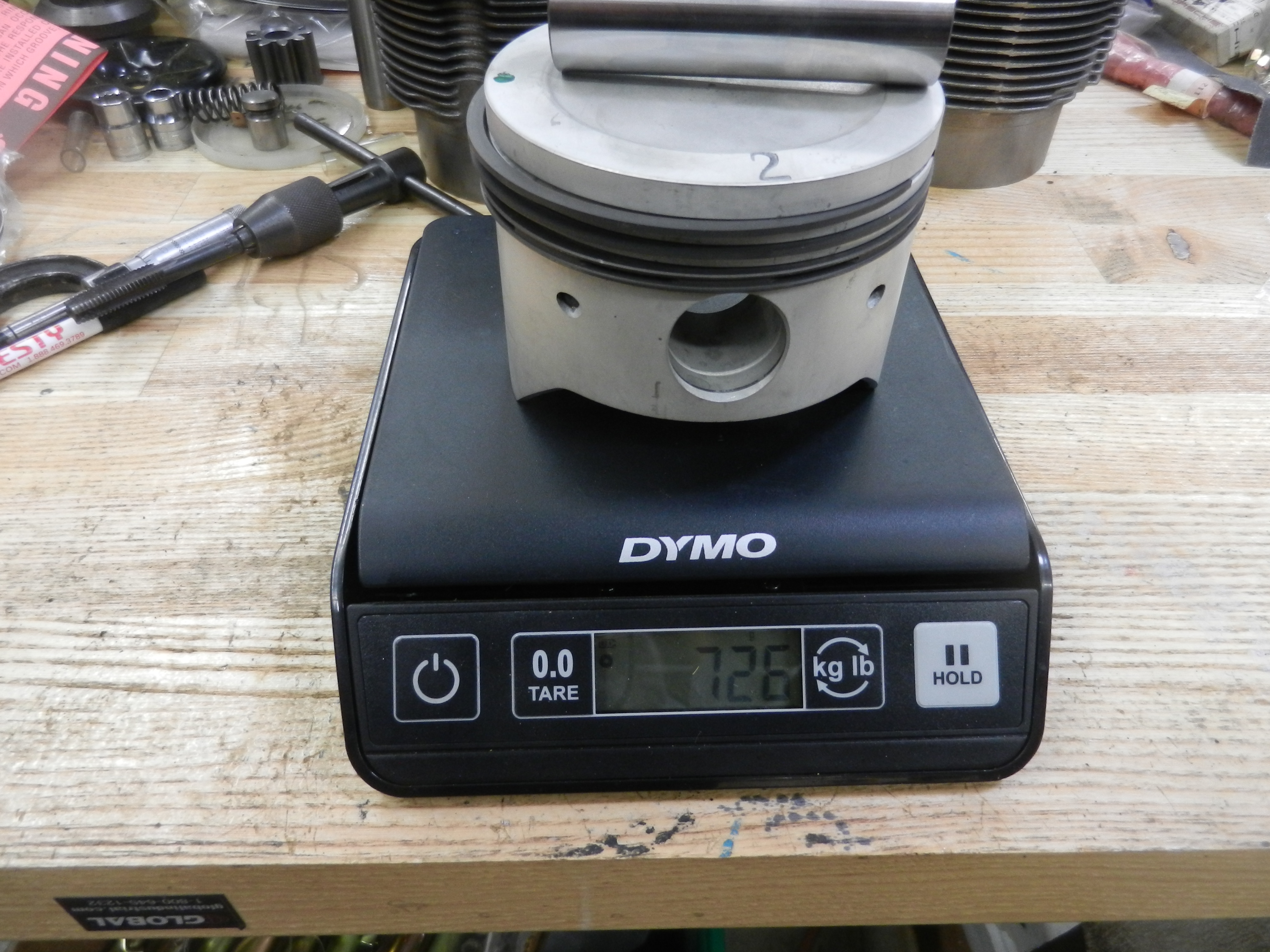

First thing, we are going to weigh them. Past experience with the NPR pistons, sadly no longer available, is that they are within 1 gram of each other. This held true for this set all 4 at 726 grams.

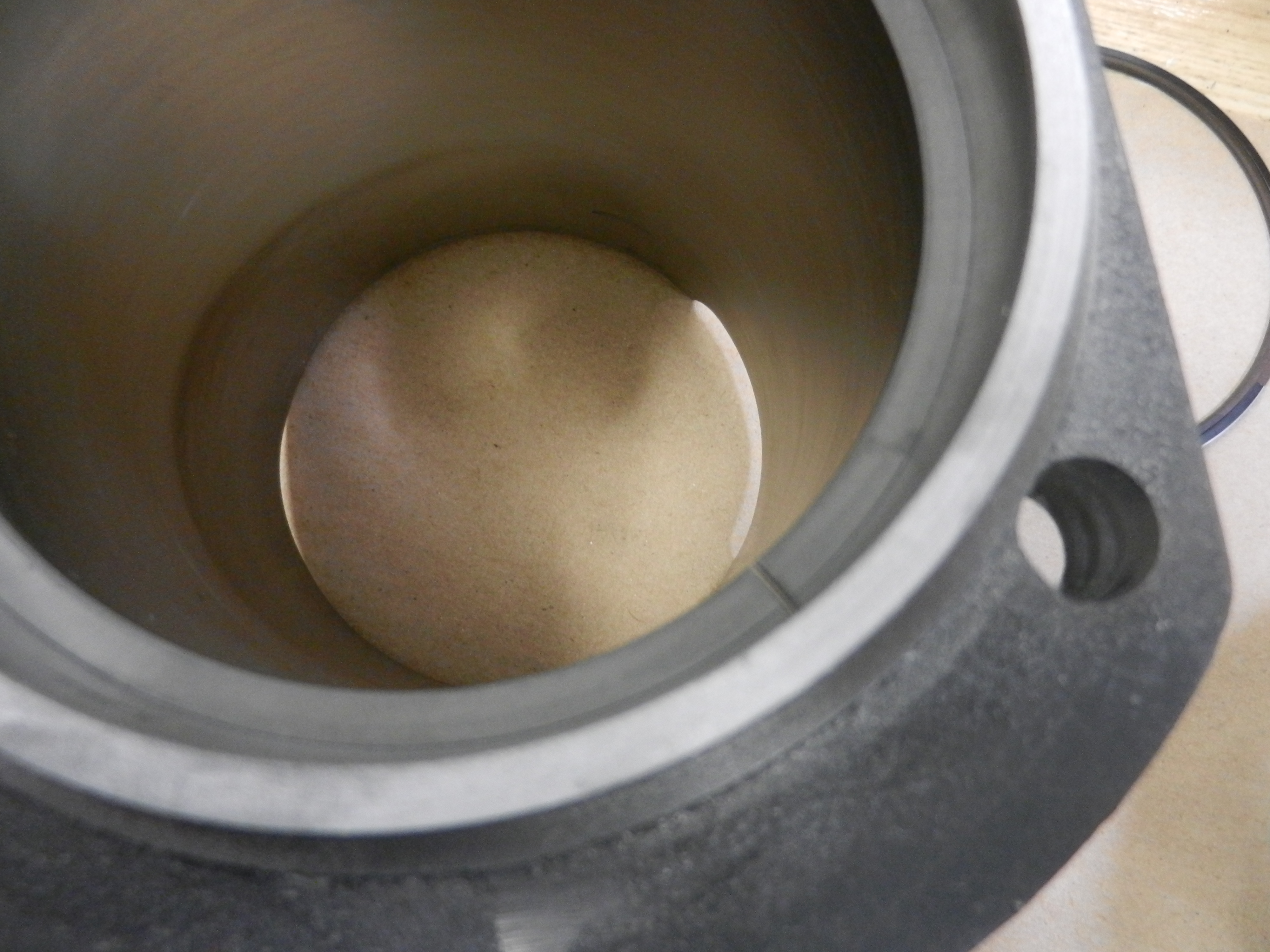

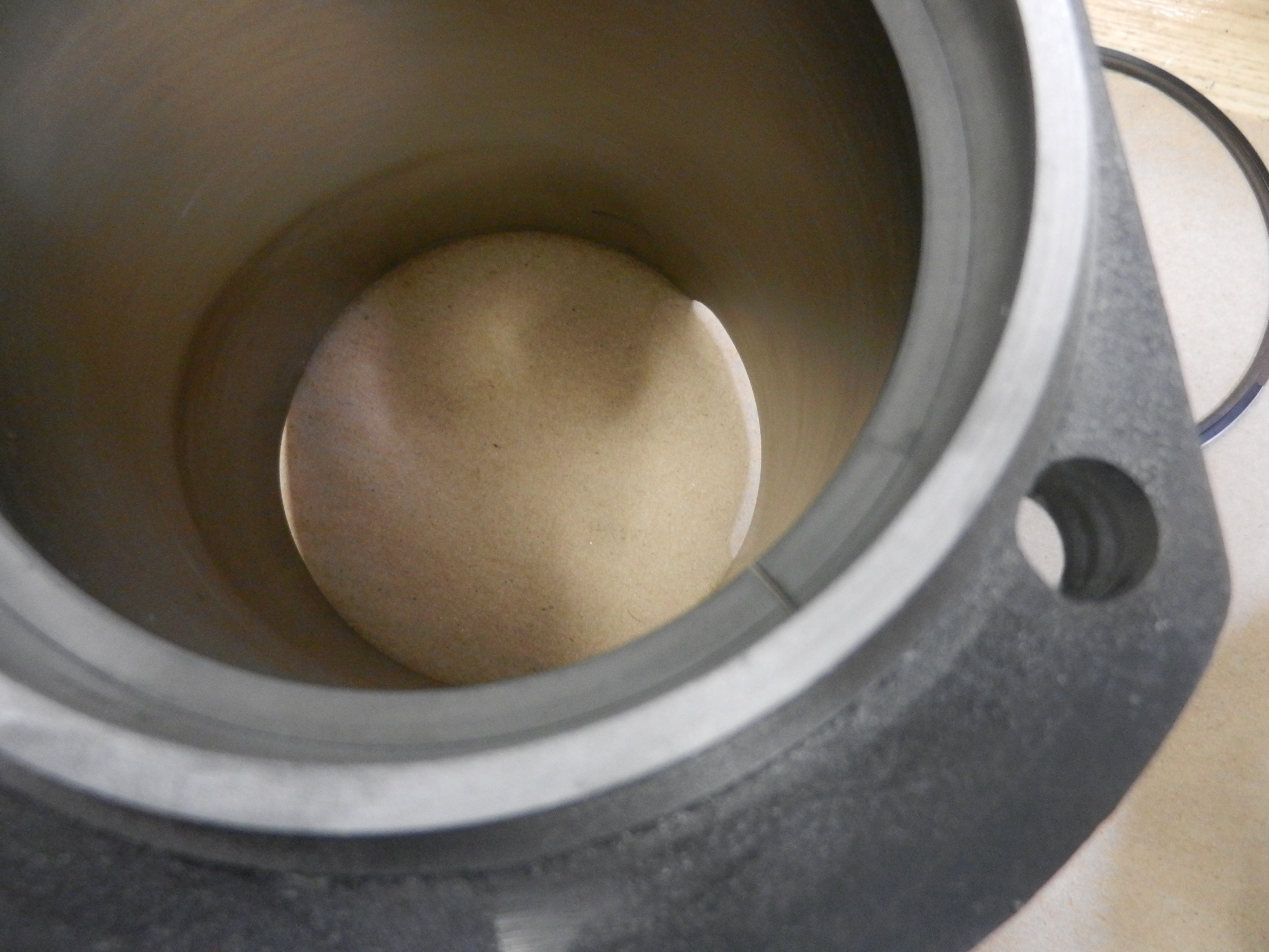

Next I like to put a little valve grinding compound around the rim of the cylinder. Then place the cylinder in the head
and rotate the cylinder back and forth, lapping the surfaces.

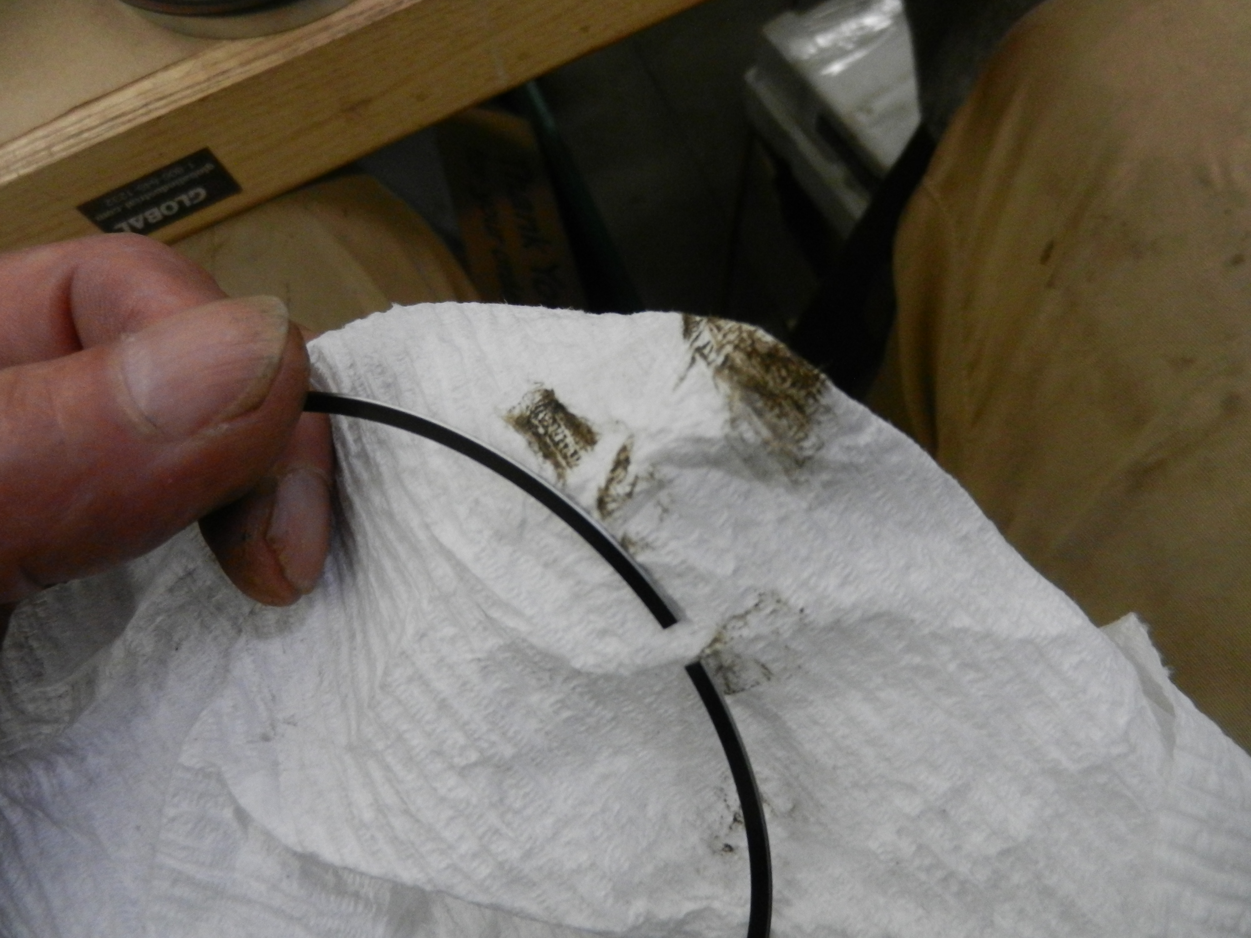

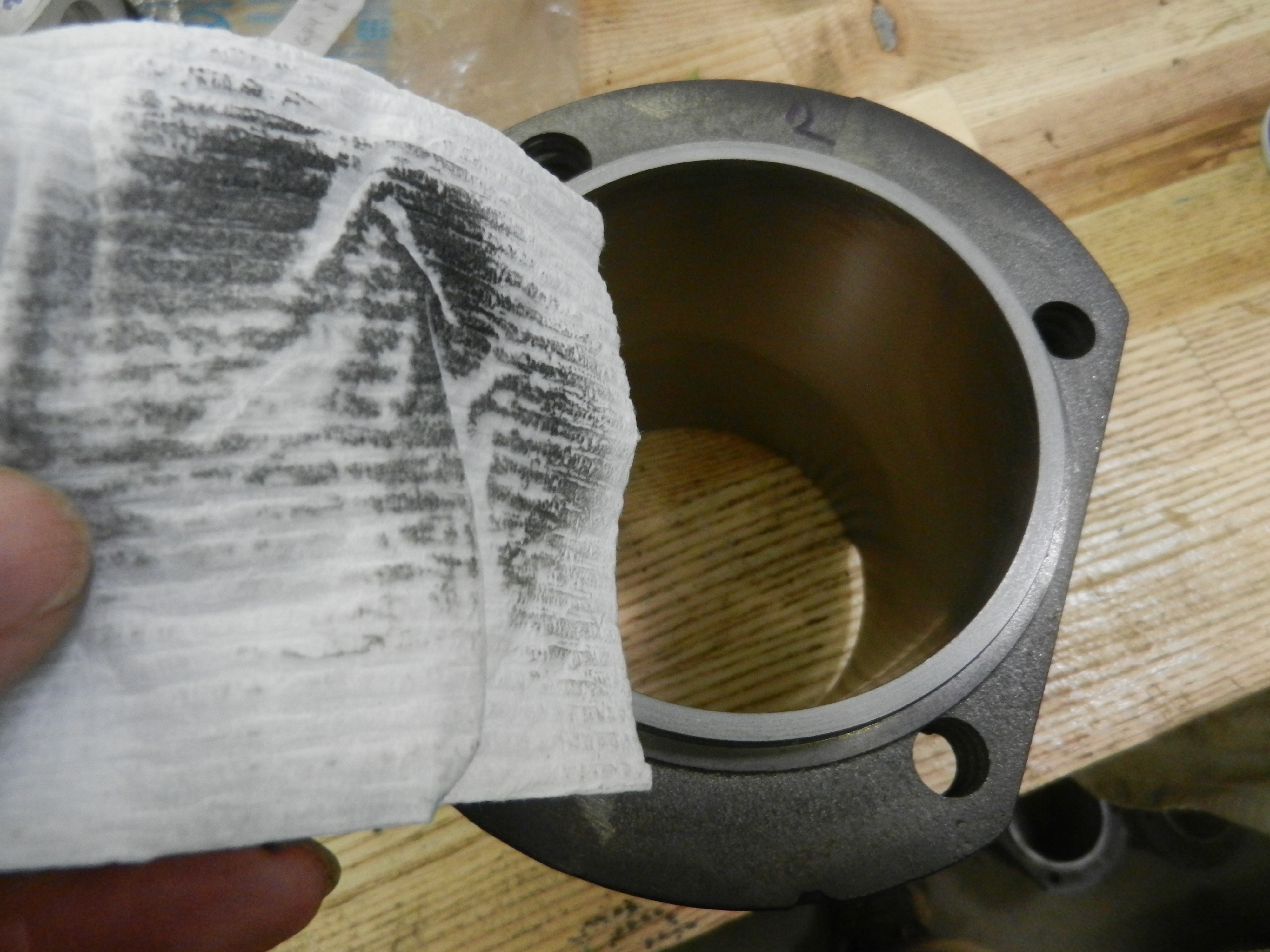

Wipe it well and wash both surfaces thoughoughly with brake clean.

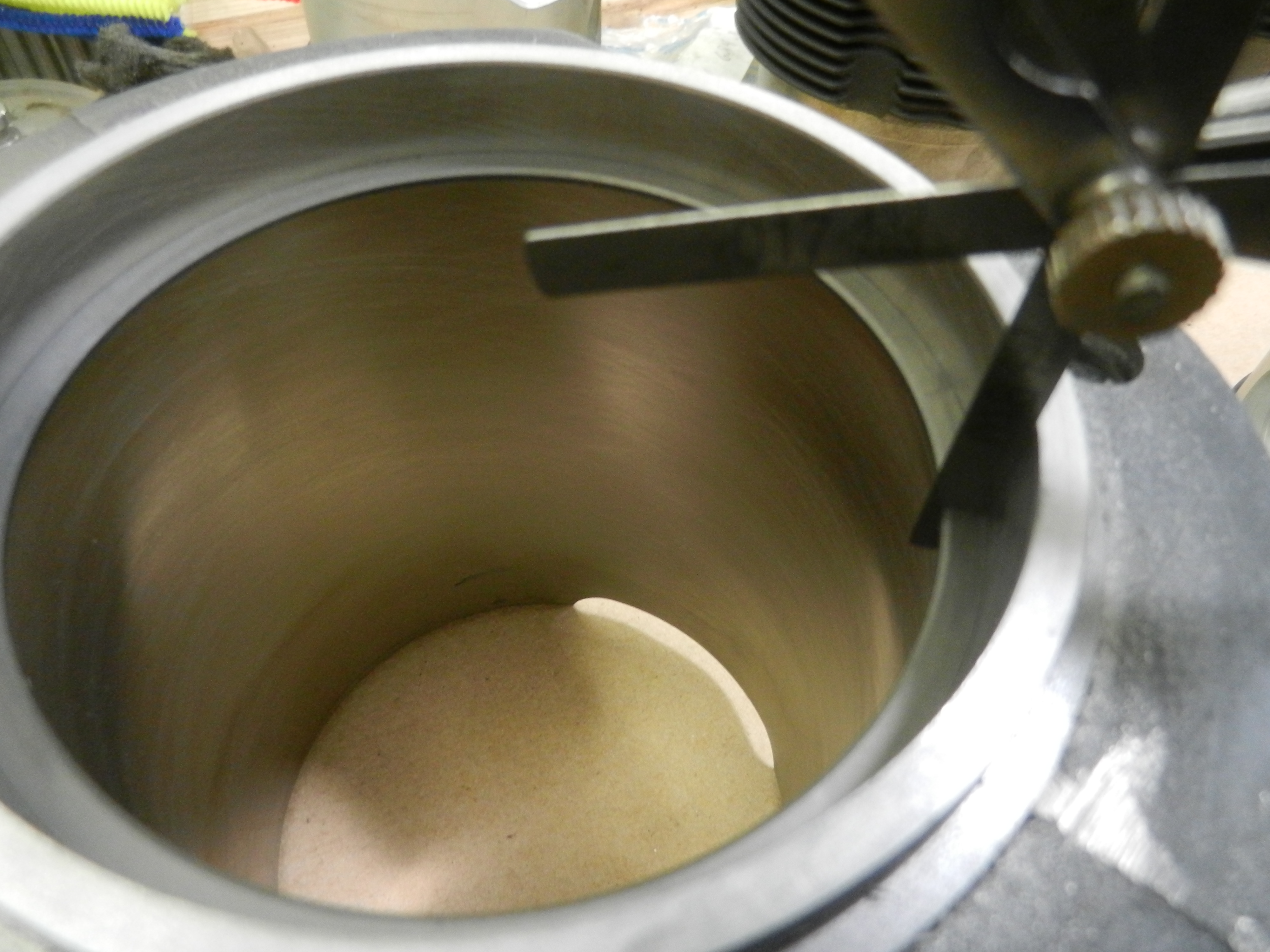

Also, wipe down the inside cylinder walls. I like to scrub them in a bucket with blue Dawn. then clean again with brake clean. This step is important as there is a thin film from the factory to prevent rust.
Next, we will remove the rings from the piston. I do the same cleaning with them as with the cylinders. It is best to do one piston at a time so you don't mix the top and middle ring. Then, wipe the rings with brake clean.

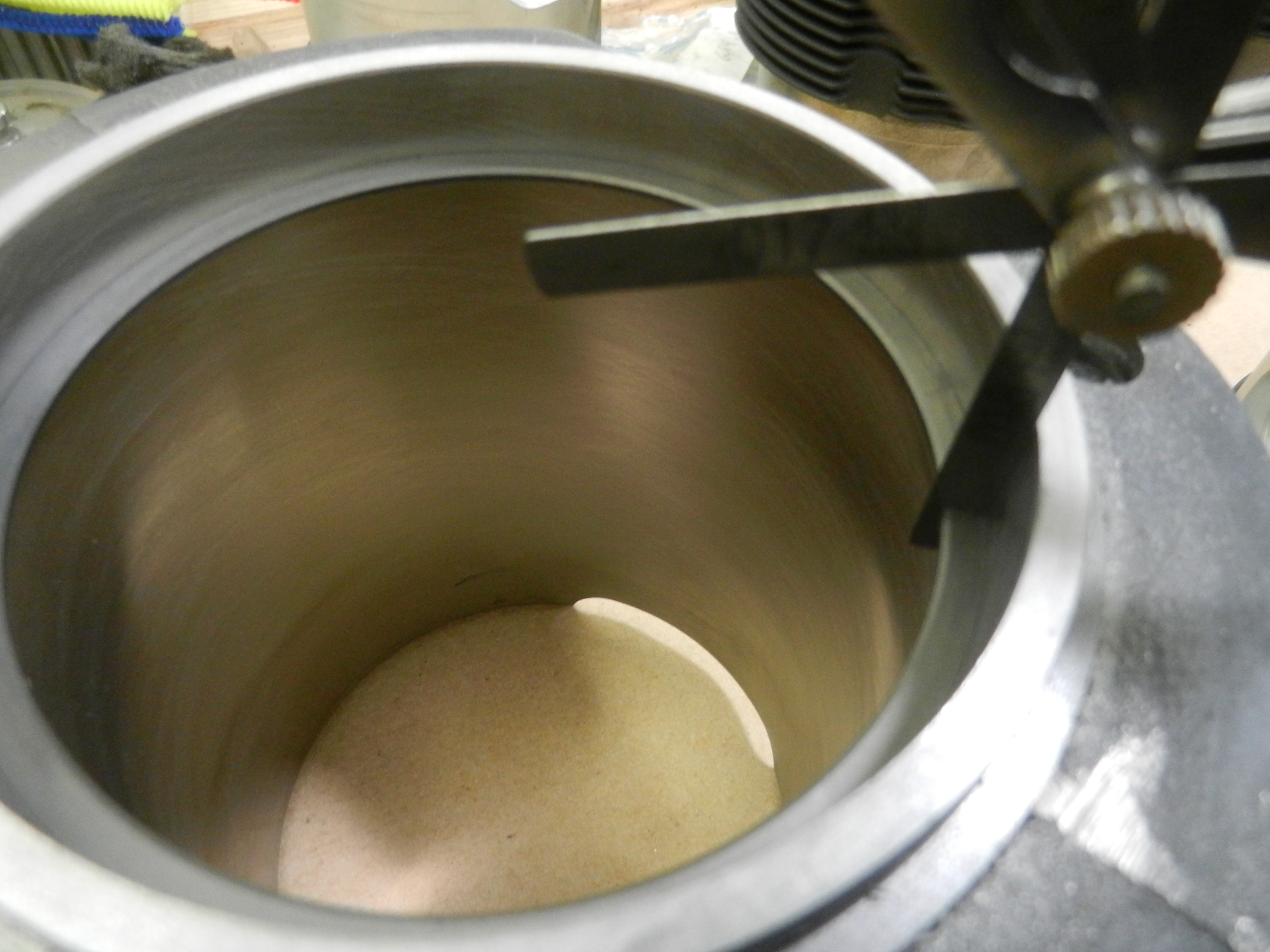

Since this set came with rings, there should be no need to to check some measurements. But, we are going to do it anyway. This MUST be done if you are re ringing a set of pistons.
Install the ring ( top or bottom) in the cylinder and square it with the piston.
Using a feeler gauge, measure the gap. Spec for the top ring is .014 -.022. We are .017

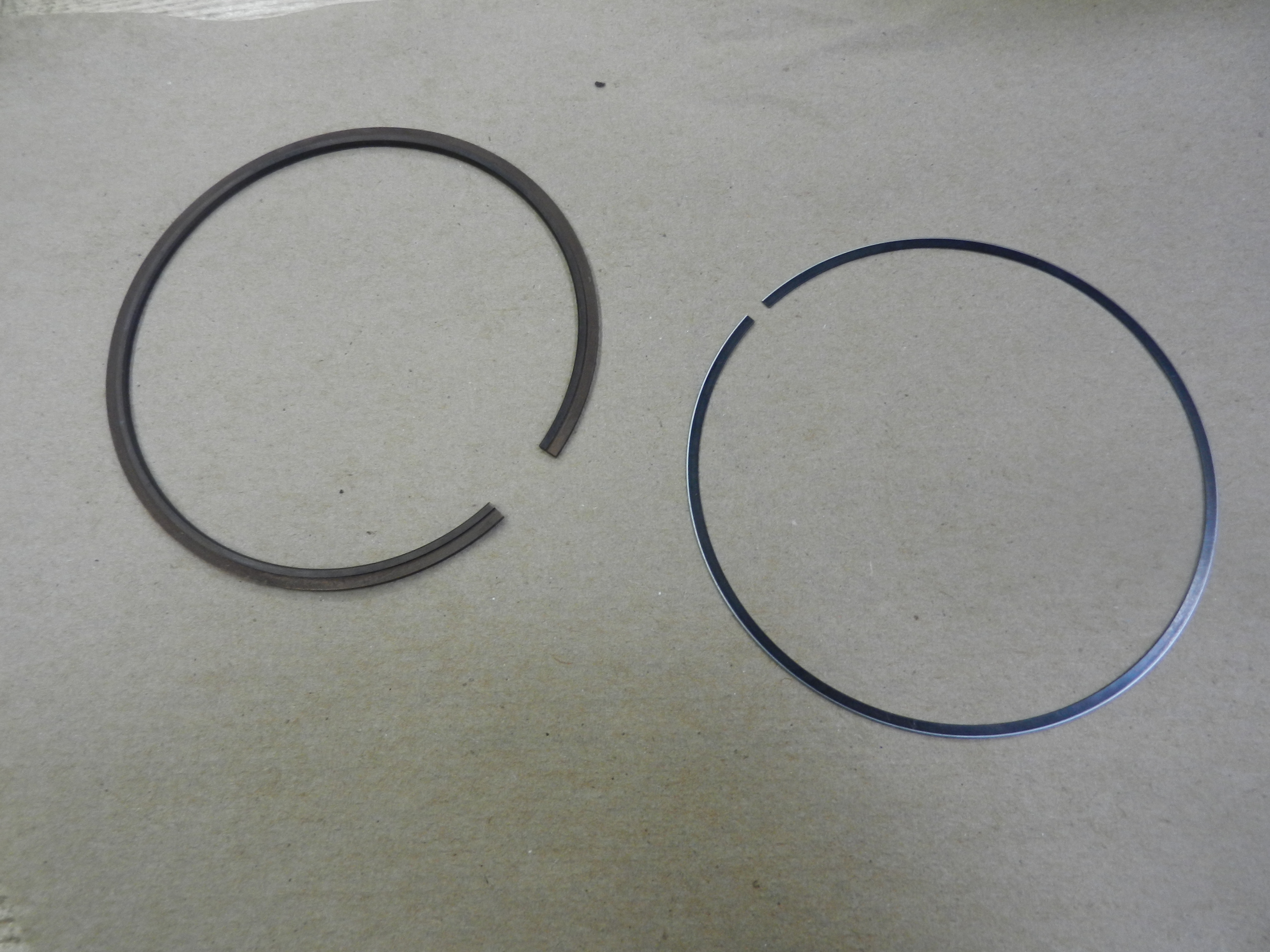

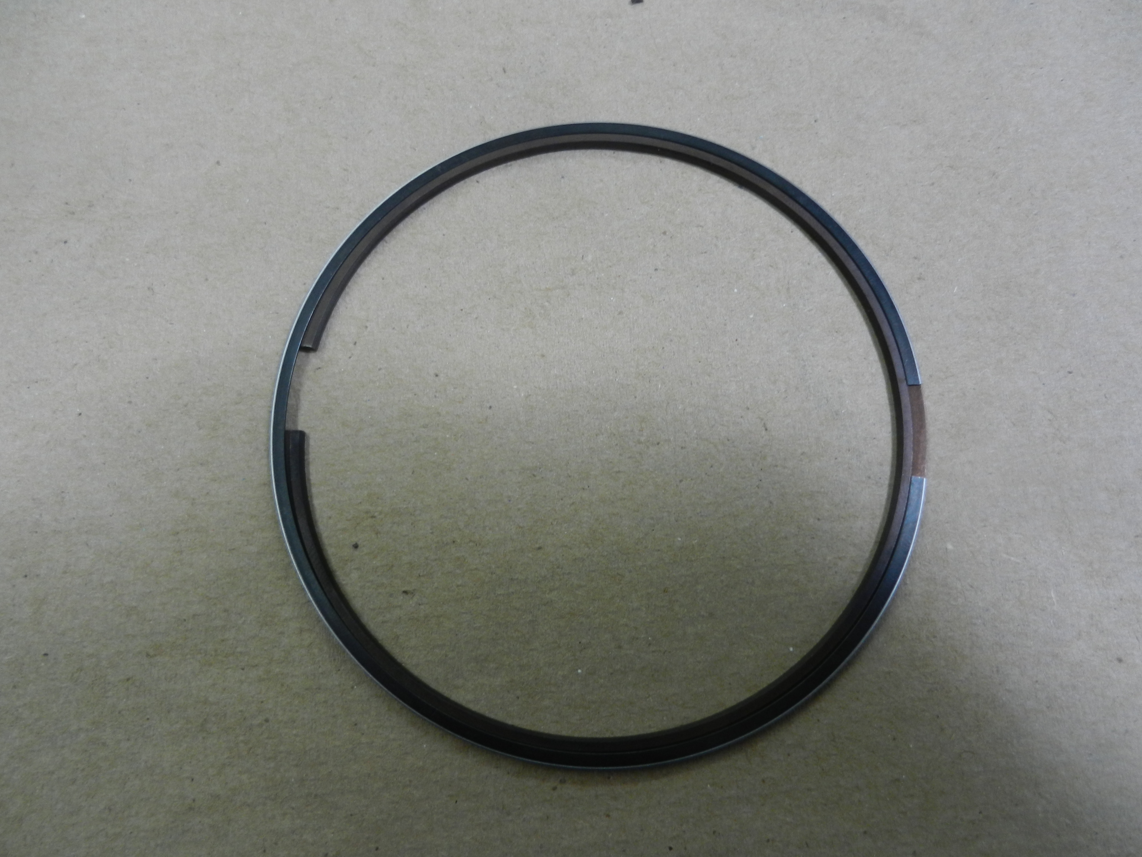

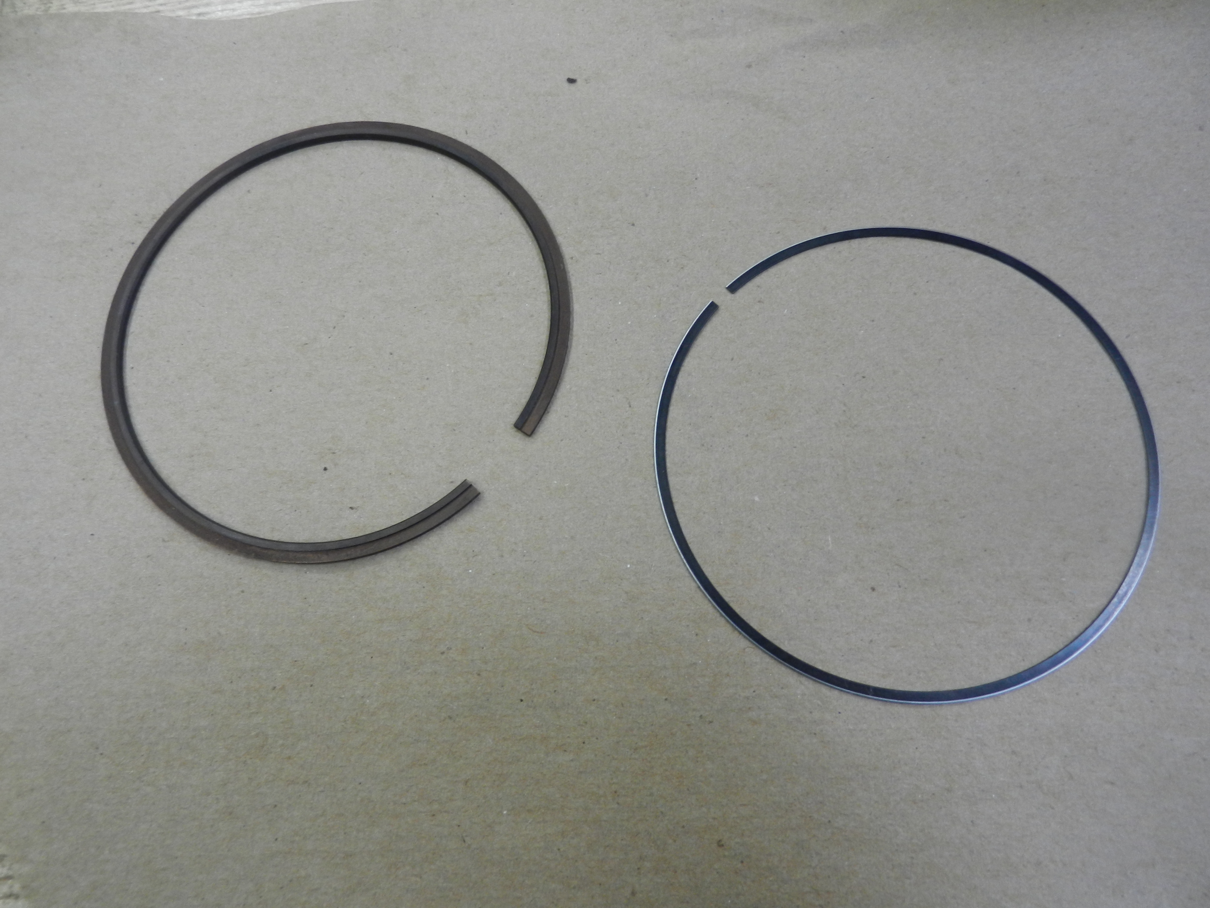

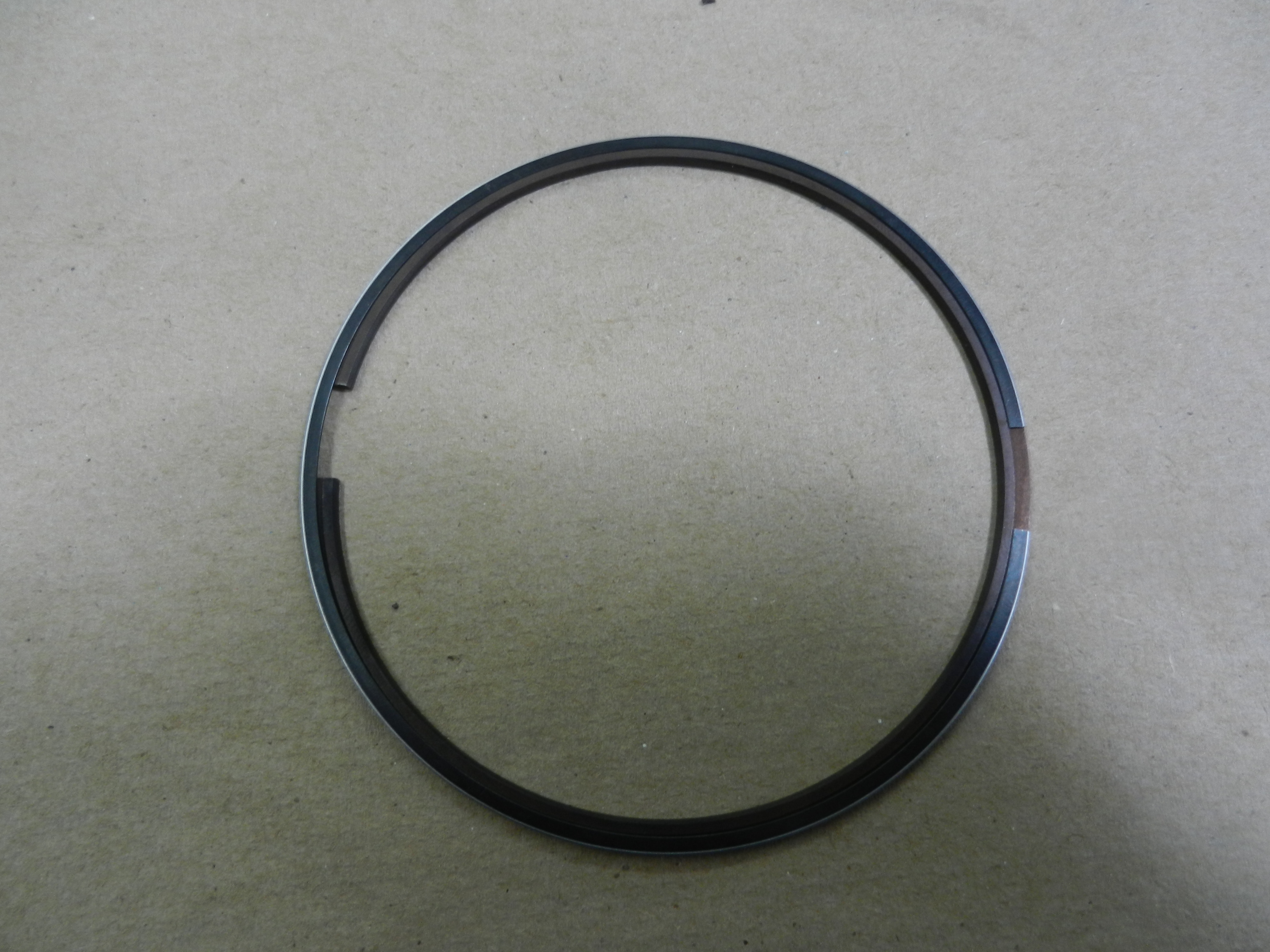

Do the same for the middle ring. spec is .012 - .022. I did not do this as I am using Total Seal gapless middle rings.
The Total Seal gapless middle ring Is a 2 piece ring with a machined ring and a rail ring.
When assembled, with the gaps at 180 degrees, they form a gapless ring.
A leakdown test will show the cylinder holding 99% using these rings.

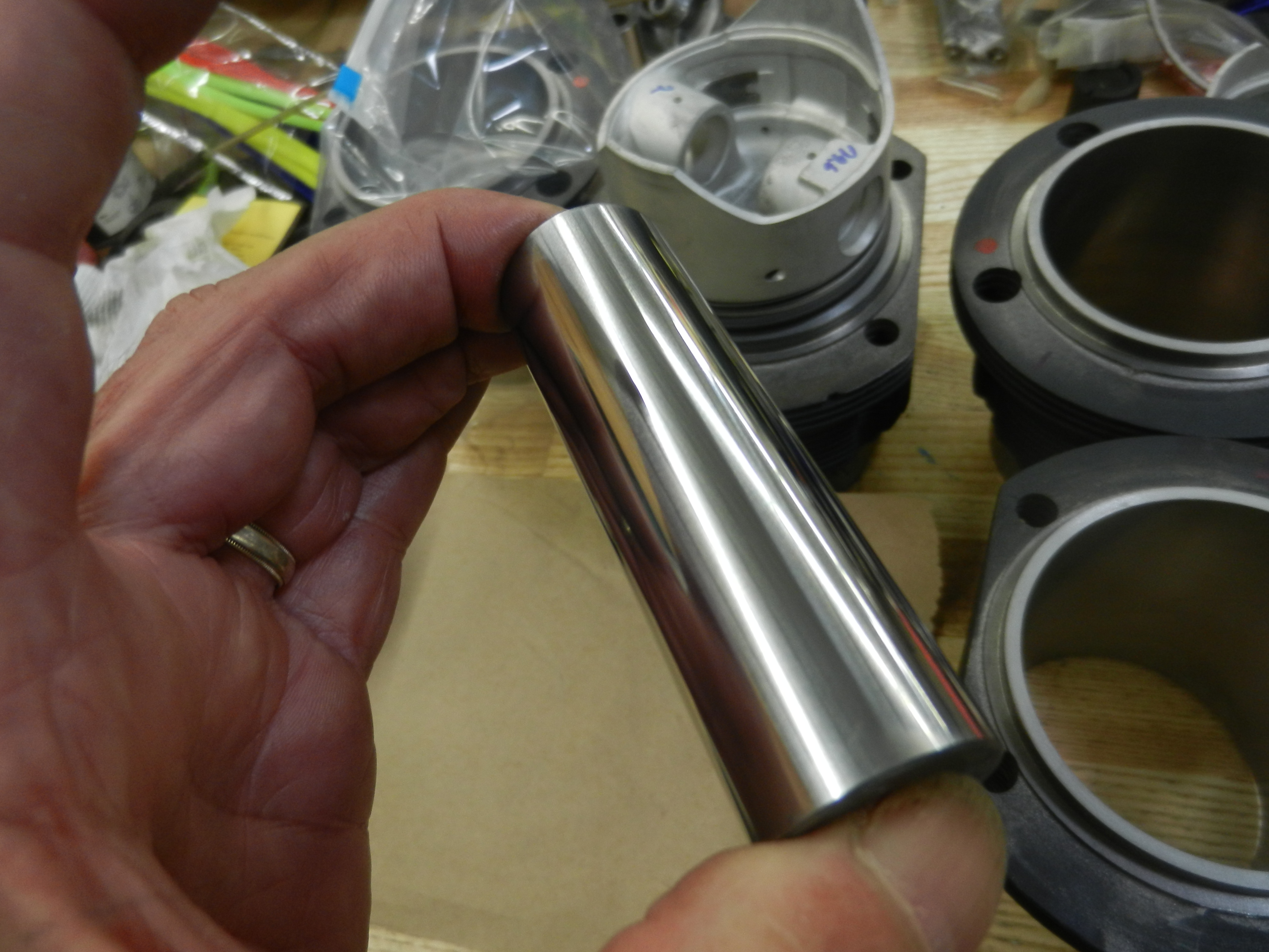

a couple of hints: like all the other parts, wash the piston pins with brake clean to remove any film. I like to polish them.

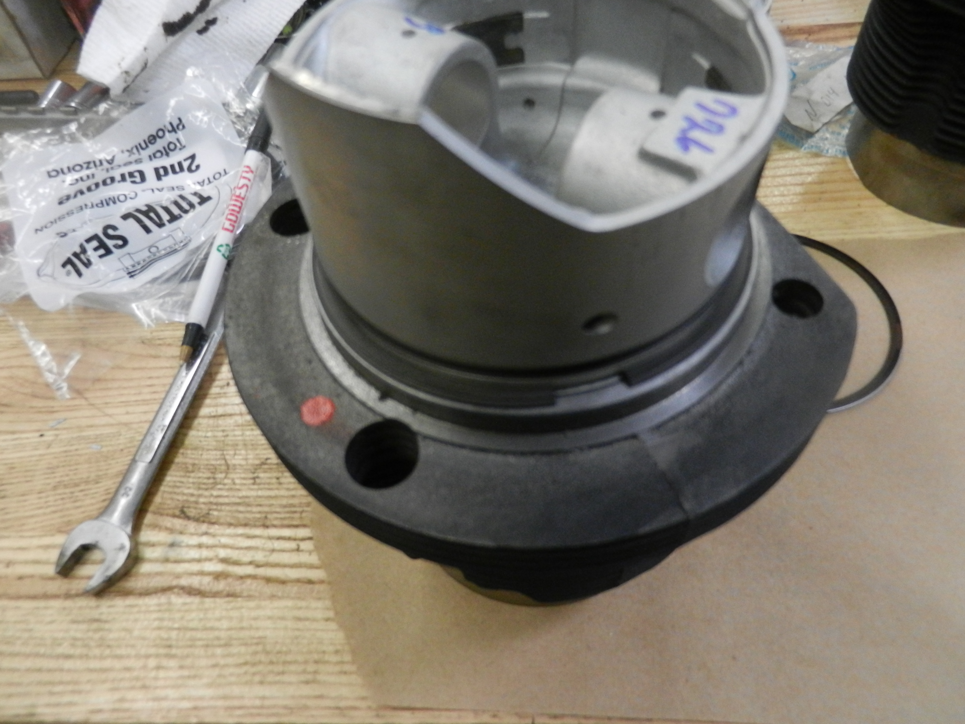

It's a good idea to number the pistons and cylinders 1-4. Before you assemble then you need to note their installation sequence for the type 4. arrow on the piston pointing toward the flywheel.
I usually do the #1&2 side first. install the circlip in the side of the piston on the flywheel side. The pin needs to install from the #2 side,as the flange on the flywheel side will not allow for the pin to install from that side.
For #2, install the clip on the #1 side and install the pin from the opposite side.

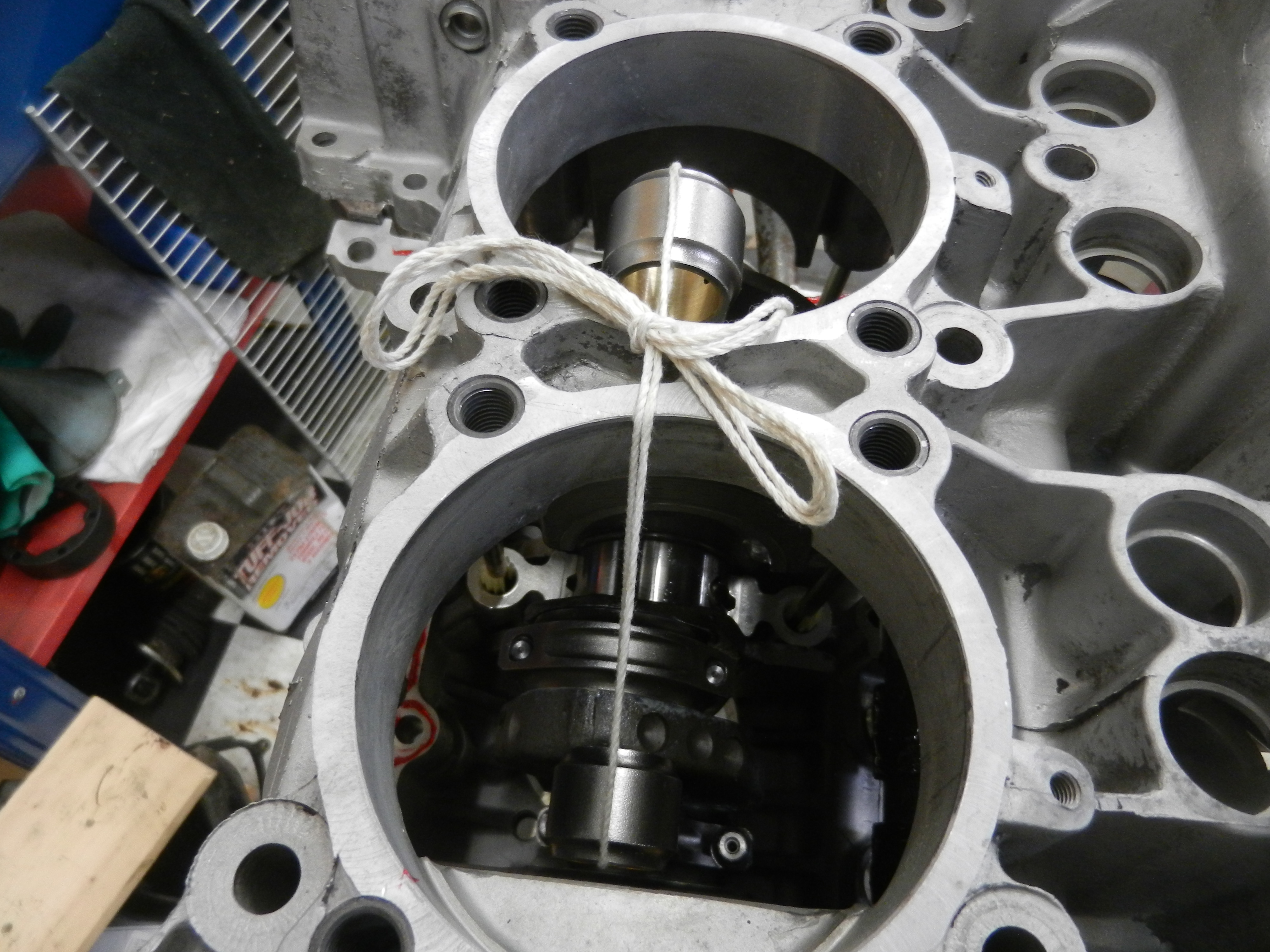

Stuff a rag in the cylinder hole so when you drop the second clip it won't fall into the case.
Here's the assembly ready to install on the rod. Some permatex at the cylinder base, then the shim, and another thin coat of permatex. Lube the pin with some assembly lube.

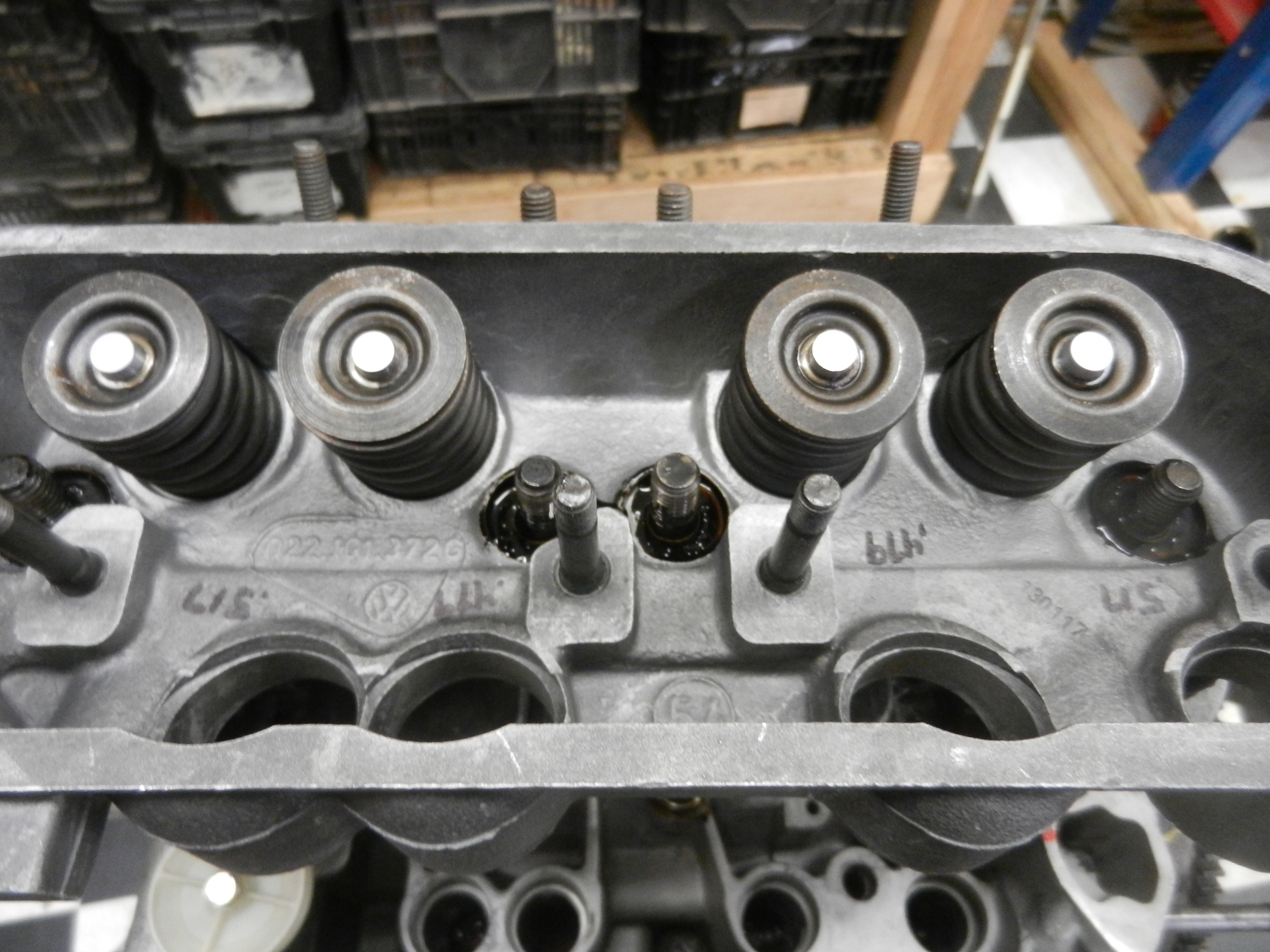

You can install the head on ea side as you get the piston cylinder assembly seated on the case. Follow the torque sequence in the manual. A little permatex on the head studs and washers.

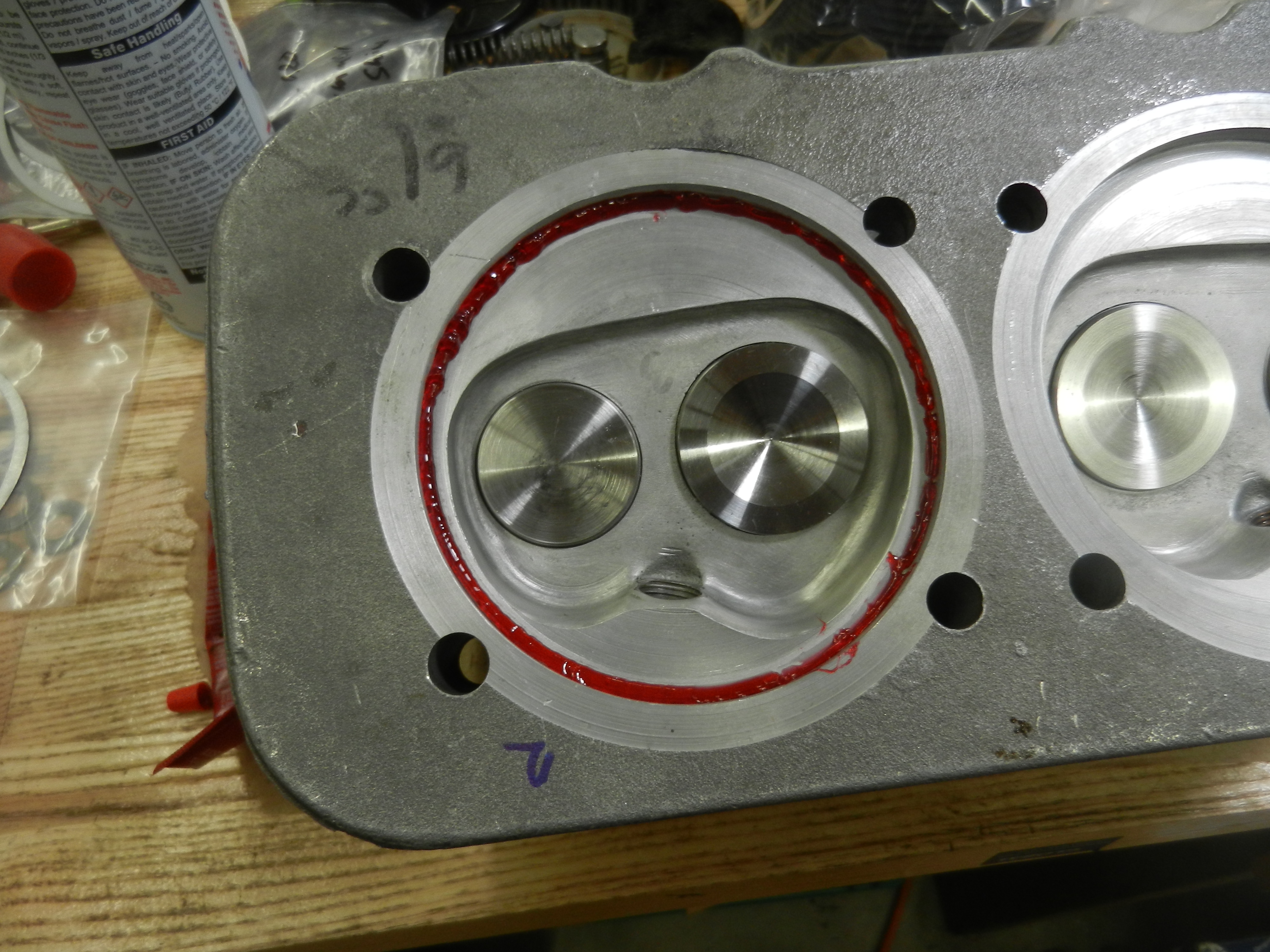

I run a small bead of Locktite 518 around the cyliner to head mating surface.
Re torque each head to spec.
Despite a good pic. ( I completed this build months ago and am trying to recreate for this thread) we now have a long block, less rocker and push rod assembly.

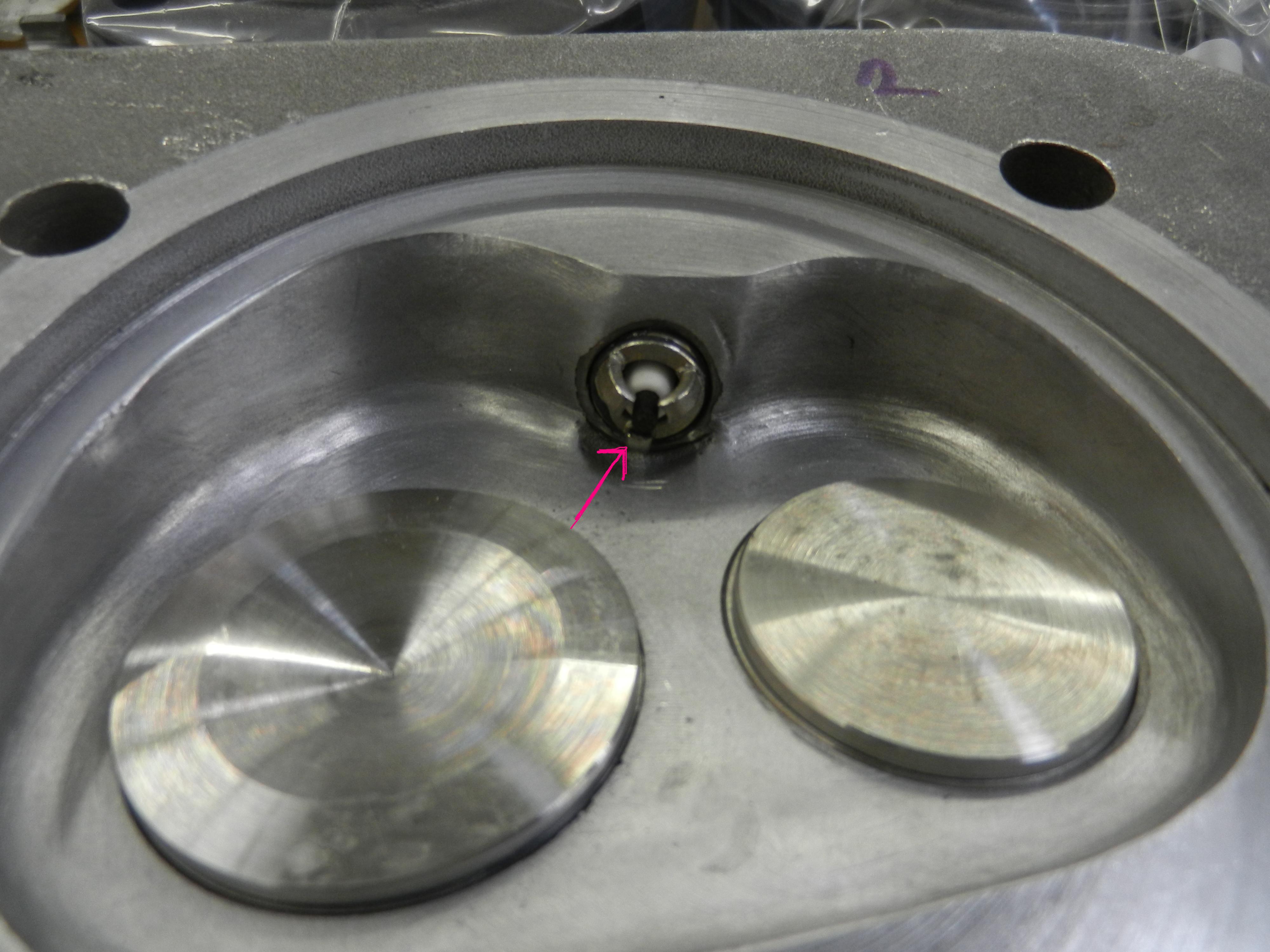

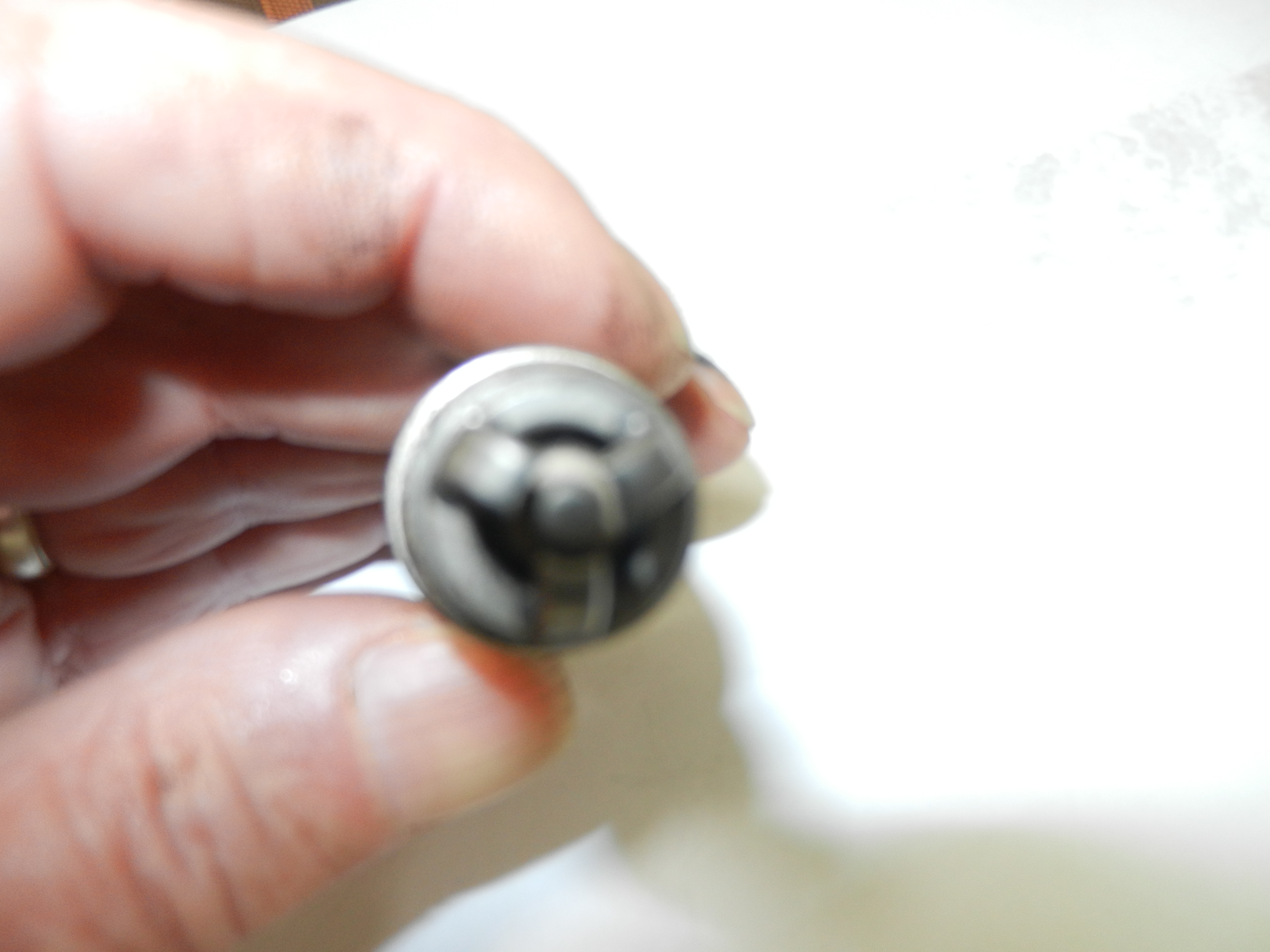

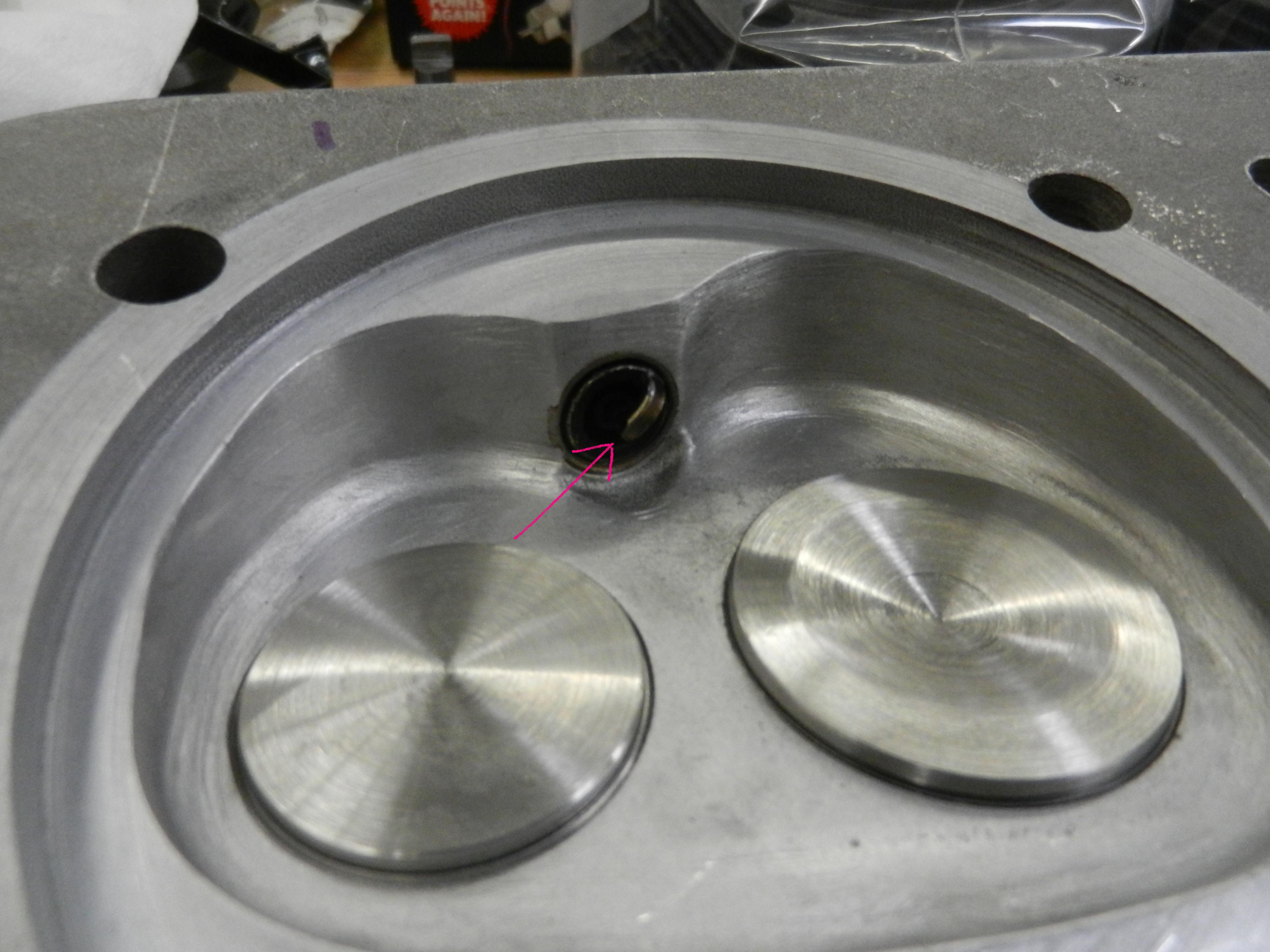

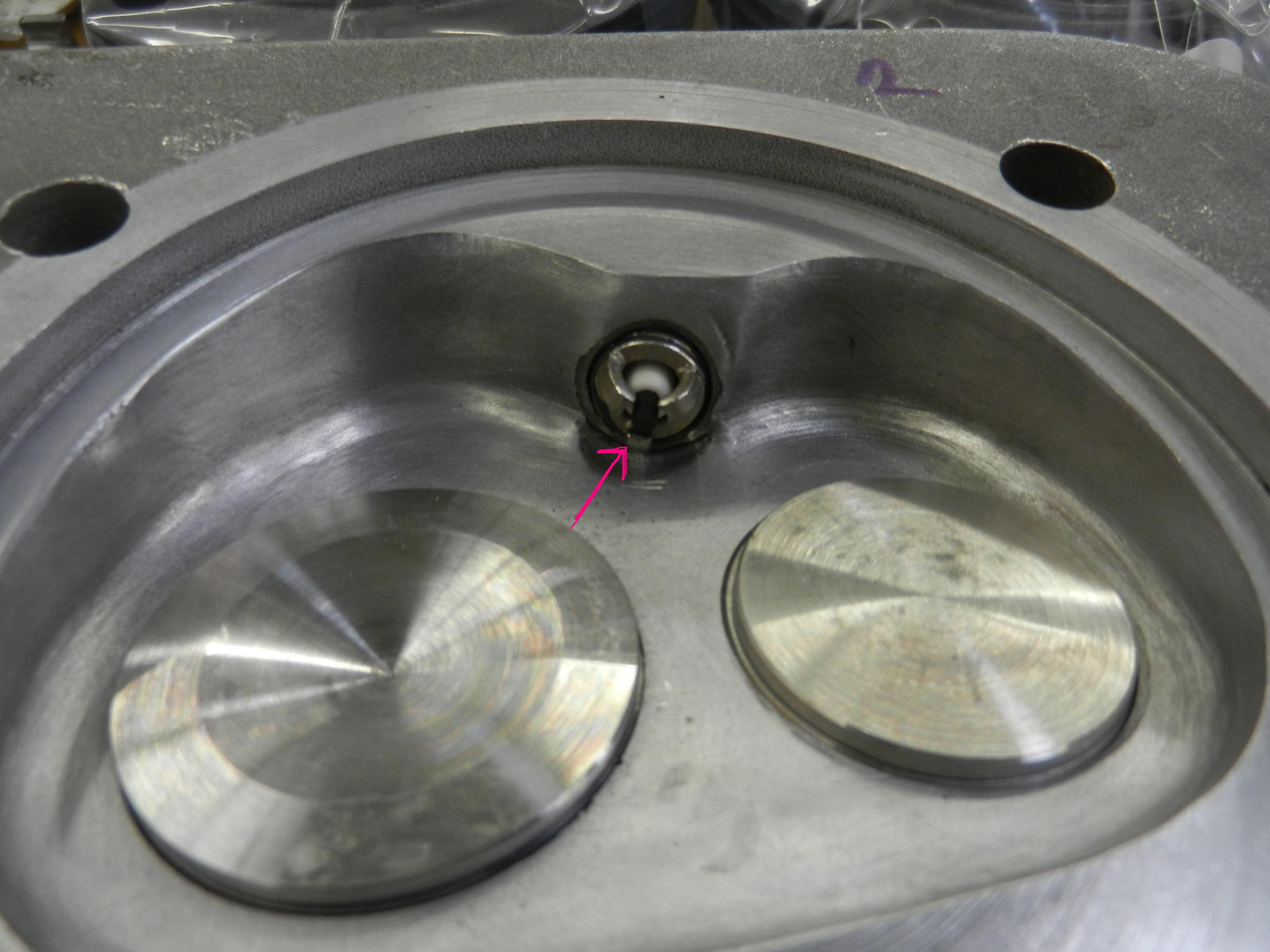

Just a note on the heads and spark plugs.
This is a standard spark plug. Notice the gap. It is directing the spark towards the side of the chamber.
An old racers trick was to shim the plug so that the gap was pointed towards the center of the chamber.
We don't need to do that.Bosch made a 3 electrode plug W8DTC, Which they stopped making. But Mick at Micks' 440 465 1985 can still get them. also available i step hotter W7dtc.
As you can see, this plug directs the spark towards the center of the chamber, which is what we want.
