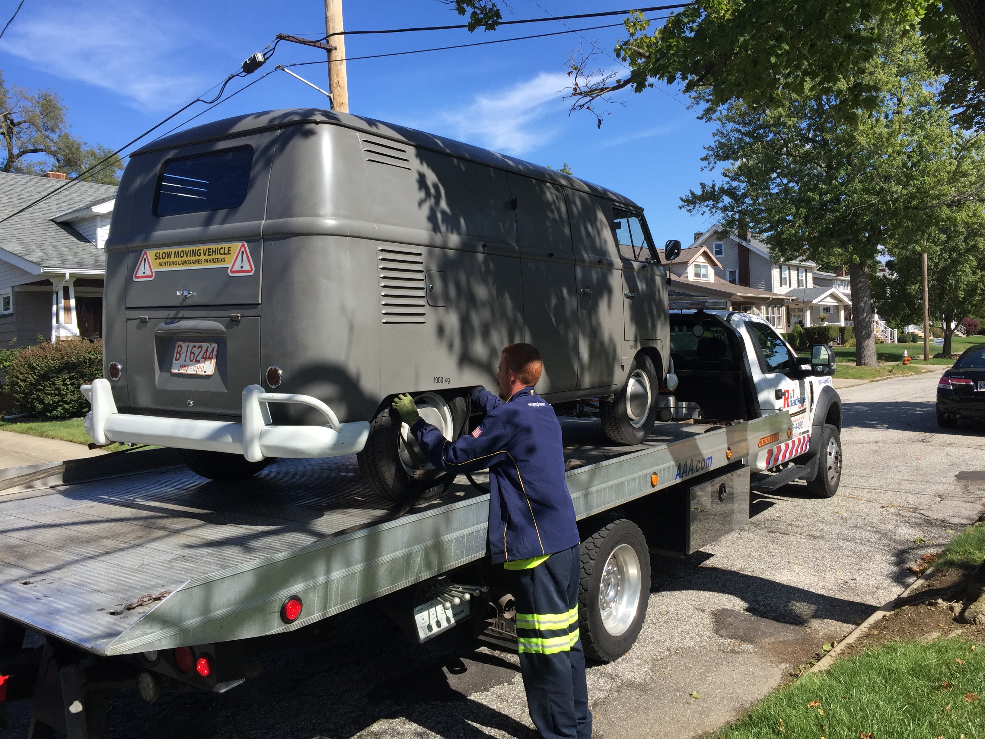

I've been logging plenty of miles on my bus even with the engine transplant on the horizon, so when I was asked to bring it to an impromtu parade up at Kamm's Corners I agreed. Ran fine, then suddenly didn't run fine. Was acting like it was fuel starved. You know, run a little bit then die then start and run and die just chugging haphazardly the whole time. So I checked the fuel and it was getting gas and of course there was air so I thought it had to be electrical. :shock: I mean, even I know that's all it can be! :lol:
So I had a spare coil because I don't really know how to check if a coil is good or bad. I mean, I know you hold the center wire from the coil with your bare fingers to some exposd gas in the engine compartment then have someone crank it over. :P Ok, so you dont do that, but I had a spare coil so swaped it in by the side of the road and no change.
So I debated on pulling the distributor but it was a pain where I was stopped and I decided to just get it home and figure it out. Luckily when I called AAA they had a company with a truck right by me. 10 minutes later I had it back in my driveway.

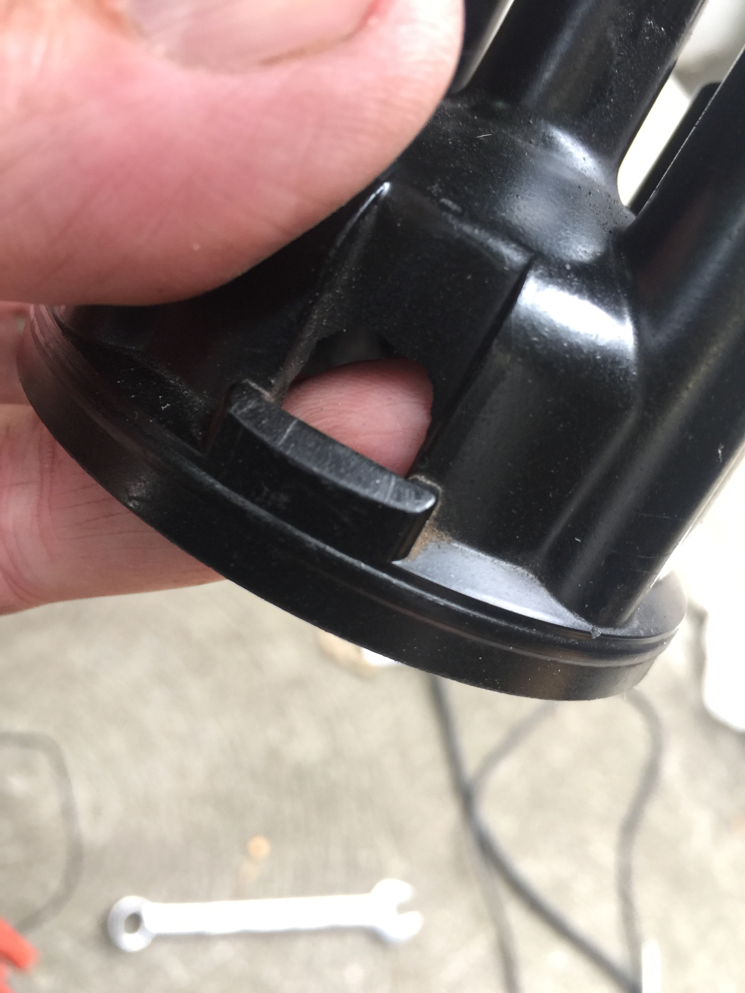

So I got the distributor out and walla! Once I got the cap off I saw what was likely my problem. A cracked cap that I couldn't see with the clips on.
I did swap out distributors and for the life of me I can't figure out what's up wih the distributor the PO put into this bus. Its the craziest thing. You get the bus to TDC on #1, but the rotor is pointing to where #3 is normally located. You put another distributor in and the rotor with that distributor is pointing to where #1 is or should be. I thought someone put the distributor drvie gear in 180 degrees off, but I'm wondering if the gear is right, but this one distributor I have is just out of whack somehow? Can someone rebuild a distributor backwards :?

Six Volt wrote: Mon Oct 05, 2020 8:52 am Can someone rebuild a distributor backwards :?
It's not that someone built it backwards, it's that on some distributors the pin hole at the bottom (where the drive is attached) is at 90* from where most distributors are. This puts the rotor 90* off from most distributors. If the rotor is 180* off, yes, maybe someone put the drive on backwards on the bottom of the shaft.
All you need to do is move the plug wires one spot on the cap, but careful, it's easy to F that up. ;)

Yes, I moved the wires 1. 4. 3. 2 because I've had that gremlin in my inglorious past! :oops:
When I initially put the replacement distributor in (without touching the motor from the TDC spot with the rotor pointed at #3 the way it was on the original distributor) It would not fully seat. It would only seat when I swung the rotor around to #1 spot then it dropped in. And the test light stayed on continuously when i moved the seated drisributor side to side at the #1 spot. Points had the proper gap, but wires were still in the former location at that point.
I'll re-check where exactly TDC is on the motor. I'll pull a valve cover and watch the intake and exhaust on #1 and make sure neither are moving when I rock the motor with the generator nut. I'll also try more than one distributor to ascertain if I'm getting a different TDC indication with rotors based on that original distributor. I'll report back.

Anyway, I swapped distributors out because when the cap cracked it sent shards of plastic into the vacuum only distributor body gumming up the innards. Not pretty. So I was going to use one of my 36HP cast iron distributors I have, but there was a scary noise coming from the engine so I just popped on a 009 to get it running.
