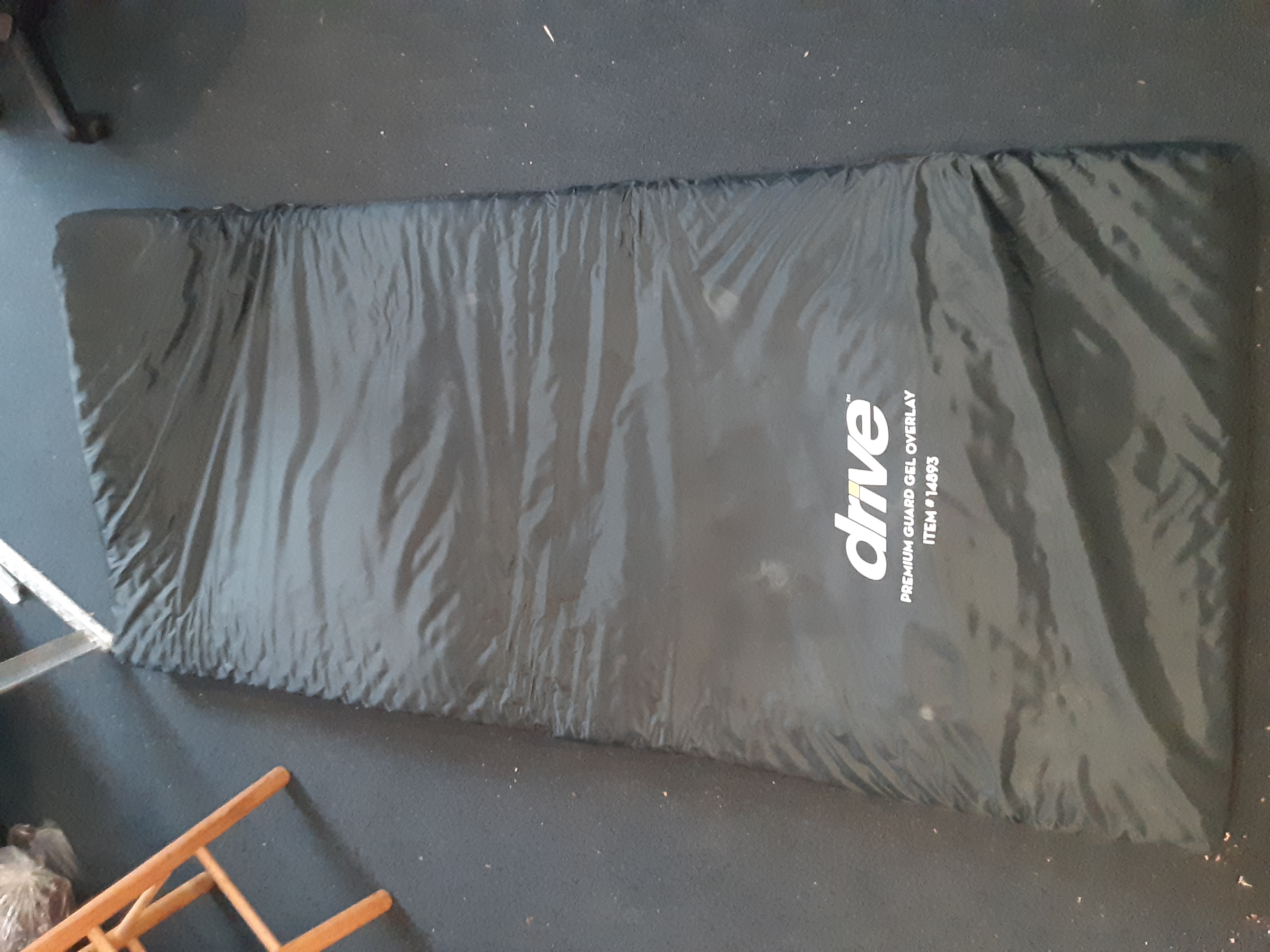

I use a hospital bed mattress pad that's part gel and part regular foam. They're $100-150 online, I bought it at a garage sale for $10. It's only about 3-4" thick but very comfortable, even after 7 straight nights on the last big trip.

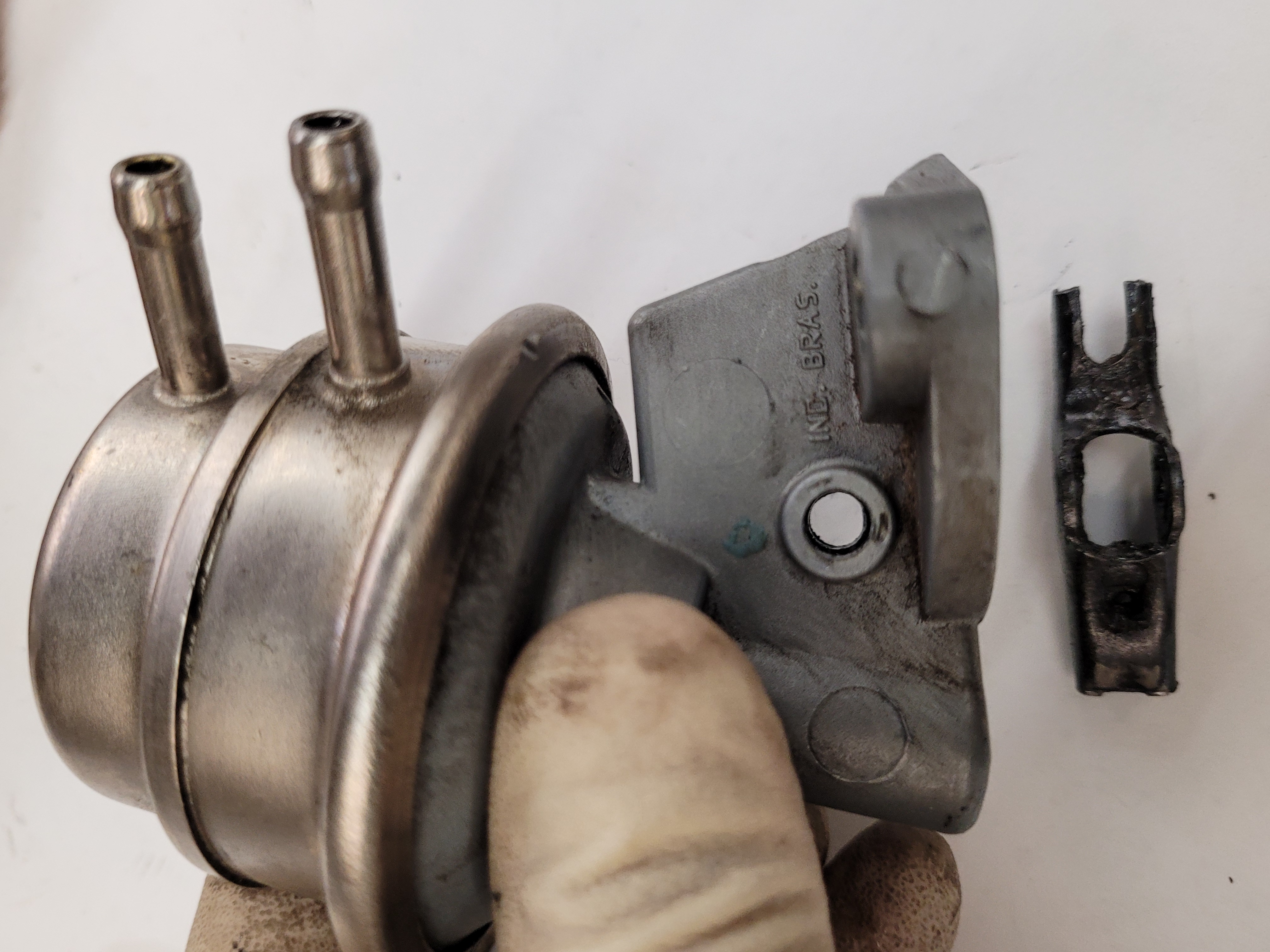

One problem on the Qwesty trip- the fuel pump pivot pin fell out on the way home. Not a big problem, it took about 20 minutes to diagnose and repair it since I had a pump and tools with me. Oddly enough this is the THIRD time on three different vehicles this has happened in the last 10 years! Once I returned home I put a bolt in it (with a dab of weld) and reinstalled it.

Dual Port wrote: Wed Aug 31, 2022 10:09 am One problem on the Qwesty trip- the fuel pump pivot pin fell out on the way home. Not a big problem, it took about 20 minutes to diagnose and repair it since I had a pump and tools with me. Oddly enough this is the THIRD time on three different vehicles this has happened in the last 10 years! Once I returned home I put a bolt in it (with a dab of weld) and reinstalled it.
I by chance bought one of these when I was having issues with the OE pump on the truck. Comes with e-clips on the pivot pin. They claim testing up to E85 on their components.
https://ecat.spectrapremium.com/en/part ... plications
