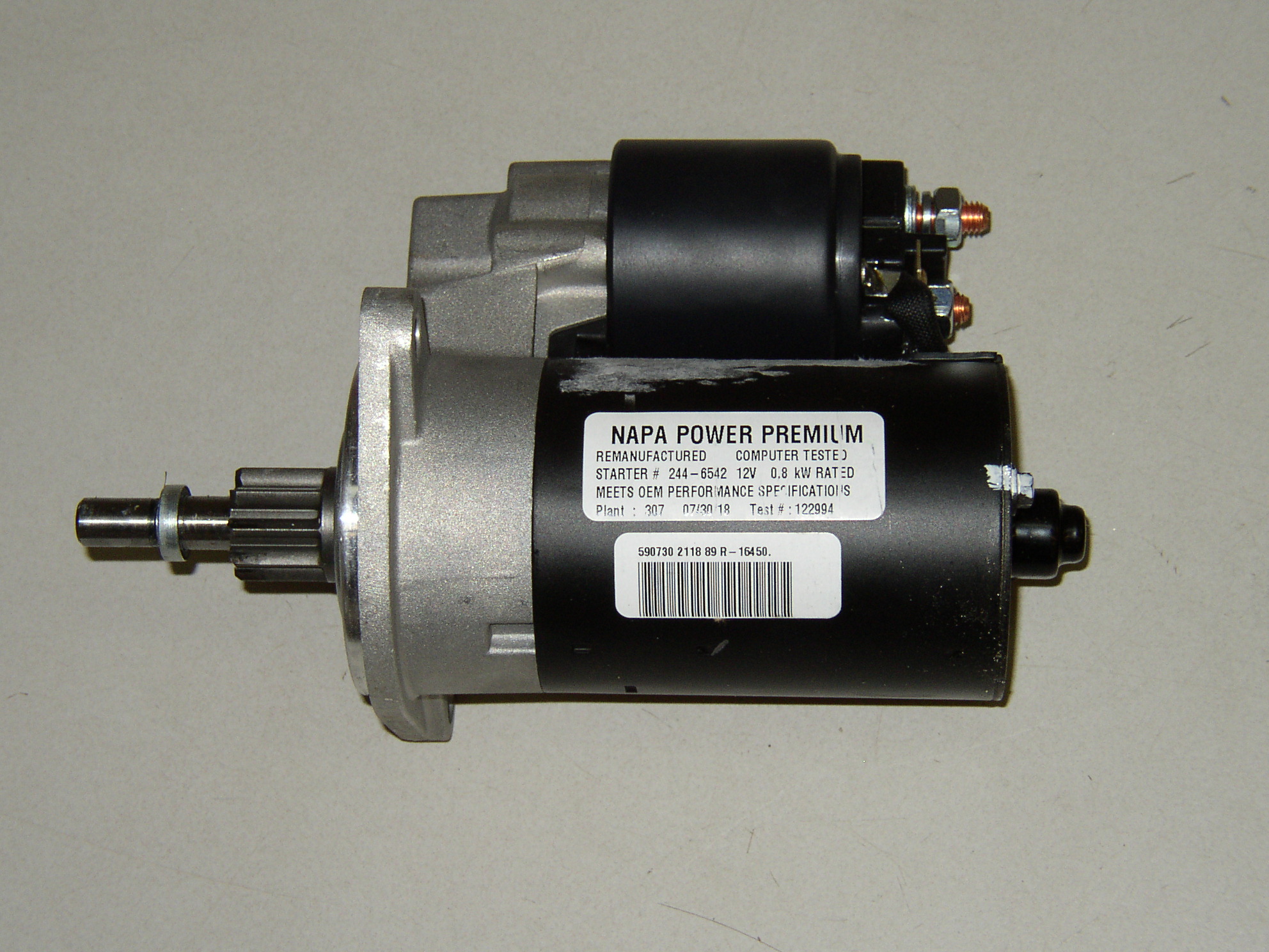

The starter stuck "on" even with the trigger wire unhooked so it got a new Napa permanent magnet (small, light) starter which was only $44 with a life warranty. I figured that was a good deal so I bought one for the shelf, too. Pics are in the camera at the shop right now but I did clean the flange well. :mrgreen:

Great work! And that’s good info about the NAPA starter.
Here's the Napa starter, PN 244-6542. The Carrollton warehouse showed 3, I bought 2. It's a PM so it doesn't sound like the big old Bosch, but I don't care. Small, light, fast, and cheap is all I want. And life warranty, if you fill out the card it comes with they'll even pay the tow. Dated 7/30/18, it's not even stale from sitting on the shelf! :D Should fit all 12v apps like bugs and busses with upright engines.

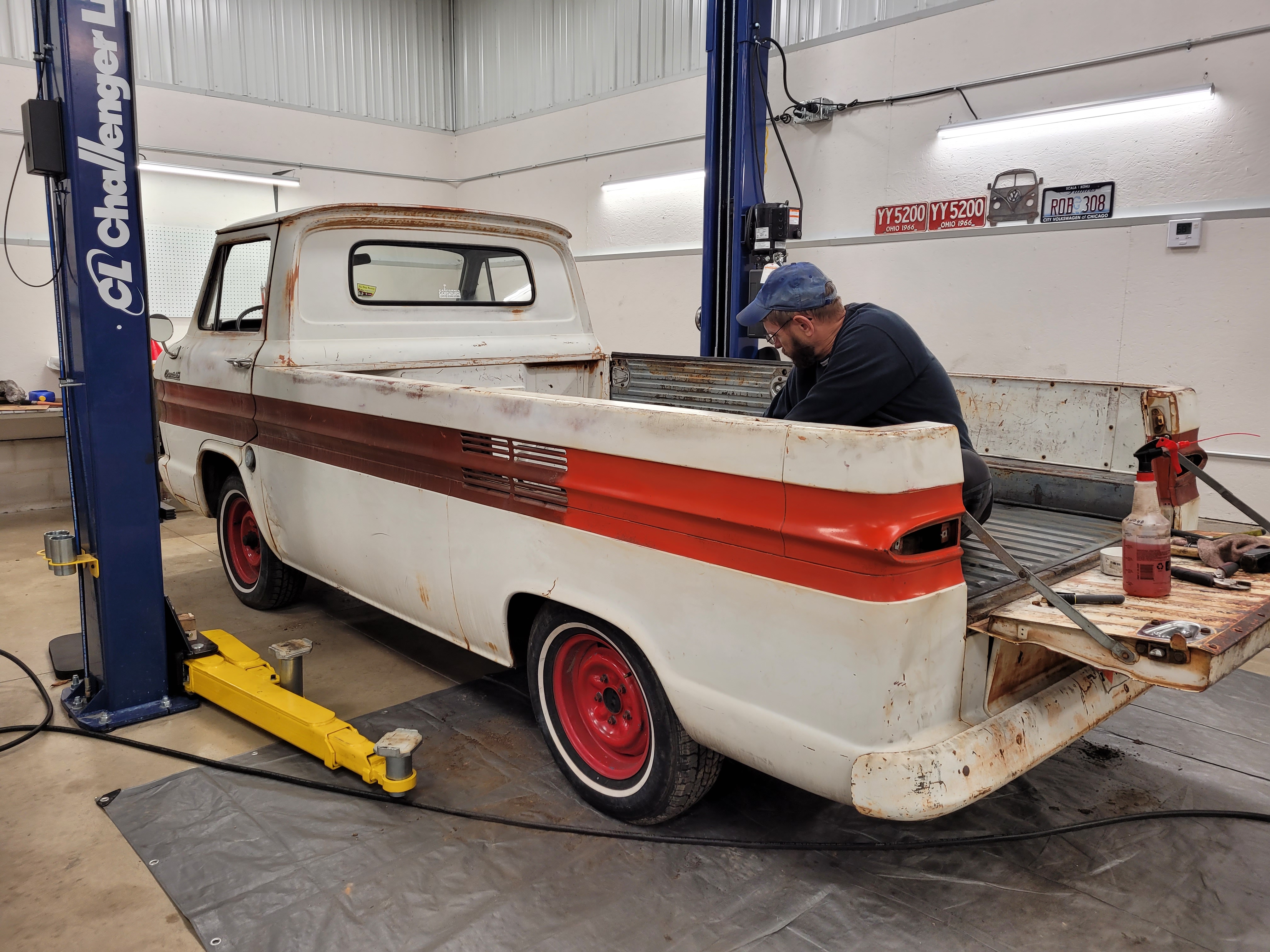

He bought a Corvair Rampside lately, not a VW but still a very cool truck. Desert dry, not a spot of rot anywhere. We've done a lot of work on it lately, too.
Looks like a lot of fun. Very nice Corvair!
