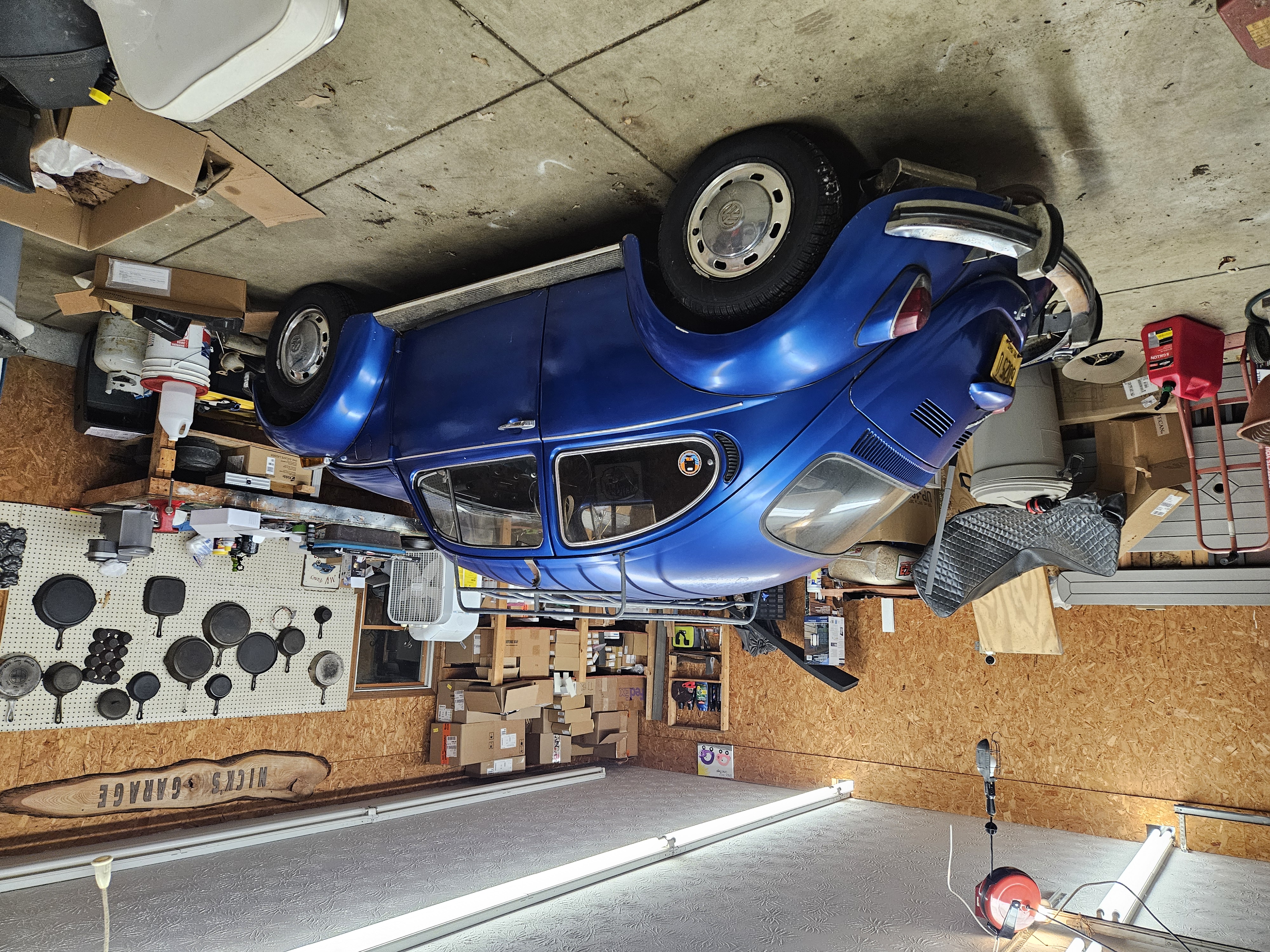

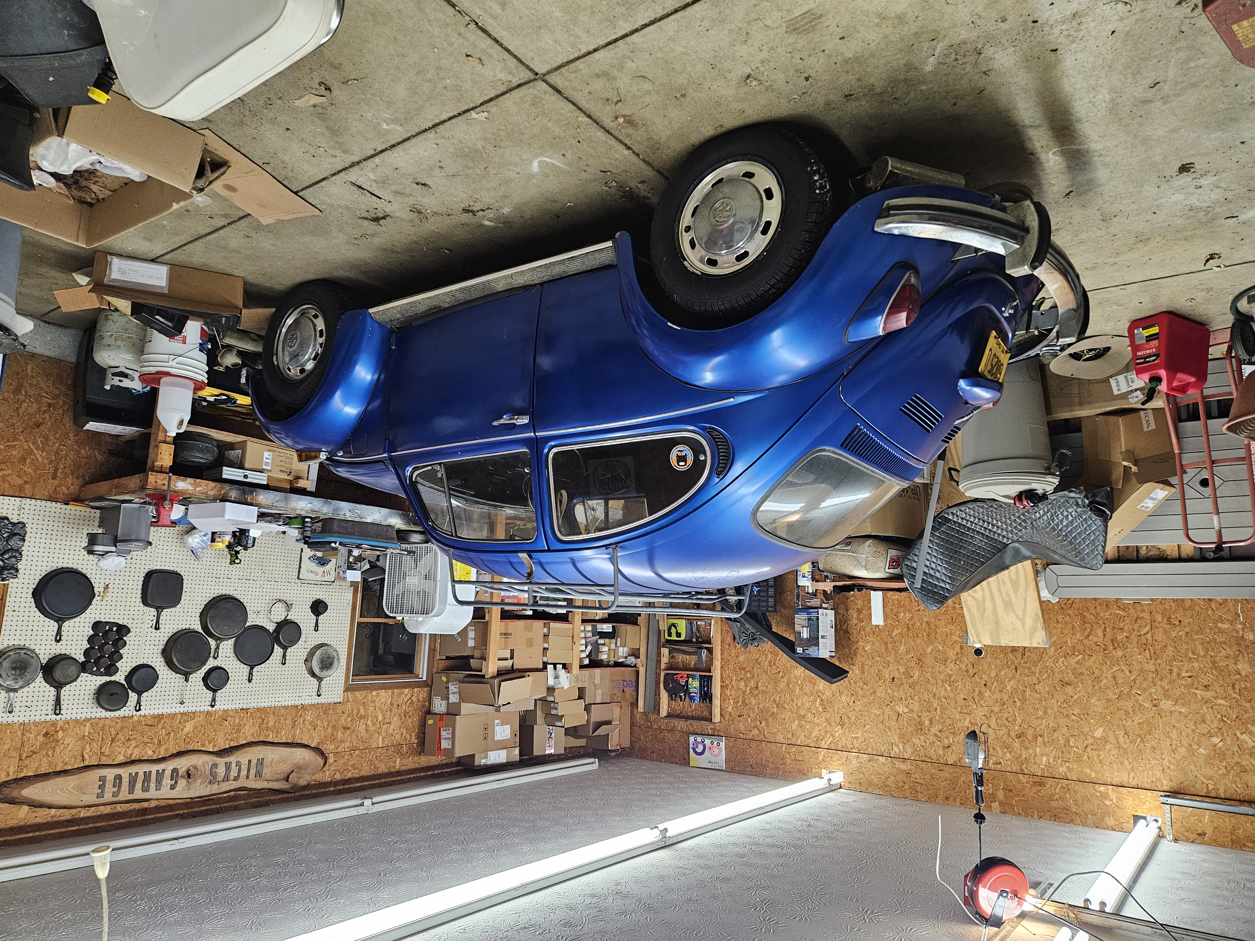

Hans is at my new house and now partially torn apart to redo the interior after some floor pan patches. Getting new TMI seat covers on is a PITA. Bill had the patience of a saint.
