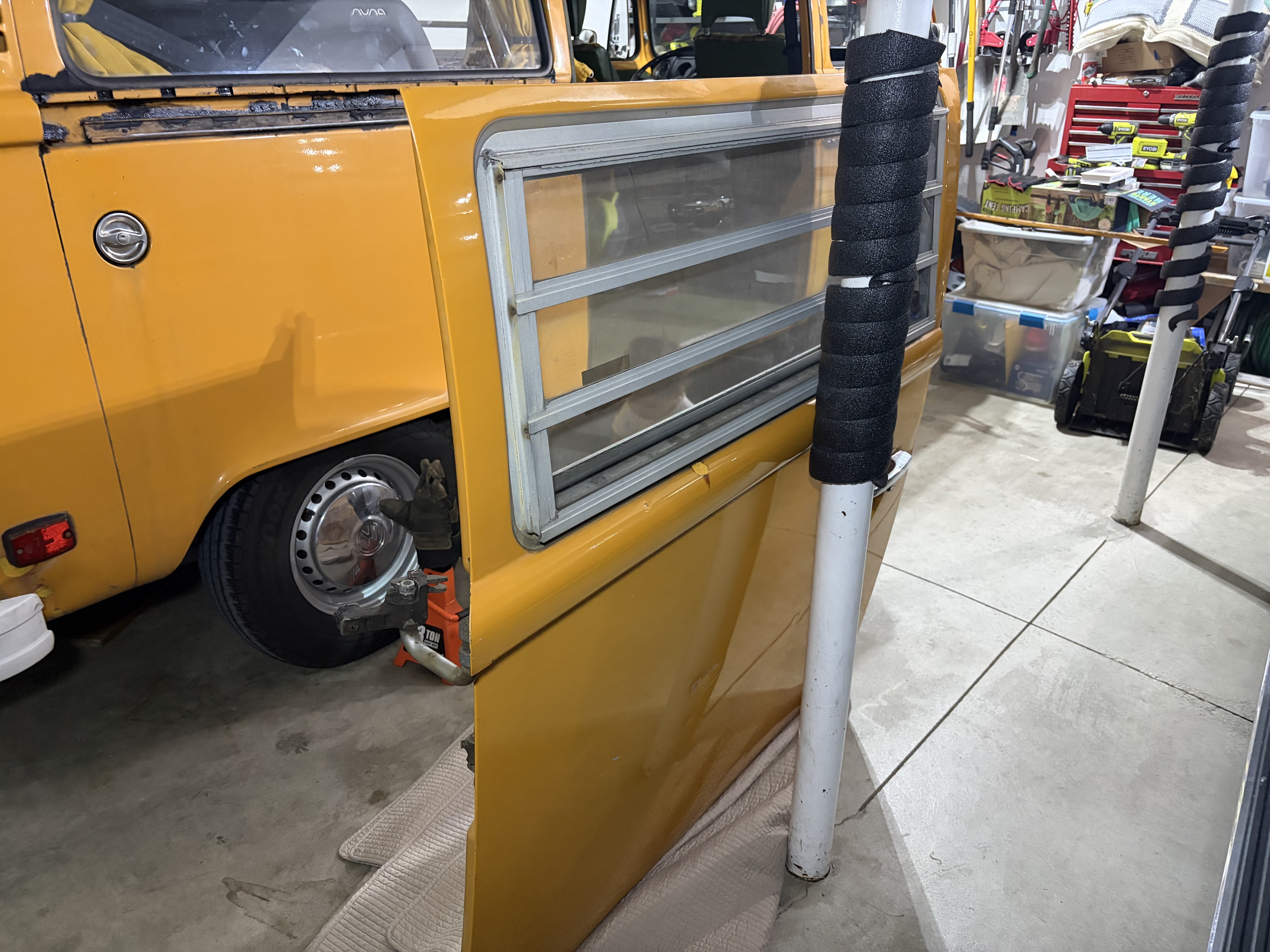

:twisted: Sliding door has needed attention for a while. Pulled the door and inspected everything. It took a few hours to clean up the old icky grease in the track rails. As well as clearing away the old glue from the door seal. There was some surface rust hiding in a few places under the seal and rail track. As well as Rust converter paint touch ups from the PO. I cleaned a lot with a wire wheel and applied POR-15 rust converter and paint. Then spent some time cleaning and servicing all of the mechanical parts of the door. Re assembly on the next post.
Posts: 681
Re: Pumpkin the 1977 Westy

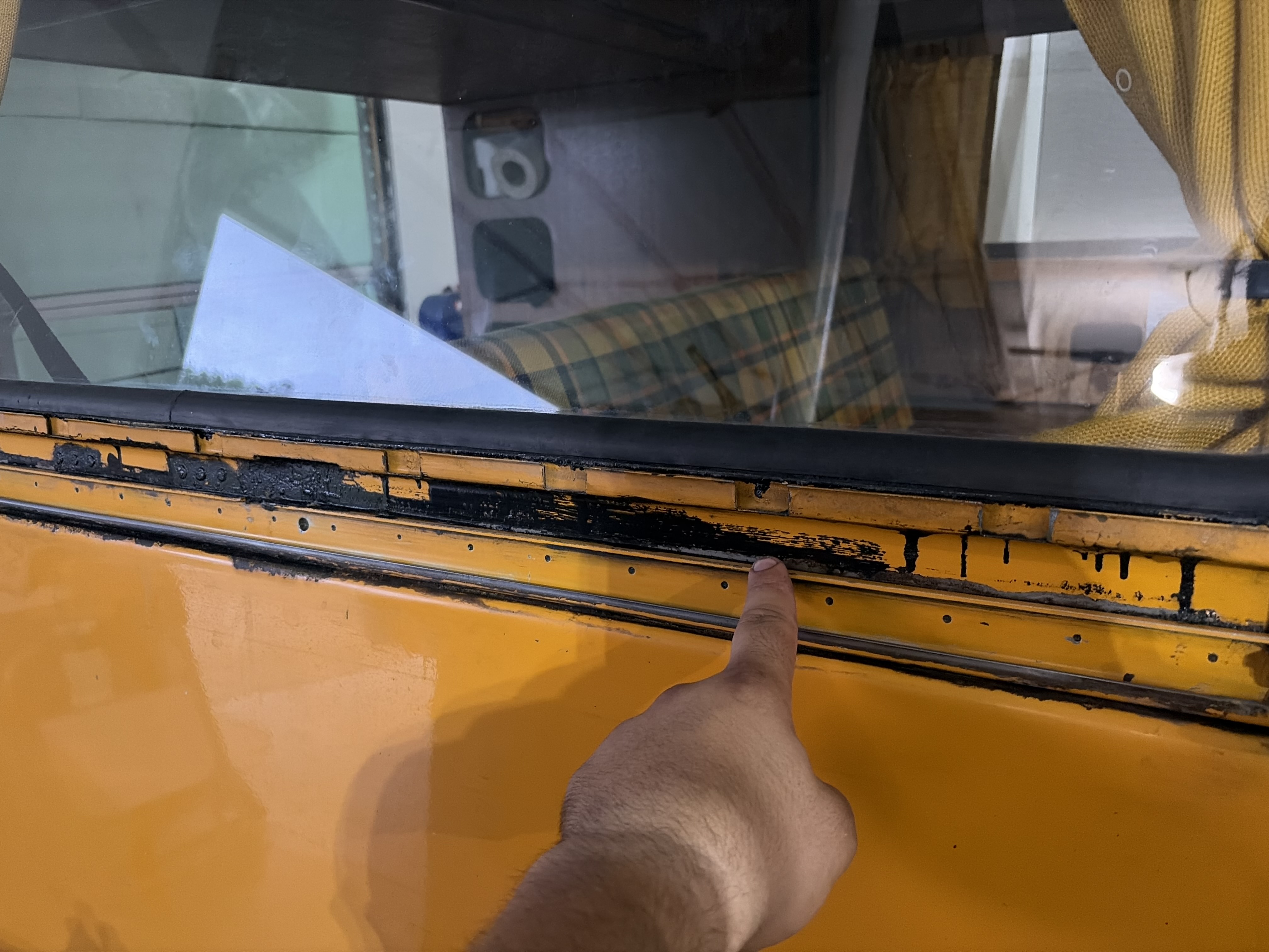

During my sliding door refurb and door seal replacement. There was crusty surface rust especially underneath the door seal. Wire wheeled, treated, and POR-15 coated the bad spots. I also POR-15 the sliding door track. Which ended up being not the greatest move. The paint is a little soft and not the best for a roller bearing moving across it. May need to readdress later. But door is on and works.

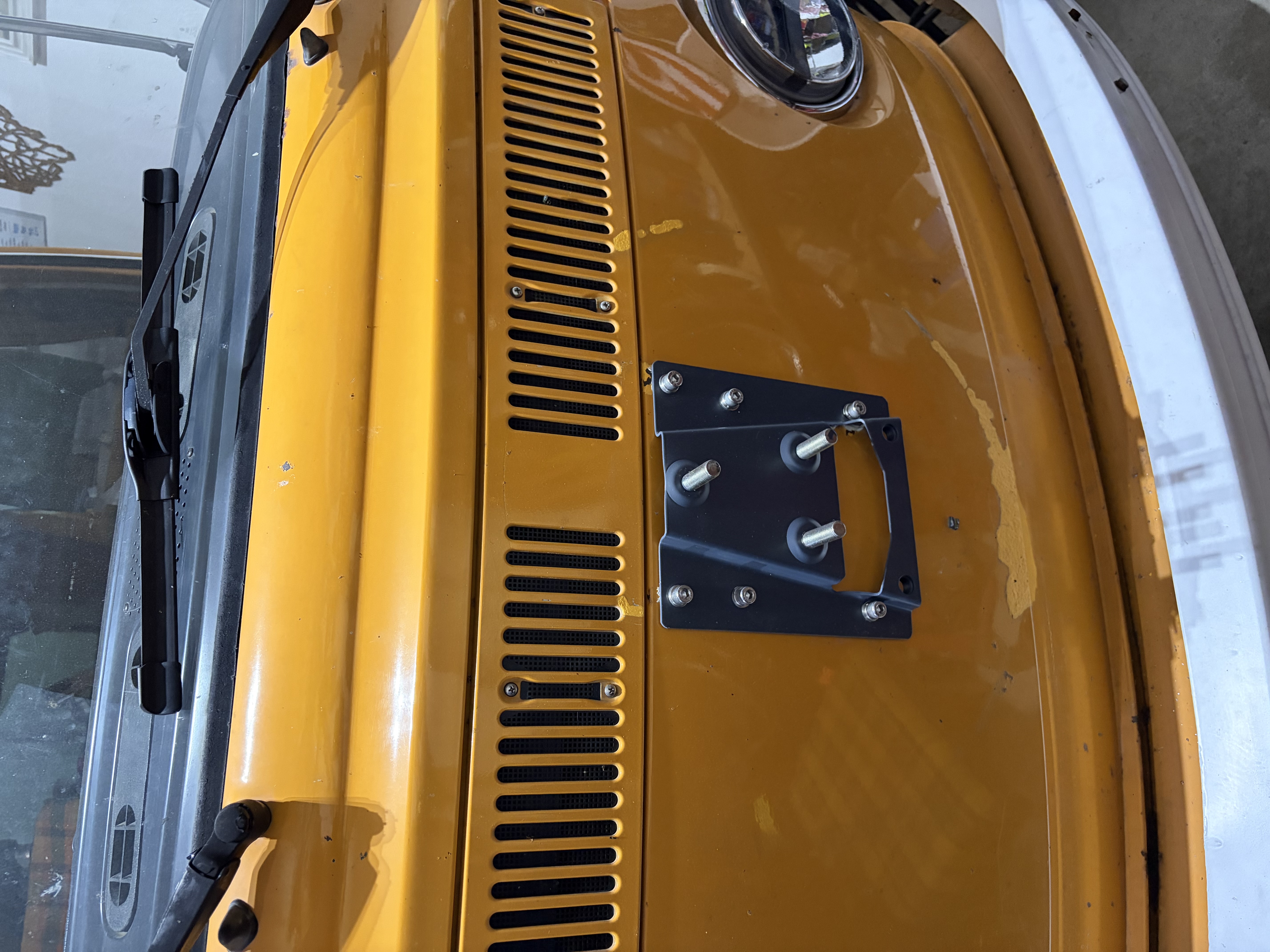

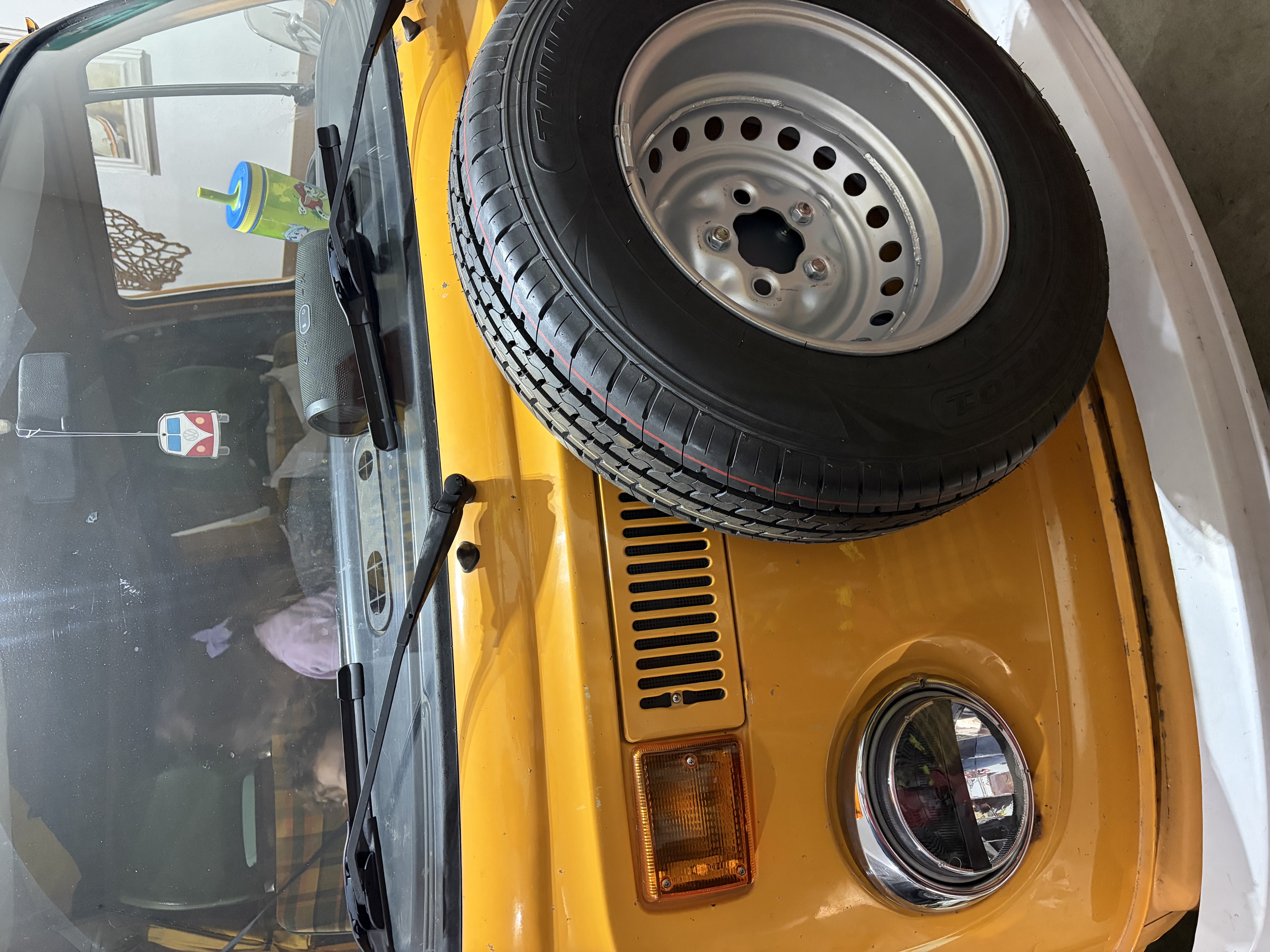

Next project is re-mounting spare tire onto the nose. The spare normally lives in the kitchen cabinet on this style Westfalia. I want to use that interior space for more storage.
At some point in the past. The spare was on the nose and the holes were still there and just plugged with plastic caps. Used some Riv-nut inserts to bolt up the tire mount.
Glad to see you got that tire out of the kitchen. Now you need a good tire cover on the front. 😁
