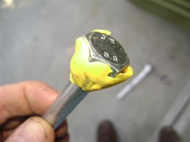

My kid stopped playing with playdough years ago, but now I'm back on it. If you get some playdough or something else you can stick the bolt in place so it will hold while you reach into the engine compartment and get the nut on the other side started. It works. Just get it started. The putty isn't strong enough for you to tighten it all the way down. For that, we need something to hold the bolt in the engine comaprtment in place. Here is one method...

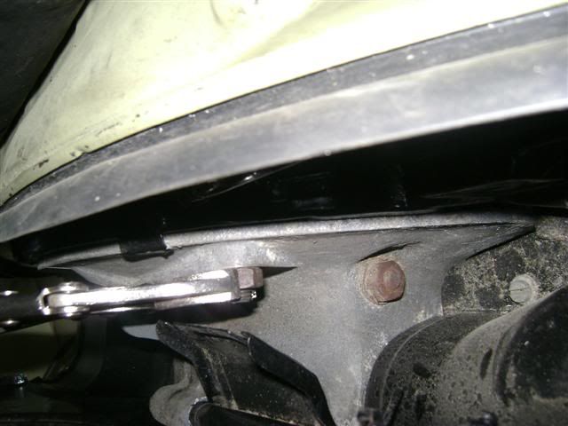

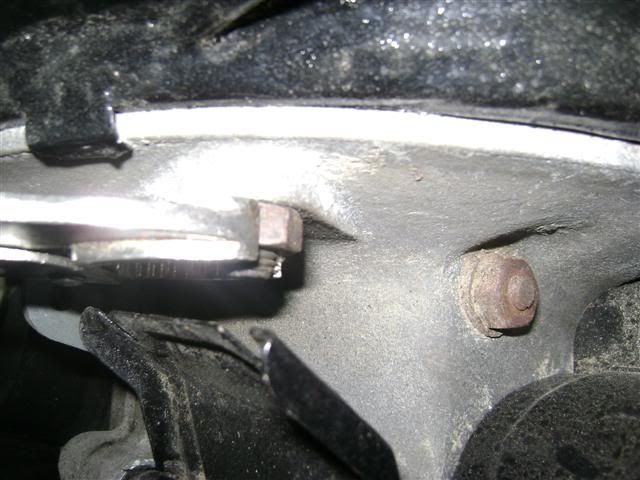

What you see here is the inside of the engine compatment from behind the fan shroud where the nut is put on the upper bolt. You can see the nut is started, but then a set of vice grips are attached to the nut so when you go underneath with your 17mm ratchet on the bolt head you can crank away and the nut won't turn once the vice grips come into contact with something and stops moving.
Here's a bigger view...

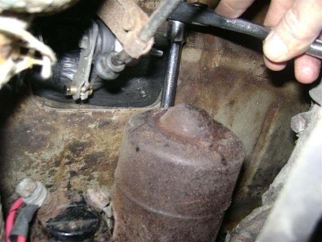

The real challenge on the starter side is gettng up there on the top of the starter and finding the unseen bolt so it can be tightened down. Here's how the effort looks...

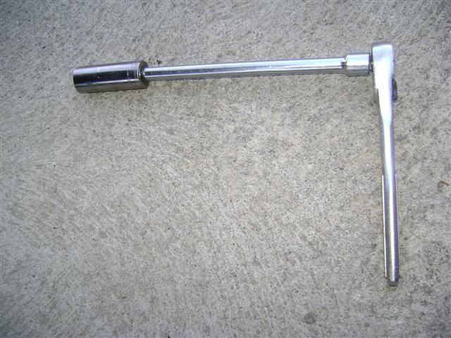

You can see the chrome extension bar above the starter seeking the bolt. Here is the set up that you need. 17MM w/ 3/8 drive and 6" extension.

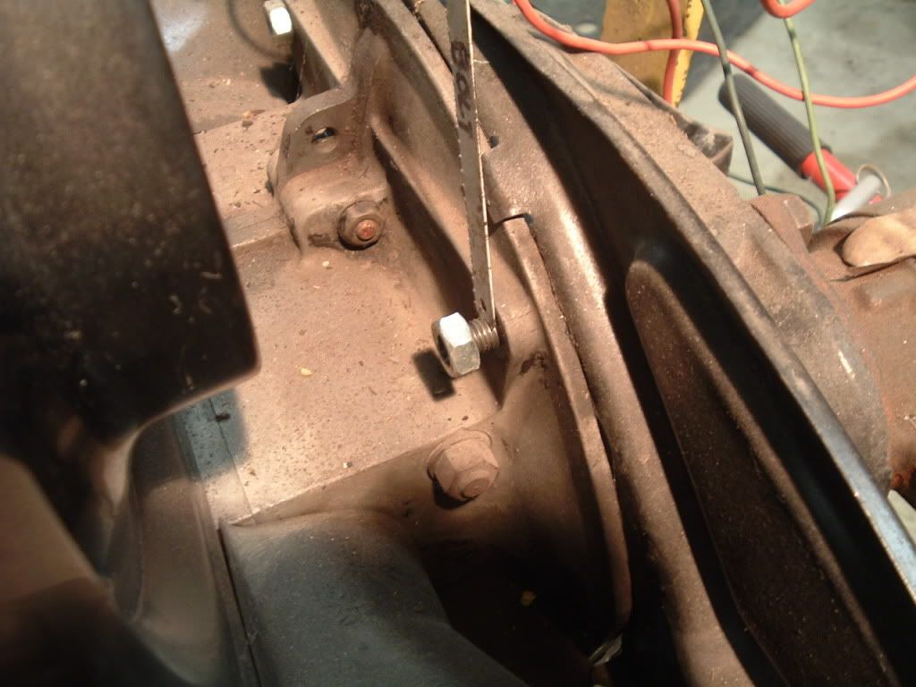

Here is a little trick I learned and it seems to work very well. Take a standard length hack saw blade and grind a notch in one end to fit the diameter of the engine mounting bolt.
Insert the bolt into the hole from the starter side and reach over the fan shroud with the hack saw blade in your left hand and put slight pressure with the notched end on the exposed threads. This will hold the bolt in place while you use your other hand to start the nut on the bolt. Hand tighten as much as possible and use a 17mm socket to final tighten. The key to this is to clean and lube the threads on the bolt and nut before you start so they turn freely. It works me every time for me.
