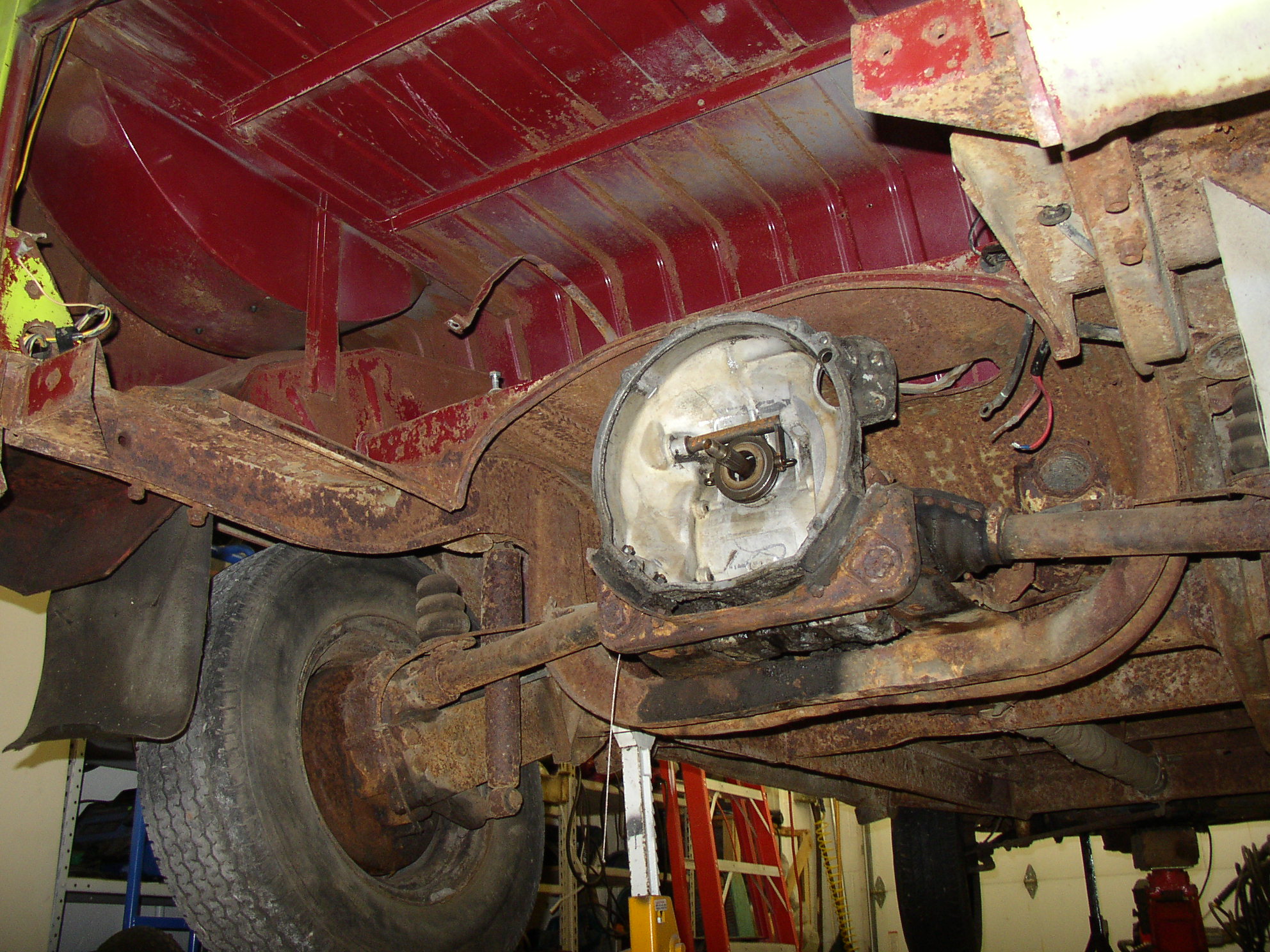

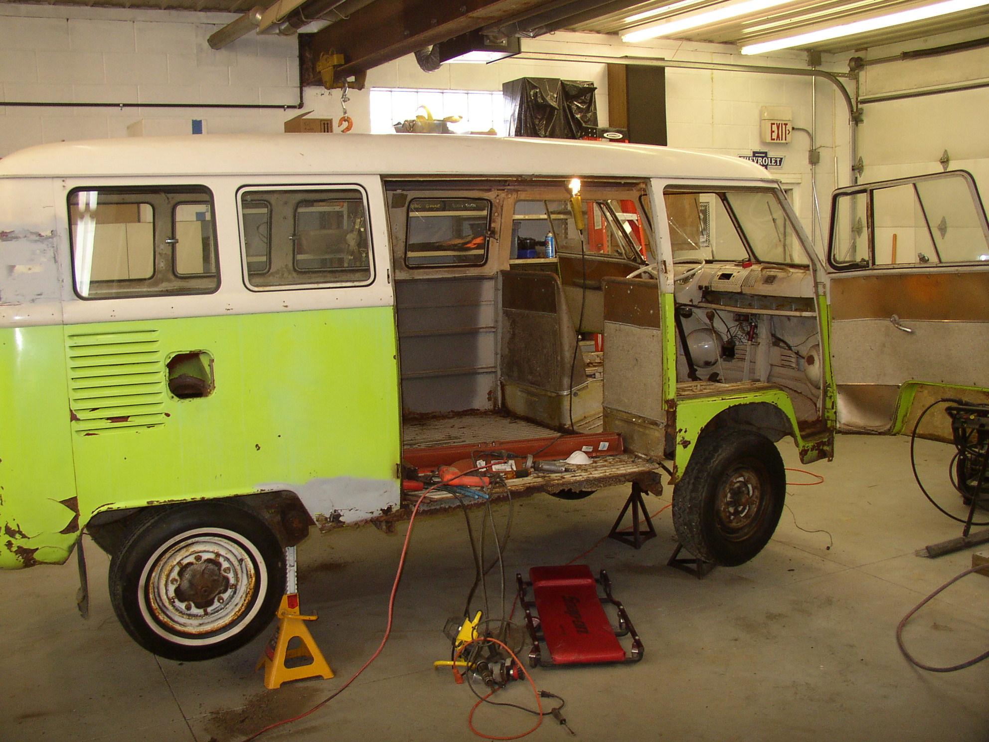

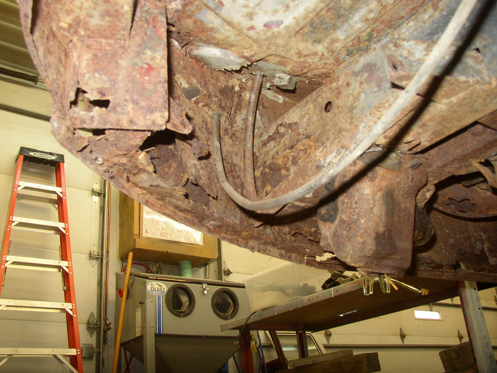

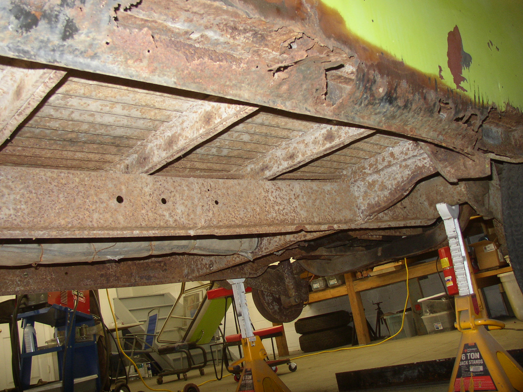

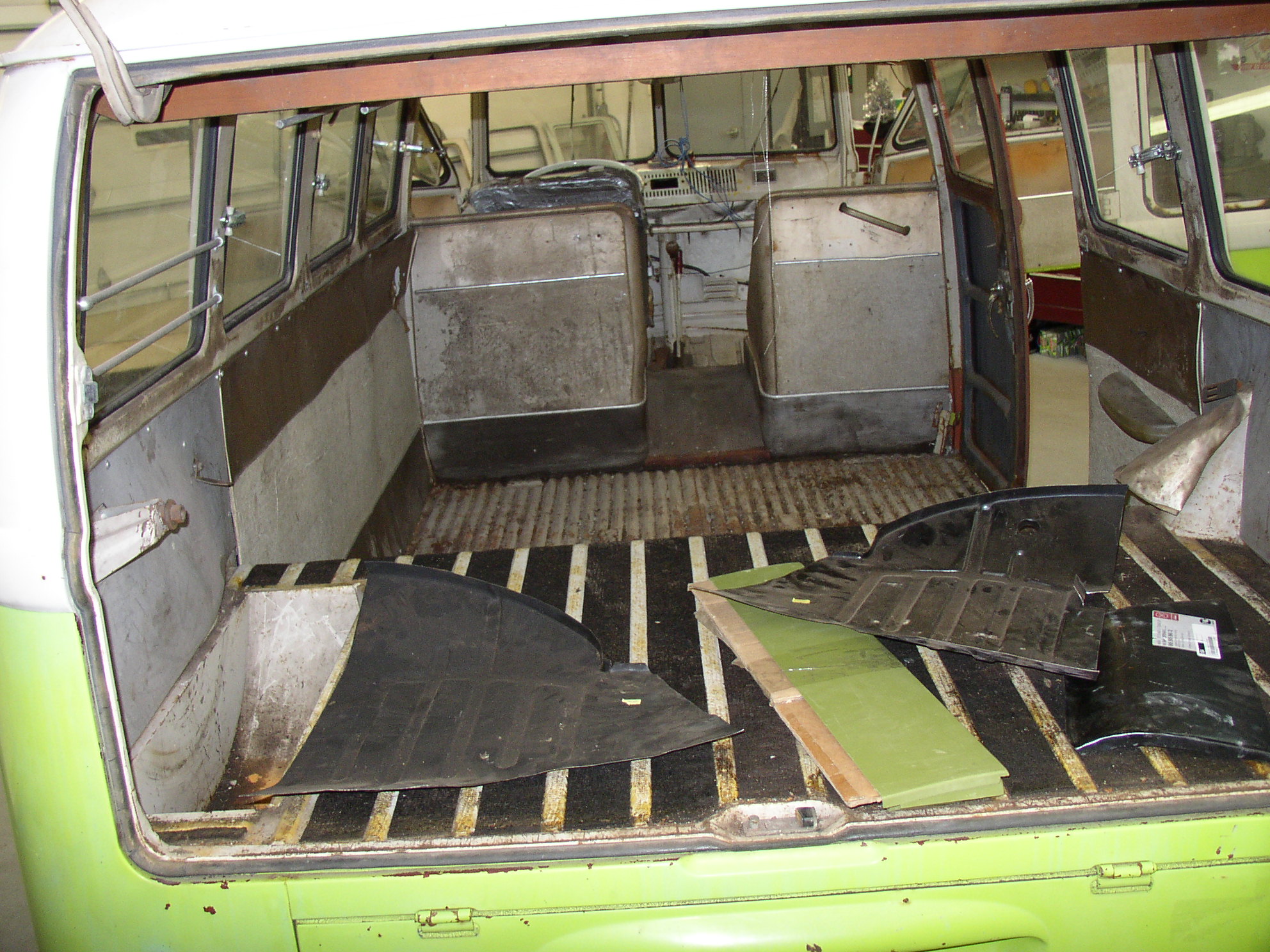

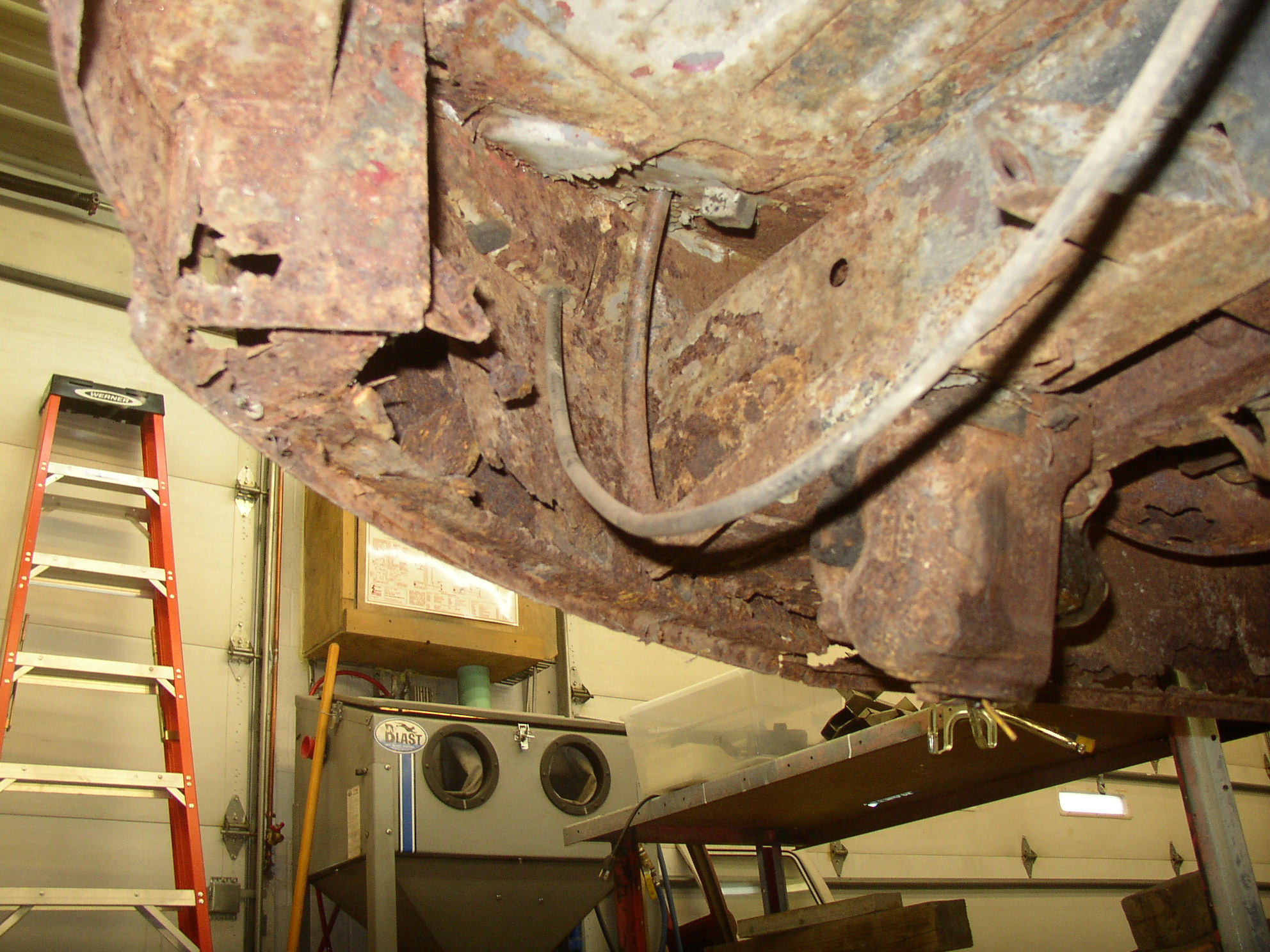

I've got it jacked up, stripped the interior and removed one outrigger today which went smoother than I thought. On closer inspection I'm pleasantly surprised with how good the bottom looks overall, there's nothing underneath that's going to be a tough fix. I shot a ton of pics but they're in my camera at the shop. This should be 6v, right? It "appears" to have a nicely done 12v system in it and I'm wondering if any '66s came with 12v. The 12v regulator and wiring "look" OE to me.
I'm wondering if I can put a '67 harness, TS switch, dash junk and clock into it and convert fully if it's not already. The PO didn't know anything about electrical details but it has a 12v reg and bulbs in it so far. Sorry, Sean!
Deluxes have headliner cloth glued to the inside walls around the windows.
Does anyone have any tips for getting this glued-on headliner off the inside walls of the bus? It's glued on there with some ungodly strong stuff!

12V systems were optional on 66 transporters. As far as the headlining material glued to the side walls :lol: :lol: :lol: , Razor knife and a putty knife and a DA and lots of DA paper and a couple days.

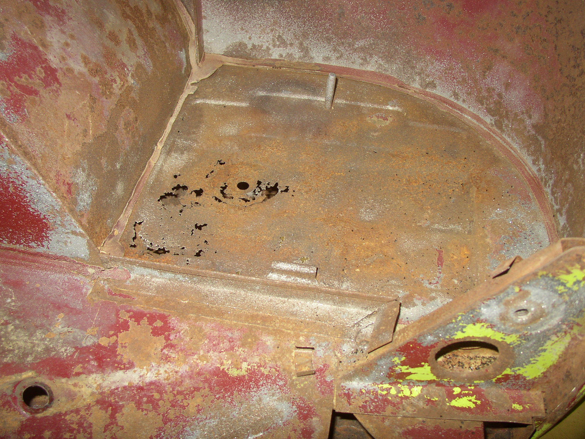

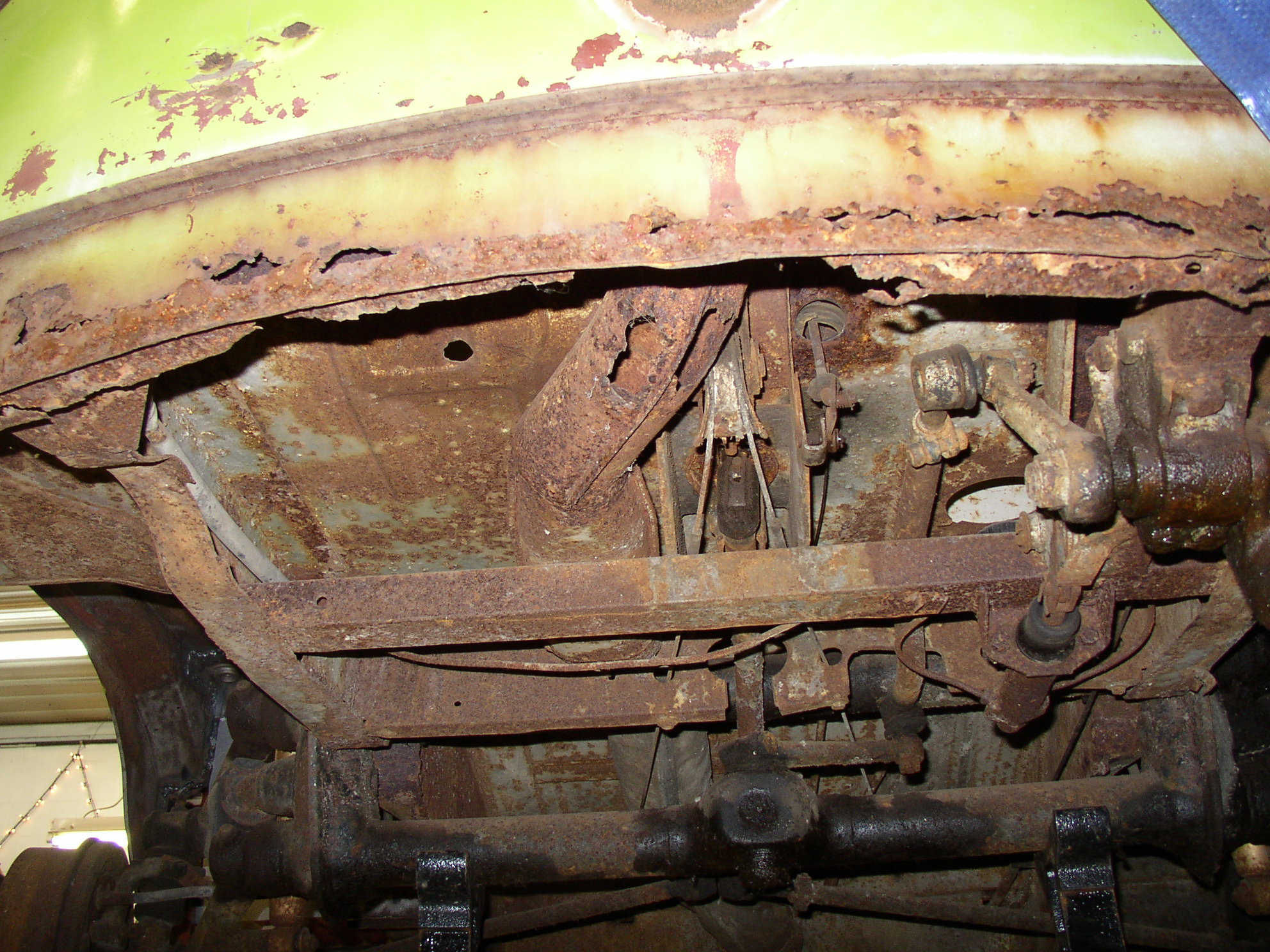

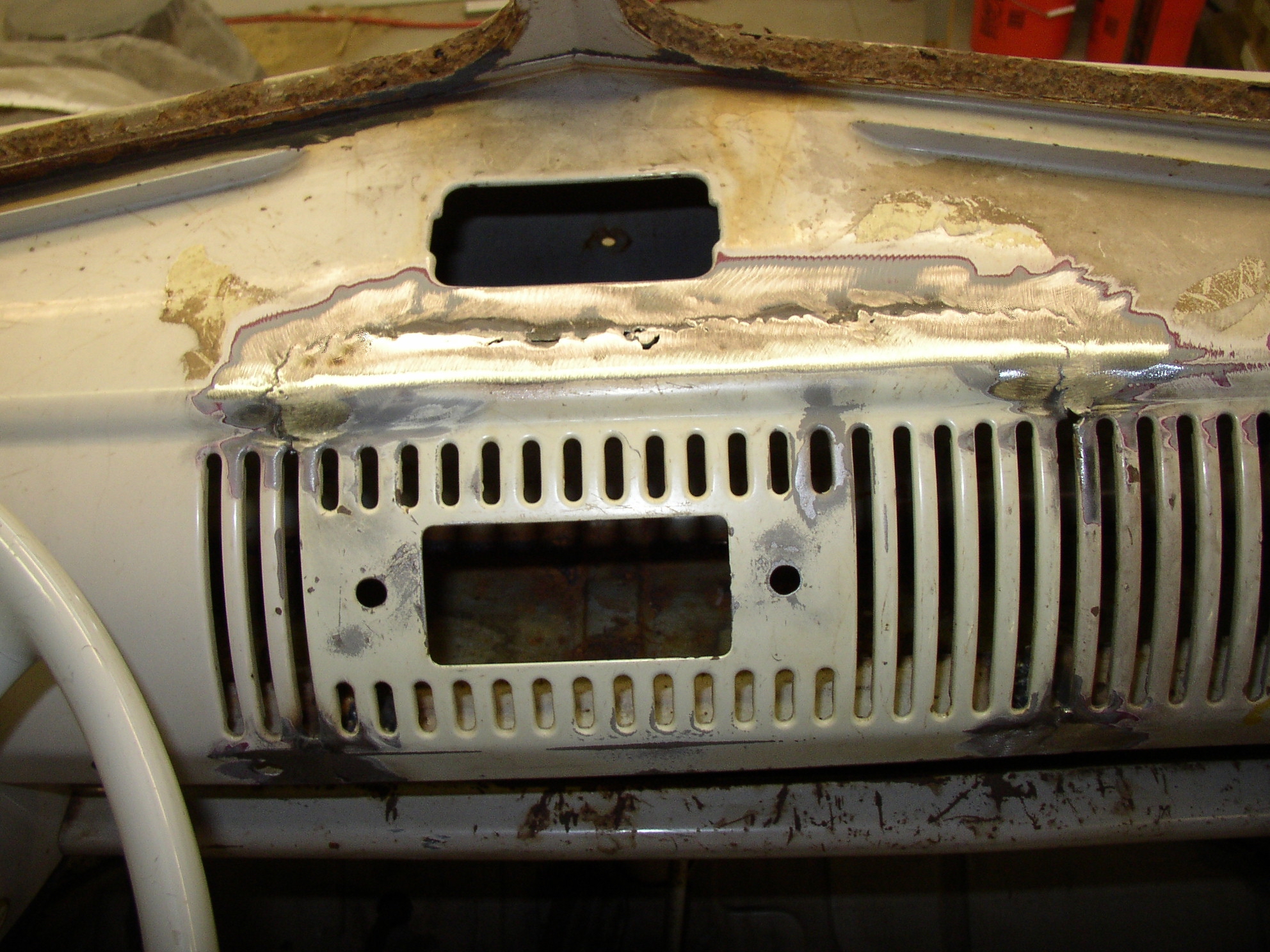

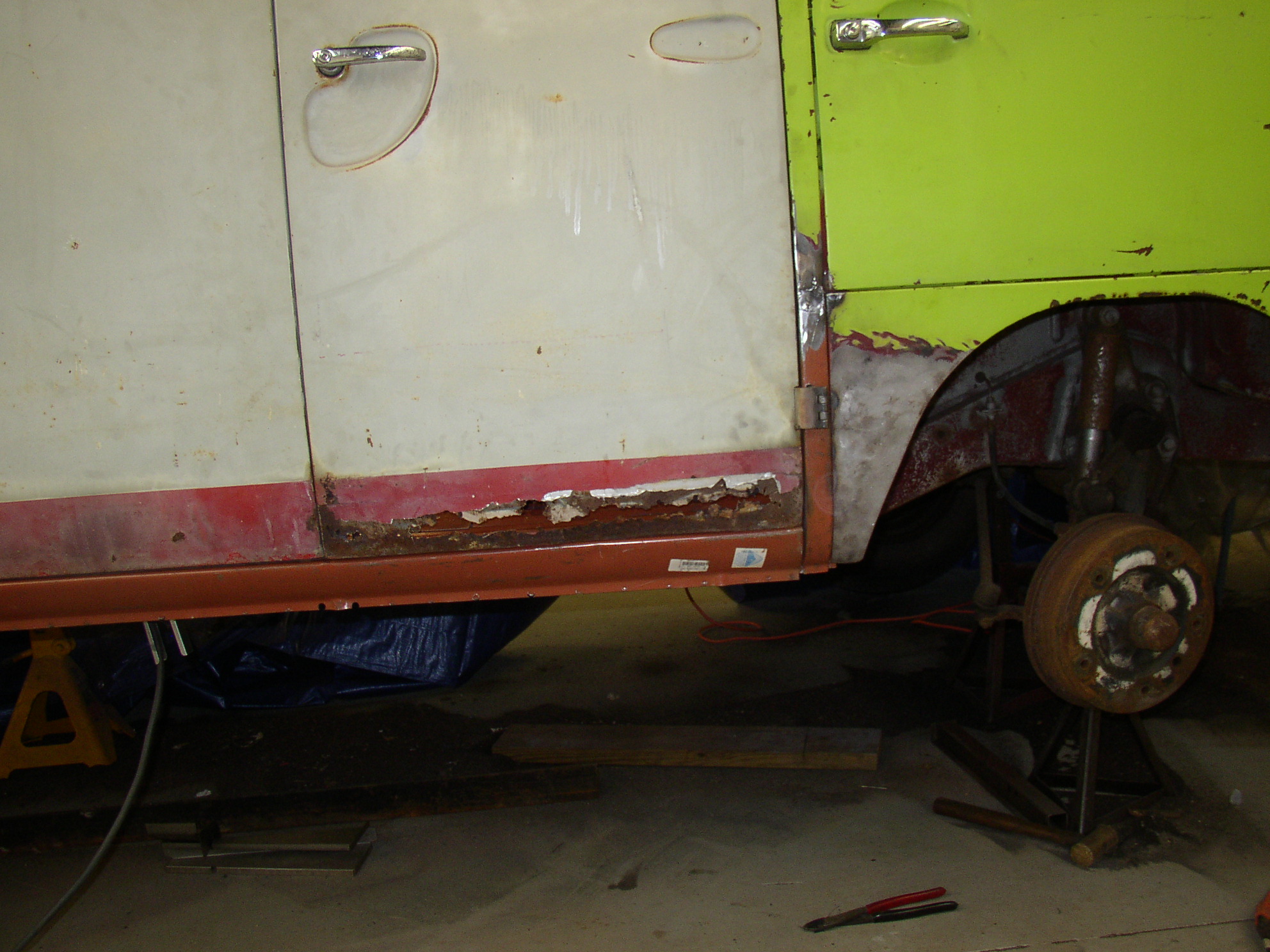

That's dirt on the roof, not dents:

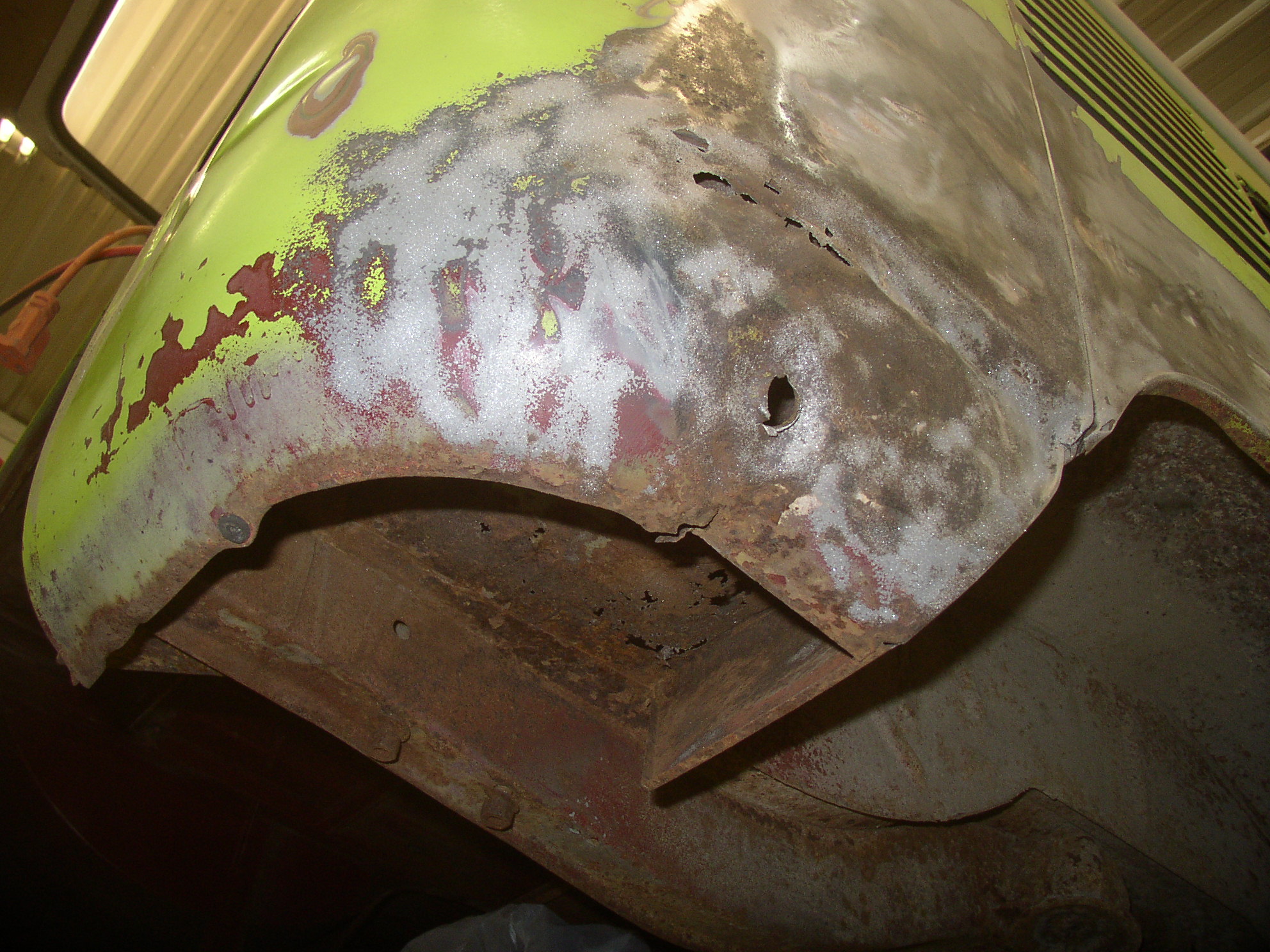

It needs rockers, some floor patching but not the whole floor, and outriggers. Roof is virtually perfect, all side window frames are perfect but there is some rust under the windshield. Nose and the rest of the body has almost zero impact damage, only a couple of small bruises that are easily repairable. This is a very restorable bus and will go back red and white, originally titian red and beige.

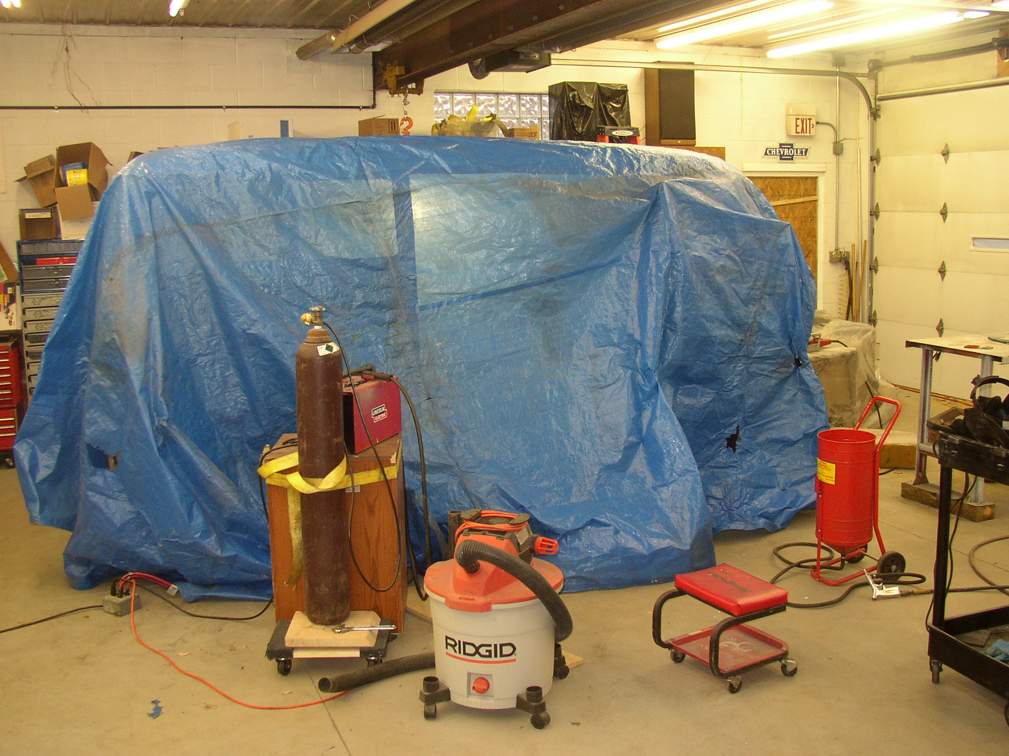

Big thanks to Josh who stopped by today to give me a hand and pointers in mig welding!
More pictures to come, I will document the whole process.

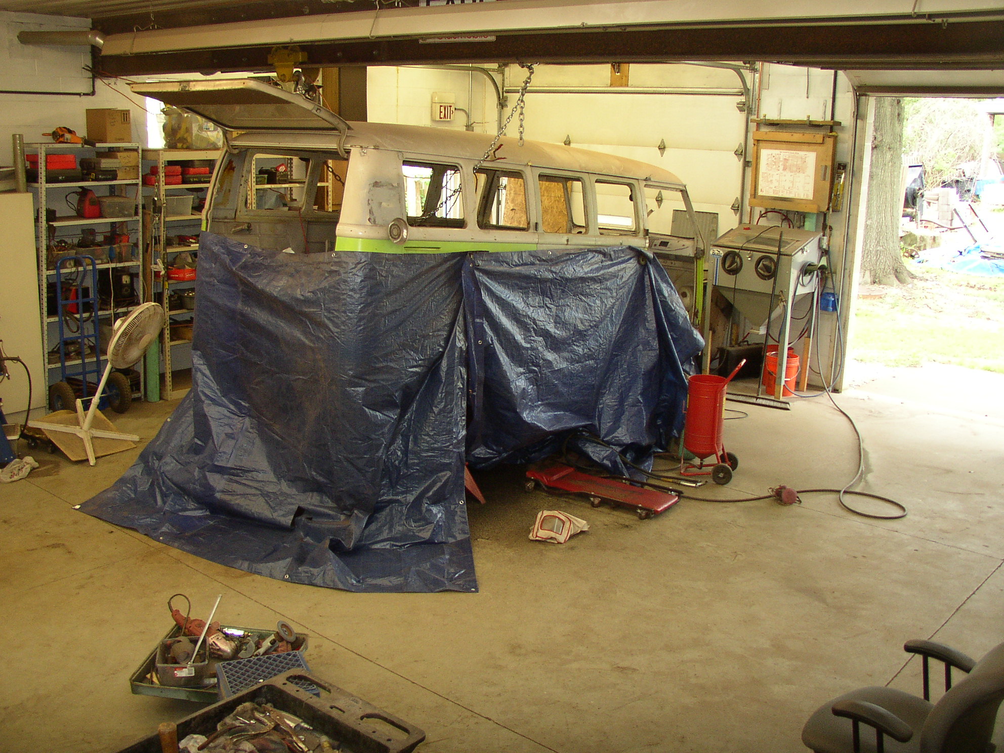

I'm planning a full gut job and restoration before it goes on the road, it will be 90% accurate to OEM but I might change the colors slightly. Originally Titian (medium dark) red and beige, I'm thinking a slightly brighter red and white. Interior will be all stock, stock wheels and tires, no modifications.
I'm telling people between 6 months and 2 years for it to be roadworthy, I'm thinking 2 months of welding panels, 2 months of bodywork and paint, and then assembly. My work is slow in the winter but will pick up in spring.
