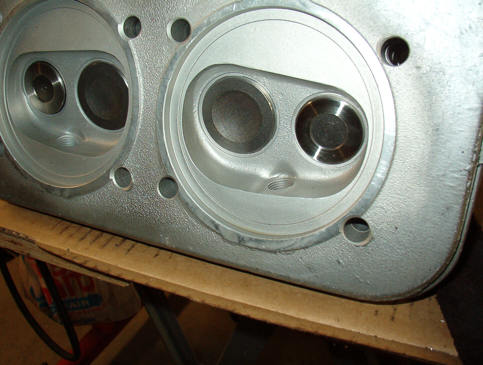

Still waiting for the crank to come back from DPR. In the mean time,the heads came back from Delzani's,as mentioned above.The heads looked good upon teardown. my only concern was that the valves seemed to be sitting a little deep in the seats. I did not get a pic prior to sending them off. Turns out that the Chinese valves used in the AMC heads have very thin heads. Most likley the reason for their pre mature failure associated with these heads. However,the castings are very good. Most reputable T4 engine builders routinely throw them away and replace them with GOOD valves. The new TRW/Kolbeschmit valves sit up nicely on the seats.

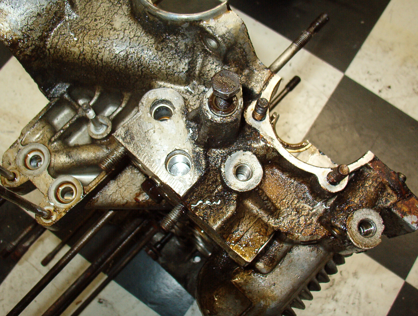

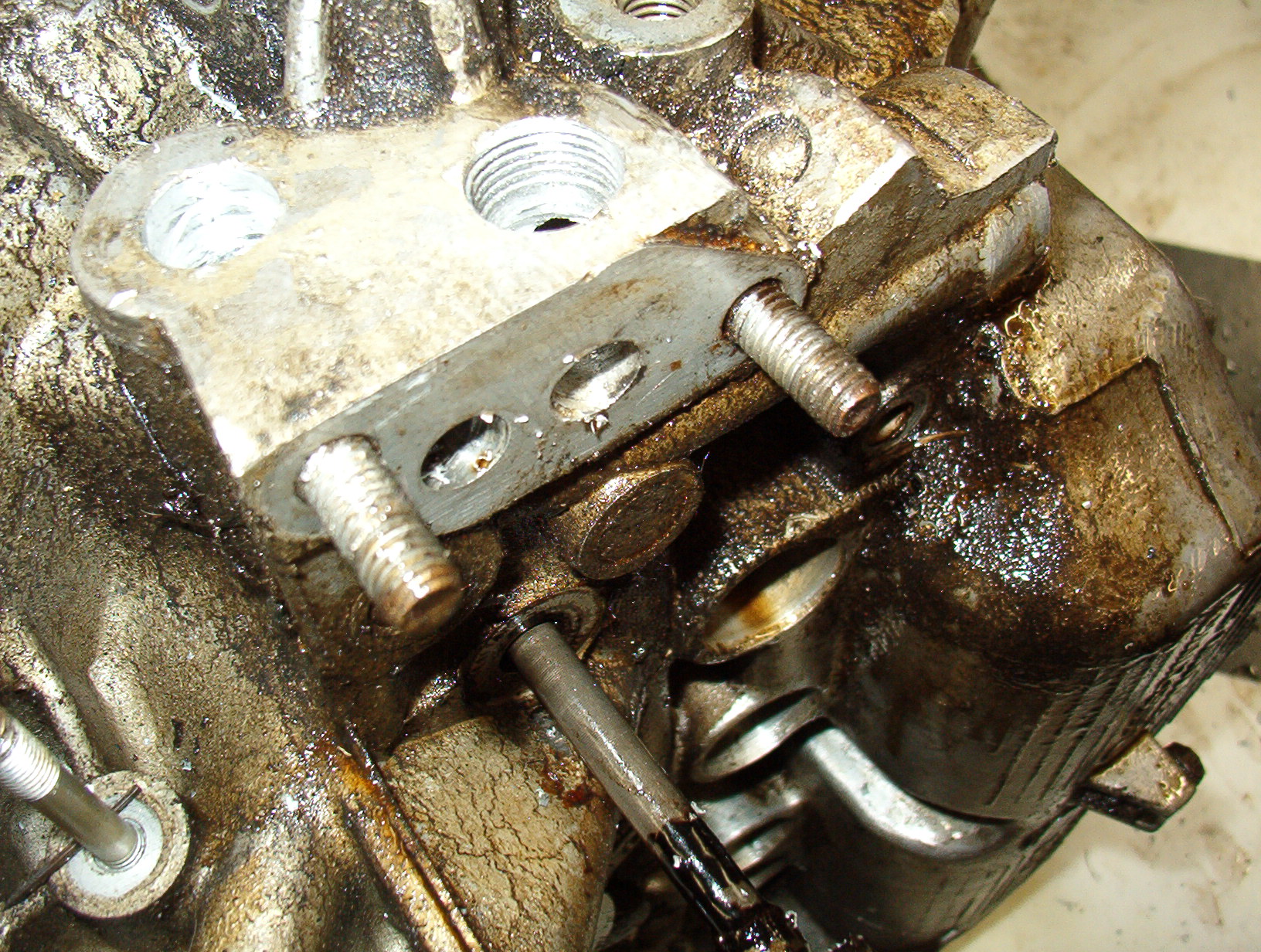

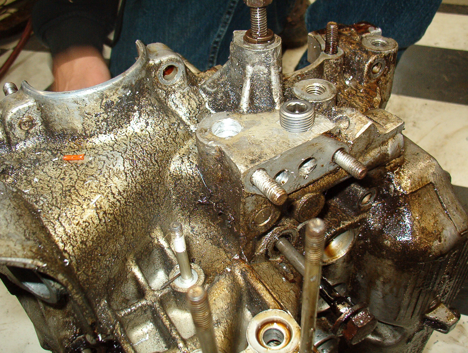

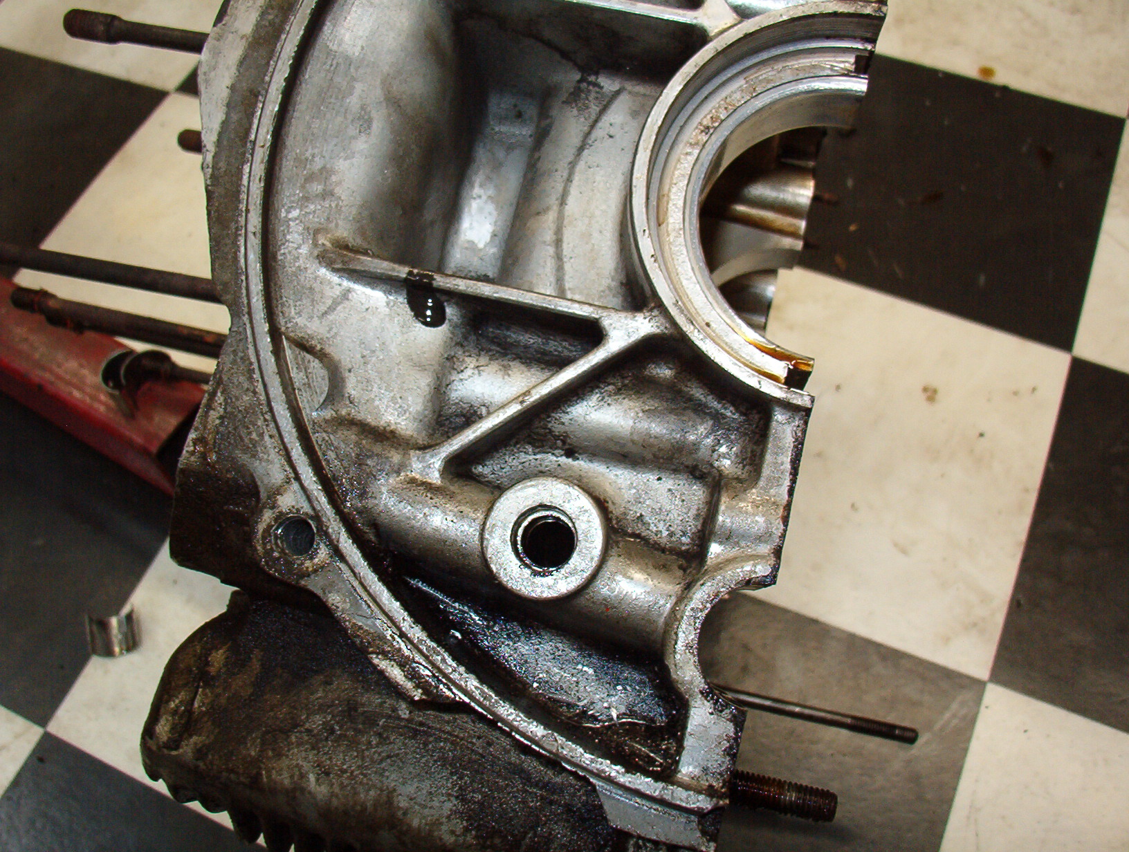

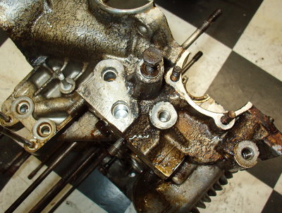

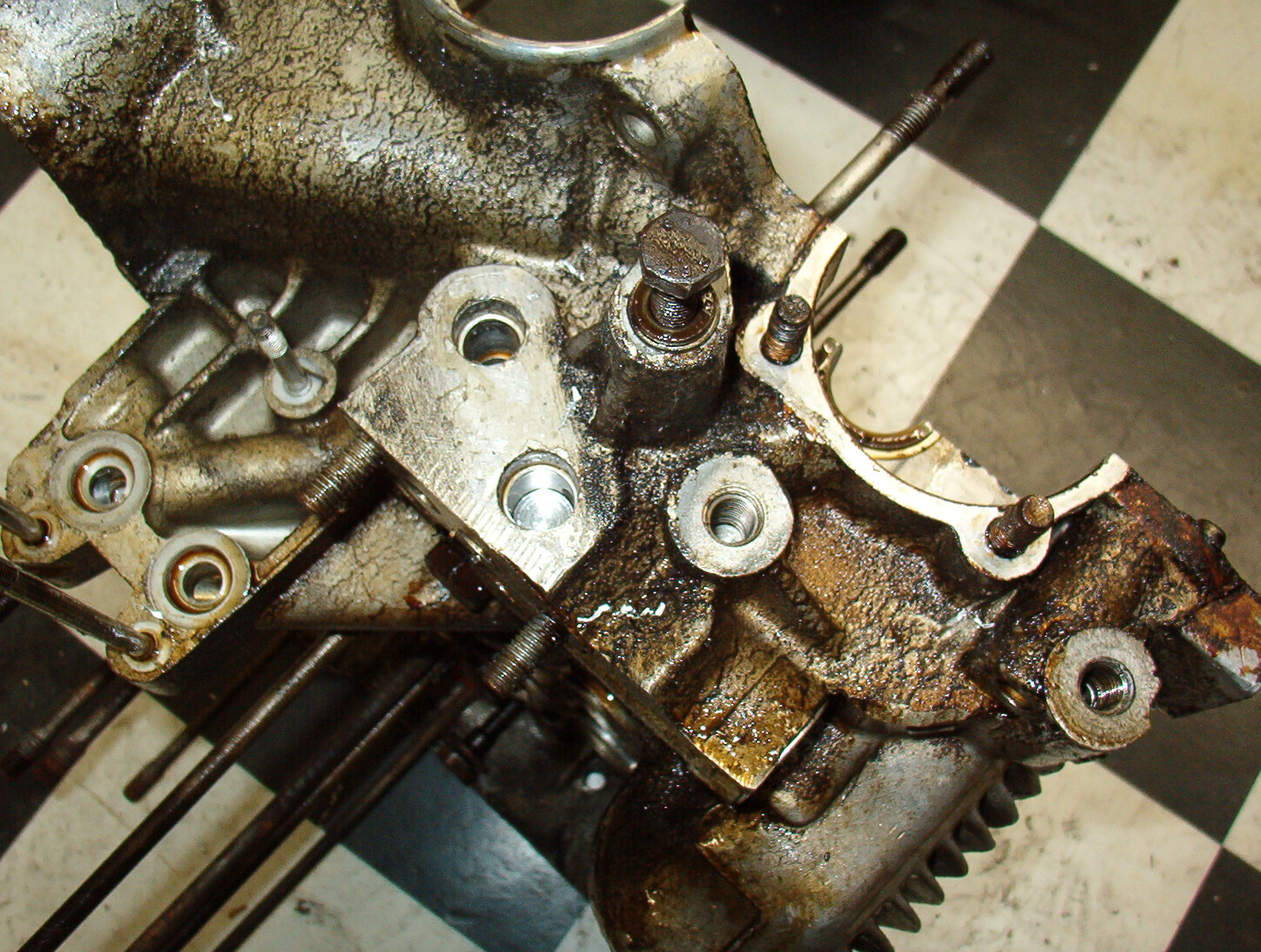

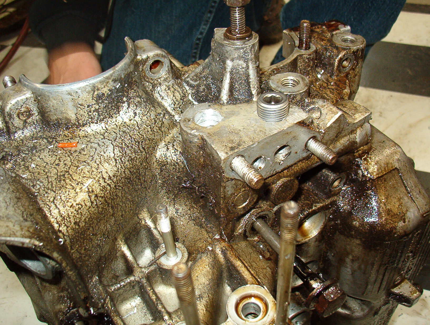

We can't do much more until we get the crank. We did pull all the oil galley plugs and tapped them for plugs. This will insure that when the case goes for cleaning,any remnants of that nasty red silicon that the last guy used,along with any other foreign matter in the oil passages will be cleared out.

In terms of the oil passages, is it sufficient to just open them up prior to cleaning? Or do you have to run a brush through them? What type of cleaning of the block are you doing? Are different cleaning methods used for aluminum blocks compared to magnesium?
Re: John's t-4 engine rebuild
KB Machine in N.Olmsted uses a turbo wash type of cleaning. Similar to a commercial dish washer. Solvent used is compatable with all metals. In addition,when we get it back we will use a rifle bore cleaning brush and compressed air to be sure ALL the oil passages are clean and free from obstruction.

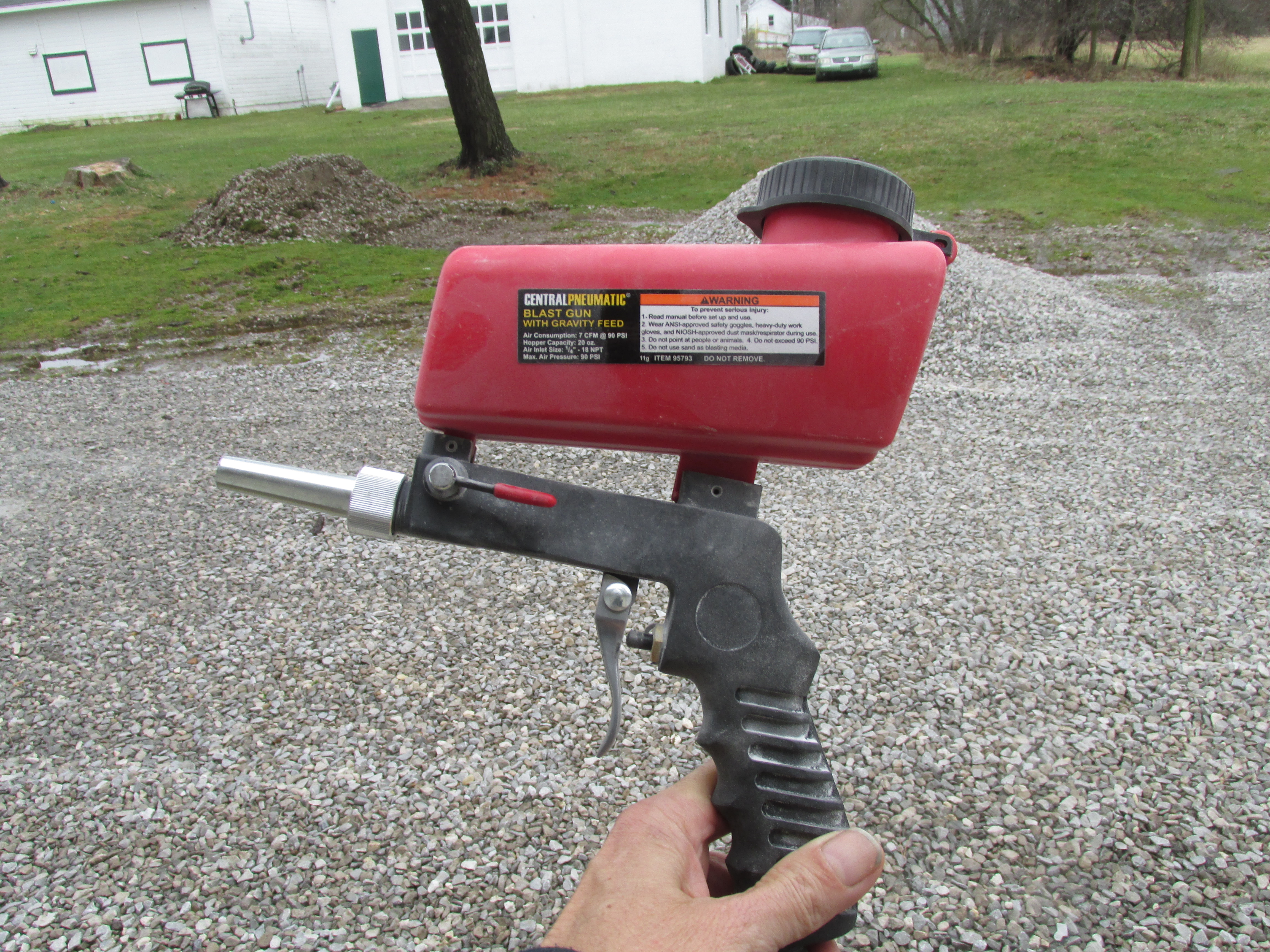

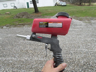

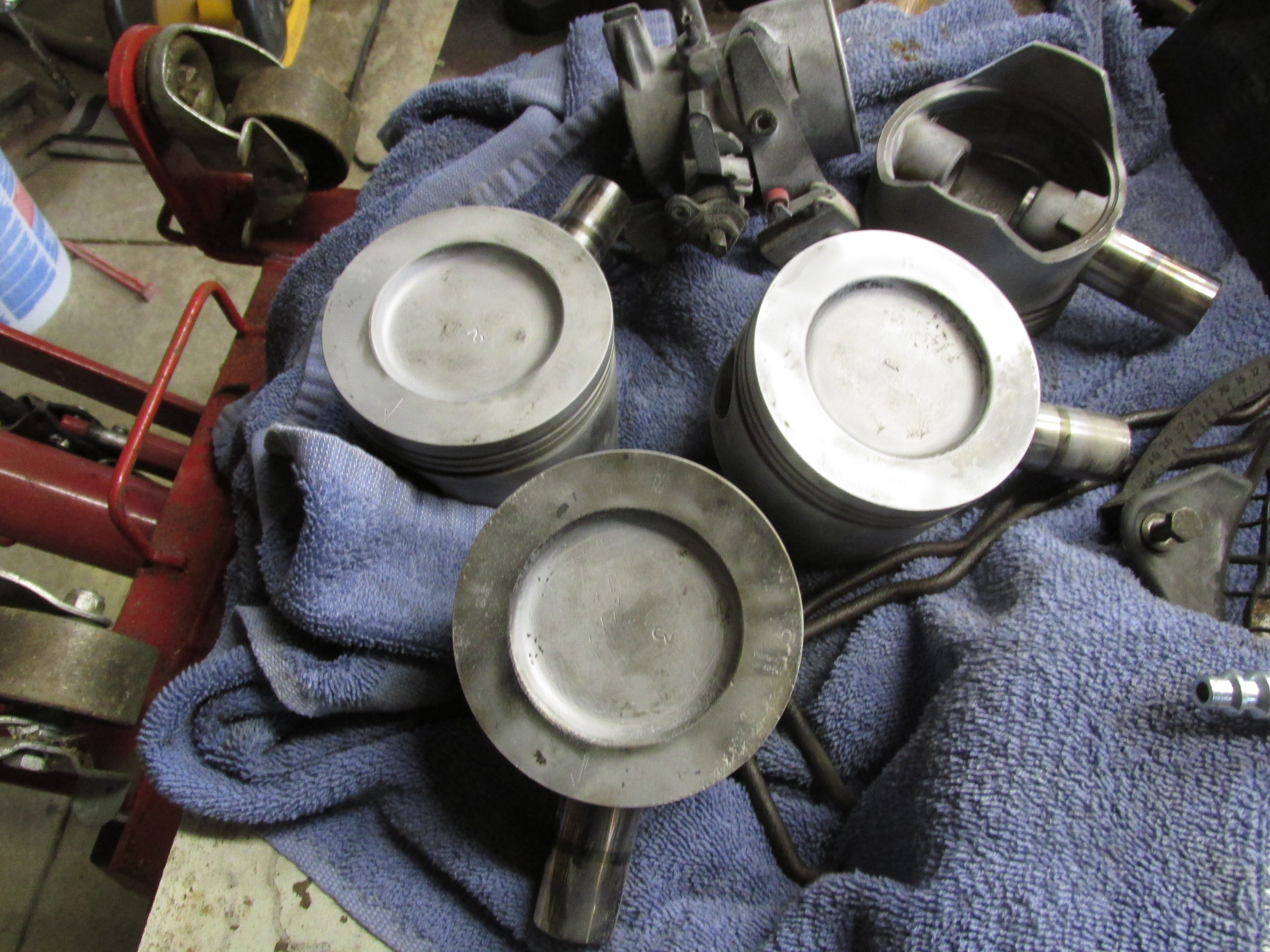

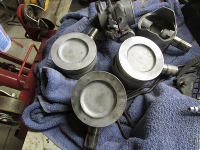

I stopped at a not so local H.F. and picked up a G.F.B. gun ,then I stopped at a little more local G.S. and picked up 6lbs of B.S. Took these items home and tried B.A.'s cleaning method on my pistons , T.B. and some nuts and bolts, werked very well, it took the carbon build up off the pistons like NOW. also tried on the fan shroud butt B.S. it is not a paint remover. butt it werks well on greasy fingers.

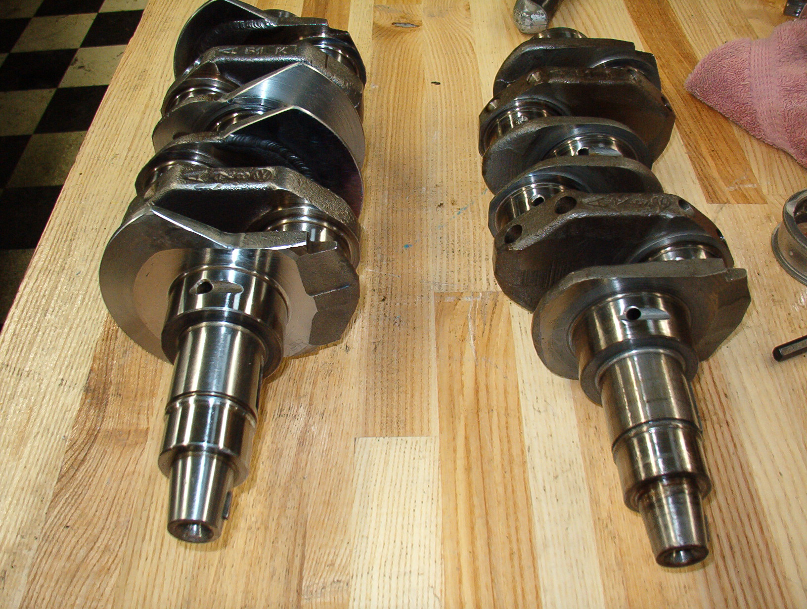

The crank came back from DPR. Beautiful :D Welded on counterweights,balanced and polished. all journals measure perfect standard.Stock crank on the right.

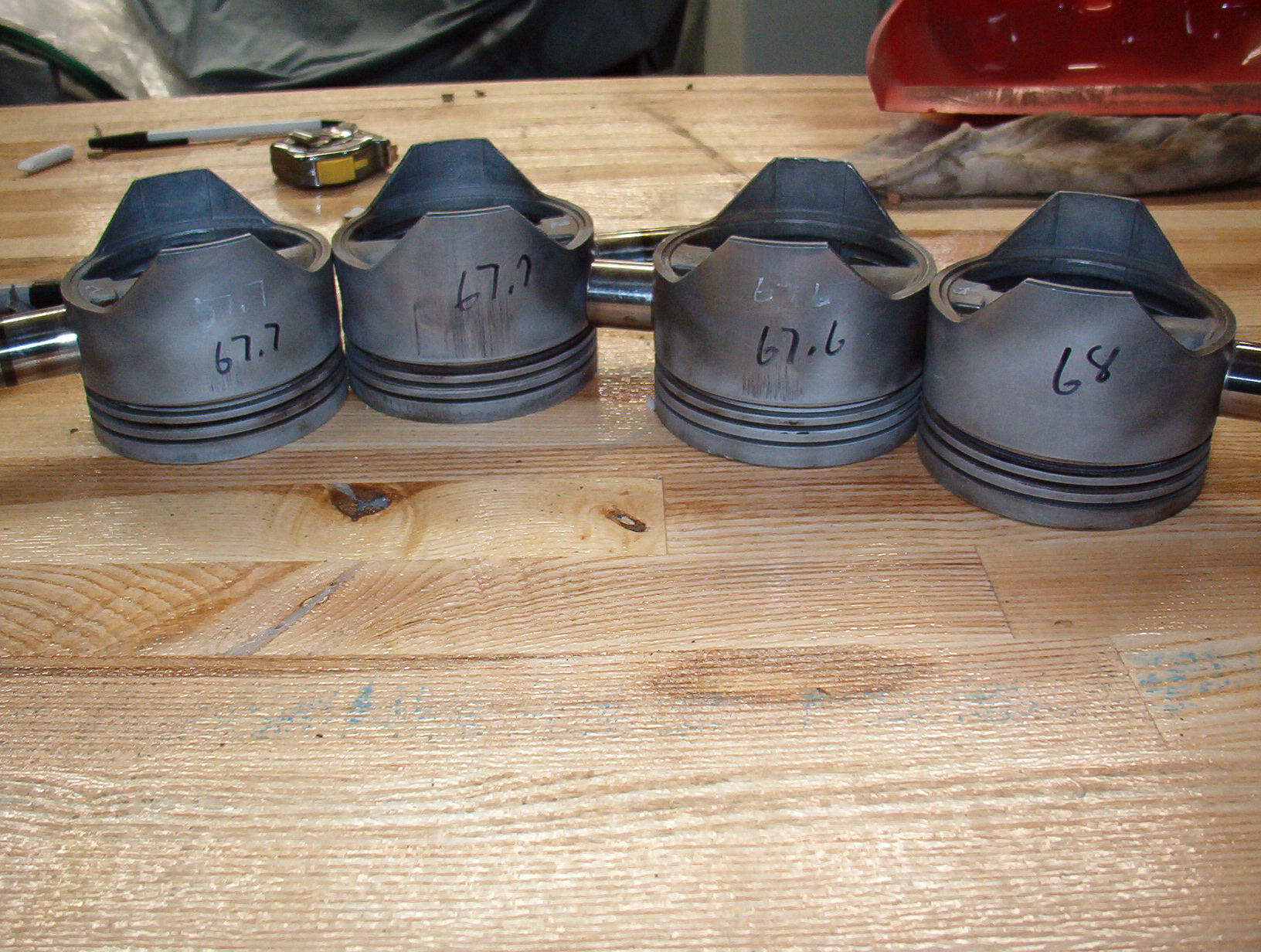

John has cleaned the pistons. The original (60,000 miles) look very good. I weighed them to balance them,but,
the lightest and the heaviest were within .4 grams. Since we would shoot for 1 gram, no need to.
