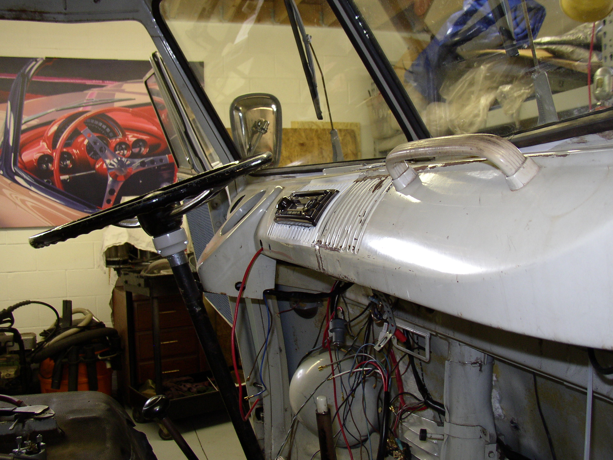

I was out of town for a while on business but I've gotten a lot done since I returned, it's about 99% done right now. A lot of this is repeat, just like yours and my '65 I did last year.
Splice the main power feed into three feeds to supply the HLS, Iggy and FB independently. This bus also got the 40 amp Maxifuse in the main power feed near the battery.
Cover it with two layers of shrink tube to protect it.
Clean all of the switches and stuff so everything makes a good connection.
This bus had an unusually large dent in the dash and parcel tray. Something very big and heavy was not secured properly and hit the dash with a LOT of force when the driver hit the brakes. I straightened it out using a ball joint press and some stiff scrap.
The starter stuck "on" even with the trigger wire unhooked so it got a new Napa permanent magnet (small, light) starter which was only $44 with a life warranty. I figured that was a good deal so I bought one for the shelf, too. Pics are in the camera at the shop right now but I did clean the flange well.
It's getting some simple stuff- an axle boot, free up the heater cables and put a new heater box lever, etc. The electrical is all done and everything works as it should. It will probably come off the rack tomorrow. (Yea!)

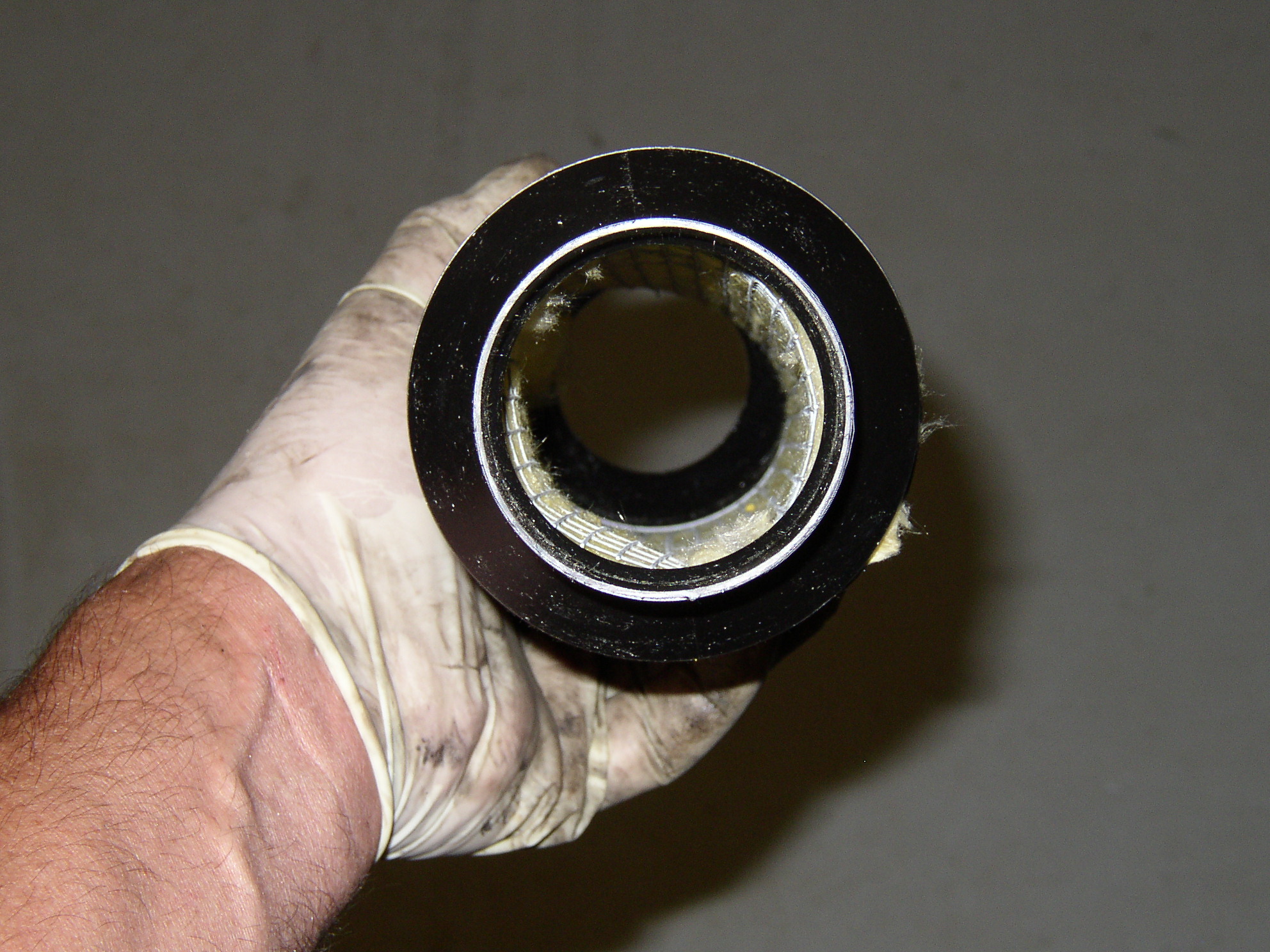

I remove the spring and use "hardware cloth" (1/4" screen) to hold it back. Much better heat flow.

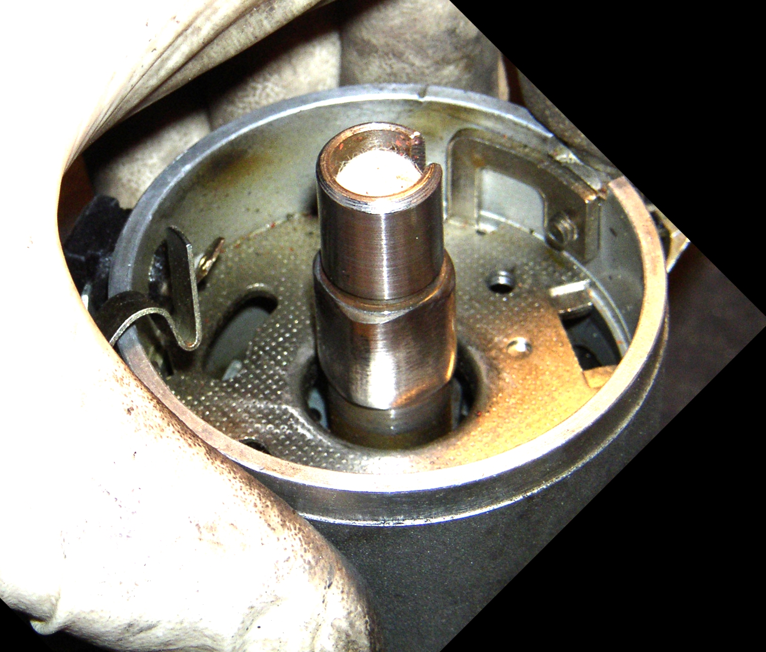

The aftermarket 009 was installed without greasing the cam or oiling the felt pad.
The cam got all rusty.

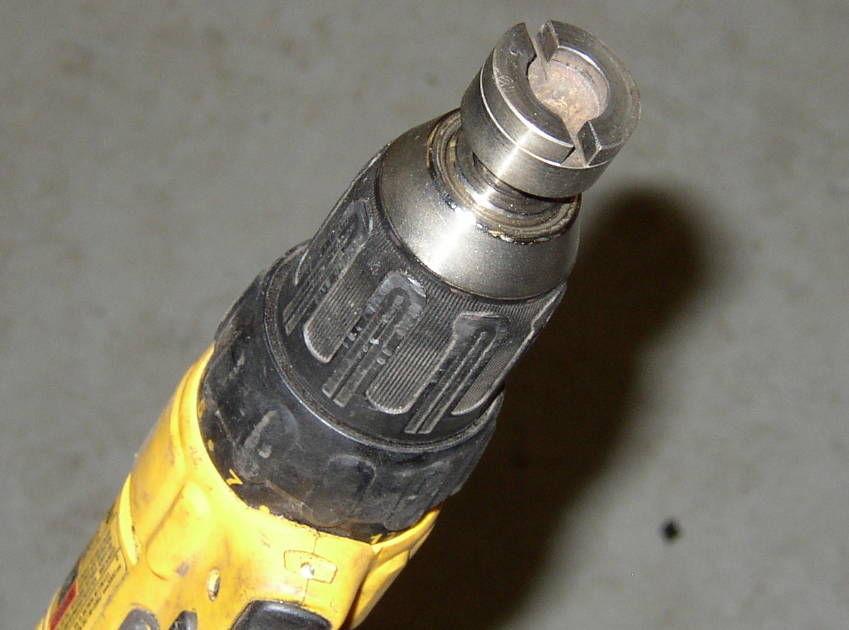

I have a gizmo to drive the dist and used 1000 grit to polish the cam. It came out better than the picture shows. Surprisingly the advance curve was pretty acceptable, like 20° crank at 3000RPM which gives me 10° initial. Many aftermarket distributors have bad curves out of the box.

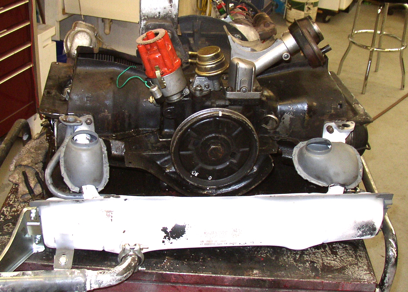

Been kind of bored with winter lately, mostly tinkering with stuff at my shop and Rob's many cars. His bus had some engine issues develop so we decided to pull it and look inside. It's probably been rebuilt several times as the case has already been cut. It has newer VW Brazilian heads on it, but one of the valves is soft, stretched, and lost its keeper grooves. It would have dropped a valve soon. Cam is bad also.
