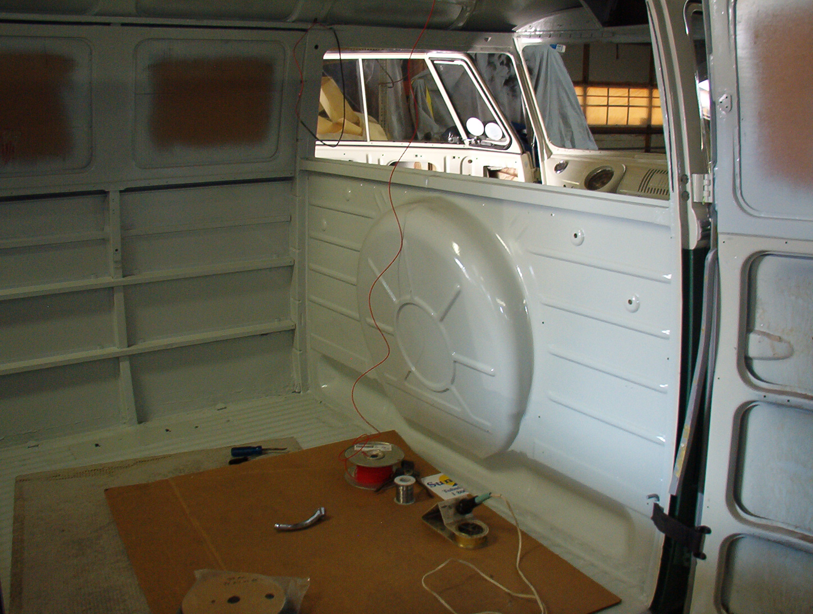

This bus has so many holes drilled in it I wonder about the previous owners, it’s like some kid got a cordless drill for Xmas and went crazy on the bus, putting dozens of extra holes everywhere. I assume these all need to be filled?

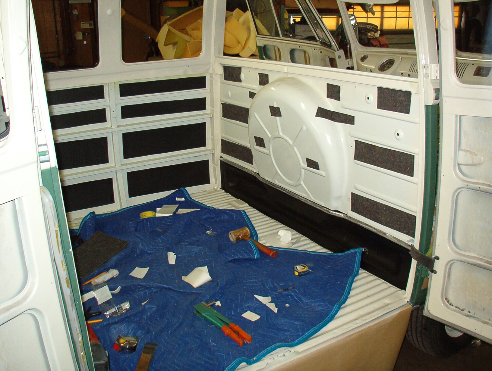

Bruce,here's somepics of one I did a couple of years ago. although this was a non walk thru, most of the holes in your pic look symetrical.

I like what I see in those pics. How did you fill the window openings- is that cardboard? I'm thinking of thin cardboard panels cut to fit the window openings and a million little magnets to hold them in place so I don't have to worry about tape. Once the inside is painted, flip the panels over to keep the paint from the inside as I'm doing the outside......
Nice workmanship. Solder. Blanket on the floor. Sound deadener.
I will be asking a lot of questions since you BTDT.......
Posted: Fri Sep 06, 2013 3:43 pm
by wwebner
Yep,cardboard panels. I used tape,the correct good stuff,but whoever did the body and paint job did little or no proper prep in the window recesses. When I pulled the tape,well you guessed it,bare metal was what I was looking at.

Dual Port wrote:This bus has so many holes drilled in it I wonder about the previous owners, it’s like some kid got a cordless drill for Xmas and went crazy on the bus, putting dozens of extra holes everywhere. I assume these all need to be filled?
The 2 large holes are for the grab handel and the evenly spaced outer holes are for the screws that hold the panel. There should be 2 for the screws that hold the mcode plate on too.
Posted: Sat Sep 07, 2013 9:42 am
by Dual Port
Yep, the big ones are the grab handle. The tips of the M-code plate screws are barely visible just above the upper big hole. (view is from back side)
Thanks!
