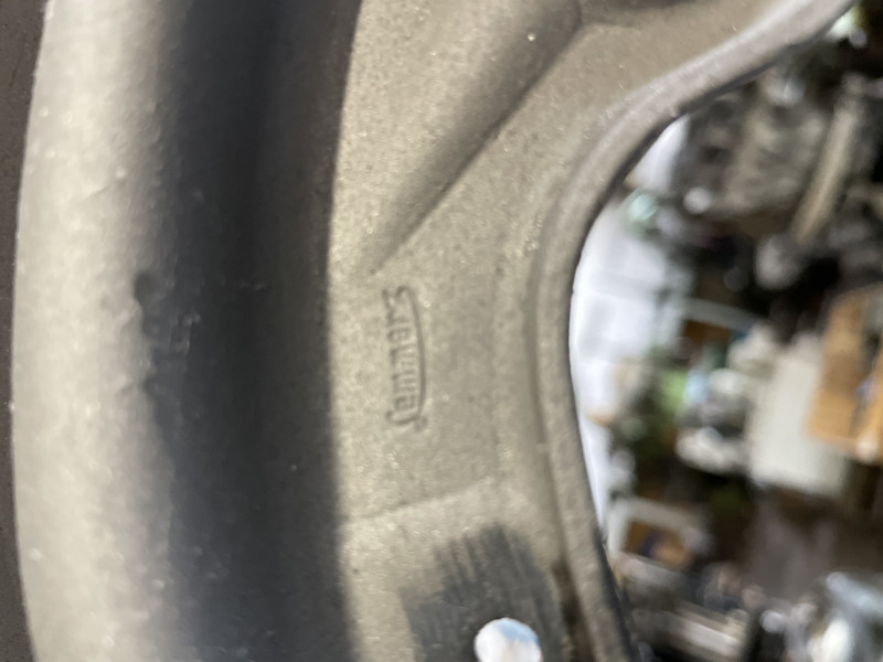

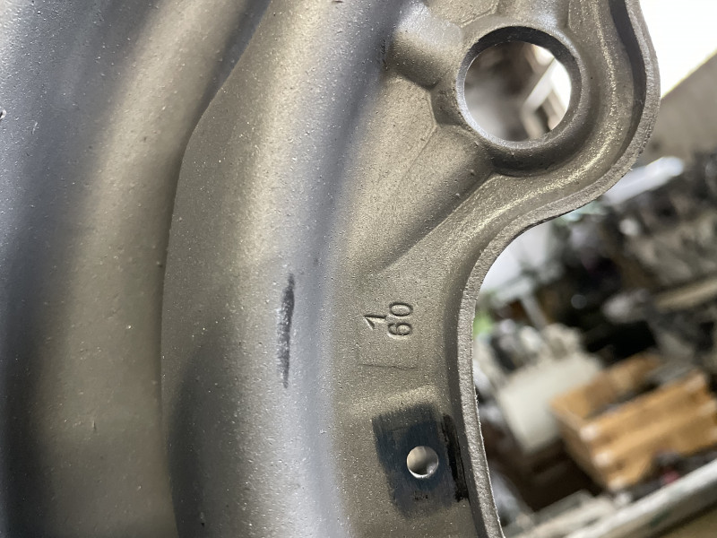

Its been wheel week. I had 6 bus wheel sandblasted and they came out great! Its cool to see the little details hiding under years of crud and layers of paint. One of the Lemmerz made wheels has a date stamp of 1/1960 but the barrel of the wheel has it’s own date stamp of 12/1959.
Clean
Clean
Lemmerz stamp
Lemmerz stamp
1 of 1960
1 of 1960

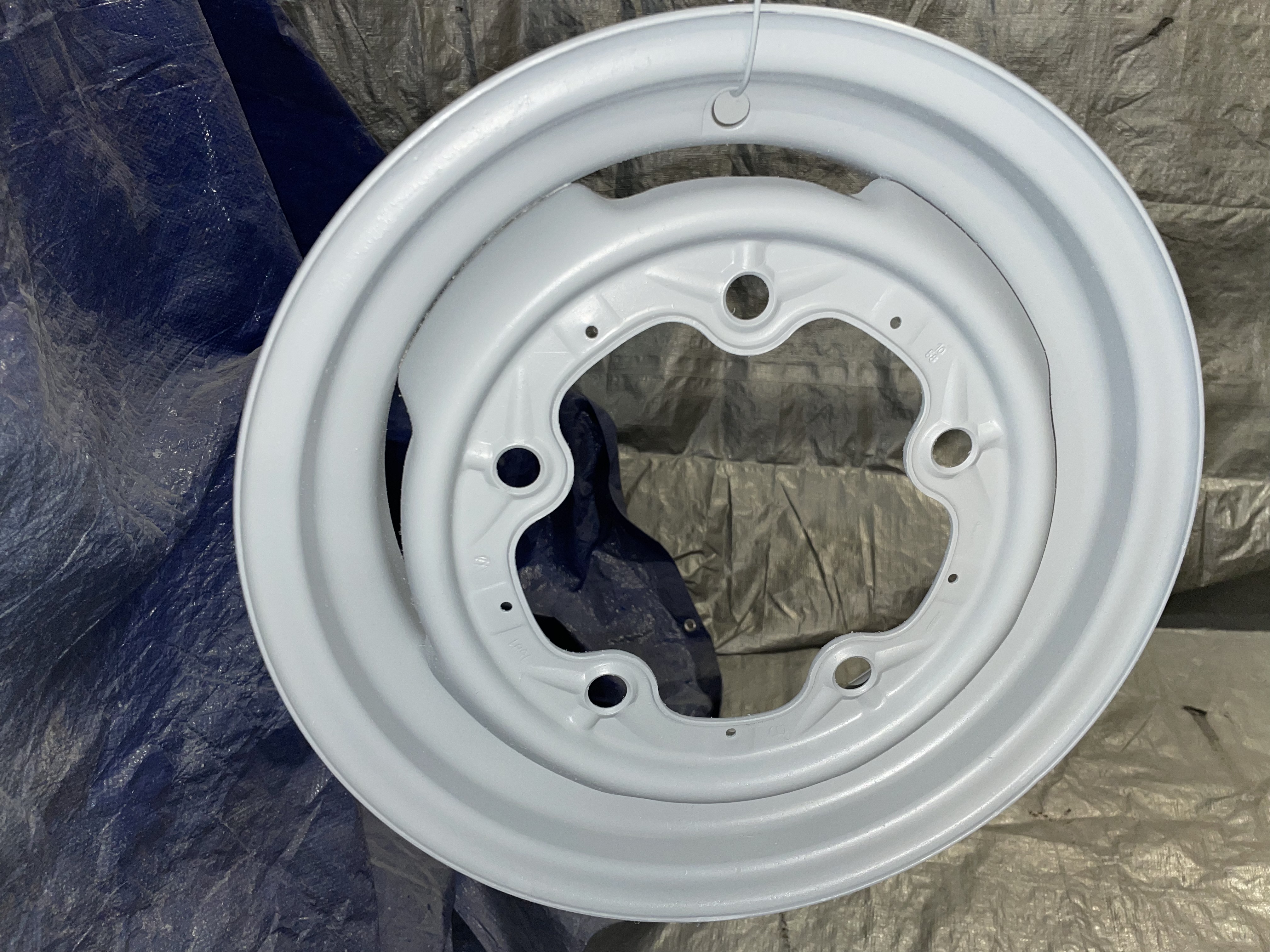

I prepped the wheels for paint by using some Fast Etch metal prep from Eastwood and then getting the wheels set up on my makeshift painting rack which happens to be a old ladder.
Ladder Line
Ladder Line
Im not a great automotive painter but I do my best. Sprayed on a few coats of primer. 2 of the wheels had some heavier pitting compared to the rest so I used a rattle can of high build primer I had to layer up a few coats and then sand back down to help fill some of the pitting. That helped smooth things out a little.
Ready for color
Ready for color
Next post should have some color!

Posted: Sat Mar 05, 2022 10:51 am
by TRL
So, wheels have been painted. A couple
oops here and there but the most importantly, I had a good time painting! Color on the front and back of the wheels. Black on the outer barrels where the tires will hide to somewhat mimic the factory paint job and to save some paint for a upcoming bumper project.
