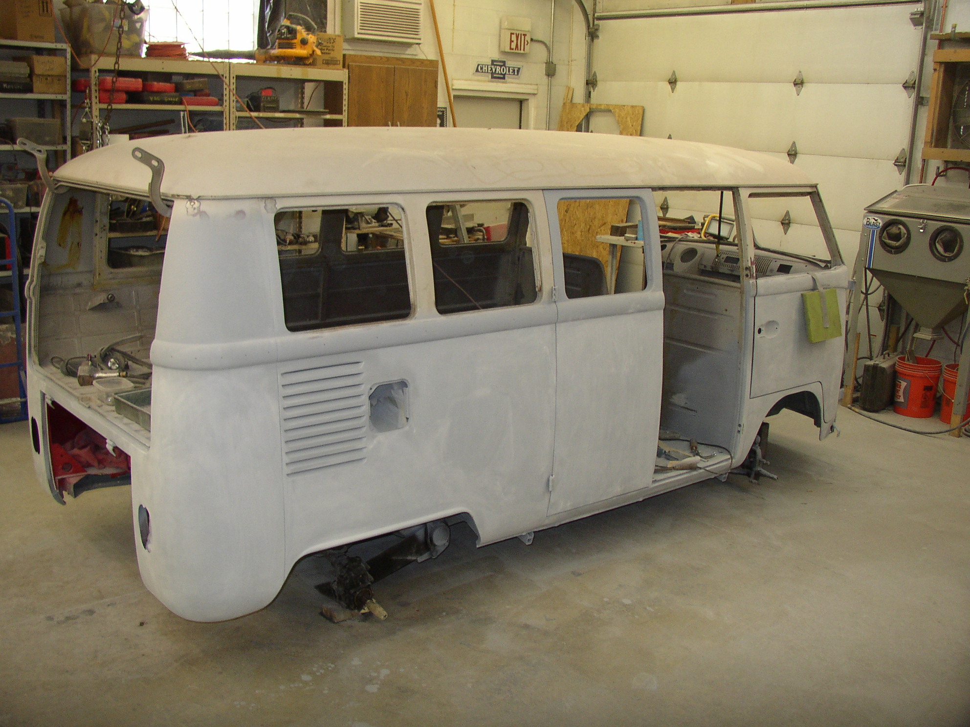

Worked a long day today and got a shitload done- dropped it down and started on the roof- DA'd the whole roof, wire wheeled the rain gutters, unwrinkled some wrinkles in the roof, and a few skim coats of mud. Also wirewheeled the side window openings. My f'ing arms hurt right now from handling that grinder (WW) for so long. That thing is a fighter......

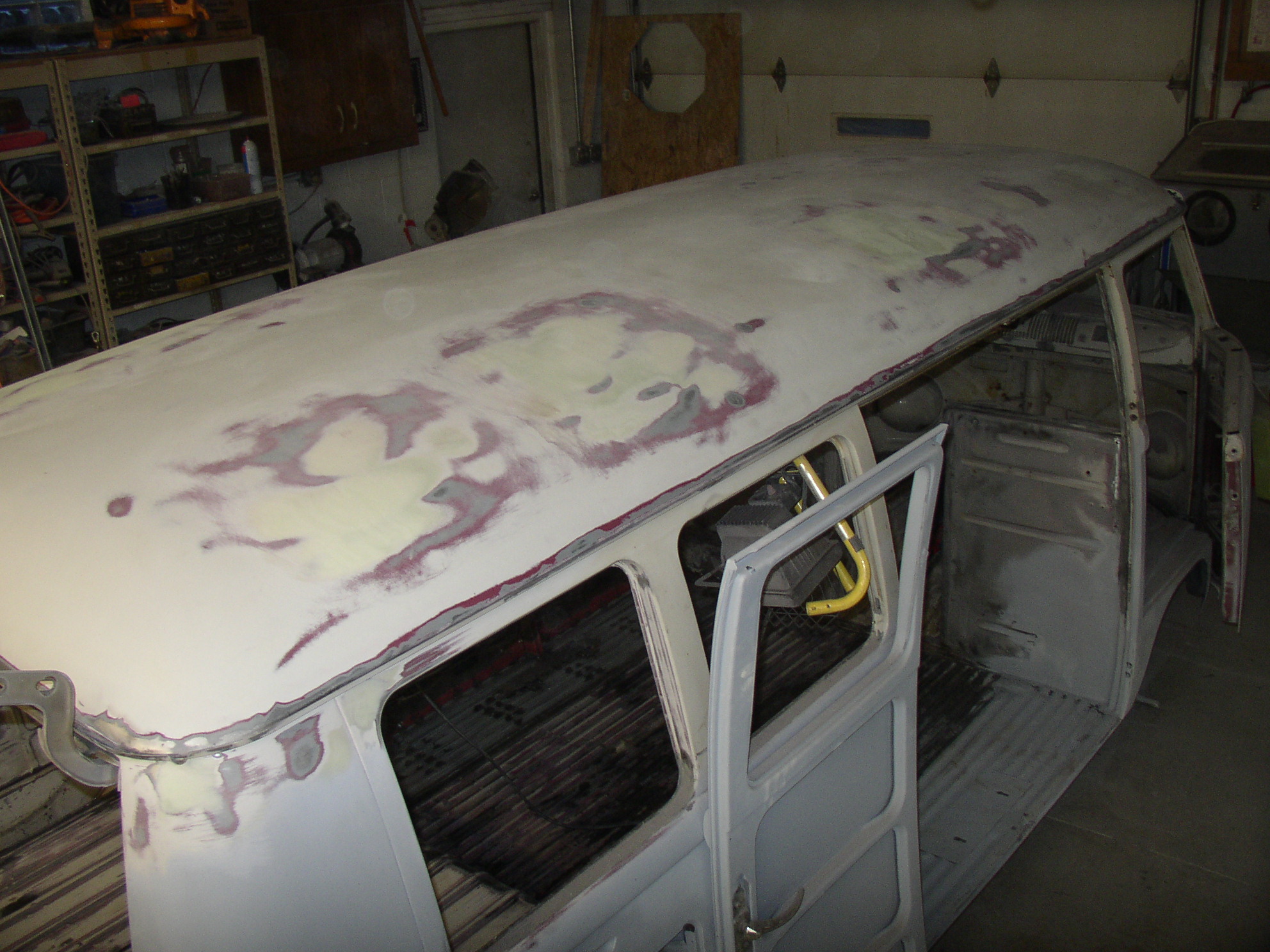

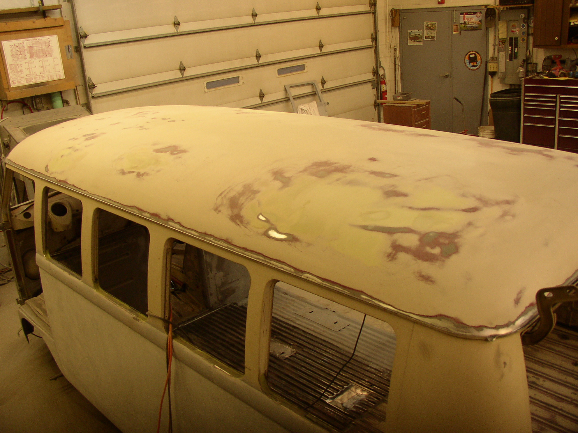

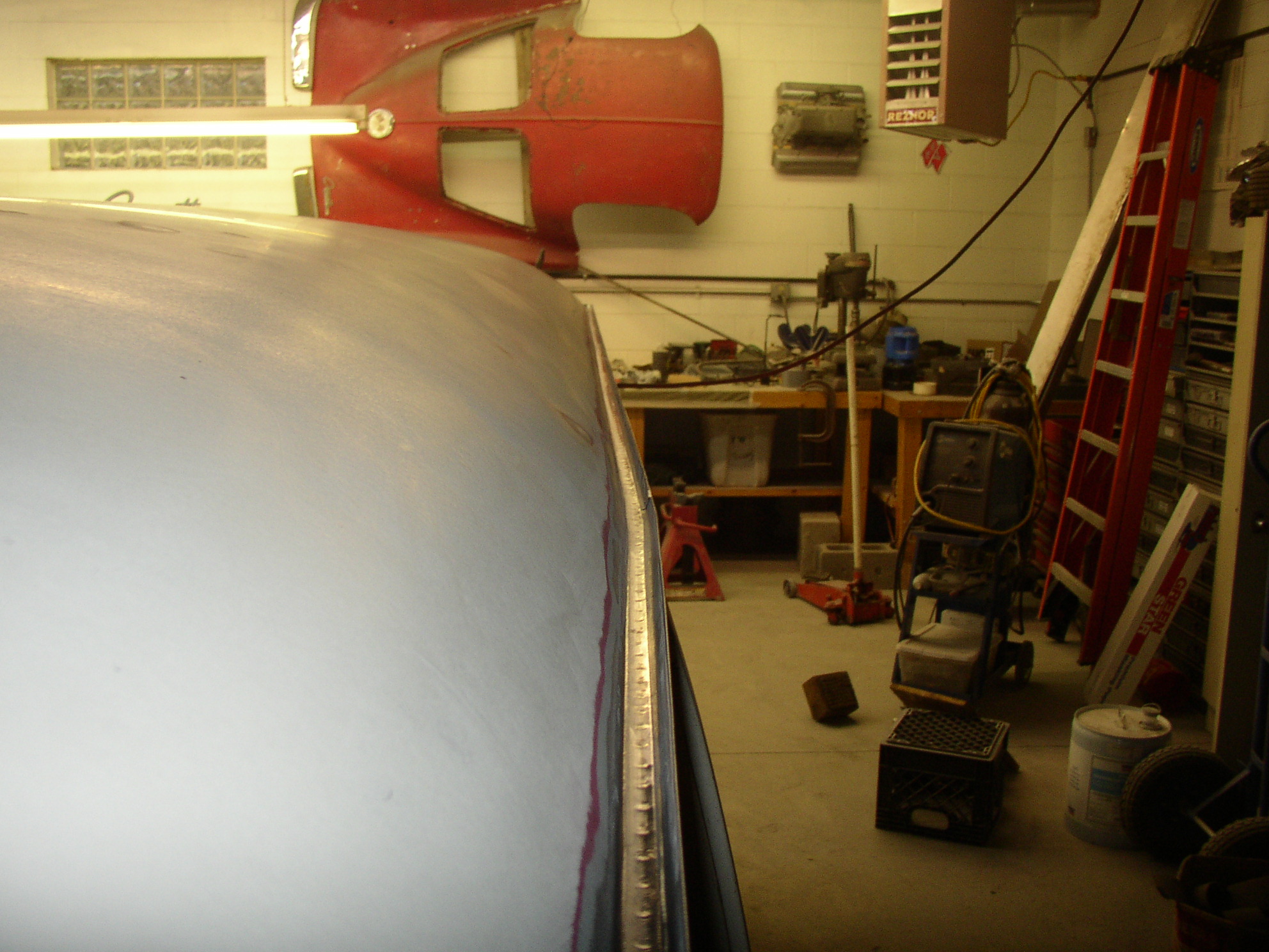

I don't normally work weekends on the bus but today was an exception. I got a lot done, wirewheeling the window openings, welding up a CB antennal hole in the roof,
DAing and started wirewheeling the inside of the window openings and inside the roof. The glue isn't so bad, this should only be a few hours tops.
There's different types of popout window latch mounts, does anyone know why?
And, why did one of mine tear out? (It's a forward window that opens backward, catching the wind, which might be why.)

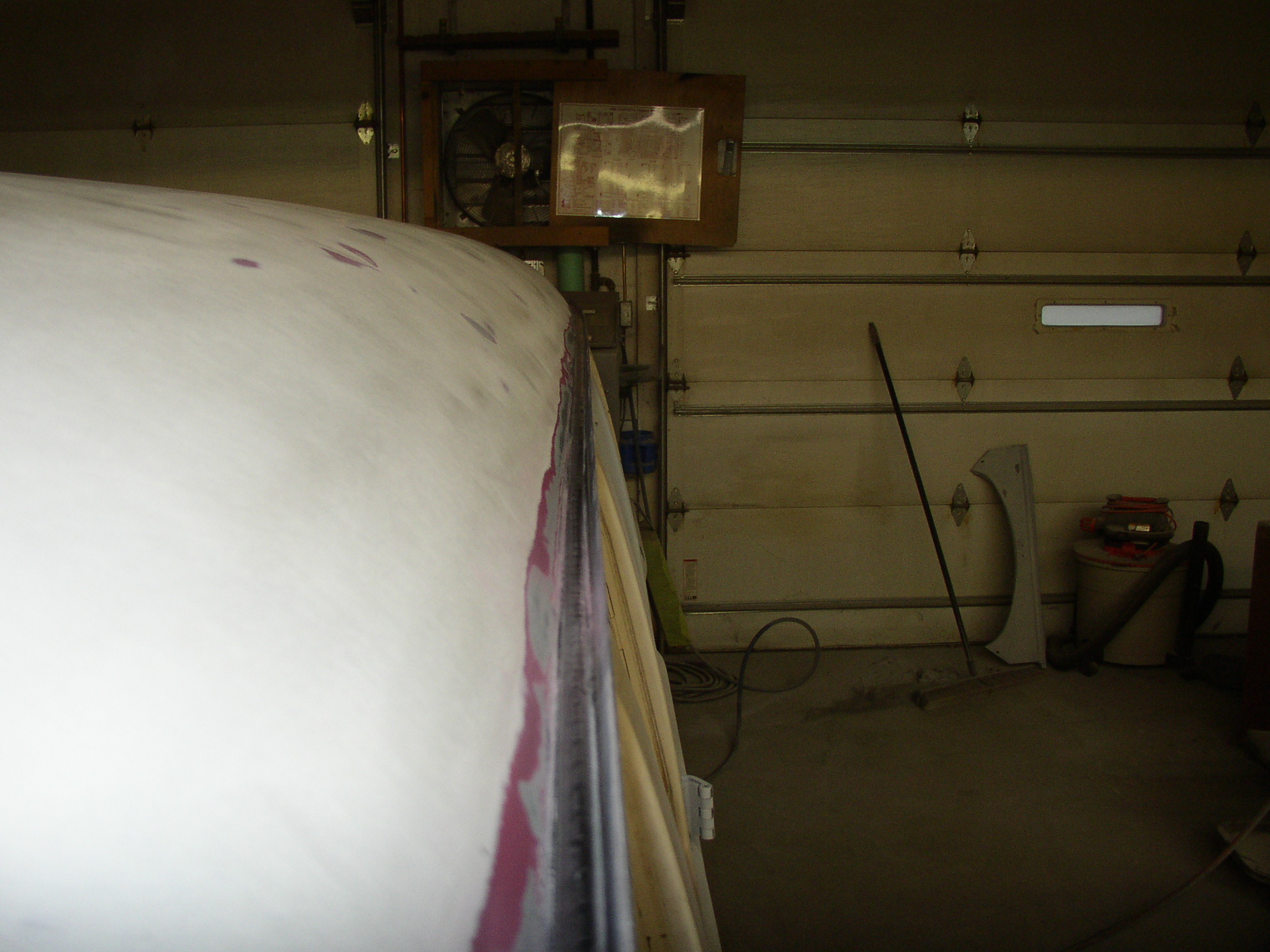

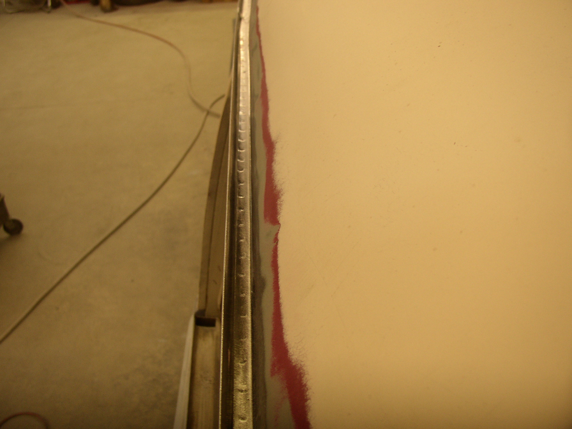

Here's a shot of the rain gutter after wirewheeling, this is one of the reasons I bought this bus. Pristine. Not even surface rust anywhere in the rain gutter and only a couple of insignificant surface spots anywhere on the roof at all.
Here we are at the end of the day after air filing the mud out a couple of times. Made good progress, the roof is just about ready for seam sealer and primer.
Anyone recommend an inexpensive seam sealer that sets up in a day or so? Many times the stuff I've used in the past takes weeks to harden. I know the body supply places have a two part that's like $40 or something, but that's kind of silly, I've heard of using a Home Depot product but I'm not sure which one.

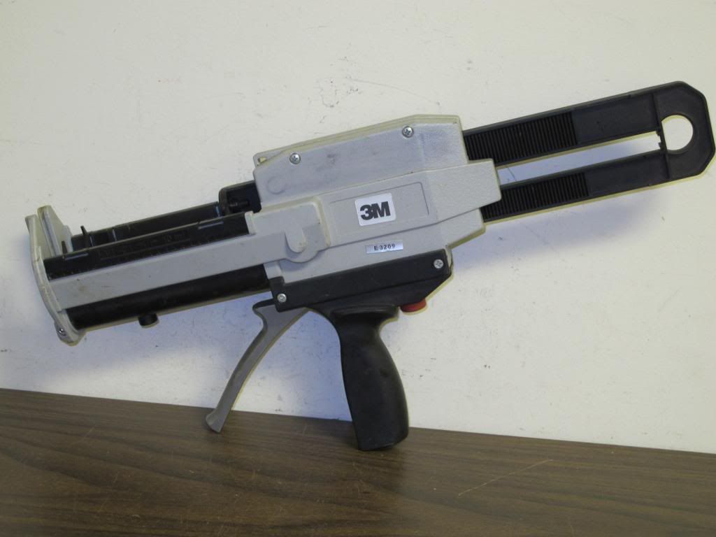

As for your seam sealer questions: most of today's one part sealers work fine, usually ok to paint within a few hours, and they lay down better and are easier to tool (wipe with your finger) than the 2-part types, that being said I do have a Mixpac gun if you opt for a 2-part product that isn't available in standard caulk tubes, most everything 3M or SEM make is top notch stuff.
