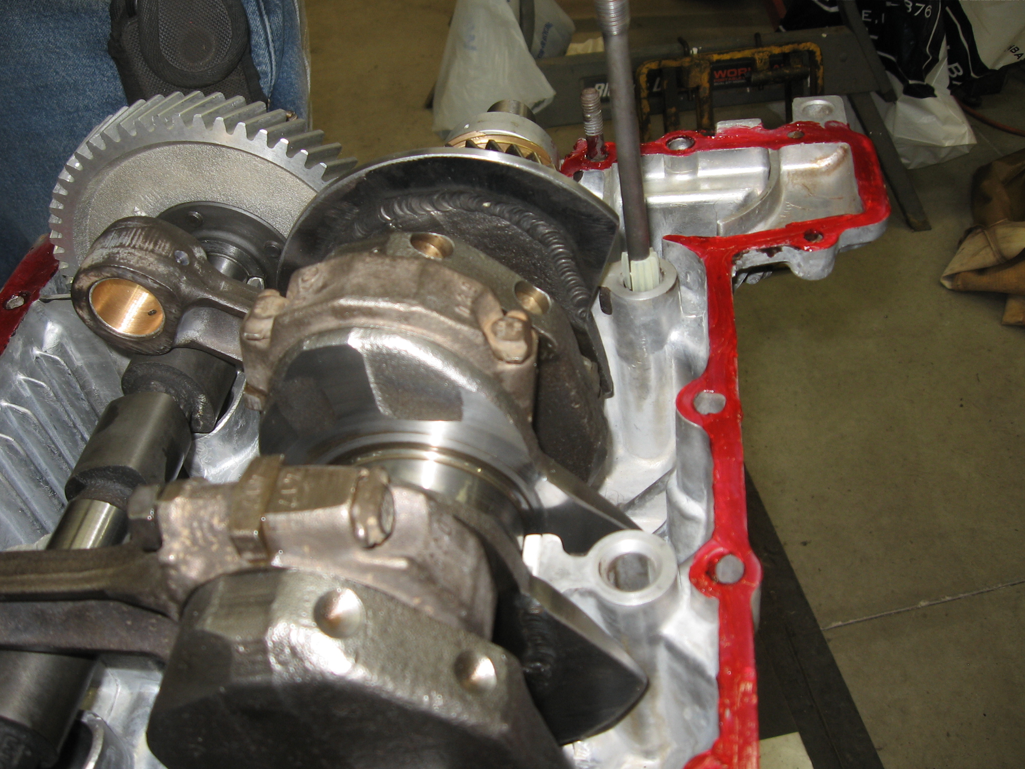

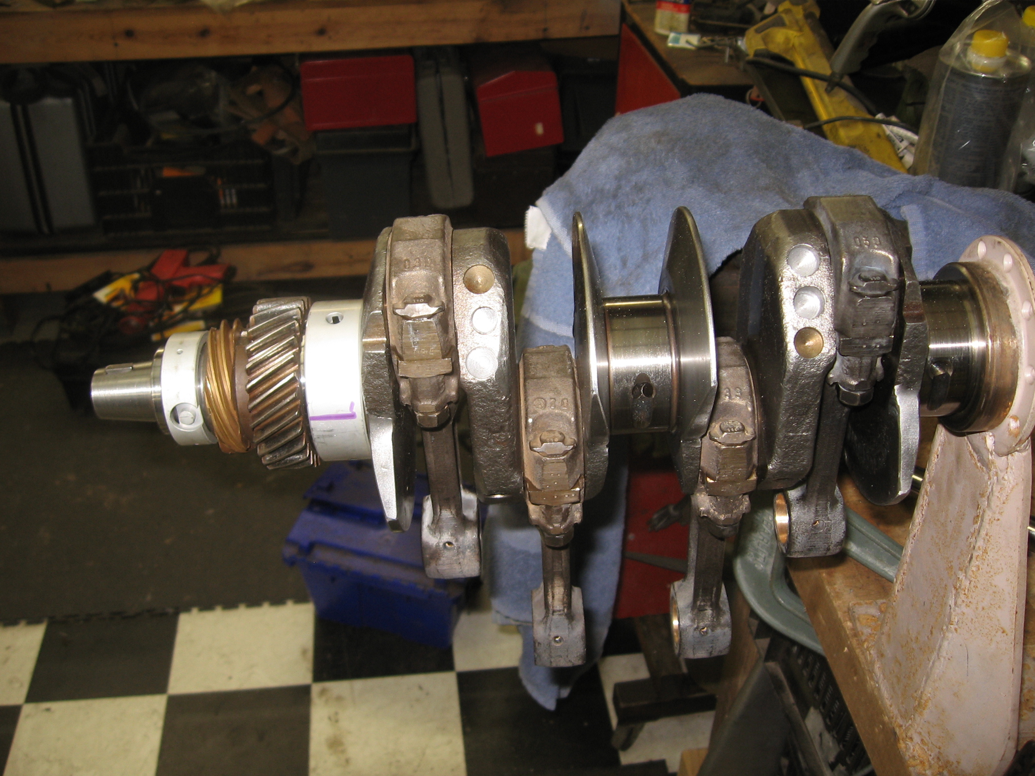

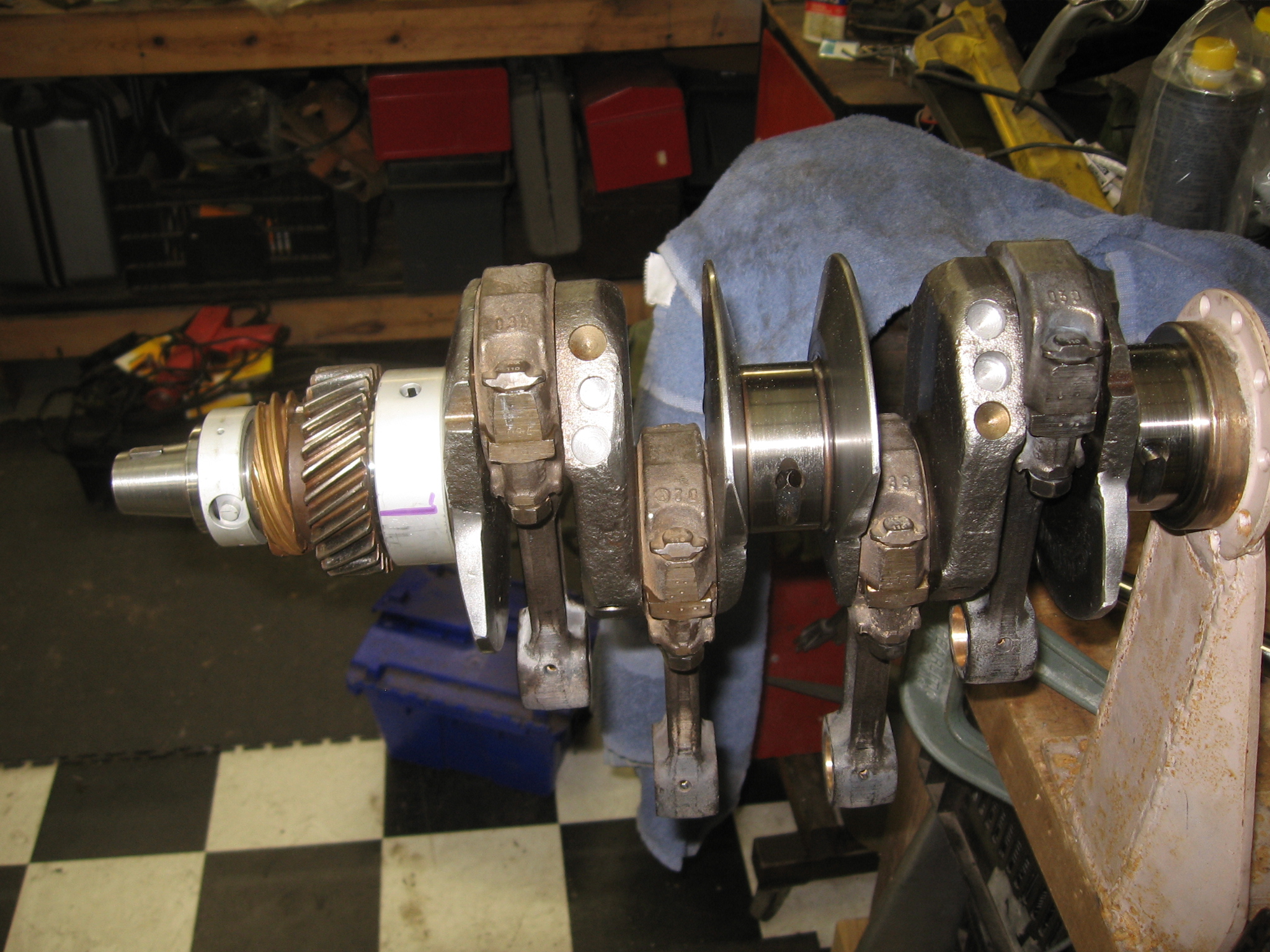

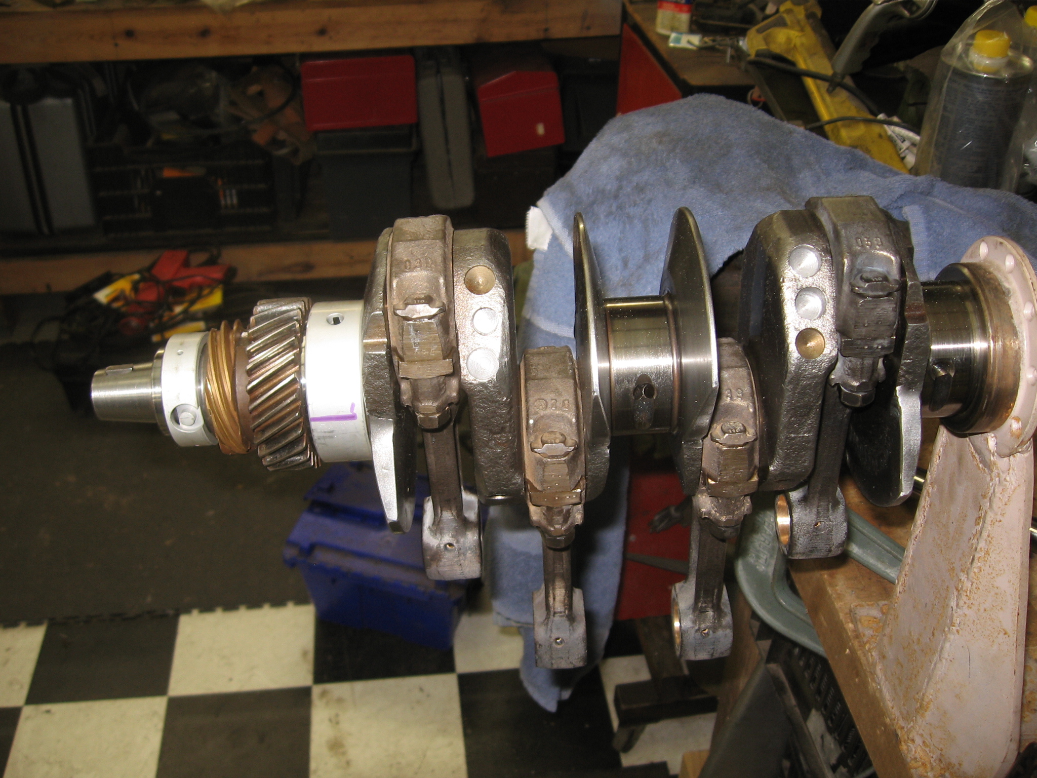

OK,here we go again. Now that we have the crank and case oil passages cleaned and the case,including the mating surfaces. It's time to build the crank assembly. Chuck stopped by one day last week and when I turned my back,they had the crank built up.
T 4 crank build is the same as T 1 whith 2 exceptions. No oil slinger on the end of the crank and the rods are symetrical ie,there is no up and down. We put the rods on with the numbers on the cap and rod up,for no particular reason.
Bruce's crank build shows the pics That I missed.http://www.leakoil.net/forum/viewtopic.php?f=23&t=4227

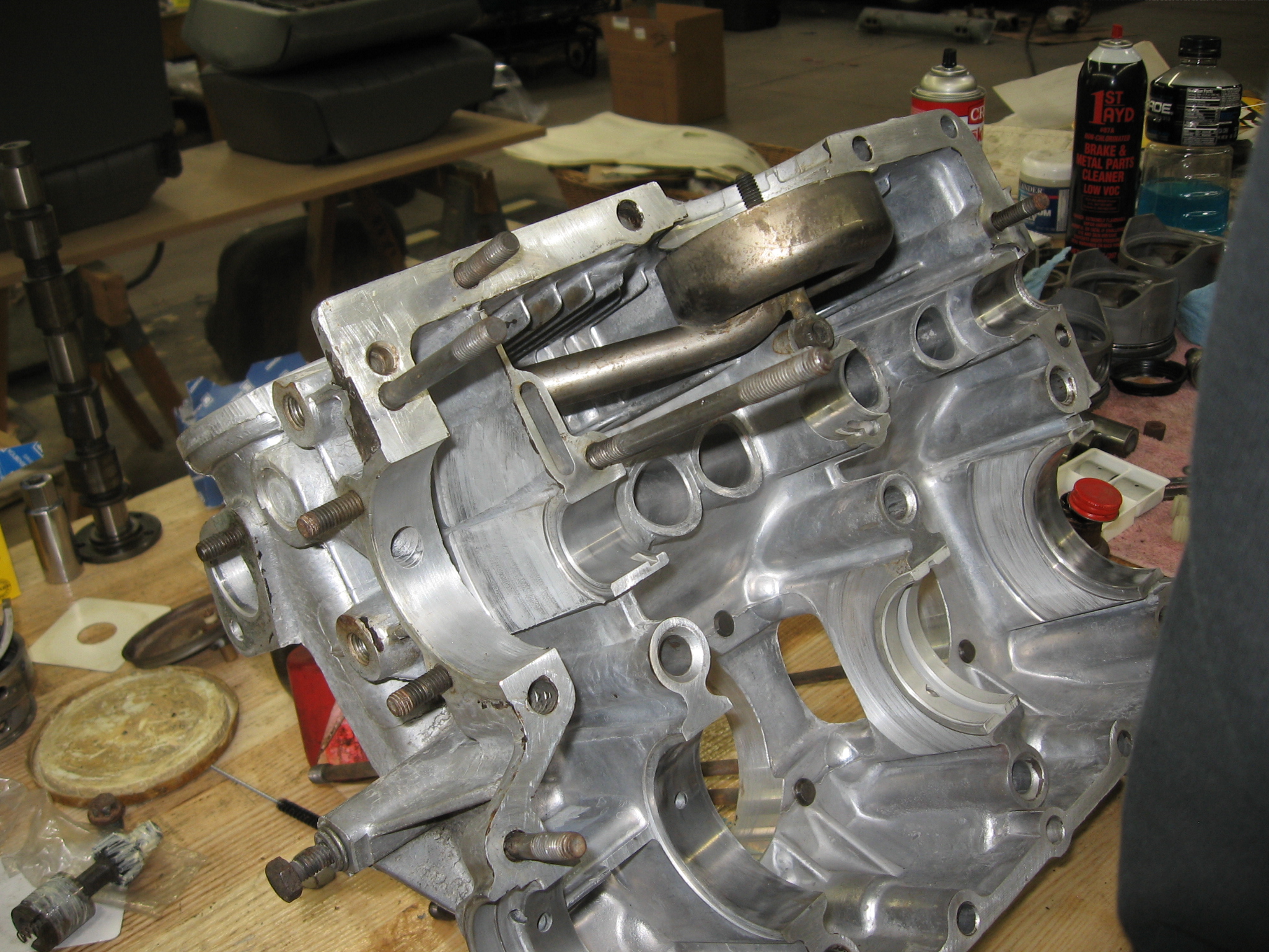

We did set the crank bearings in the case halves and seated them on the dowels,then marked the center line. This makes it much easier to position the bearings when setting the crank in the case half and considerably lessens the chance of missing the dowel and ruining a bearing. This was done on all 3 main bearings that install on the crank.

Crank installed in left case half and ready to install cam bearings.
Rotate the crank assembly several times to make sure there are no clearance problems.

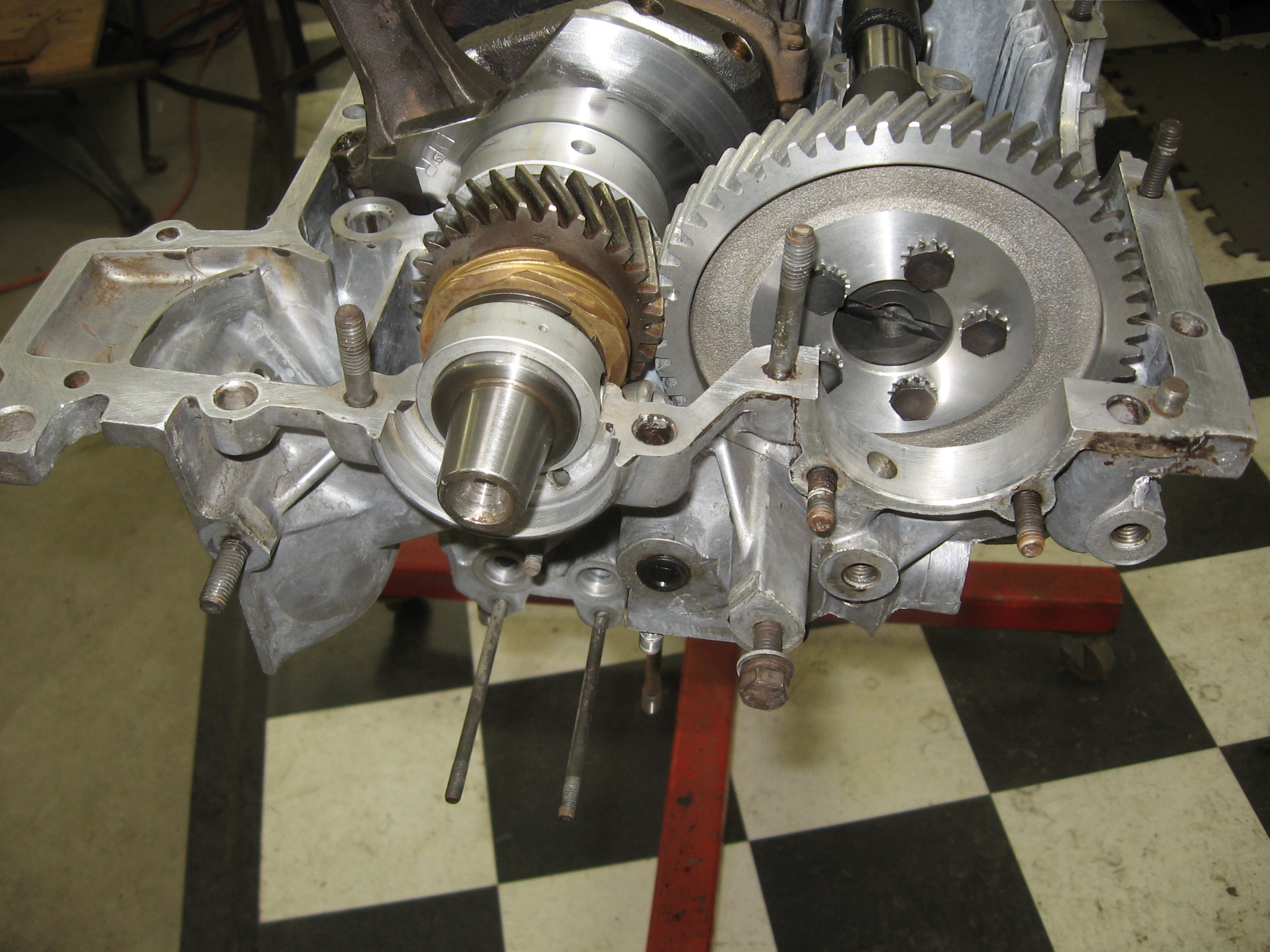

Now it's time to install the cam,aligning the timing marks.

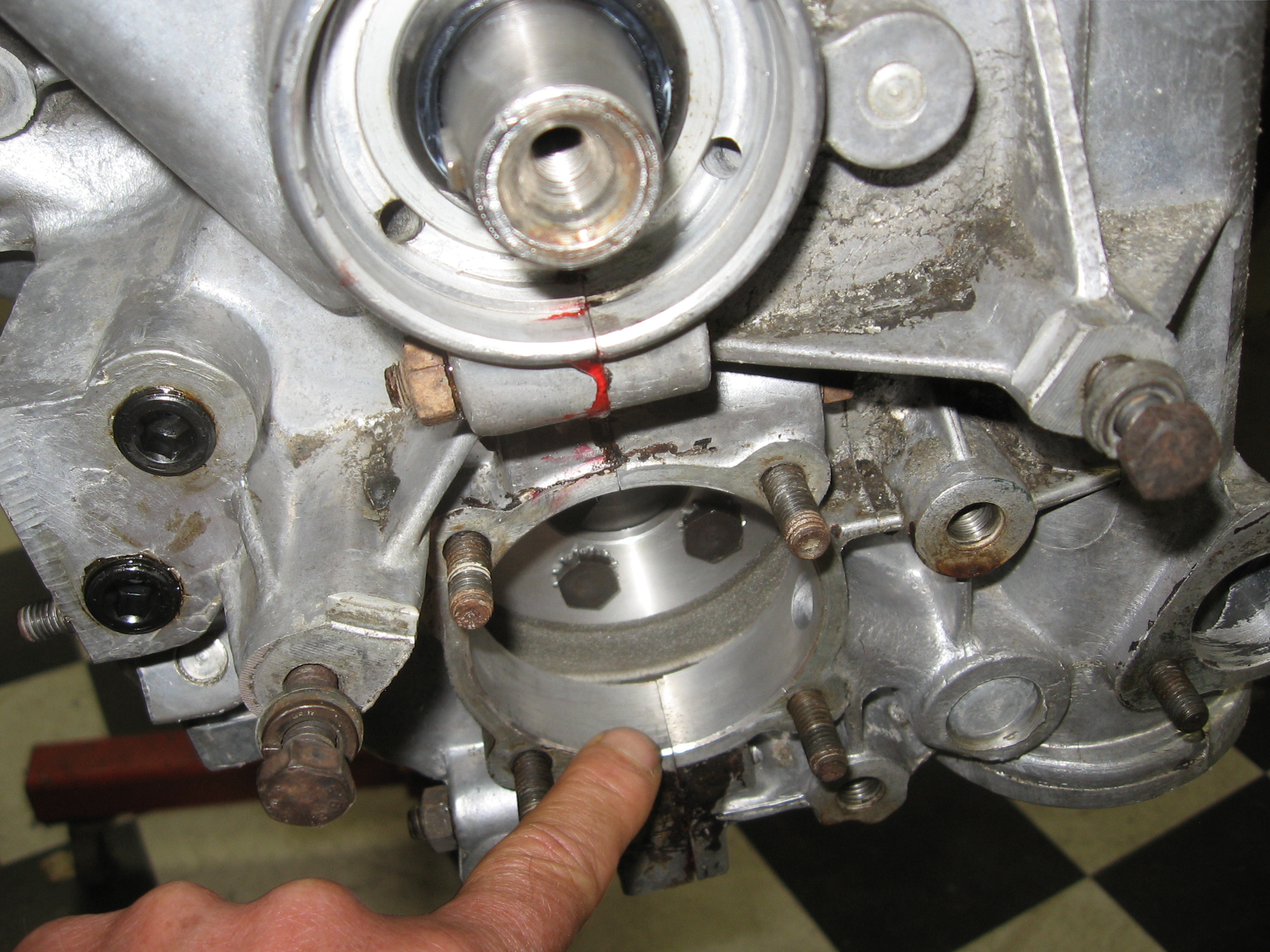

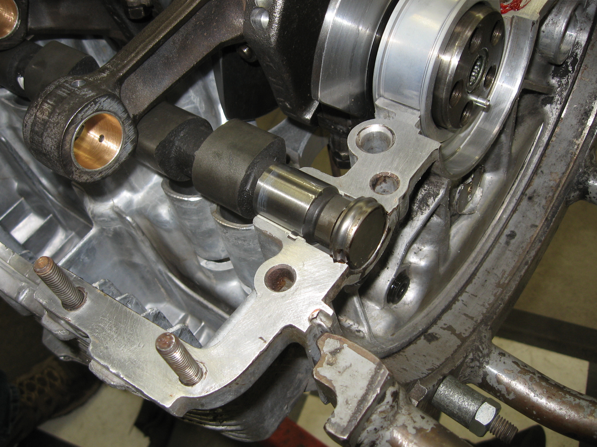

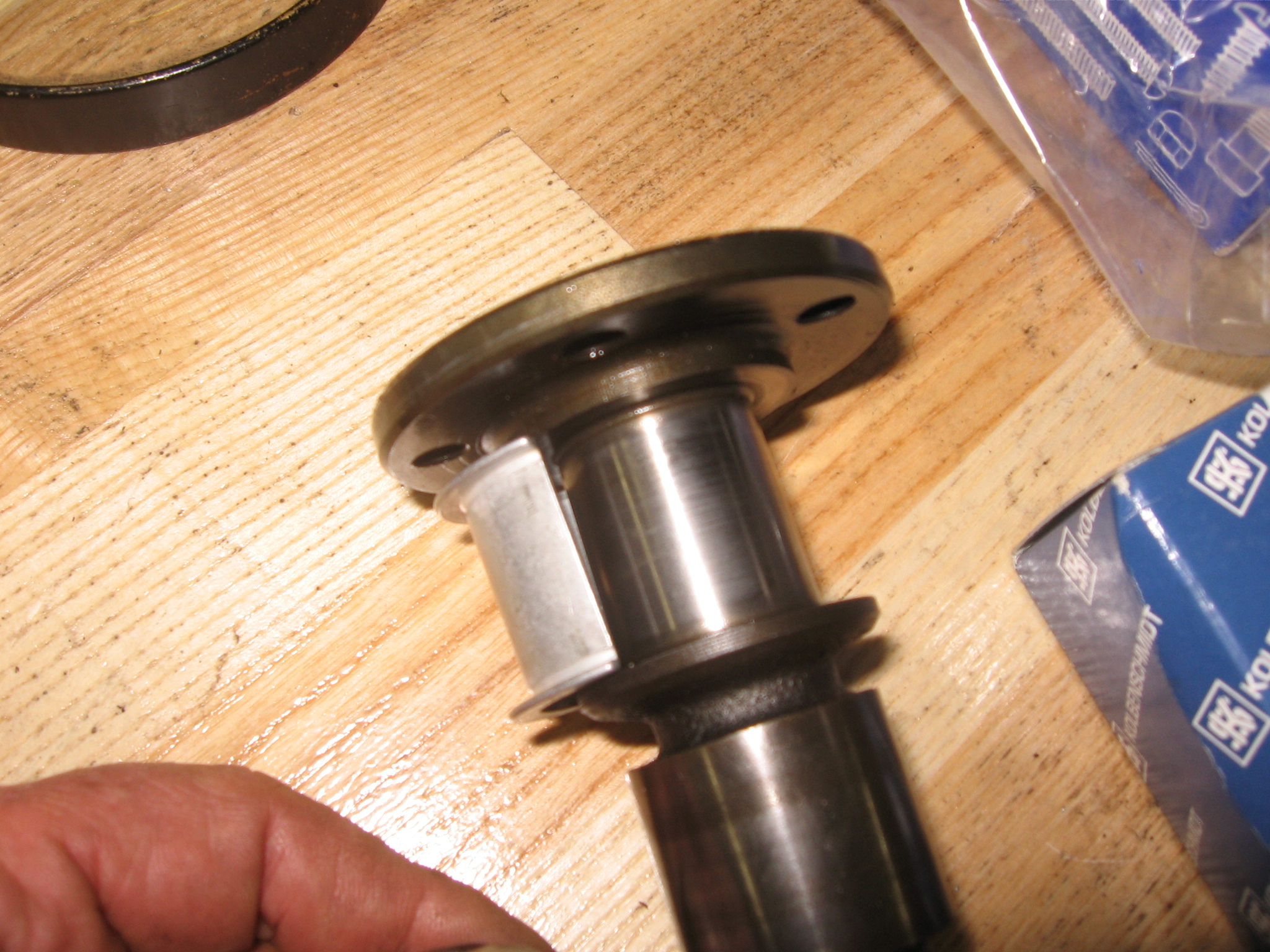

This is where we ran into a small problem. The cam would not set down in the bearing at the gear end. This is why.
The outer diameter of the thrust bearing was about 1mm too wide,not allowing the cam to set down.
This was a Kolbenschmidt (Brazil) bearing. I had a German set in my stash,so,we could continue.
Like Art Brow used to say "I know it's a new part,but is it any good?" DON'T ASSUME THAT ANY PART IS CORRECT

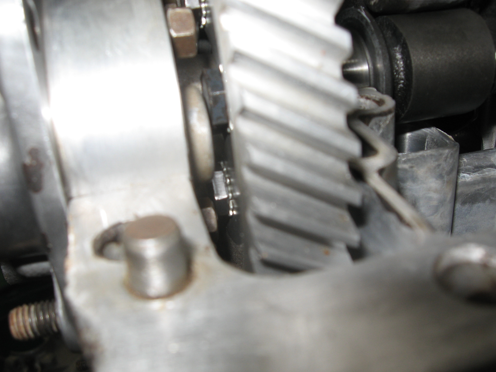

Since we re used the cam gear and bolts from the cam that was in the motor on the new cam,we were fairly certain that there would be no problem. It is close,but no clearance issue.

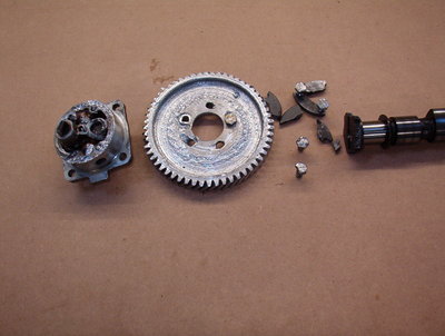

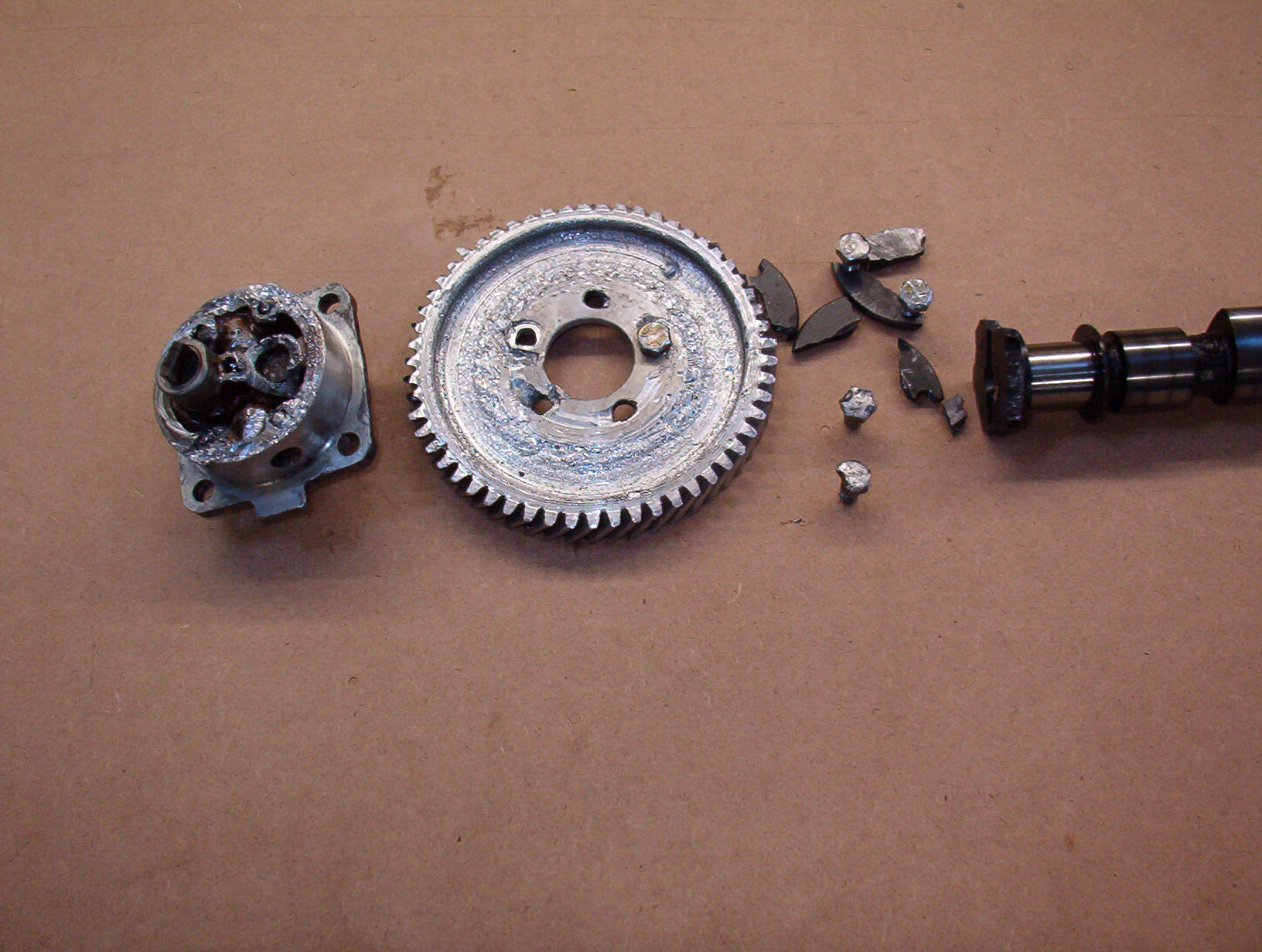

Just a note here. ALL replacement cams come with bolt on gears. Most all replacement oil pumps will have clearance issues with the cam bolts and the pump. Note the low profile heads on the cam bolts. If you do not check this clearance,THIS WILL HAPPEN.

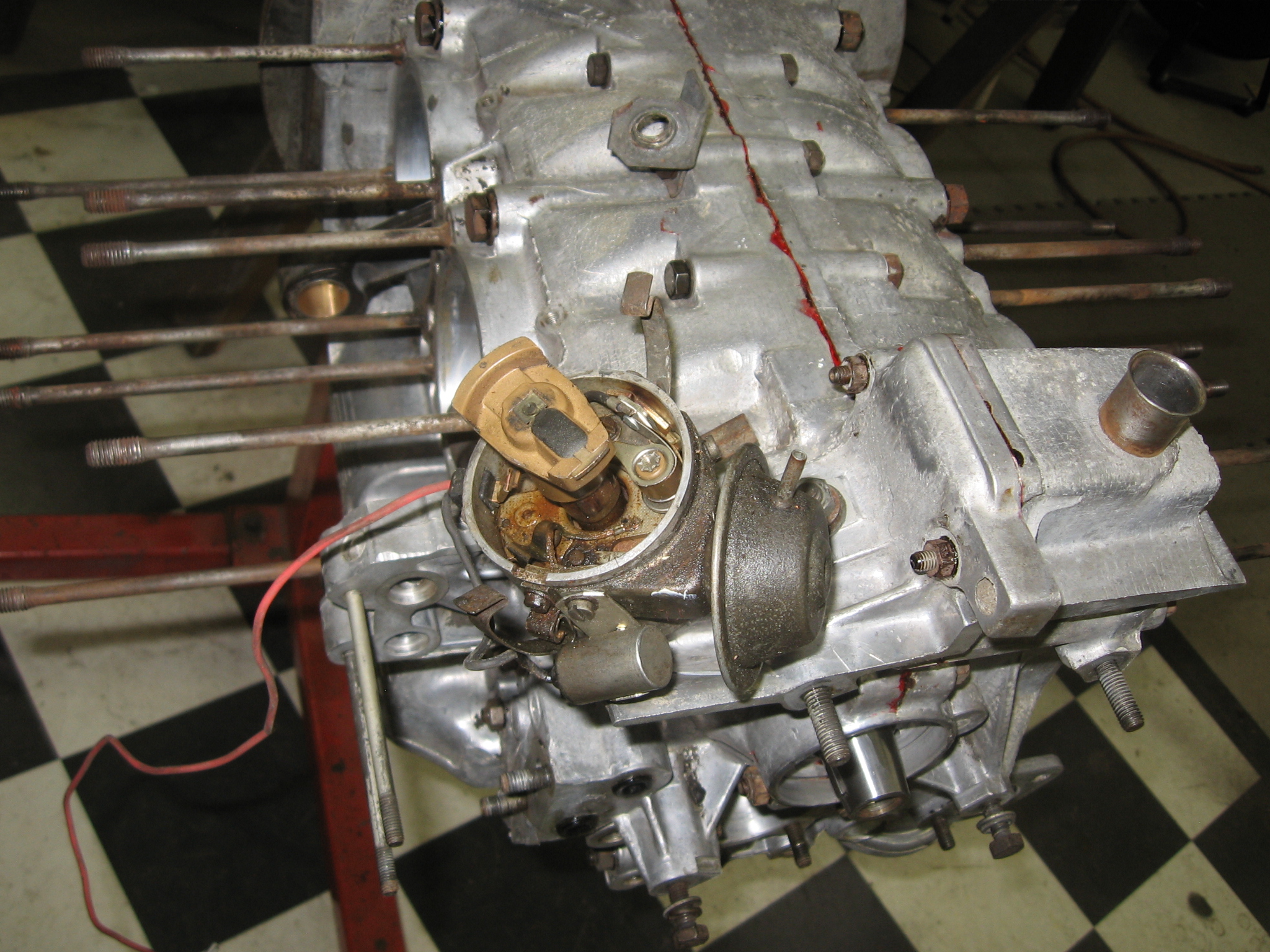

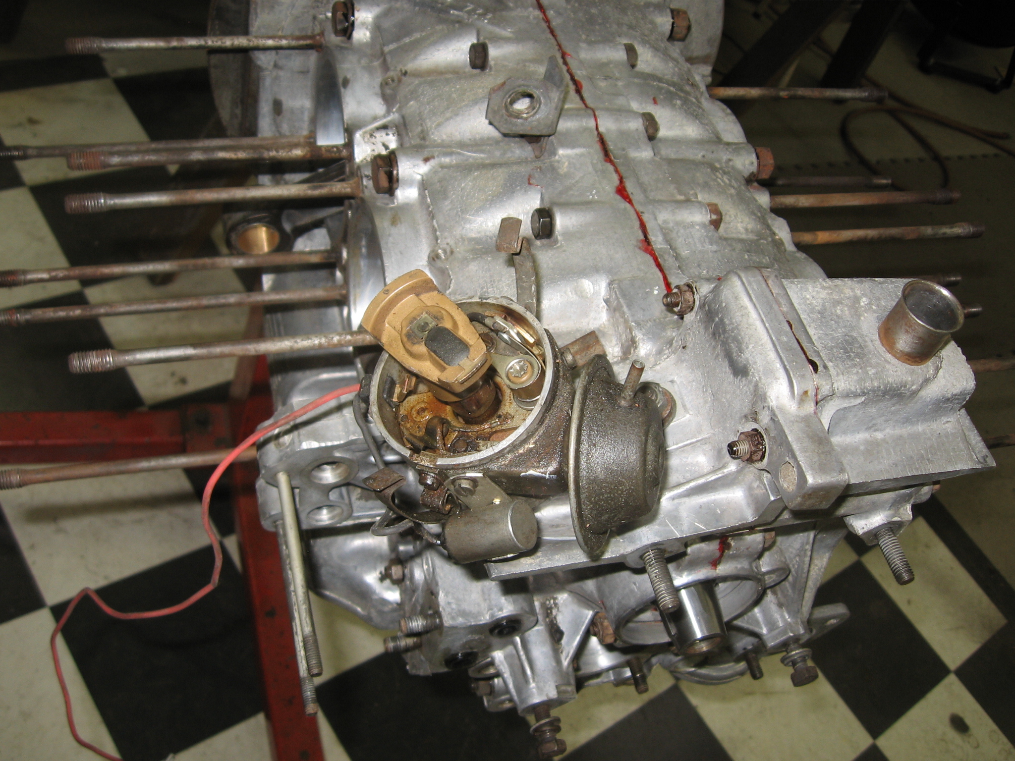

Now that we know that we can rotate the innards with no binding,we can go about sticking the 2 cse haves together.

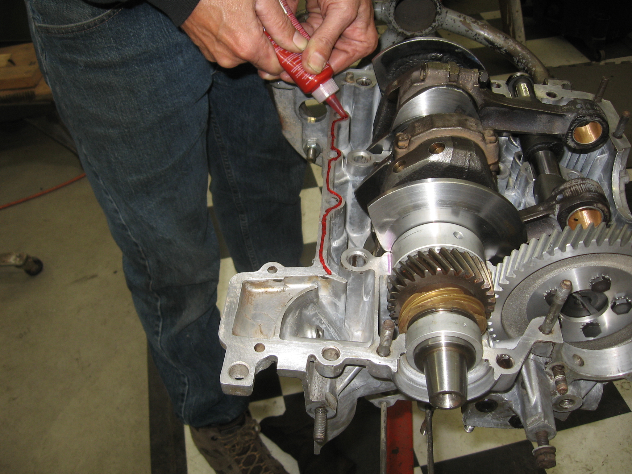

I have used several different sealers for this and they all work. I have used Locktite 518 the last several times and so does Chuck.
a thin bead,then smear it with your finger.
Don't forget the cam plug. concave side faces the cam on all engines except T1 auto stick. we used permatex 3H around the outside of the cam plug.

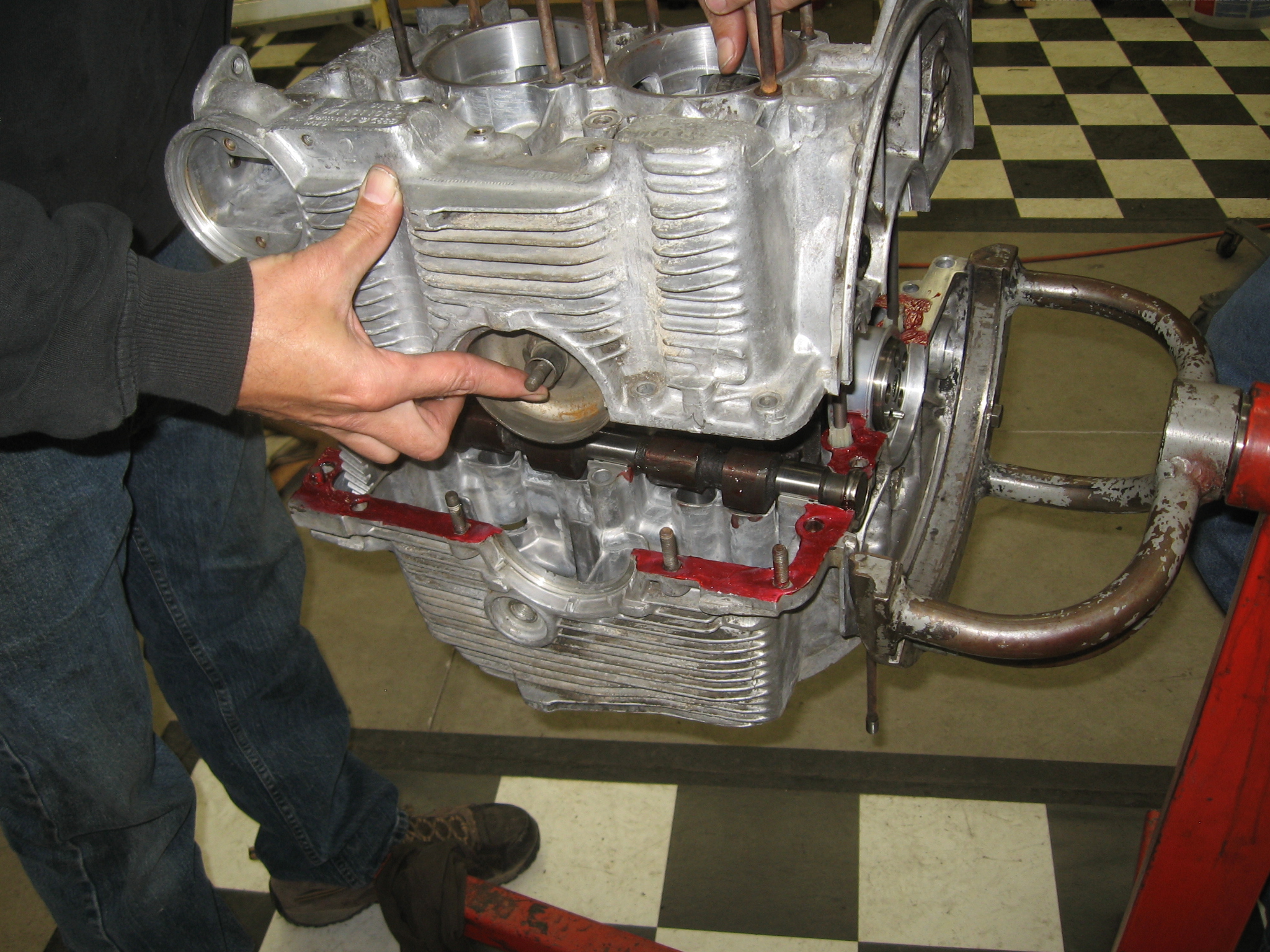

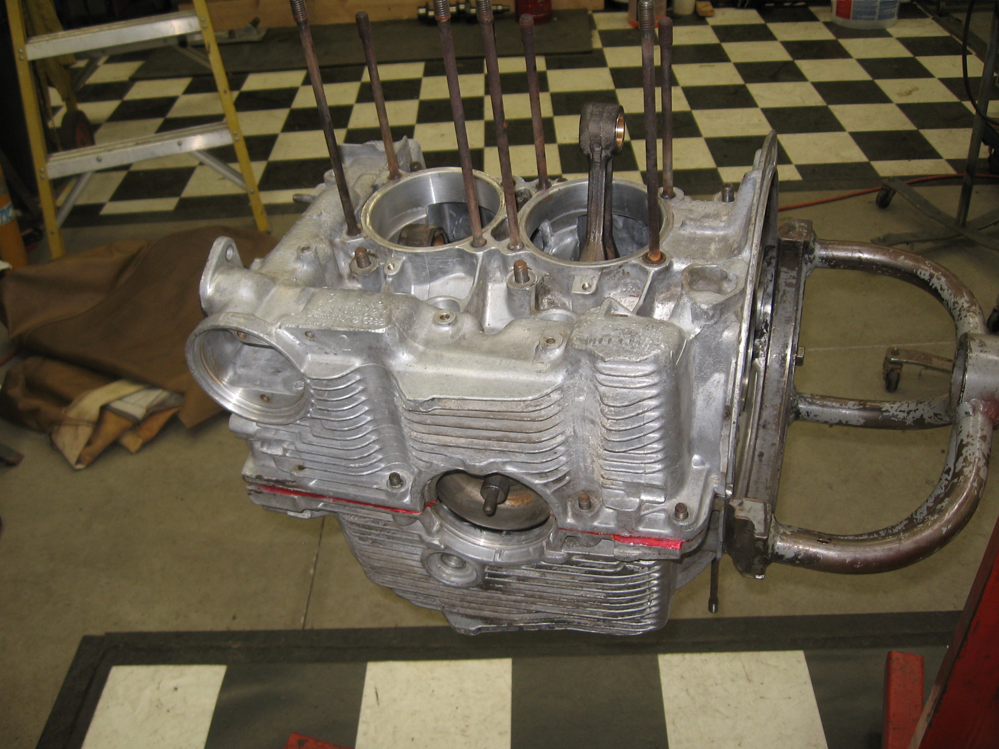

Set the right case half over the studs.

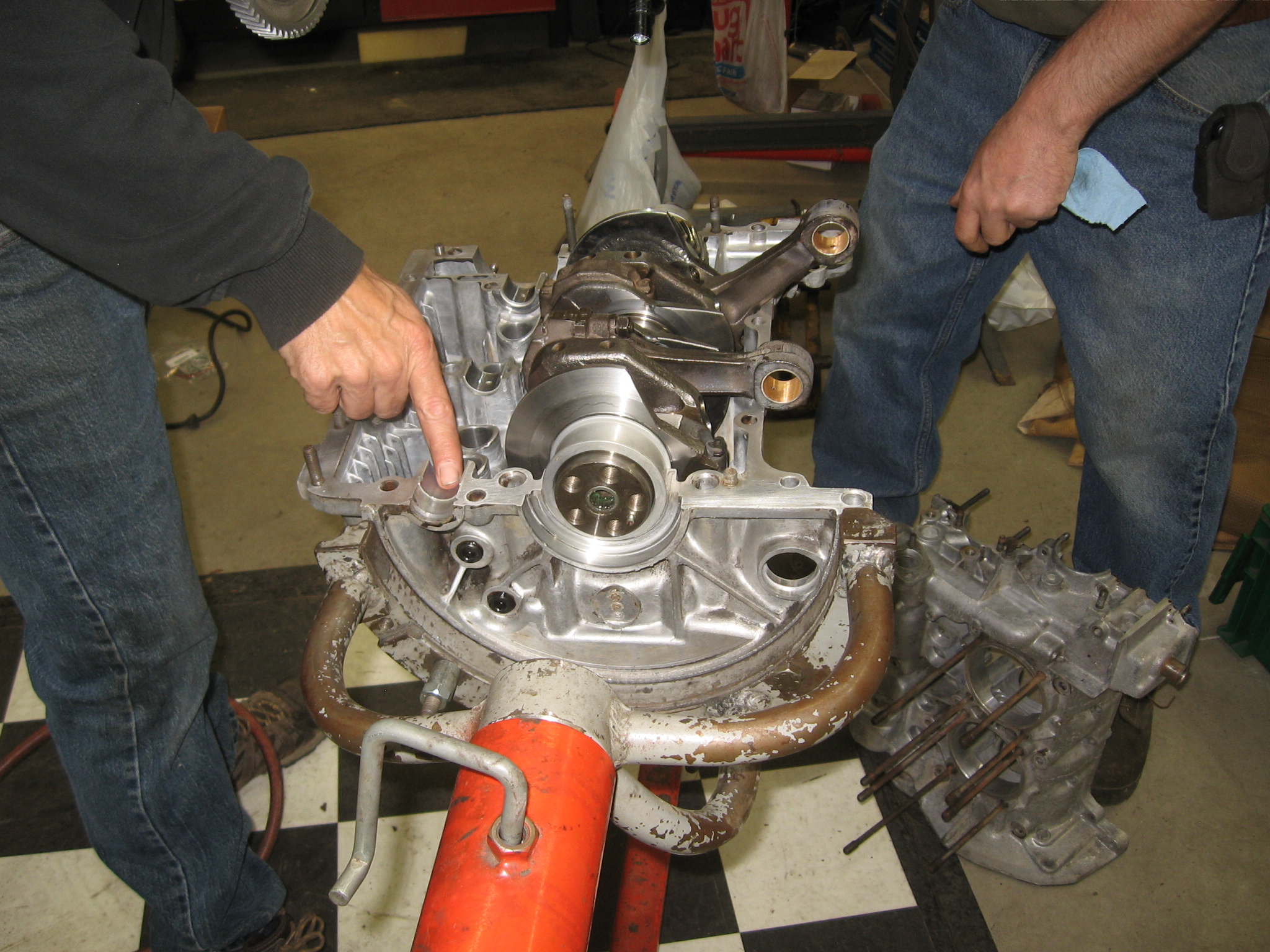

There are 20 case bolts on the T4 motor along with washers.Three of them are easy to overlook.1 at the bottom front in the bell housing area,1 in the deep recess on the bottom,this is the 71mm one that holds the oil pick up,and one below the oil cooler in the left case half. the 6 main ones around the crank get torqued first ,from the center out.
It is best to give the engine a few revolutions at this time,to make sure there is no binding. Then the rest of the case hardware on the outer sides of the case. Wipe any excess sealer from the crank seal holes on both ends of the case. Also around the sump cover area and the oil pump area.

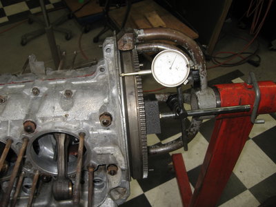

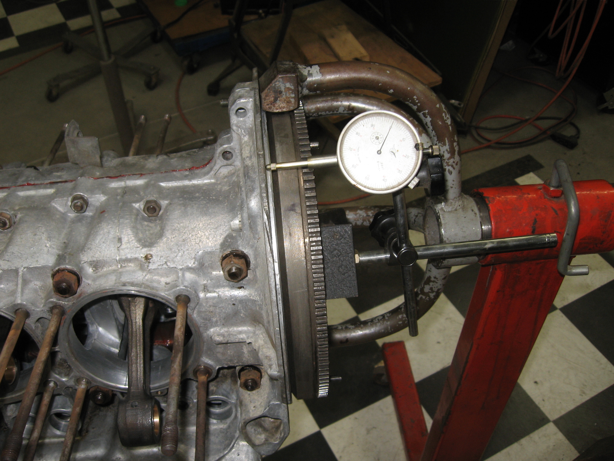

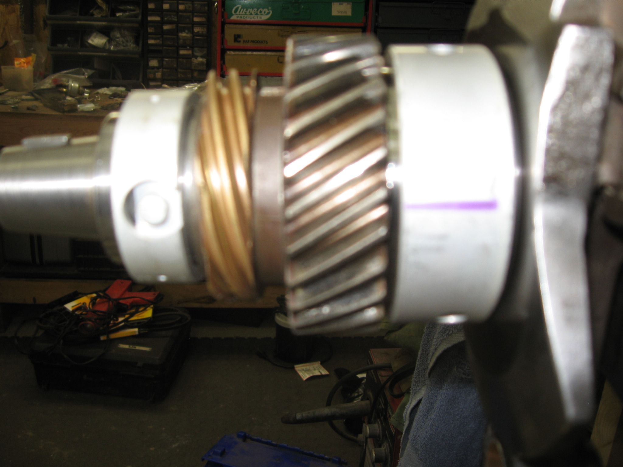

Before we install the flywheel seal,it's time to check the end play.
spec is .003-.005 We were at .005. Good to go.

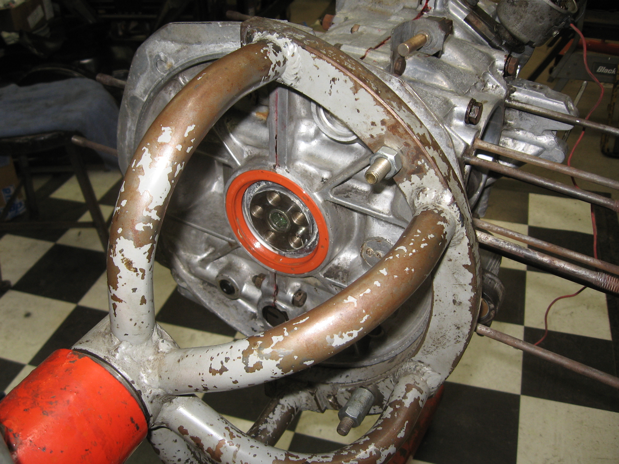

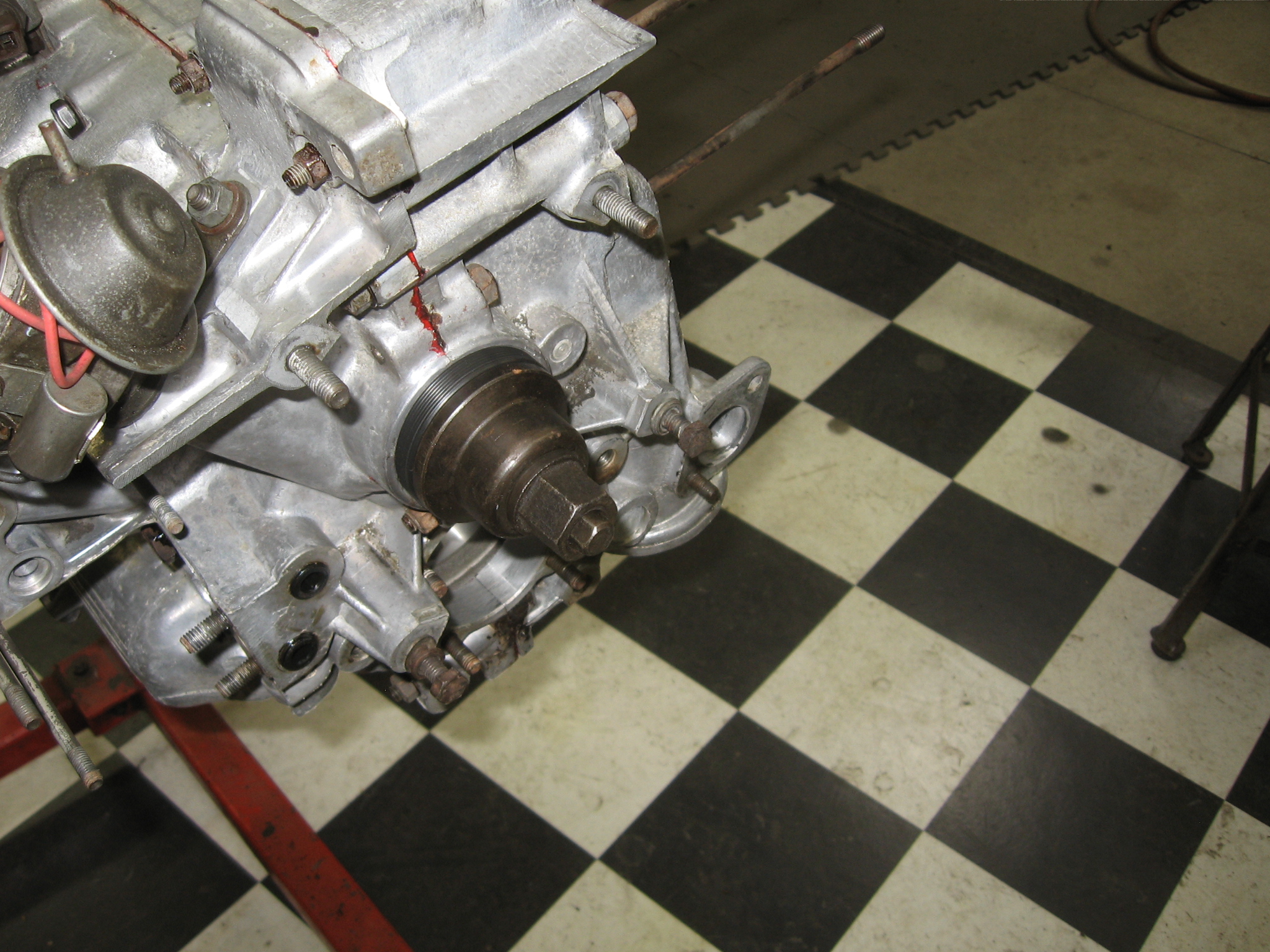

Install the front and rear crank seals. (T4 has one on the fan end also.)
Put a little lubricant around the inside of the seals,install the oil pump. Installing the flywheel now makes it easier to turn the engine over for the installation of the pistons.

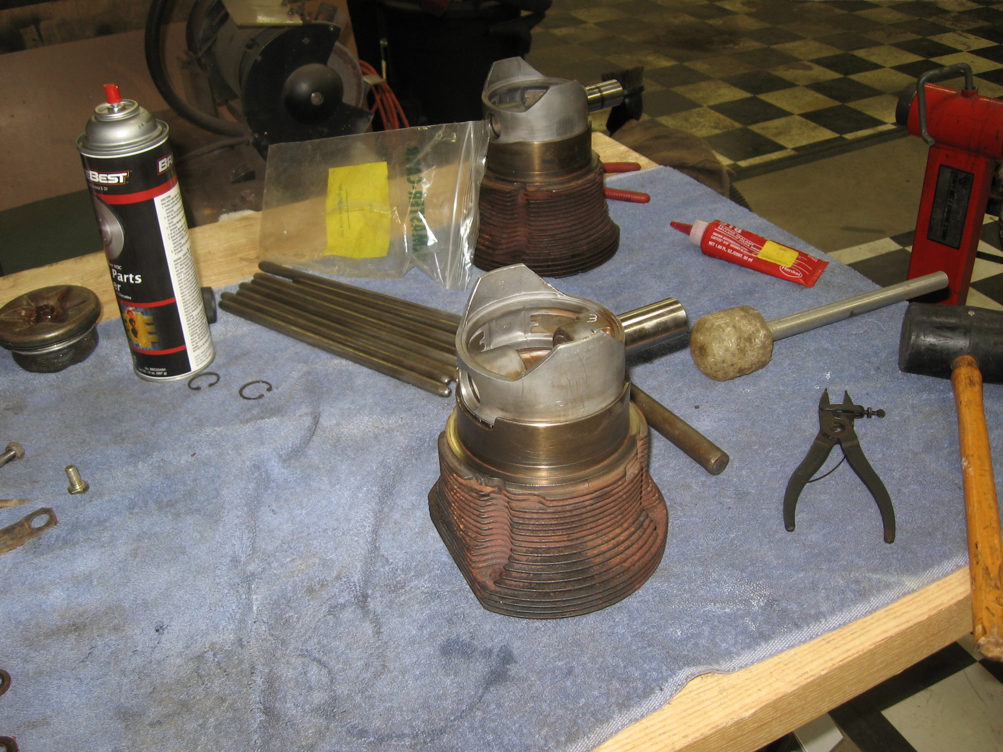

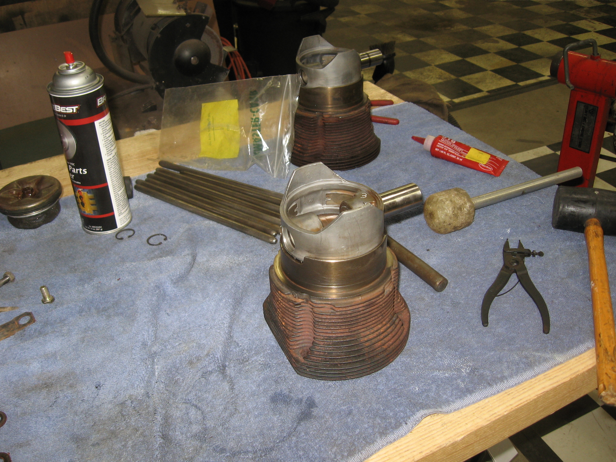

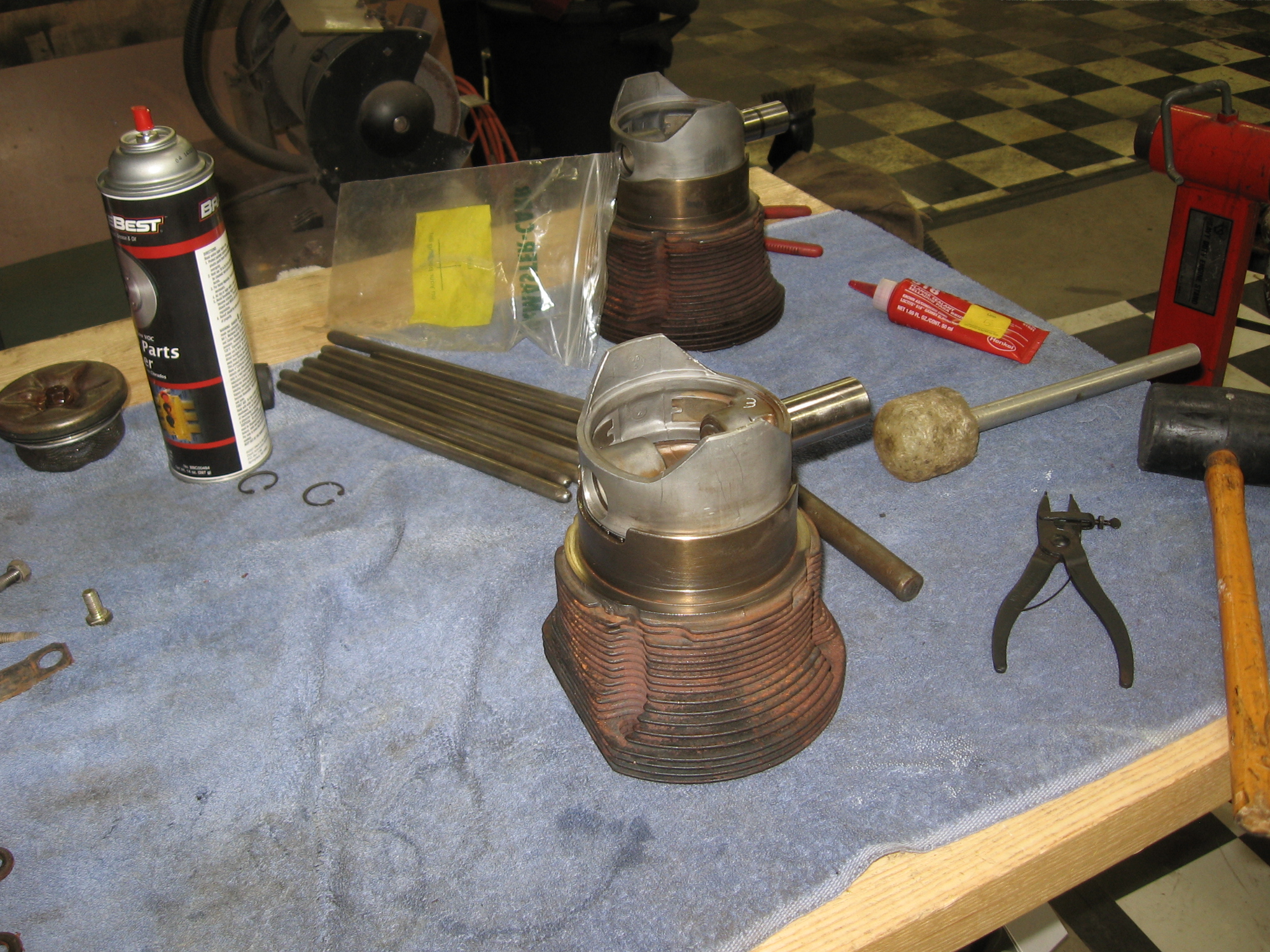

Now it's time to prep the pistons. Don't be temped to skip this part.even if you bought new P&C's. these parts are coated with oil to keep them from rusting while waiting for you to buy them. This oil probably collected some dirt since manufacture,plus your rings may never seat. Take the pistons out of the cylinders and remove the rings and pins. Keep the rings in order as the middle and top can look similar. Clean the hell out of them. soap and water and brake cleaner.

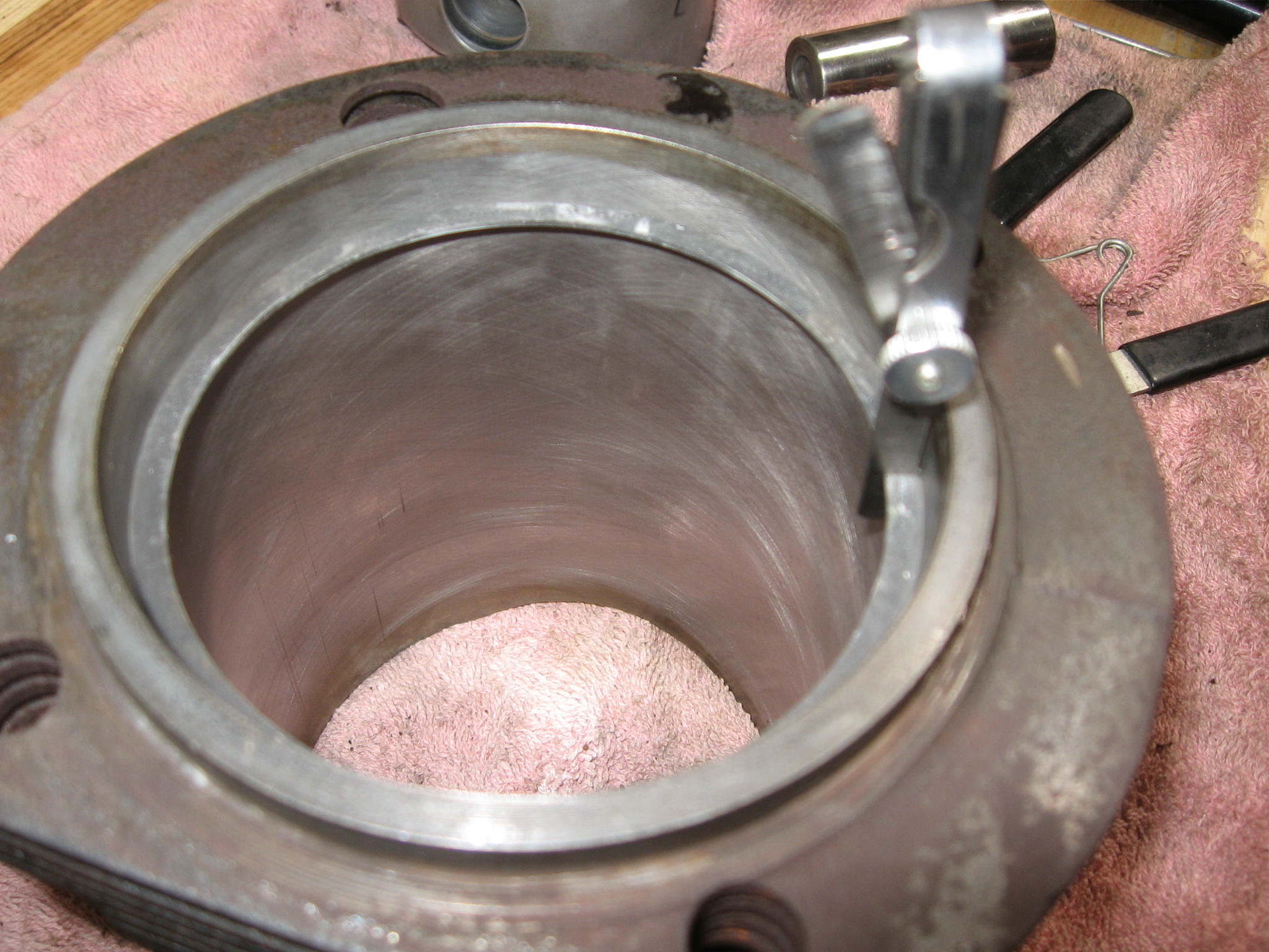

We are using the pistons and cylinders that were in the engine. the cylinders were honed,pistons soda blasted, and we are installing new rings. Grant rings on the Mahle pistons. Clean the ring grooves. A old piston ring works well (break it to get into the grooves). Spray the grooves with break cleaner.
Now we are going to check the ring gap. Nor a bad idea to do this even with NEW pistons,remember,we have been seeing incorrect or bad parts even from "NAME" manufactures.
Install the top ring in the cylinder and square it using the piston to push it down.
spec is .014-.022 we are at .015

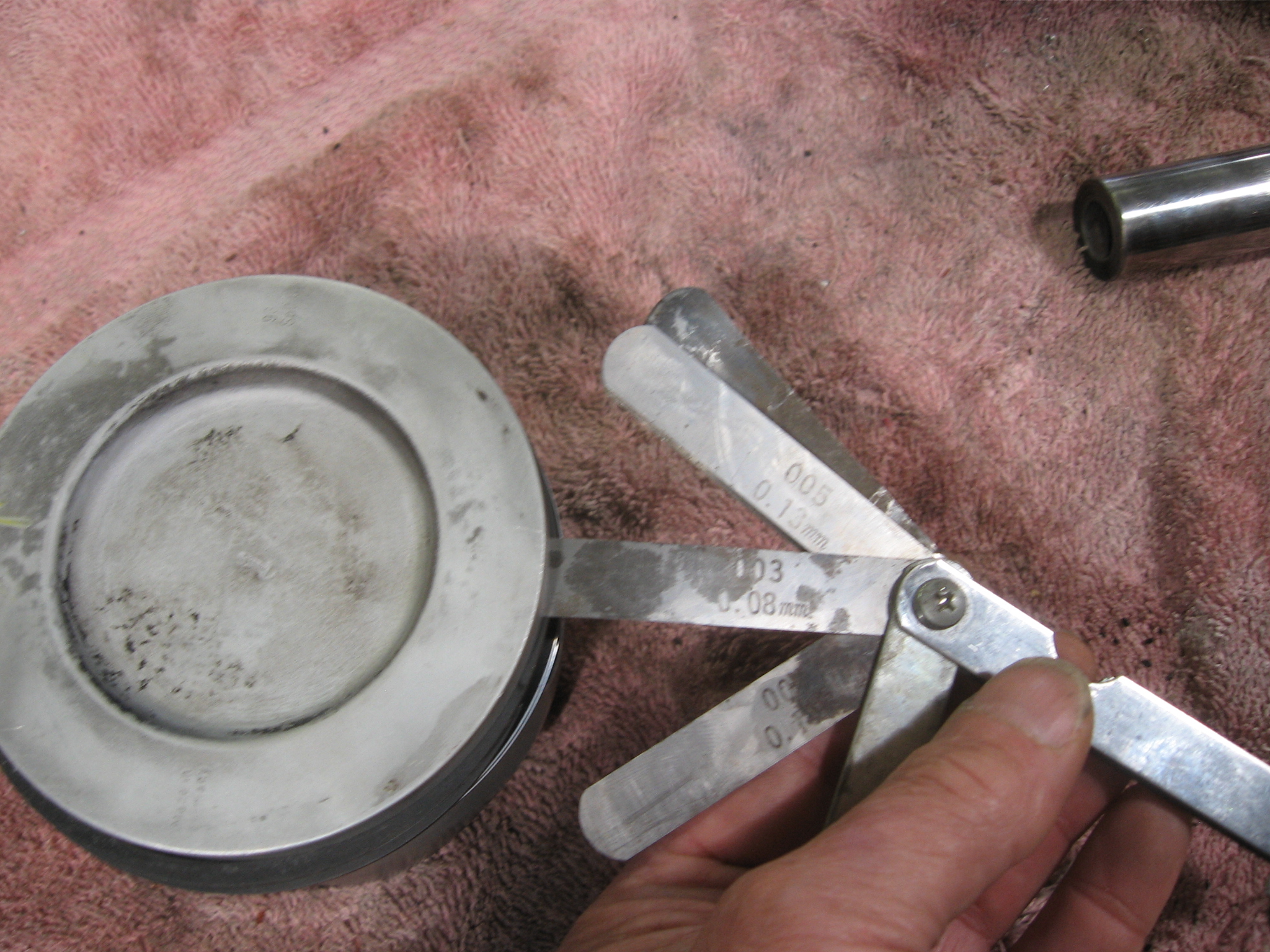

Now the side clearance.
spec is .0023-.0035 We have a TIGHT .003

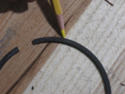

You can now install the rings on the pistons. Note the top and middle (don't mix them up) are marked with "Top" on the side that faces up.
You can do this carefully with your fingers or use a ring spreader. Do this carefully,don't want to break one. follow the instruction that come with the ring set,or refer to "How to rebuild your Volkswagen air-cooled engine, by Tom Wilson.

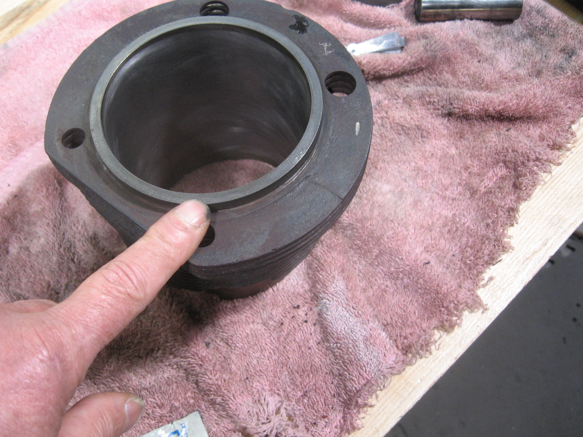

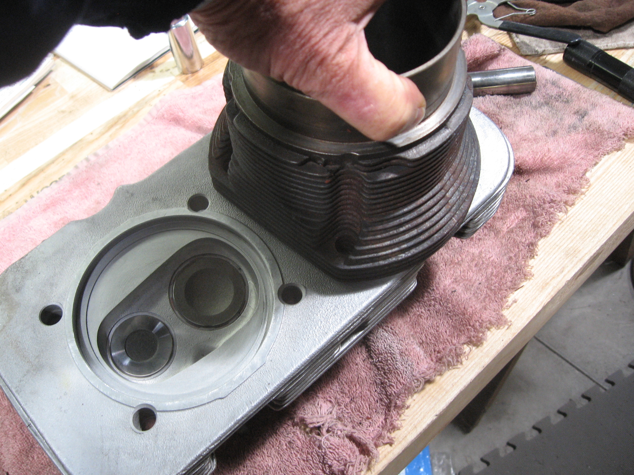

Prior to installing the pistons in the cylinders,we are going to take one more step. We are going to "seat" the cylinders in the head. Apply some valve grinding compound on the mating surface of the cylinder.
Lap the cylinder into the head. Be sure to take a minute and mark which cylinder goes in which head chamber.
This is just an extra step to ensure that the cylinder seals in the head. (more on that when we get to the heads)

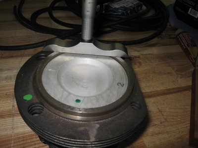

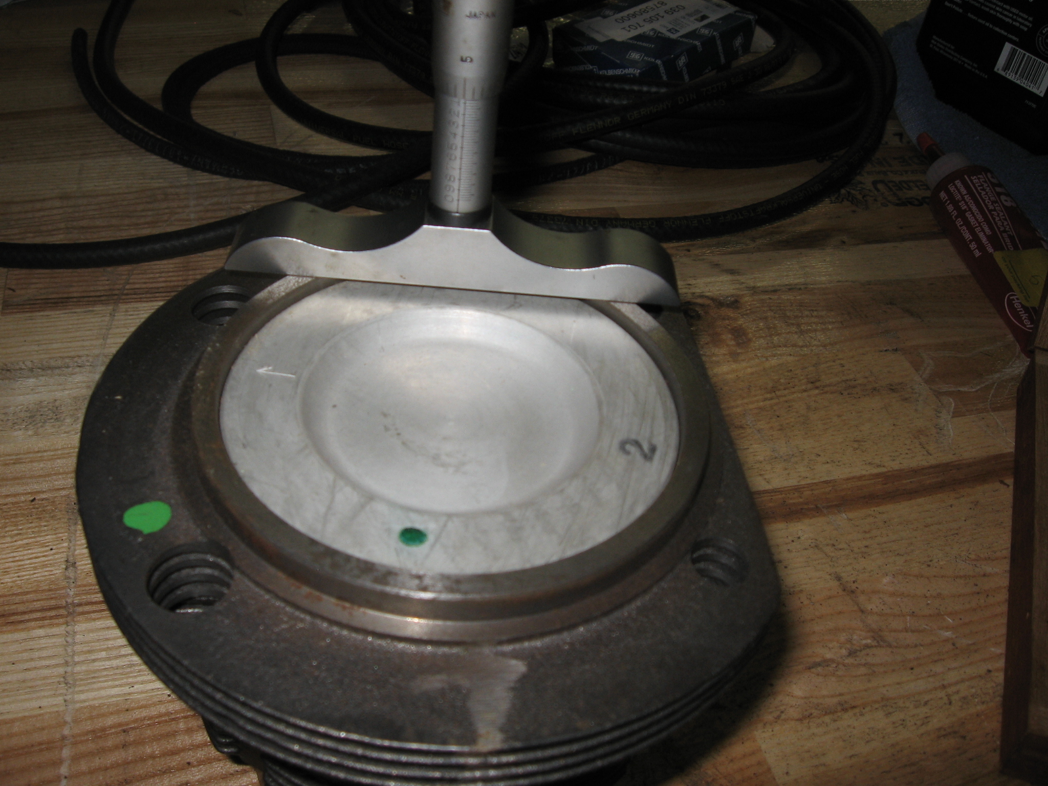

Now before installing all 4, we will install one in order to measure deck ht. I did not get a pic of this process so I mocked up a Piston and cylinder. With the piston and cylinder installed on the rod. Check deck ht.
We measured .045in. write this down on you build sheet along with the head vol (cc's) the you did a while back.
